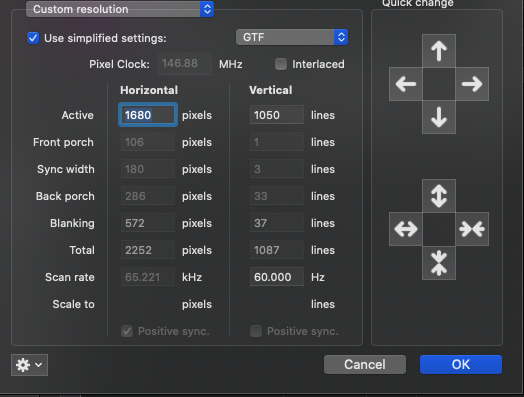

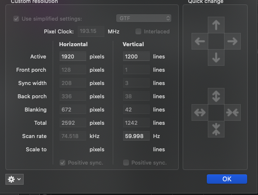

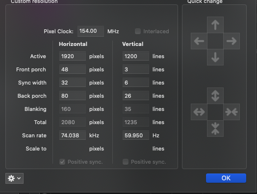

Hoping someone can help in regards to the switchresx setup. 16" MBP 32gb ram 8gb vid. When hooked up to external monitor Radeon Highside spikes like everyone else is seeing. I only use in clamshell mode and I'm having trouble getting this resolved with switchresx and hoping I'm doing something wrong. Monitor is 24" Asus 1920x1200 Pro art IPS.
Here's the settings and the results of my testing:
These settings fix the issue of the Radeon Spike, it drops down immediately. The issue is this resolution is not great and everything on the screen is huge, not useable.
These settings work on the monitor, resolution is good, but no impact on the radeon high side (no simplified or GTF):
These settings seem to be what should fix the issue but I get an error on the monitor "Out of Range", nothing I can change on the monitor to try and help this that I could find either:
Any help or insight would be greatly appreciated.
Thanks
When you select simplified settings and use GTF, it automatically changes the resolution to 1680x1050? When I create it on mine it keeps the resolution that the monitor is currently set to.

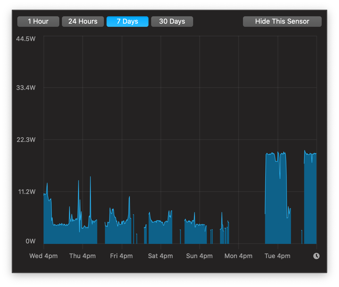

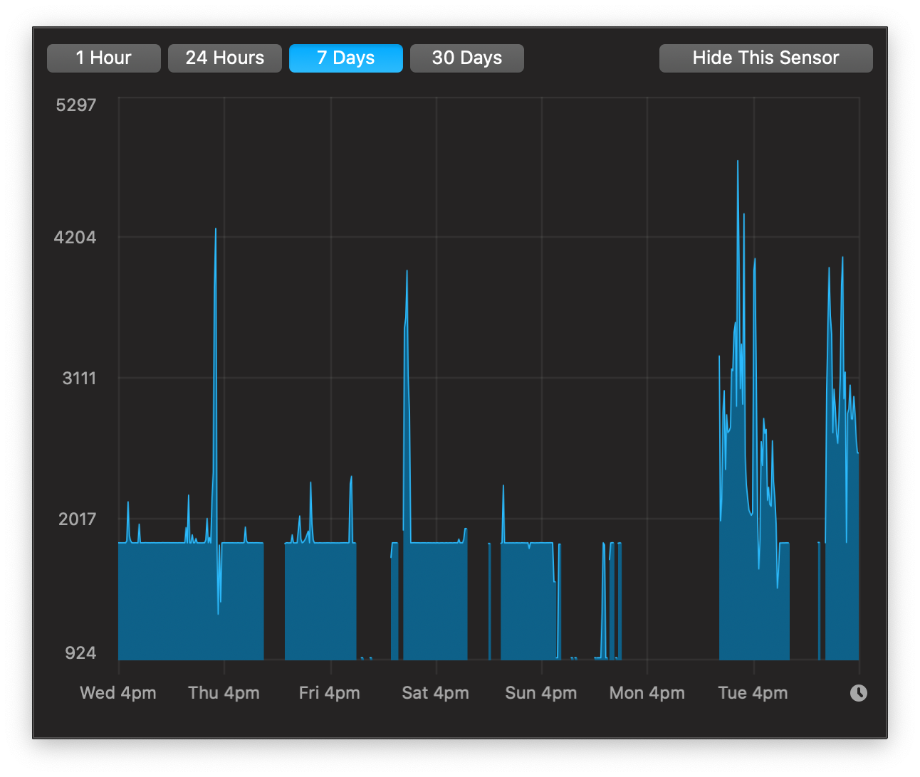

Here are two screenshots showing a 7 day view of the Radeon High Side and left side fan RPM. You can see clearly that besides the last 2 days with direct USB-C connection, Radeon High Side and fans are both pretty stable and low with the eGPU.
Radeon High Side:

Leftside fan RPM:

I've been using the 16" with USB-C connection to LG 27UK850-W for the last 2 days, just to get a feel for it without eGPU because I never really used it without eGPU except for some basic testing.
I did notice the fans were sometimes noisy (~4000rpm) and on rare occasion hit ~5000rpm (when compiling), but were often acceptable at <=3000rpm.
Radeon High Side:
Leftside fan RPM:
