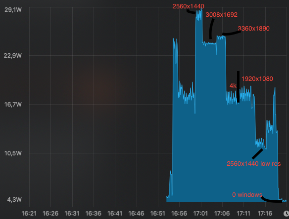

Monitor: lg 27ud88-w 4k
Watching Twitch TV with different scaling options
