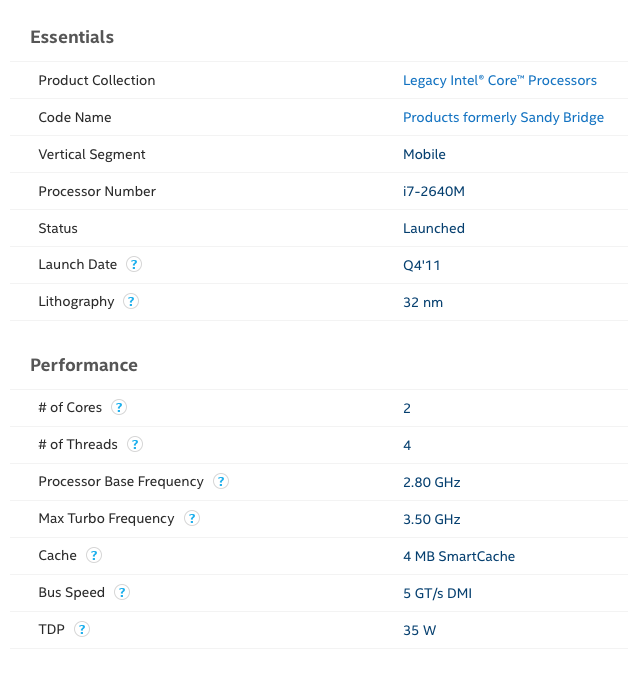

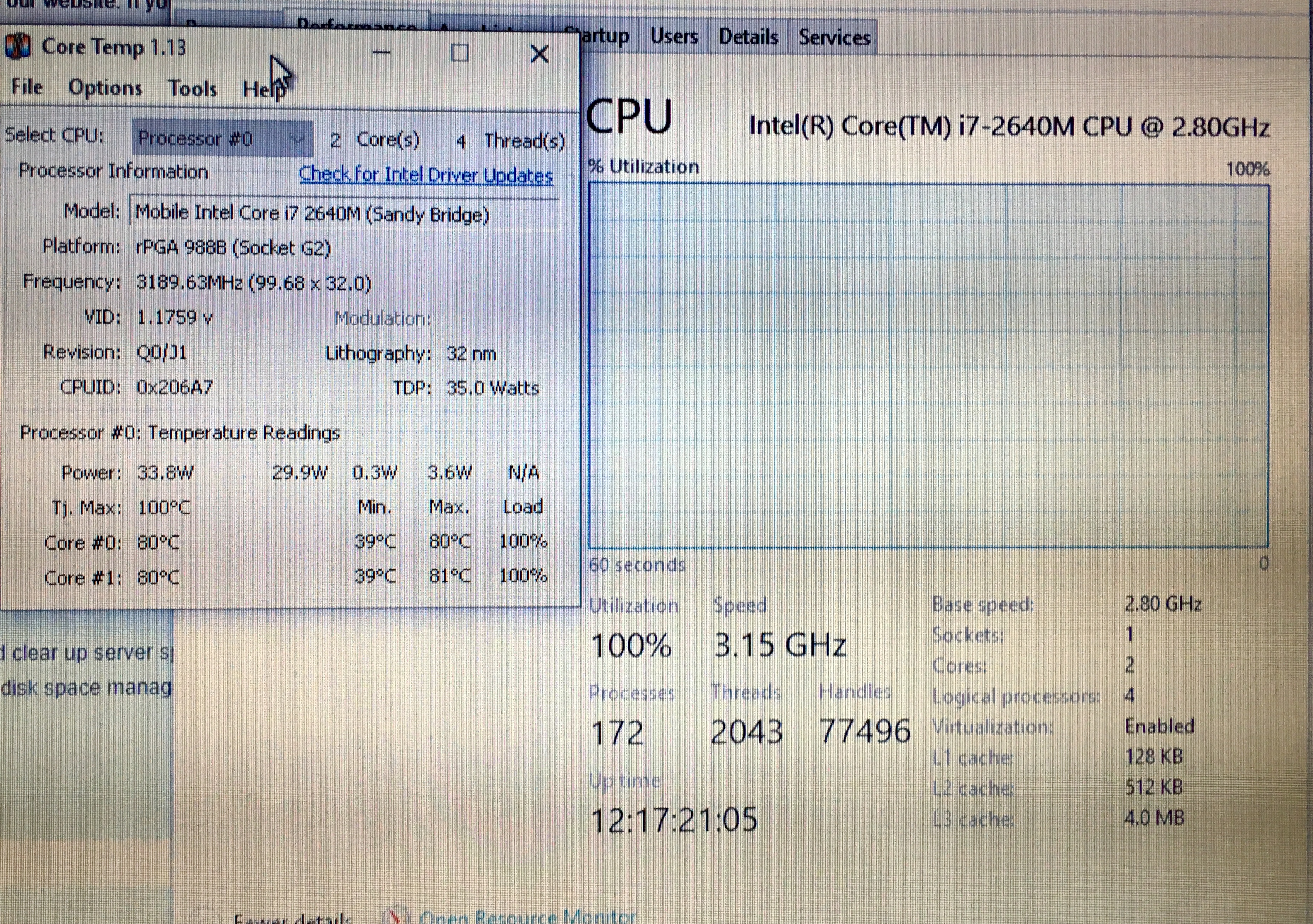

Besides you can be leaving a lot of performance on the table. Here is an example of my 2011 ThinkPad t420 fifteen minutes into a CPU stress test. I put in an i7 2640m a couple years ago
CPU specs
Since this is a stress test of all cores we won't see max turbo frequency but there is still additional performance to be had over its base 2.80ghz. Honestly I would be a bit disappointed with a computer/cpu that only met its bare minimum spec.
Excuse the iPhone pic of the screen.
