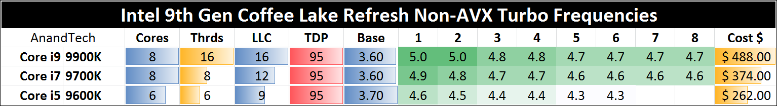

AnandTech is just one of many sources in where you'll find this. At six or eight cores loaded, the 9900k is rated at 4.7GHz. In the sustained tests, I think we've all seen that that the i9 hunts around 3.8–3.9 GHz. Whereas, the i5 is actually sitting at ~4.2 GHz full tilt. Now, these are both "95 watt" chips, and, Apple claims the i9 boosts higher (400MHz higher) than the i5, but it seems the i5 actually boosts ~400MHz higher than the i9. Does anyone have other numbers that the processors are sustaining?
Now, it would be most interesting to see what turning off two cores would do to the i9 (and maybe even hyper-threading). As many have refuted claims that it is throttling, that wouldn't support an increased frequency with less cores. If it was throttling, however, restricting core count would then raise the frequency of the remaining cores as there would then be more thermal headroom. This would help to put the battle to rest. Is someone with an i9 iMac willing to do this?
This is the most important info to know, that if the i5 9600k with only 6C6T is sustaining a higher turbo clock across 6 threads, then for some tasks then it is going to outperform the 9900k's at lower lock across 16 threads. Some apps like Adobe CC's probably are not going to utilize threads beyond 6 for certain tasks. And the fact that it costs less to config with the i5, and then it most def will be cooler and makes less fan noise are also important.

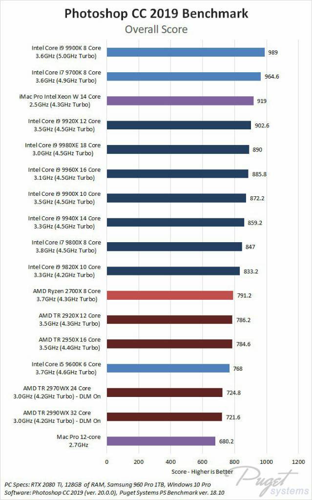

I would recommend the i9 as it is the recommended CPU from Puget Systems for Photoshop ( Although they build PCs so are not directly comparable).
See the attached bench marks.
I hope that helps you inform your choice.

You're confused. Apple never claimed 9900K will do all-cores @ 4.7GHz, only 5GHz one/two cores.
The 9900K uses 95W when running all-cores @ 3.6GHz. That's the "official" rated value. It will use more watts (125W+) with all-cores @ 4.7GHz. TDP is like the rated MPG value on a vehicle. You'll get more or less MPG on how you drive it. Same with the 9900K, you'll use more or less watts depending on the load you put on it. There's no official MPG value going 200MPH and neither is there a TDP value going all-core 4.7GHz.
Also note that the 9900K chip in the iMac has a watt limit set like a vehicle with a speed limiter, it's only getting 85W on full continuous load.
A 9900K to get speeds like your chart needs way more than 85W.
The watts being limited to 85W instead of 95W under full load is a more justifiable outrage than crying over an unrestricted 9900K able to sustain 4.7 GHz on all cores. But even with the watts restricted 10W lower than the advertised max, it seems to be performing better than anandtech’s test when they restricted it to 95W at least with more cores loaded. The highest I seen the CPU go on 1-2 cores is 4.8 GHz where they saw it hit 5 GHz.
When I get a chance, I will limit Cinebench to 6 threads and see what the i9 runs at to see if a 9600K will beat the 9900K on a task that really take advantage of 6 cores.
[doublepost=1554208891][/doublepost]Update: Ran Cinebench limiting it to 6 threads the i9 ran a consistent 4.5 Ghz with a score of 2749. Someone with a 9600K got 2595 at a speed of 4.2 Ghz. So the 9900K is still faster limited to 6 cores/6 threads than a 9600K going full tilt.

Perhaps I am the one being difficult, but on count of Apple, not yourself. You are correct, in that the processor is guaranteed to hit 3.6GHz all core with no more than 95 watts. That defines the TDP. That being said, Intel does not restrict the processor to 95 watts, as this is a “design” guideline. Apple, ultimately is the one to implement the chip in their systems as they see fit.
If a CPU is rated for 3.6GHz, it means to me that it should be able to run at 3.6GHz for an extended amount of time (several hours).
Turbo Boost means only the ability to increase the speed for a short amount time (measured in seconds).
If a 3.6GHz CPU with 4.8GHz Turbo boost should be able to run at 4.8GHz all the time, why not just call it a 4.8GHz CPU?
So to me, any reduction of CPU speed which occurs above 3.6GHz is not throttling.
You seem to have another viewpoint.
This is what I find very confusing. If Intel “designed” this processor to operate at 4.7 GHz instead of 3.6, why even list/support 95 W TDP? If it’s not within the design spec, why is it on their spec sheet?
