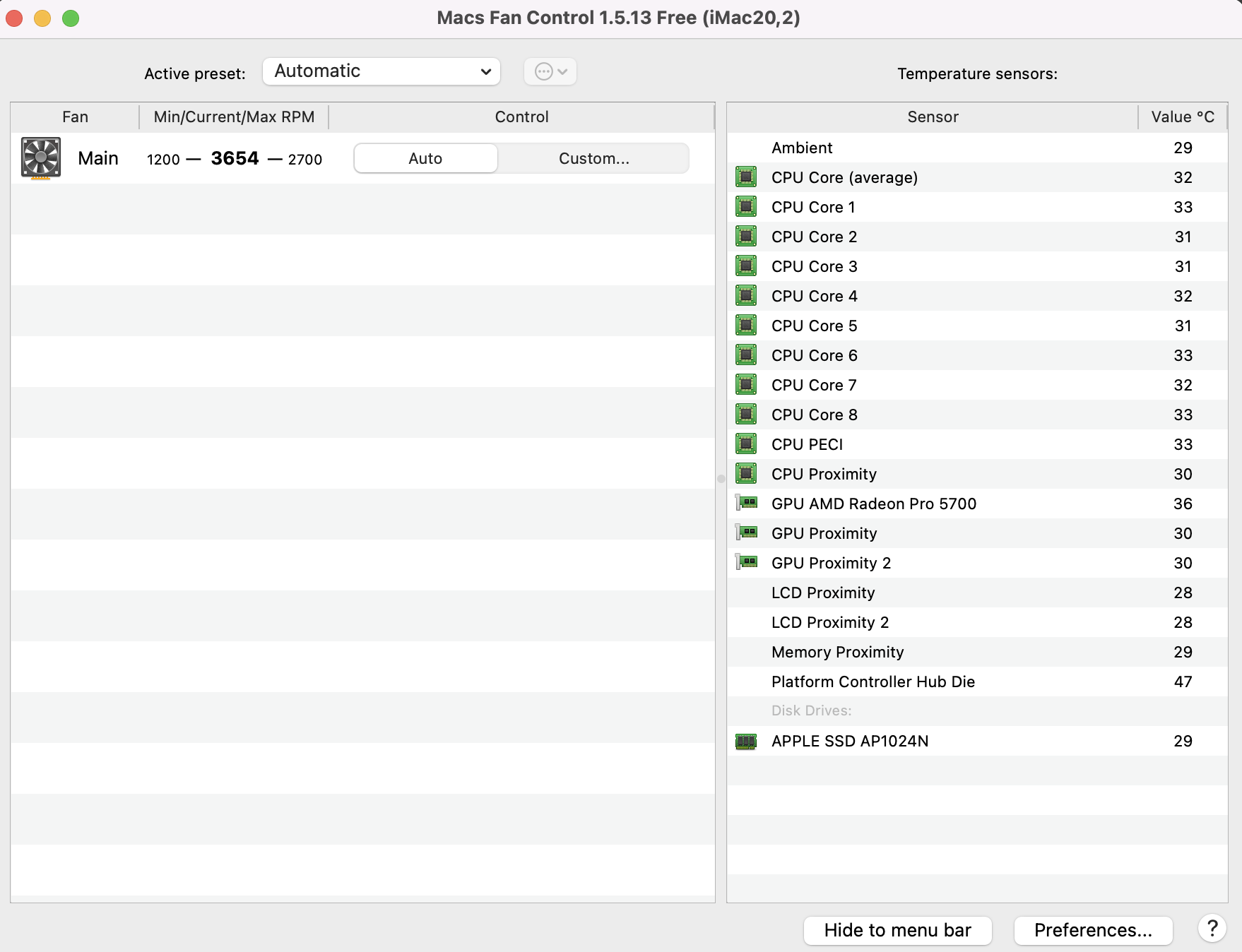

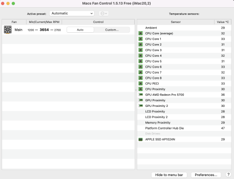

In your case, does MFC report 0 RPMs as it's happening? That's what mine did, and I presume that if the sensor detects 0 RPMs, then the fan defaults to maximum speed.
I just figured it's some kind of hardware fault, maybe the fan sensor. When they replaced the logic board (including the fan, and everything) I had to restore from Time Machine. So in my case at least it's highly unlikely some lingering system glitch. My money is on some kind of hardware fault.
It might have during the previous 6 months, I'm not sure. Last time it did it, it did not. I took a screen shot of MFC then, which is attached. Pretty high number. And did I mention...? smacking the middle of the lower screen bezel, right on the Apple logo, usually made it stop.

Actually now that you mention it, I do remember sometimes seeing an extremely high RPM like you as well.

Do you have Macs Fan Control installed? Or a similar program that can tell you the fan RPMs? I took a screenshot of the fan speed as it was happening, as well as normal fan speed, and sent this to the repair technician as proof. I would suggest doing this as well.

Yes, it shows nearly 4000 rpm same as Rickbot's fan. Same issue. Fool of me, I forgot to make screenshot but maybe Rickbot's photo will be useful.

Oh! Also, while it's happening, take a screenshot of Activity Monitor. Both CPU and GPU usage. This is to show that the fan speed isn't related to heat or some background process that's taking up a lot of resources. I just remembered I also did this. While my fan was going, CPU/GPU usage was basically idle.
Something else to note is that the fan increases speed abruptly and not gradually. If it was a process or heat issue, the fan would speed up fairly gradually and not suddenly.
Hopefully this proves to your service centre that there is a problem, even though they can't find exactly what it is.

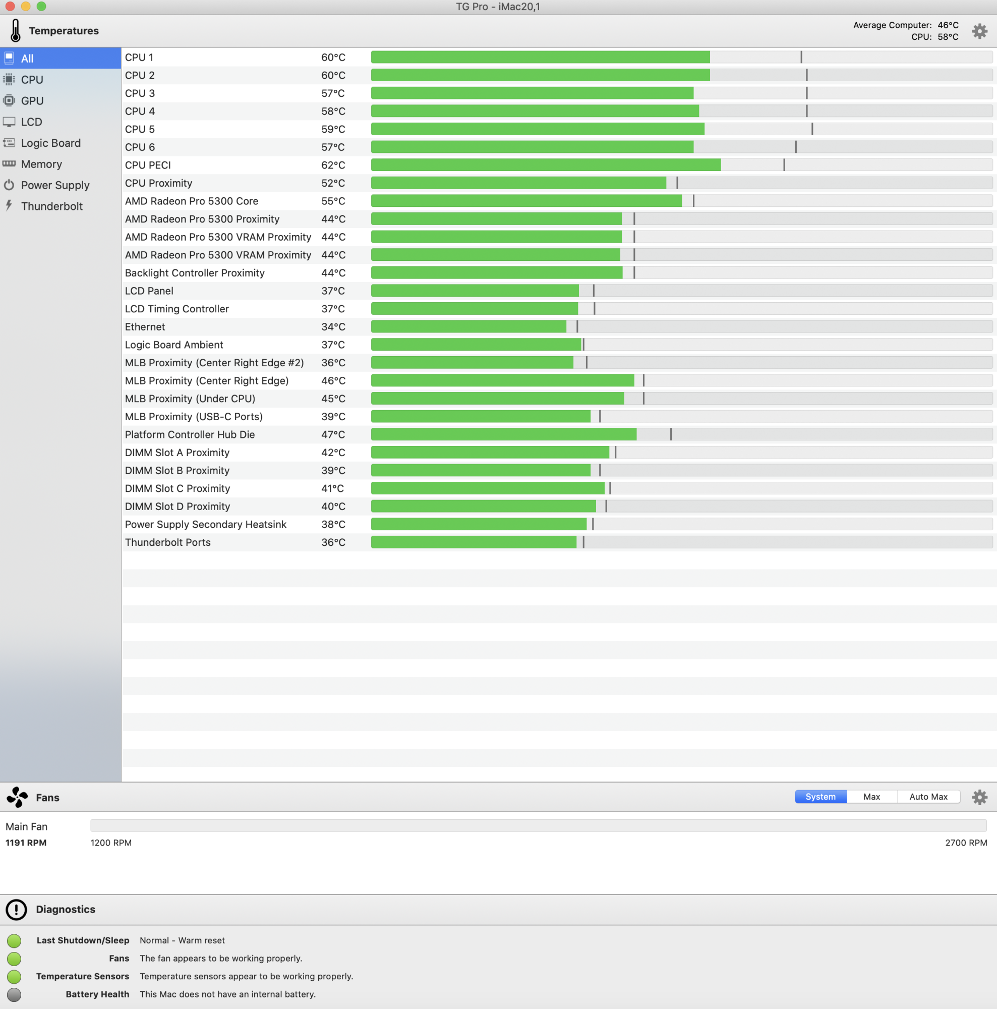

Very interesting. I also have the same configuration (3.8Ghz i7 proc and Radeon 5700) since late August 2020. However I only noticed the fan spinning up when it's doing updates from the Mac App Store (notably Xcode) and having multiple browser windows (MS Edge, FireFox) opened.

That sounds normal to me. Lucky that you didn't have to deal with this! The most annoying part is the technicians have no idea what the problem is and in some cases will take a very long time to finally just replace the internals.
As long as you don’t hear them spinning high out of the ordinary I believe you should be OK. But you can always check for the temperature when the fan gets higher RPM. That is the easy part
