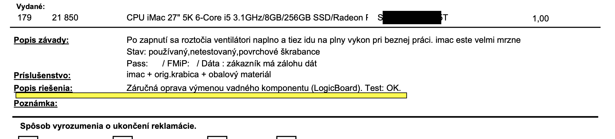

Hi tiguanito,
I had the same problems as you did, with my 2020 iMacl. The logic board replacement helped and ever since that the fan issue didn't reappear.
Here is the cutout from the service repair protocol. There is no Apple store in Slovakia, so I had to visit the authorized service for the repair. However they replaced the logic board within a warranty so I didn't have to pay for the repair.
The protocol is in Slovak of course but the highlighted sentence says that the logic board was faulty and replaced.
