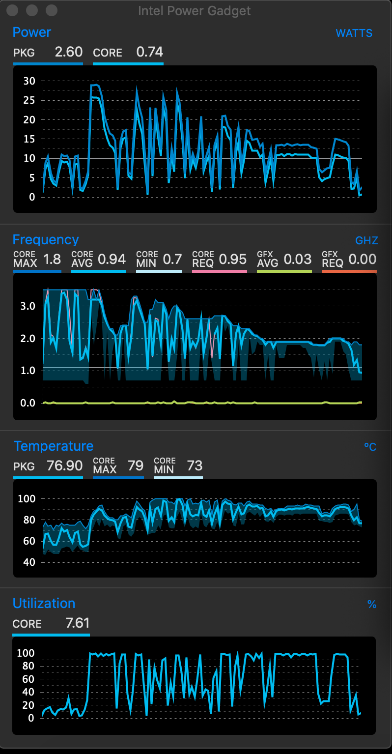

I found that the startup CPU temperature with shim mod alone still reaches 100 degree. But with heated mod it was 70 degree. This one is 80 degree but the temperature drops very quickly with fan spinning. I used TG Pro to setup a custom profile (4500 rpm always and maximum 7000 rpm over 90 degree).

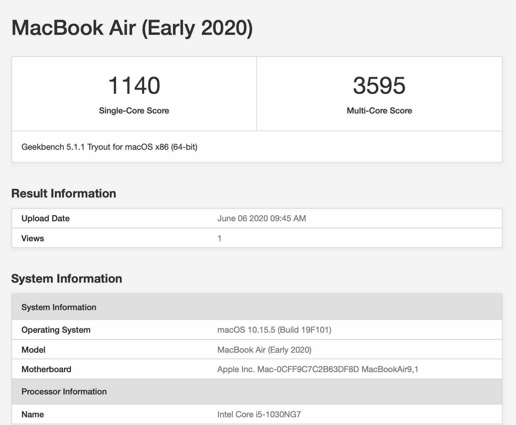

I ran Geekbench Multicore CPU test and found that the score is very good
3169 (shim mod)
3595 (shim + heatpipe mod)
The heat profile also proves that heat is transferred properly. The frequency (light blue) during early low utilization part of the test caught up the requested one (pink) than shim pad alone. And heavy load part is better also (though heatpad mod is better because the heatpipe and fan speed capacity). You can find the comparison quoted from DanSilov thread below.

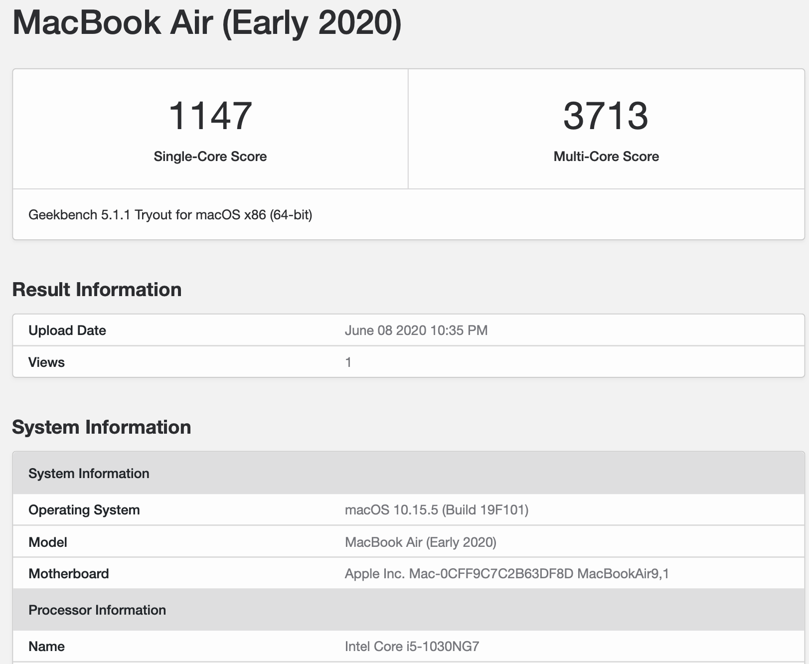

I repasted again and with shim + heat pipe mod (I am too lazy to remove the heat pipe),
my score rises to 3713. I did it 3 times, and its all above 3700. Wow.
And more importantly, the frequency profile is perfect for me. The pink (requested frequency) line completely overlapped with the blue (average frequency) line THROUGH the test. That means the CPU provided what was needed for the test without thermal restricted. And the temperature never reached 100 degree.

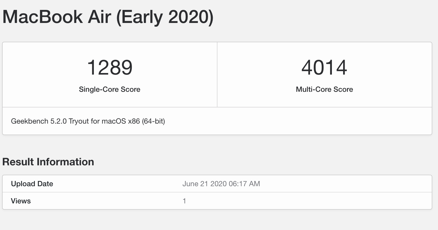

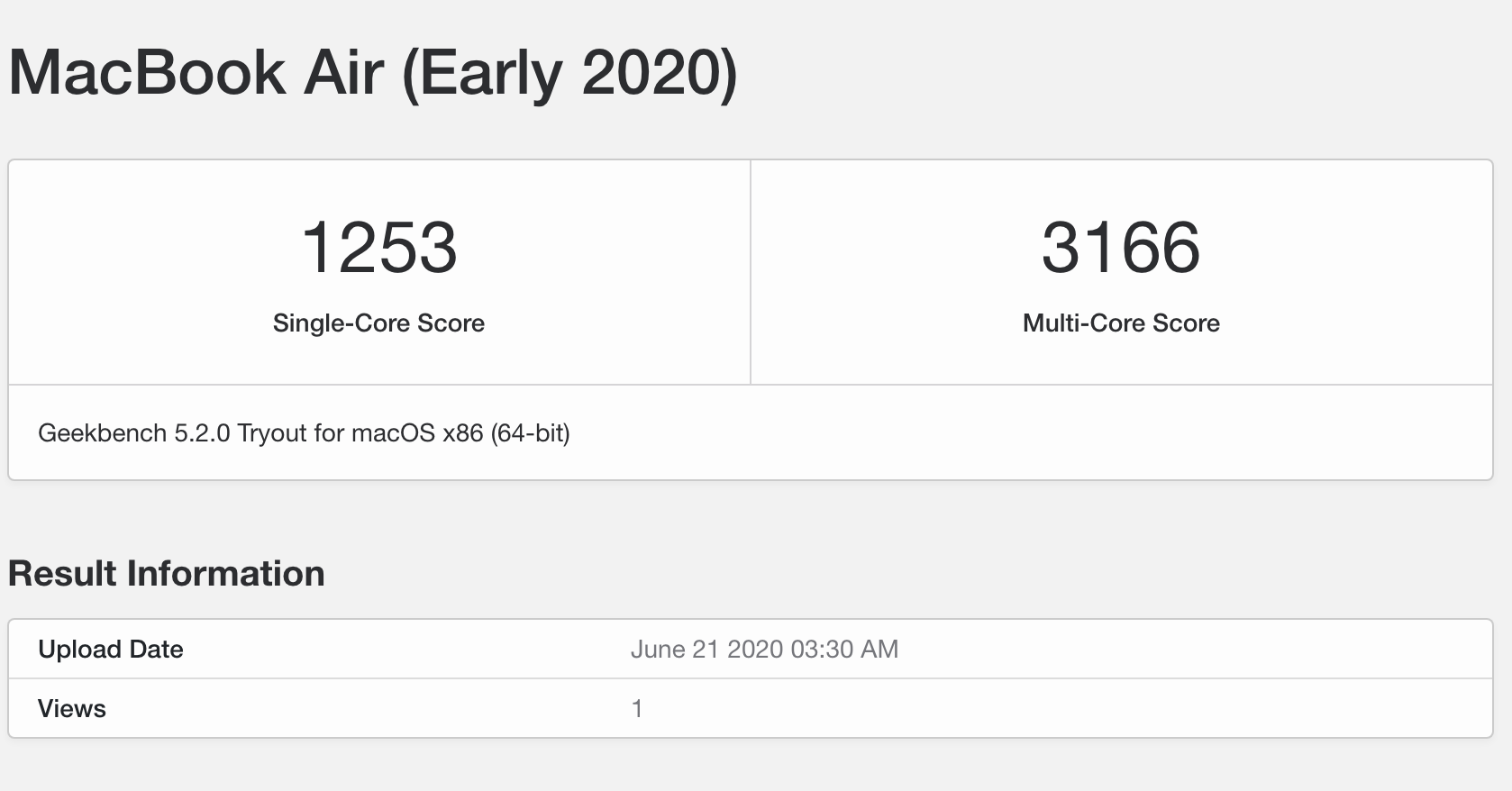

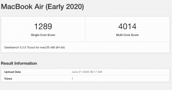

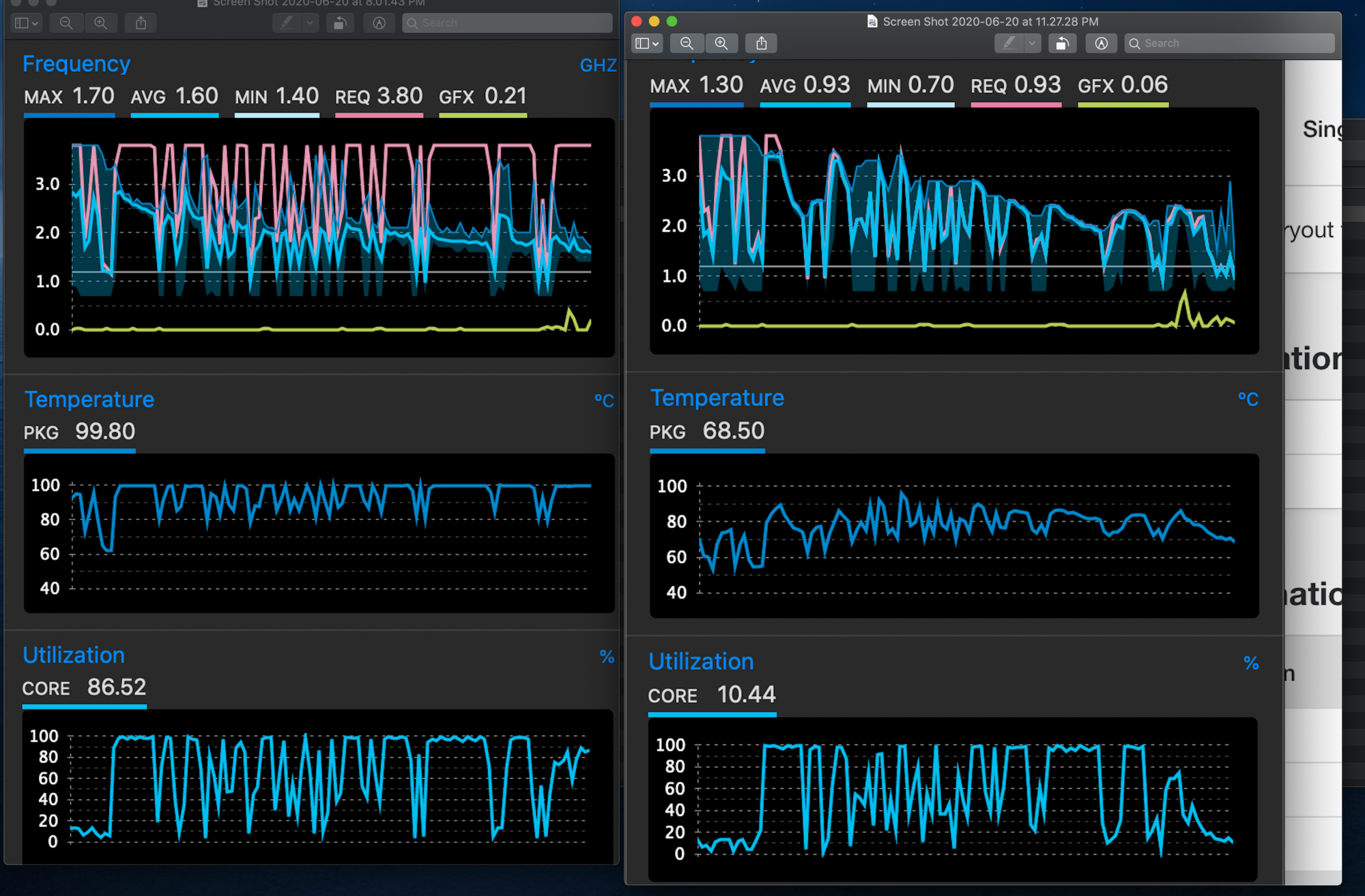

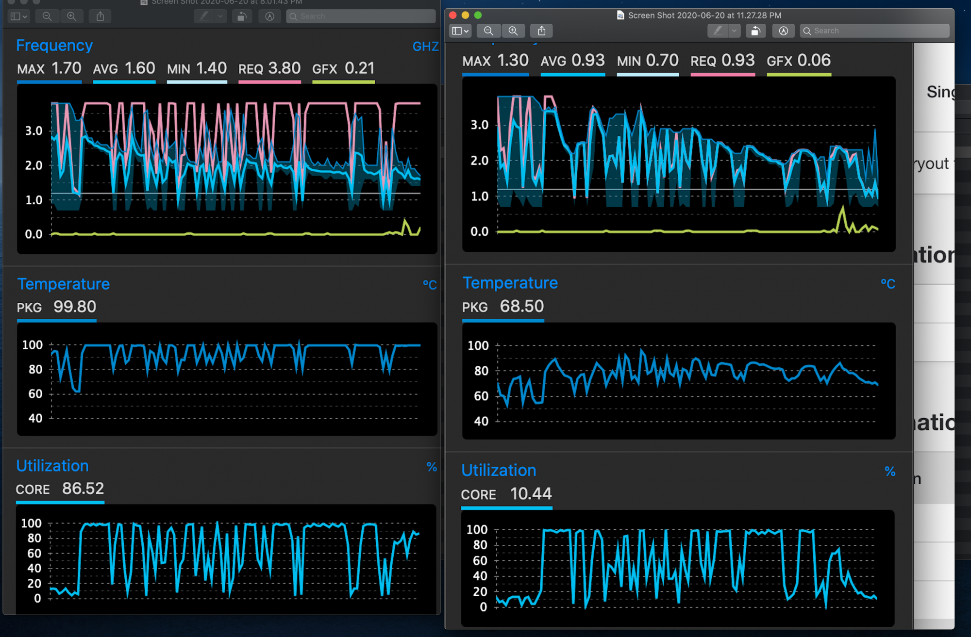

Update: went ahead with the heatsink and heat pad mods and oh...my...
The performance gains are absolutely amazing, but the temperature drop and stability is even more impressive in my opinion. This has turned my MBA into the powerhouse it ought to be.
Left side is pre-mod GeekBench testing; right side is post-mod. Look at how much more stable the frequencies and temperatures are. Also, note how much lower the temps are post-mod, with only a single 100*C peak.

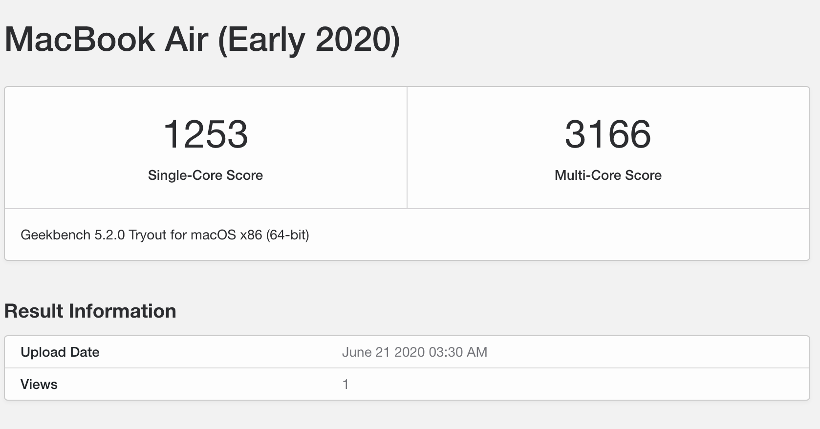

GeekBench before the mods:

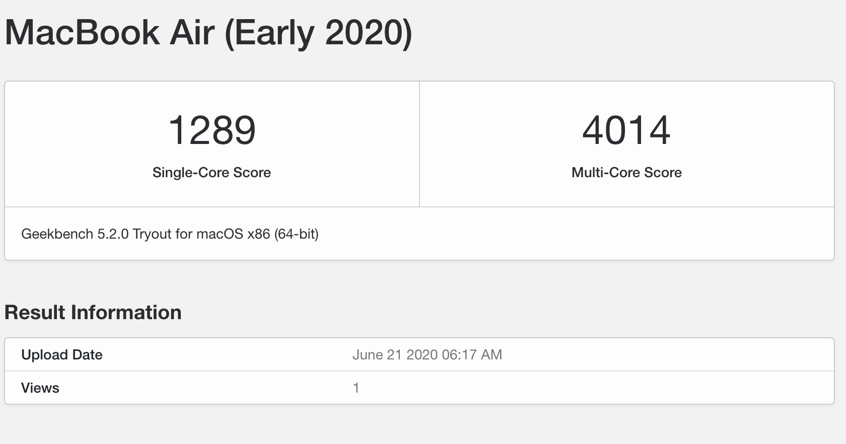

GeekBench after the mods:
I added a couple of my test results in PhightinPhils26's spreadsheet here. I'll continue some tests tomorrow, but early indicators are extremely positive.
Lastly, I documented much of the process and put together a thread with instructions here. This is 100% credited to everyone here like @DanSilov, @Robotronic, @kinchee87, etc. Thanks for the advice and how-tos. I couldn't be happier with the results.
