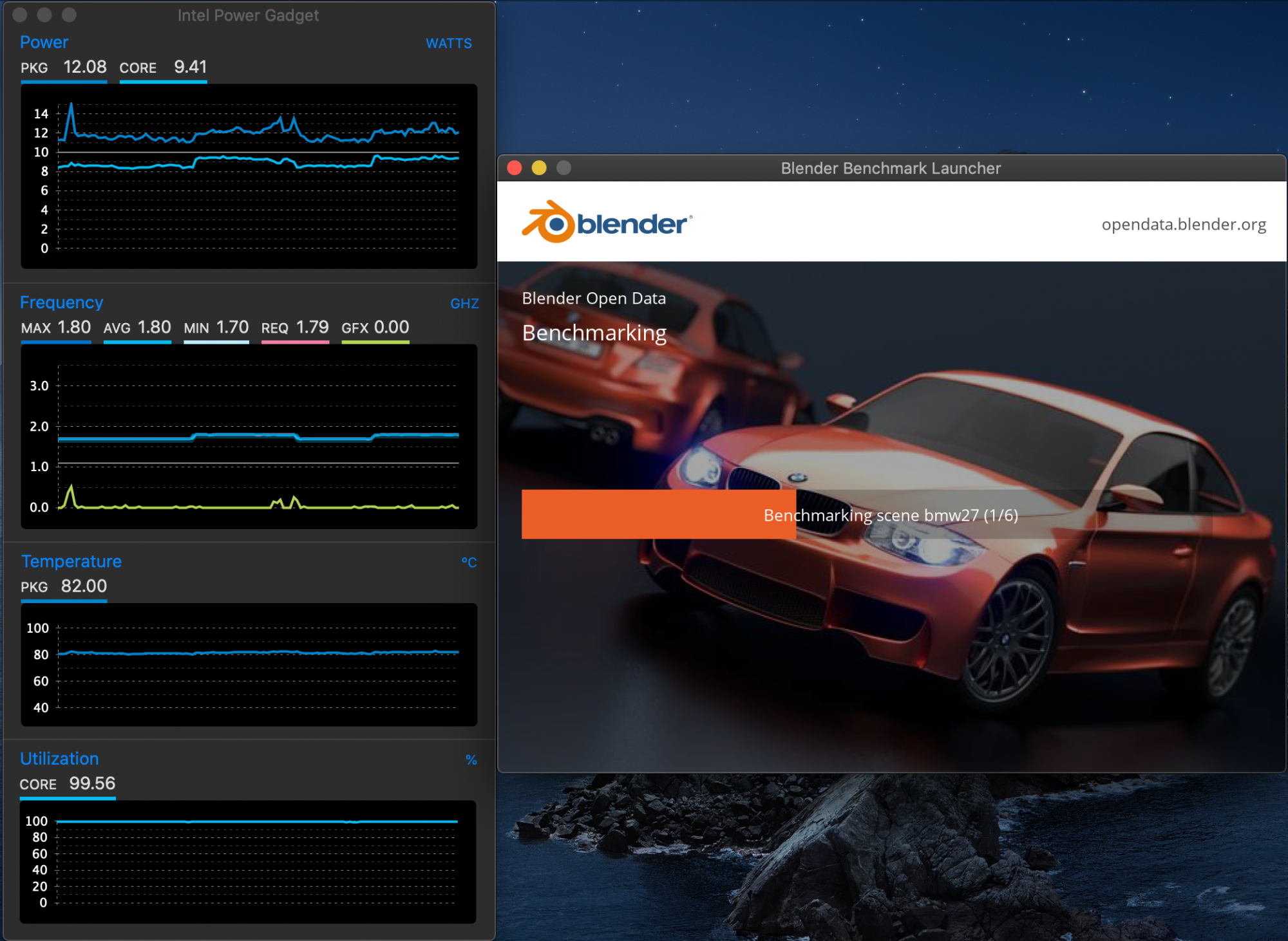

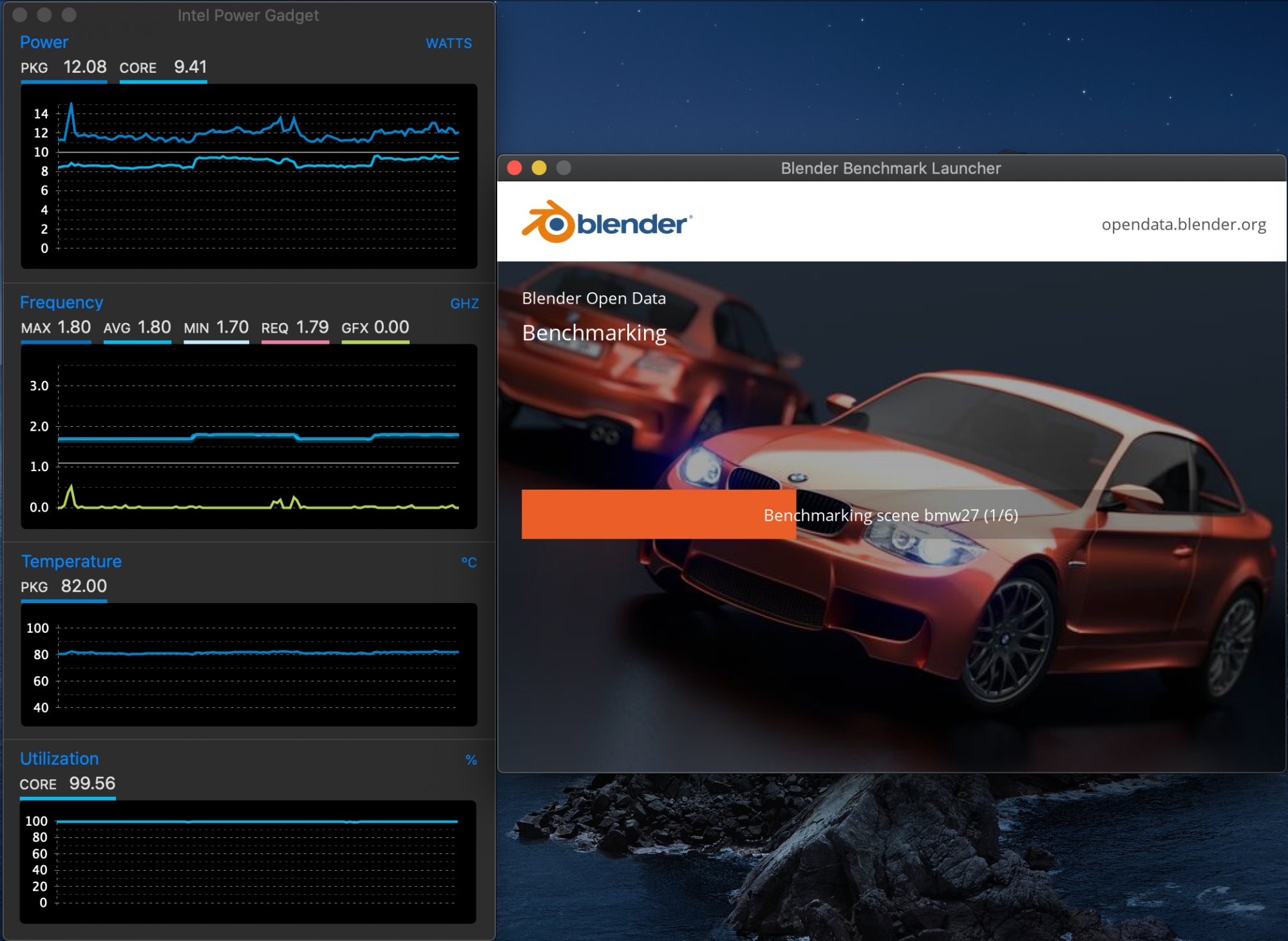

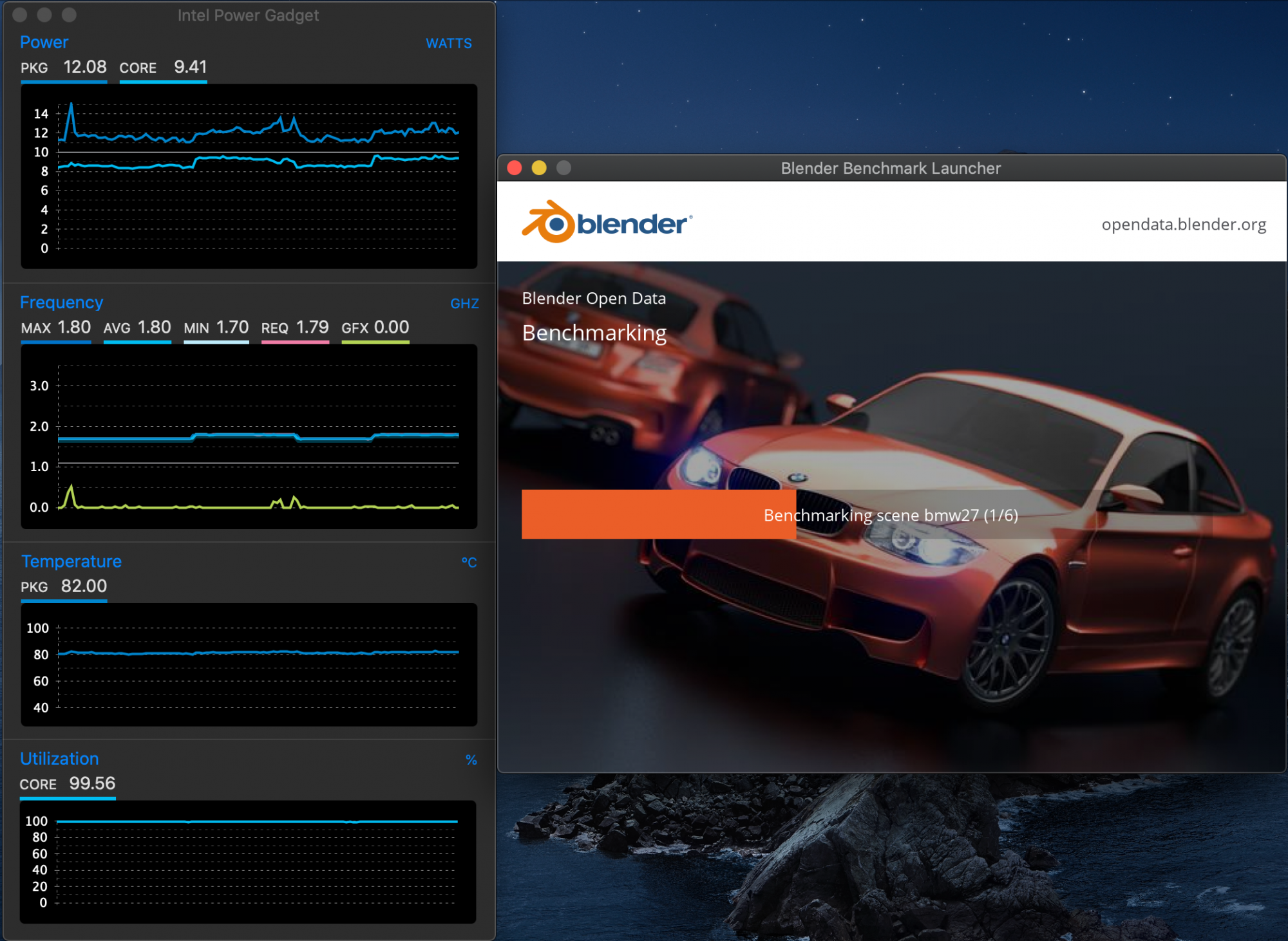

So I did the mod. copper shim, new thermal paste, and heat pad. I have a 2020 i5 MBA. The weird thing is that it's capped at 1.8 and it's at around 80c when I run a benchmark. This is the blender one I'm running, but it's like this for cinebench too for some reason. When it's not running a benchmark, it does go up to 3.x

Congrats on doing the mod. That is weird, what version of macOS are you on?

That's the "all core" clock speed and the single core speed is much higher :) Perfectly normal!
