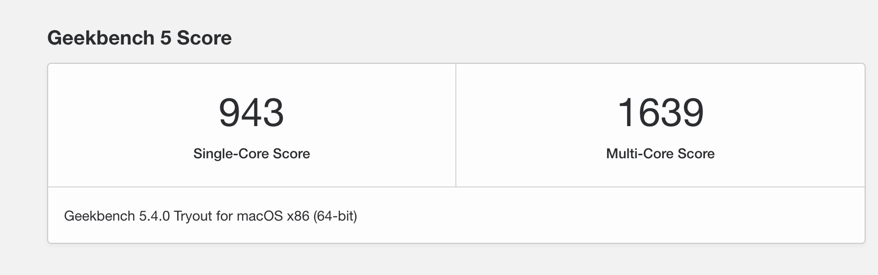

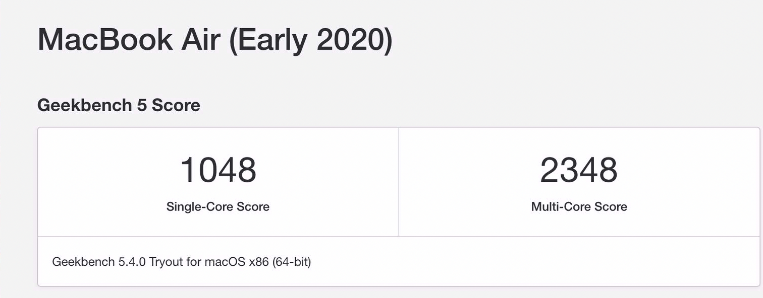

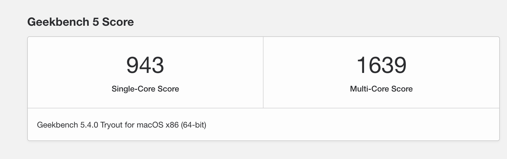

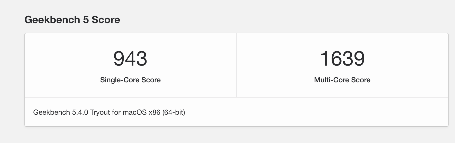

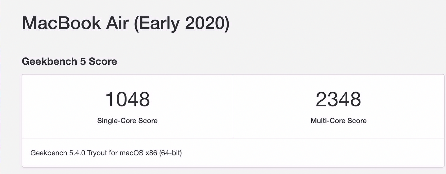

Just did the thermal pad mod on my i3 2020 MBA. Before and after geek bench scores attached. I used a 2mm thermal pad between the heatsink and case. When the warranty expires I'll probably do the copper shim mod.
That’s a huge boost for a 10 minute job. The safest mod to do.
What pad did you get? I saw others used 1.5mm.
