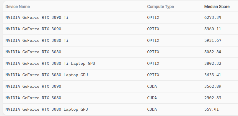

I noticed there are no 3090ti or 4090 CUDA scores for the Blender Bench. With what is there, the 3080 is twice as fast as the M1 Ultra 64. AFAICT CUDA doesn't use the RT backend so it is more of a "fair fight" with Metal.
CUDA cores are slower than RT cores, so people don't use them.
The 3080 has 30TFLOPS, the M1 Ultra has 20TFLOPS, so that makes a difference of 50%. Whether the other 50% are because of the software or hardware maturity or some other factor, we don't know. What's quite interesting though that if the 24-core M1 Max scaled linearly we would expect 712/24*64 = ~1900 points, and multiplying it by 1.5 (the 50% of TFLOPS difference to 3080) yields 2850, which is oddly similar to the CUDA score (2900) that the 3080 has. Sure, it's just some random napkin arithmetics, but the sheer coincidentally of all this almost suggests like the Metal Blender backend has some massive thread scaling issues.
P.S. Your wattage estimates for the M1 blender seem quite off. I am not even breaking 30W running blender benchmark on my 32-core Max...
I dunno where the wattage estimates come from, I barely see 20W on my 24 core model.
Going by TFLOP is a poor metric as the Ultra is "slower" than a 3060 Laptop GPU which is a 7 TFLOP card (10 if you use the boost number). But I see your point otherwise.
Those results are weird anyway since the mobile 3060 is somehow faster than the desktop one?
it doesn’t work like that, the GPU will use all the available cores when rendering, both traditional and RTX, and RTX hardware is not “faster“ it’s just designed to speedup some aspect of the rendering. Depending on the scene RT cores may accelerate the rendering a lot, in other case not so much.
Reactions: Xiao_Xi
What is the point of the optix renderer if the cuda renderer also uses the RT hardware?
