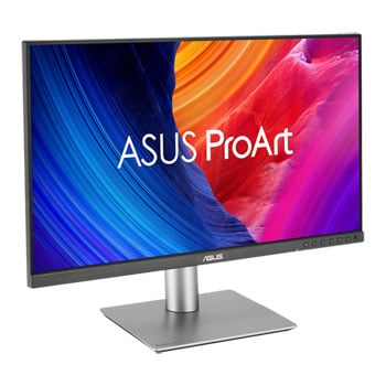

27" Asus ProArt 27" 5K PA27JCV - Current $800, Max $800, Min $800 (as it just came out a few months ago)

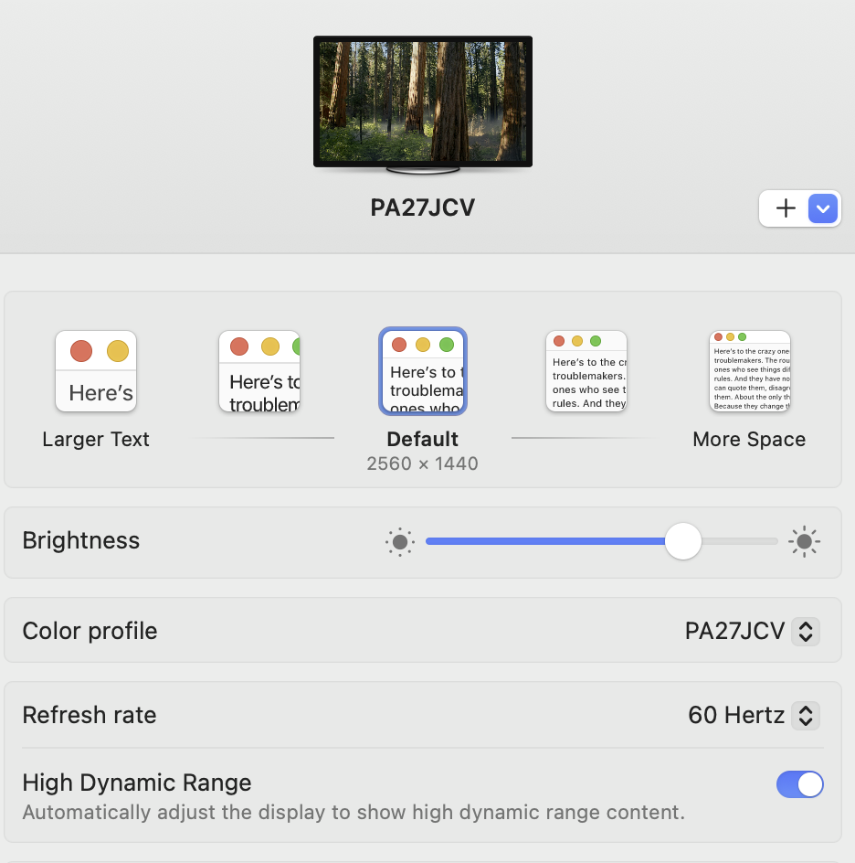

This is my first HDR monitor, so I don’t have another one to compare it with, but I’m really happy with how it performs! :)
Which Mac is this with? With the M4 non-Pro Mac mini and 27" Studio Display, other higher resolution options are 2880x1620 and 5120x2880, with nothing in between. There are more options with the M4 Pro, like 3200x1800.
Actually for someone like me who likes bigger text, 2880x1620 might work well with the 32" Acer 5K. I'm still curious what resolution options there will be with the 32" Asus 6K, but I'm guessing it will be a jump from 2560x1440 all the way up to 3008x1692 with nothing in between, at least with the M4 non-Pro Mac mini. I'd probably prefer the intermediate 2880x1620 but it looks like that probably won't be an option for the 6K, unless you go with custom resolutions.
I’m very happy with my pa27jcv. I tried a Benq pd2706u but wasn’t happy with the scaling issues.
