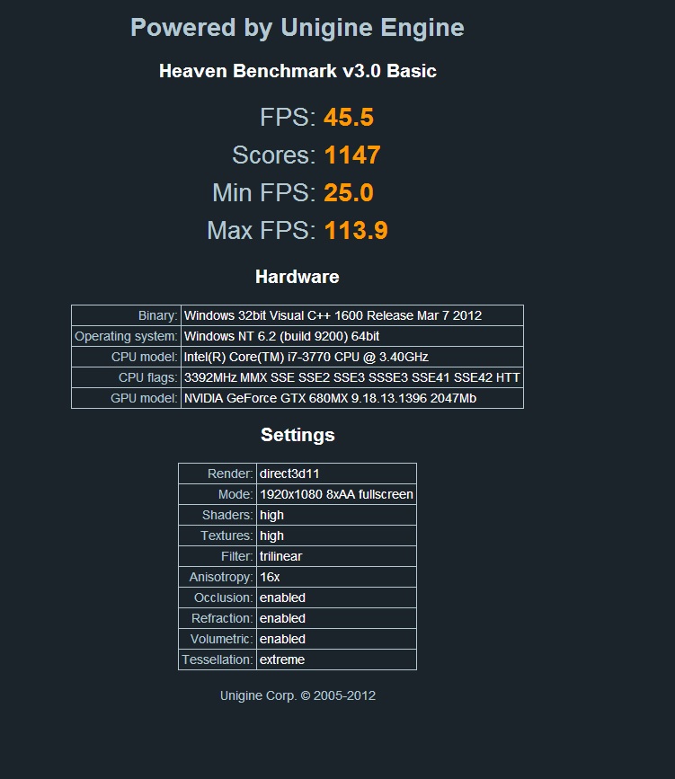

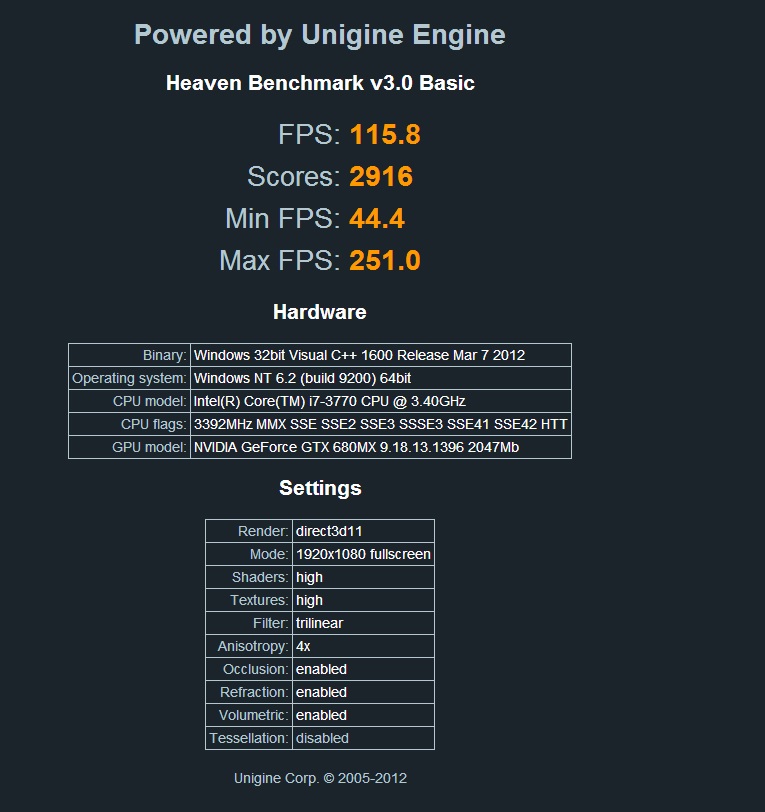

Edit: Heaven benchmark with default options, using the following .bat file
nvidiaInspector.exe -setBaseClockOffset:0,0,280 -setMemoryClockOffset:0,0,500 -setVoltageOffset:0,0,0 -setGpuClock:0,2,995 -setMemoryClock:0,2,3000 -forcepstate:0,1
Edit: Heaven Benchmark Maxed out using this .bat, so far no restarts as of now (Windows 8)
nvidiaInspector.exe -setBaseClockOffset:0,0,290 -setMemoryClockOffset:0,0,500 -setVoltageOffset:0,0,0 -setGpuClock:0,2,1006 -setMemoryClock:0,2,3000 -forcepstate:0,1

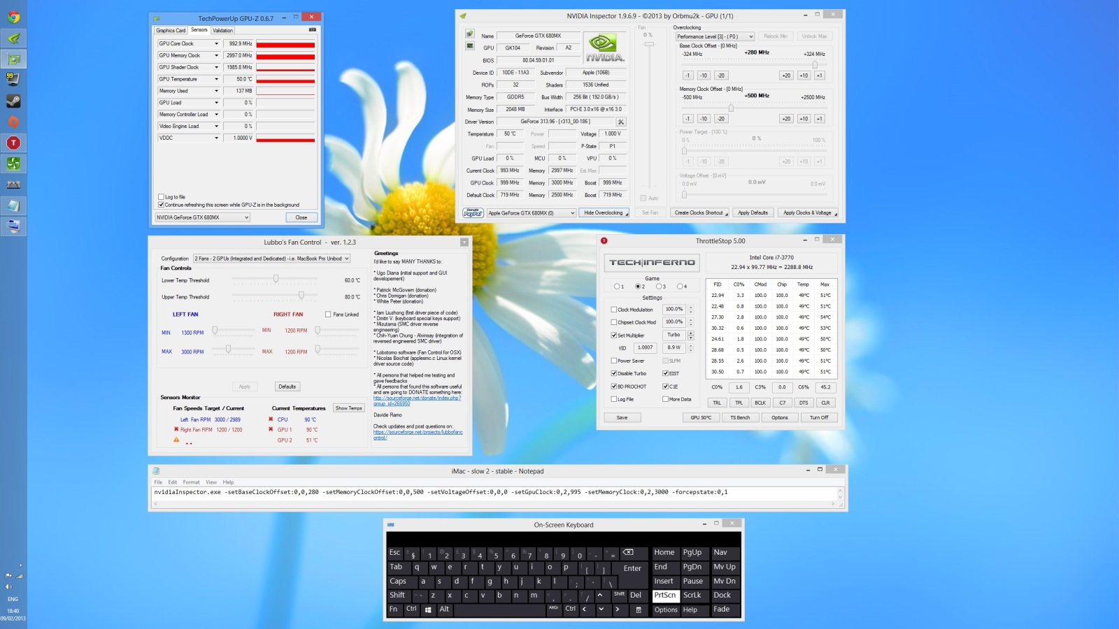

Try using it again and if it gets loud then put it on a slower rpm.
2600 is very very quite and keeps it cool, 3000 looks like to be the sweet spot for me and won't let your GPU go beyond 86-87. No need to worry unless it gets to 90 :D
Check out the new benchmark for heaven I just uploaded, it's insane.
Here is a pic of how I'm running my setup, make sure you disable the Turbo for your CPU it reduces heat by a big factor (5-8 degrees)
http://i46.tinypic.com/2qd7p8o.jpg
