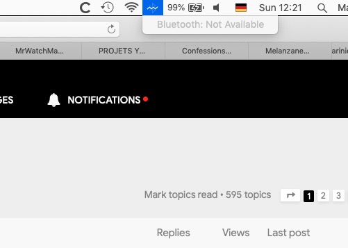

Unfortunately, I have experienced a problem with Bluetooth after the conversion:
If I connect the MBP (15" 2012, 'troop231' WiFi/Bluetooth module; Mojave 10.14.6 with latest supplemental update) to an external monitor (via DisplayPort) and also via USB (to make use of the USB hub of the monitor and also to use the hardware calibration), Bluetooth is frequently not available after the MBP went to sleep:
The Bluetooth menu says 'Bluetooth: Not Available', while WiFi continues to work trouble-free. The only way to solve this for me is to restart the machine. But this somehow defeats to the purpose of having the machine connected to an external monitor (in clamshell mode).
This happens with an Eizo PA271W (USB 2.0) as well as with a BenQ SW2700PT (USB 3.0). It does, so far, not happen if the MBP going to sleep without any screen connected.
Any ideas?
Any ideas?

That's really odd; maybe the external screens are generating noise causing BT interference or something.
USB takes a dump all over the 2.4Ghz space if not shielded well, which is the same space as Bluetooth.
You could try replacing your USB cables/hub. Heck perhaps even try wrapping the connectors in foil to see if that helps shield them.
It's a long shot, but I'd consider it.
Thanks, will try later this week, upon return!
