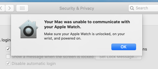

I received it today. I installed it and when I try to add my watch to Unlock the MBP, I get this error:
Did you check this footnote at the bottom of instructions:
If you have issues using the Apple Watch unlock or Handoff features, make sure that ‘Allow Handoff between this Mac and your iCloud devices’ is checked in System Preferences > General. Additionally, please sign out of iCloud and then sign back in.

Is WiFi and bluetooth working? If so, it would be a Catalina issue. There's also a few more things you can try, such as restarting the Apple watch, and disabling and renabling Handoff on your iPhone.
All of the issues being reported seem to be Catalina only.
Also seems to be you're running Catalina on an unsupported mac if yours is 2010.

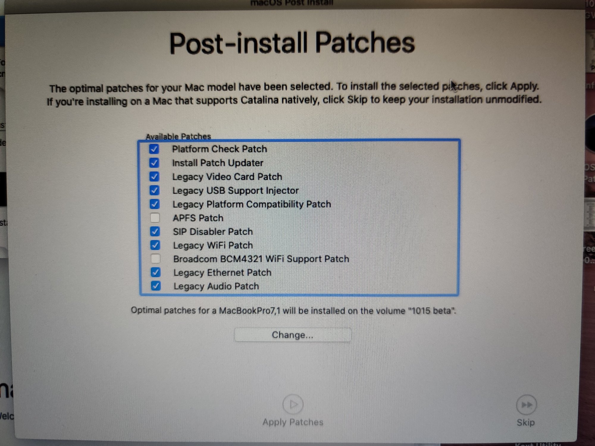

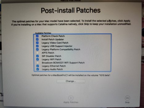

Just a reminder for anyone here using these cards with Catalina, do not allow the post installer to install any Legacy wifi kexts. You're hurting your chances of these cards working properly.

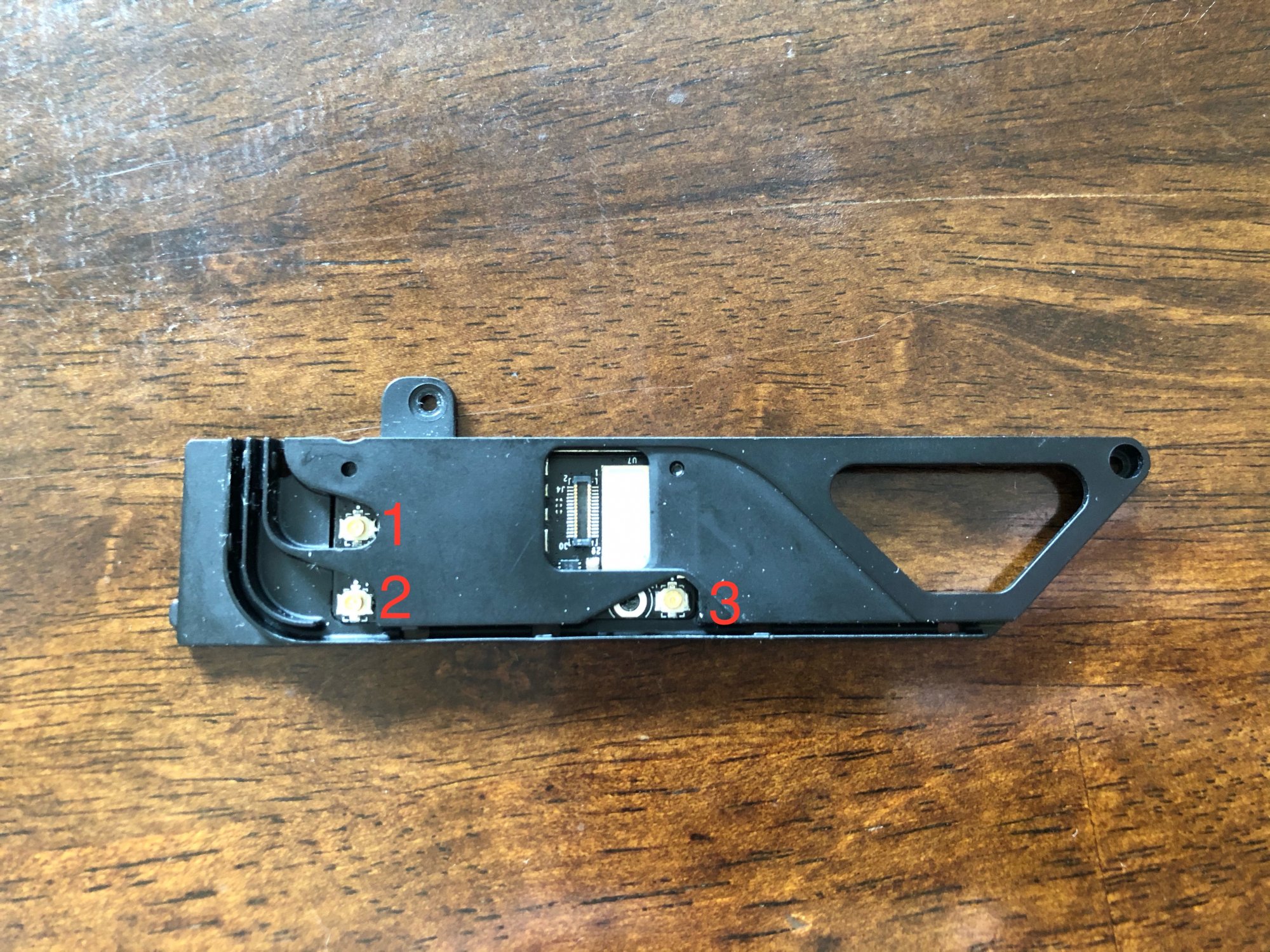

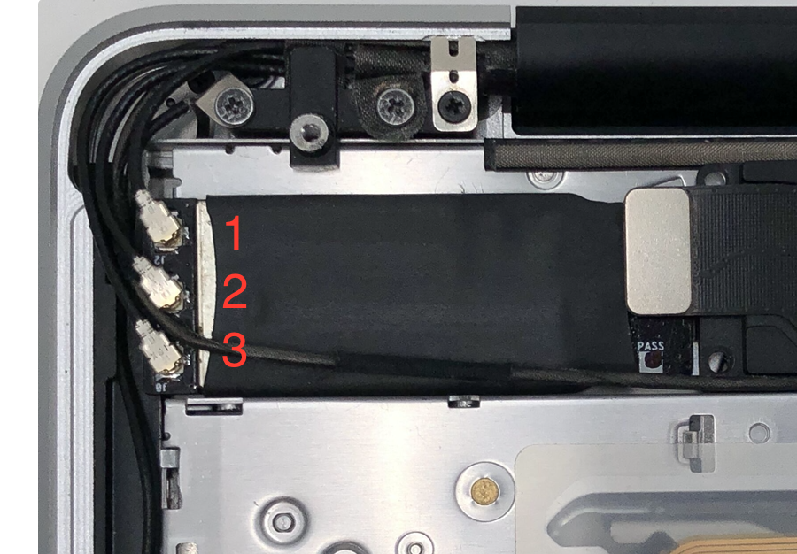

So, let me ask this... Did I re-connect the wires correclty?

So, let me ask this... Did I re-connect the wires correclty? View attachment 974941
Wire order doesn’t matter technically speaking.
