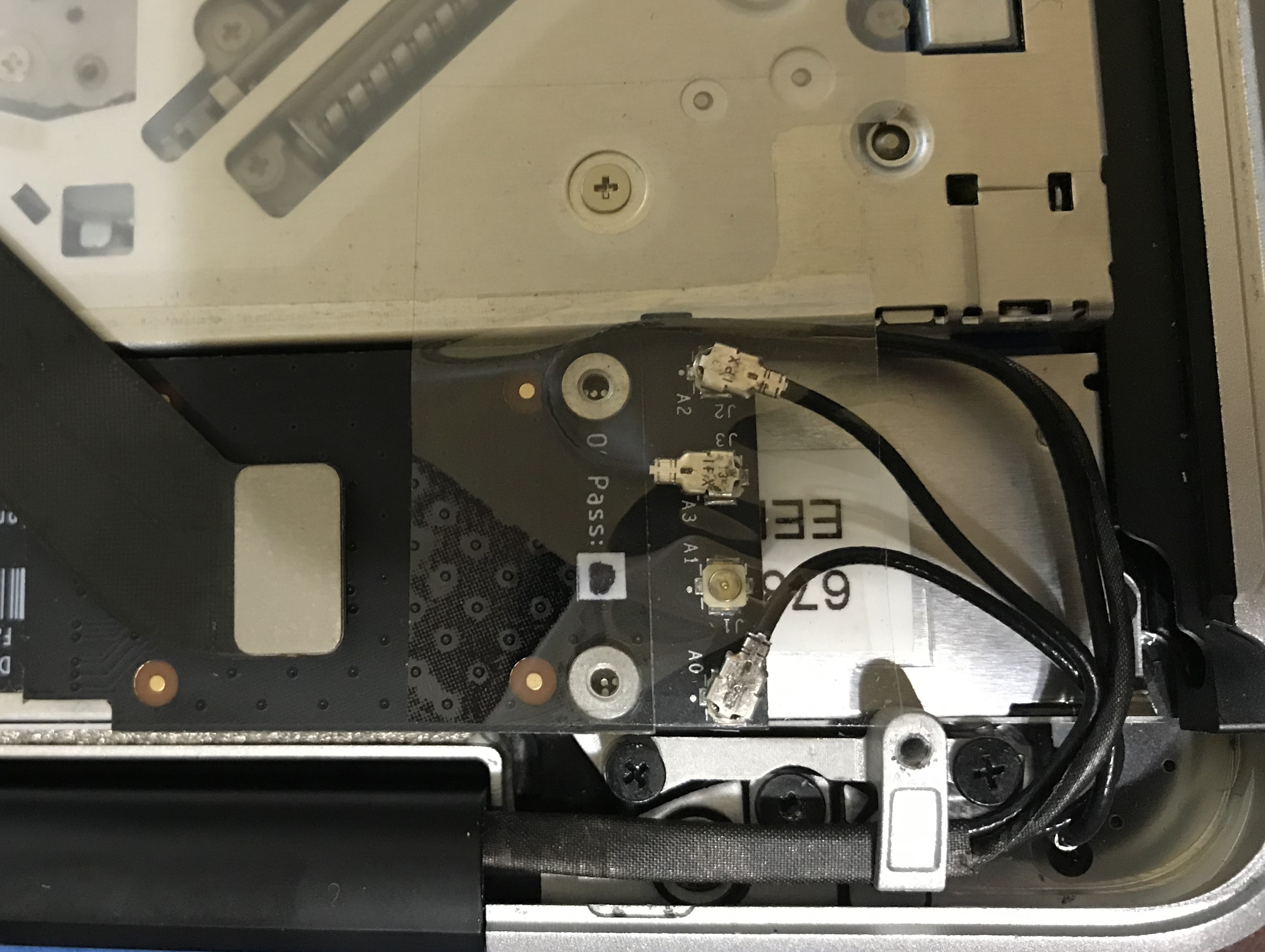

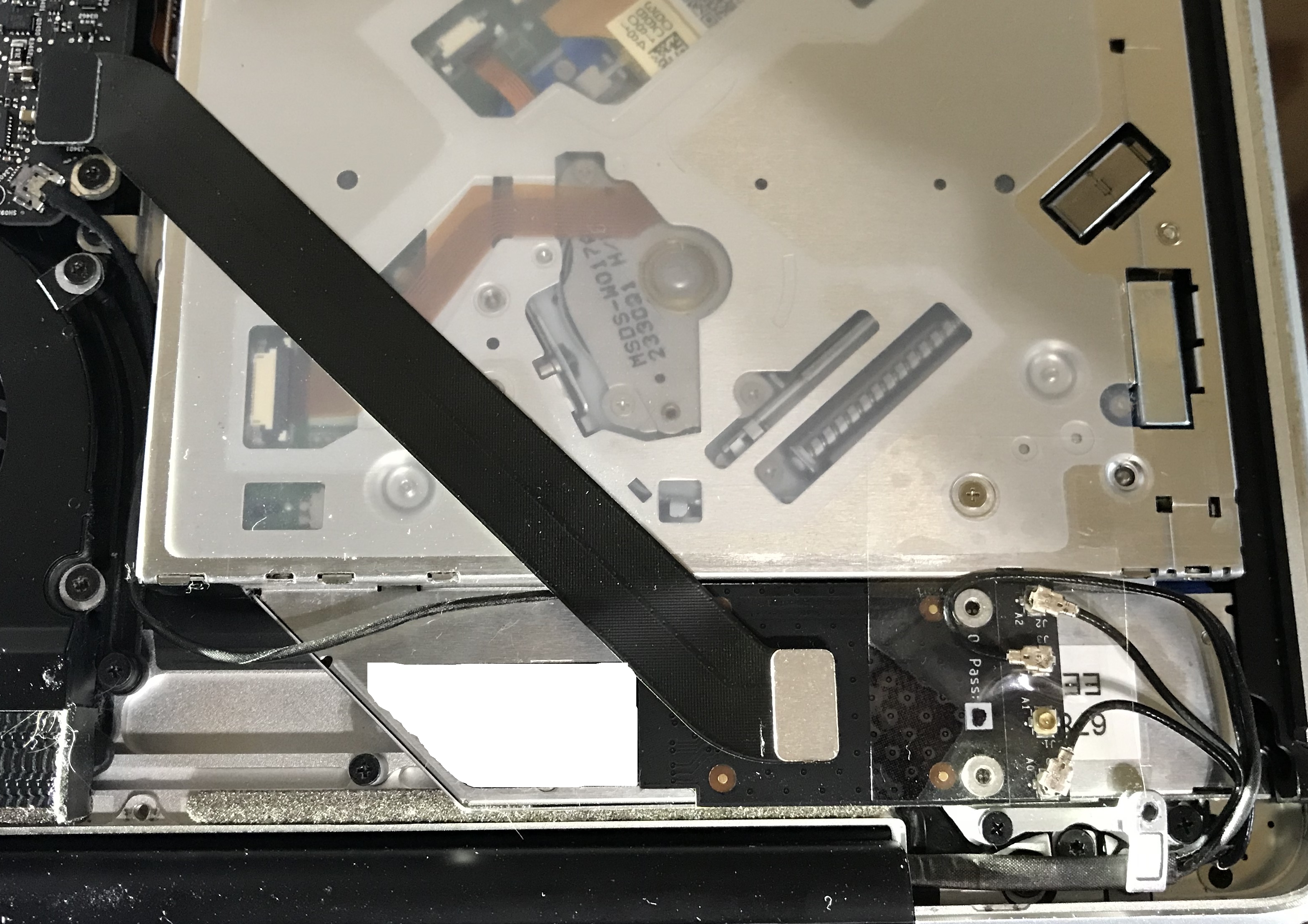

Did you happen to take any photos? It would help me and other 17" owners.
Sure - here are 2 photos. Plenty of room inside the 17" for the install.
@flehman The flex cable looks great and doesn't appear to be under any stress; it looks like I placed the flat flex connector in the right spot on the PCB :)
Reactions: mbosse
All I did was connect the flex cable to the logic board and card and then let it lay where it needed to along the edge of the optical drive. Then stuck it down in that spot.
I should also note that even with just 2 WiFi antennas connected to J0 and J2 everything comes up green. AC WiFi, Bluetooth 4.2, Handoff/Continuity, and Airdrop are firing on all cylinders.

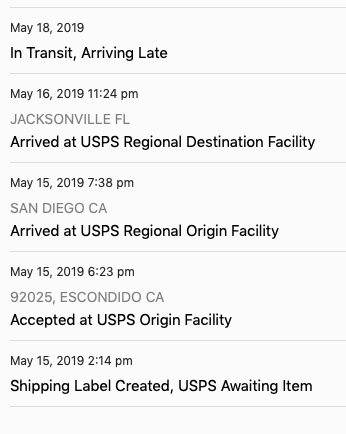

We are having issues with our local USPS processing center lately, so we are asking people here if they would be okay if we switch our shipping provider to UPS. The downside is that the cost will increase a bit and delivery times may be an extra day or two.
Browsing reddit, other people have had issues with USPS the past year and it's going downhill. The 'In Transit, Arriving Late' statuses are very frustrating to all of us.
Reactions: ScreenSavers
UPS is fine. I got your email and it looks like my order is MIA due to USPS ineptitude. Have In Transit arriving late.
My first card made it all the way around the US before finally ending up in FL. Thank you @troop231 for using such durable cases to package these cards.
No. USPS is fine with me. I just wanted to make sure I wasn't causing problems on your end if I ordered.
Unfortunately, if I continue to use USPS, I have to ship some buyers two cards due to the terrible service of USPS as of late, and they return the first one that shows up a few weeks later. That affects my inventory for other buyers.
I just enabled UPS.
