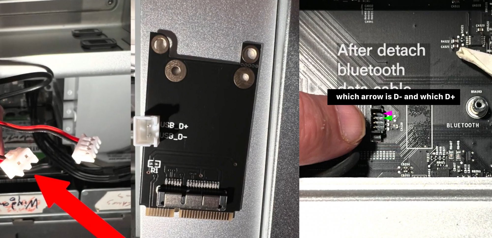

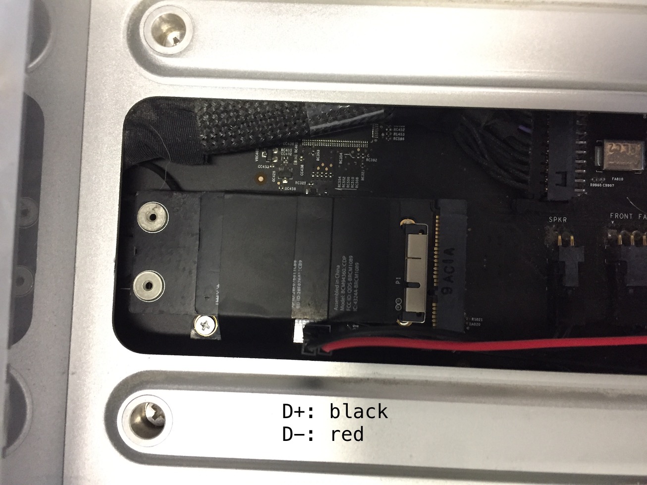

We have had a bit of trouble doing this upgrade in that very guide seems to have different parts to the one we have. And nothing seems to match. But all the cards have a D+ and a D-. Just no-one seems to specific what connects to which pin and often they conflict if we judge by wire colours - which often seem arbitrary??
We have installed as we thought we should but have Wifi good but no BT.

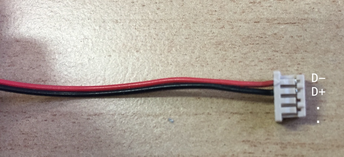

The only variable I can see is in the connection that goes between the adapter card and the connectors next to the original bluetooth card (removed).
On the adapter they are marked D+ and D-
Which pin on the other side do these correspond to? ie The upper one is D+ and the next down is D-? or vice versa? I assume from all the vids and pics the bottom two pins are left untoched.
See attachment - is magenta arrow pin ("top")connected to D+ or D- on the adapter card?
And one more q - what changes to Opencore config (and kexts if needed) are needed to make BT work in Monetery (if any?) Wifi worked without modification to my current config so maybe its the issue above that is the problem.
Thanks
Post 740 has all the answers.

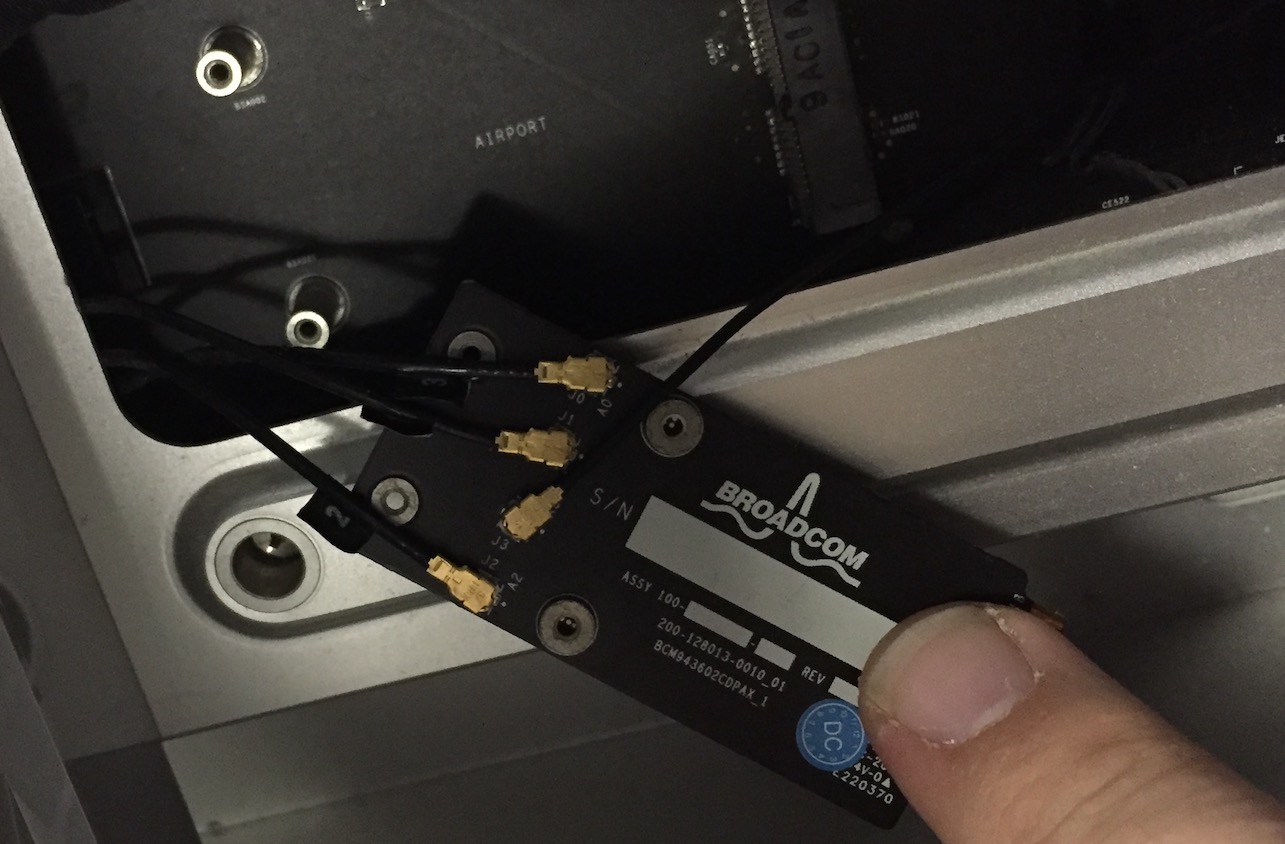

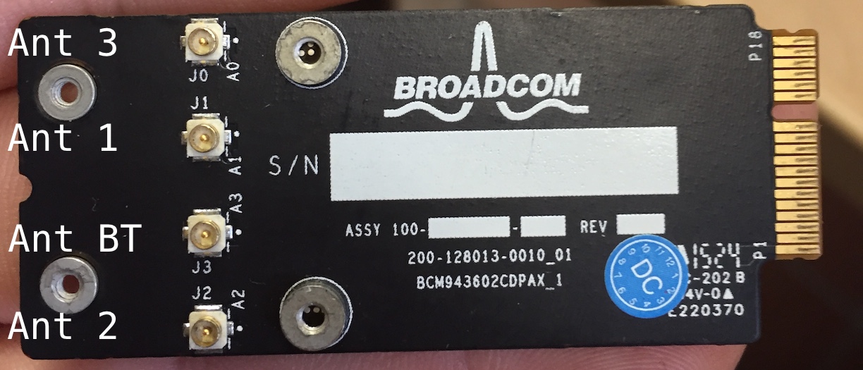

  • the three internal antennas are fine for 802.11ac, but a 4th antenna is needed for Bluetooth
  • the stock bluetooth chip is connected via USB and uses another internal antenna
  • there are about 20cm / 8 inch distance from the Bluetooth connector to the mPCIe socket

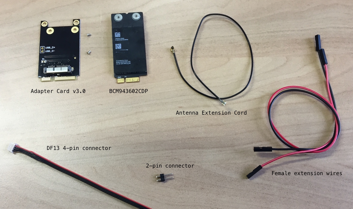

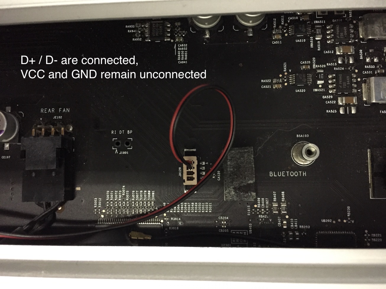

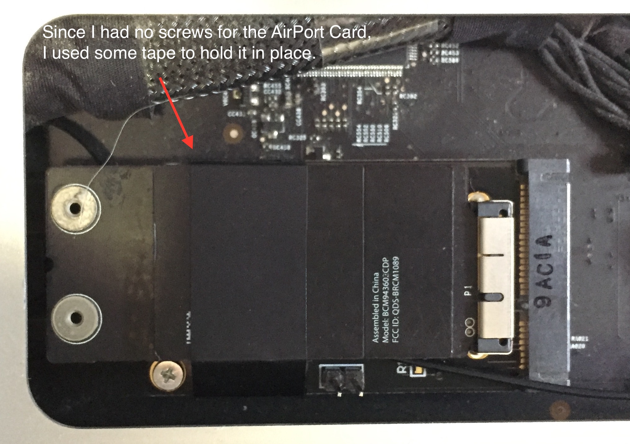

General plan (similarly used by the kits out there):
  • install a Apple Wifi/Bluetooth Card using an mPCIe -> Apple proprietary adapter

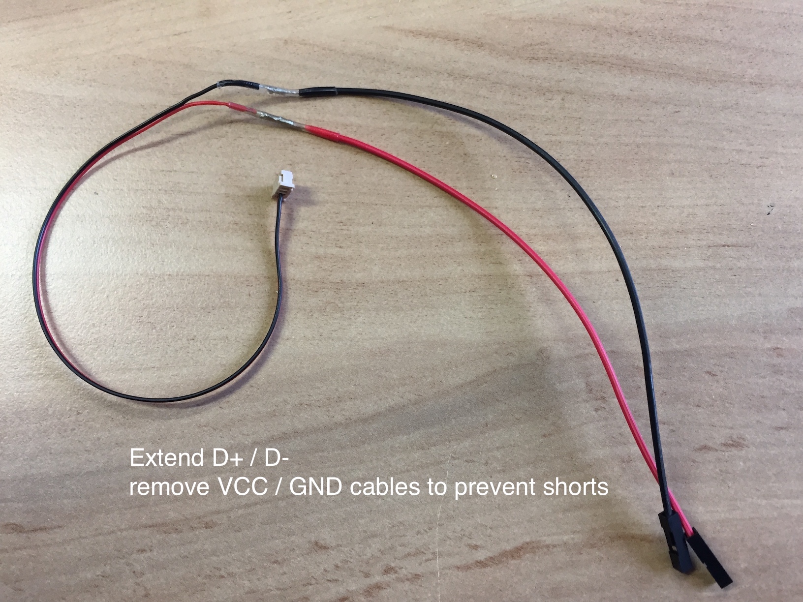

  • inject USB D+/D- lanes from the old Bluetooth connector to mPCIe adapter
  • extend the Bluetooth antenna to reach the mPCIe socket
As the general plan seems to be pretty easy, the details are a little bit more complicated. To get the right parts, all the connectors need to be known in detail:
  • the stock Bluetooth card uses a proprietary cable, which is not widely available. However the connector on the Logic board is 1.25mm hole-to-hole distance, and uses a Micro JST 1.25 4-Pin connector
  • all antennas use U.FL (aka. IPEX, IPAX, IPX, AMC, MHF, UMCC) connectors

      • BCM94360CS: MacPro Retina 15'' (Late 2015), MIMO 3x3, BT4.0 (shared antenna), MHF4 connectors
      • BCM94360CS2: MacBook Air (Mid 2013), MIMO 2x2, BT4.0, MHF4 connectors

Final Assembly:
So in total I spent 49.34$ for full 802.11ac and Bluetooth 4.2 in my cMP 4,1.
I'd like to encourage you you do this upgrade in the same manner. The only thing that didn't go well in the first place was the wrong DF13 connector, the rest is pretty straight forward.
I hope this summary helps some of you.

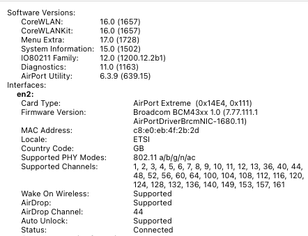

Ive have finally got my new airport card installed and working wifi and bluetooth. However I seem unable to connect to my iphone or ipad. No problem connecting to mice and keyboards. Is there something else I need to do to connect this cMP to airdrop?
When you say unable to connect can you be a little more specific? Is it just AirDrop?
If you instigate an AirDrop session from your iPhone to the Mac or vice versa does anything happen at all?

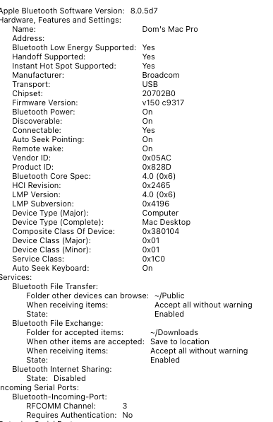

And have you checked About this Mac/System Report//Bluetooth to see if;
Bluetooth Low Energy Supported:
Handoff Supported:
Instant Hot Spot Supported:
HCI Version: 4.0 (0x6)
LMP Version: 4.0 (0x6)
And further down does it give a list of what devices are paired, Configured etc?
I have a whole heap of devices that I have not connected myself that are either paired or configured such as; keyboard, trackpad, Apple TV's, iPad, Macs, Watch, iPhone, etc.

For routing the internal BT module to USB 2.0 connector on the back:
For installing a small USB 2.0 hub between internal BT module and internal USB 1.1 connector:
There are more threads/posts with info on the above, these two might help you get started.

Hi, posted this in the wrong thread earlier and can't delete, sorry!
I wonder if anyone has had similar issues to me?
Running Big Sur 11.7 via OC 8.0. Have upgraded the internal wifi with the suggested BCM94360CD card via adapter.
Initially had the BT data red/black wires the wrong way round, no bluetooth. Schoolboy error! Hoping I hadn't fried the module, I swapped the wires and everything reports in System Information as expected? See attached. Bluetooth/Wifi options available in Preferences.
Airdrop and Handoff refuse to work. Have done all the usual tricks, turning off WiFi/BT on both iPhone and Mac. Setting Airdrop to Everyone etc. Turning off Handoff in SysPrefs>General and restarting. Logged out of iCloud.
Once in a blue moon my iPhone will show up in an Airdrop window in the Mac Pro's finder. When it does I can send from the Mac to the iPhone. The iPhone usually disappears from the Mac shortly after. On the rare occasion the Mac shows up on the iPhone it gets stuck at "waiting" if I try to send from phone to Mac.
Have tried turning the Firewall completely off and same deal, the phone appears randomly and rarely.
If I bring a MacBook next to the iPhone and Mac Pro here's what happens. They're all on the same wifi network.
Mac Pro – shows iPhone and MacBook in Airdrop window.
MacBook – shows iPhone only in Airdrop window
iPhone – shows MacBook Pro only when trying to Airdrop a file.
MacBook and iPhone can send and receive from each other.
Mac Pro can only send to the other two.
All I can think is that I somehow half-fried the BT part of the card when I plugged the data in the wrong way and now it thinks it works but actually doesn't.
Wifi works fine. iPhone can't see Mac Pro in Bluetooth Devices and the Mac Pro can't see the iPhone in Bluetooth preferences when it's set to discoverable in the other direction...
Thinking I should just buy another wifi/BT card to test. Possibly a loose cable/antennae (will check)?
