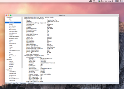

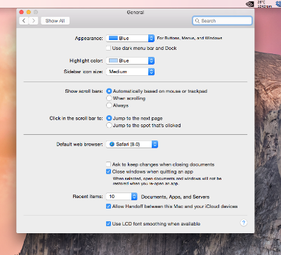

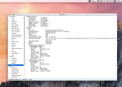

MVC option arrives, installed and all is well...
seems like forever for the adapter to clear customs but eventually the MVC solution to prolonging the usability for the cMP arrived, just installed and working as intended. really quick install, no issues at all, the thing that took the longest was trying to plug the power supply for the card into were the BT was originally sourcing its power from.
let hope apple doesn't lock certain devices by serial numbers as that would be annoying. For me it was worth it as i intend to keep this MP for some time and the new airport extreme card and 4.0LE bluetooth is a bonus.
