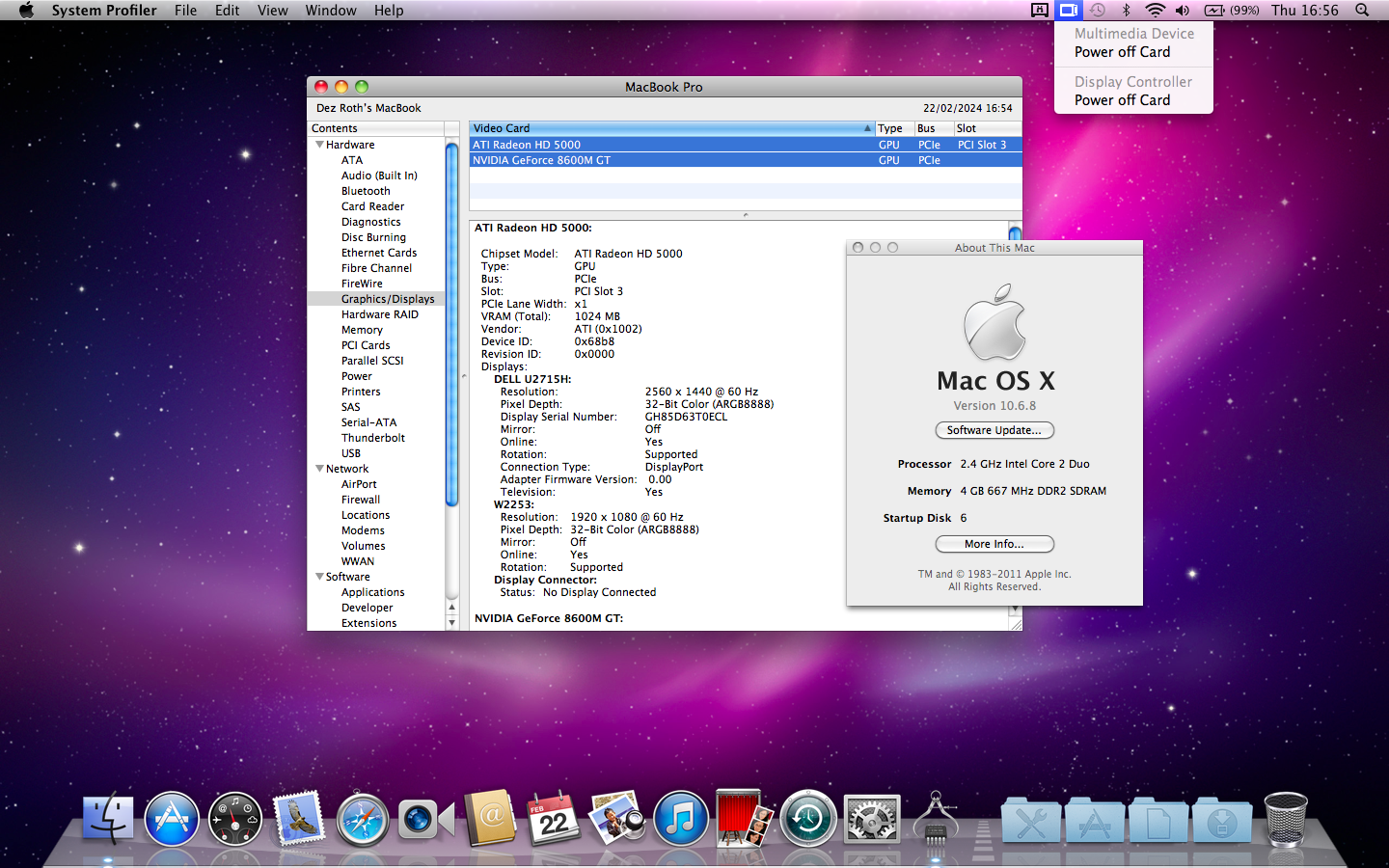

ATI Radeon HD 5770 from a MacPro5,1, wont cold boot the EFI bootROM boot loops, but plugging in at the boot picker it works :)

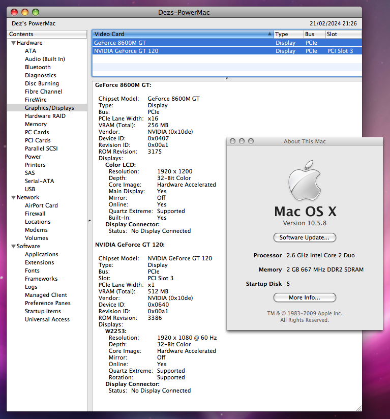

Oh yeah I plan too! hopefully it will load the Option ROM of the GT 120 like the MBP6,1 does :)
pleased to report, yes the MBP3,1 does load the Apple-EFI OptionROM of the GT 120 and thus the card even works in Leopard :)
Ill have to dig out my ATI Radeon 2600 XT and see if that will load its option ROM and if so if it will work in tiger... (I know the card itself does work in tiger, in a Mac Pro)
Been there, done that on a MacBook4,1 so looking forward to seeing your results.
yeah I suspect the crucial difference is you needed ATY-int, so it sounds like the Firmware was not loading the OptionROM of the card?
so I am hoping with the express-card setup, given it loaded the OptionROM of the GT 120 it will do the same with the ATI Radeon 2600 XT and thus work natively :)

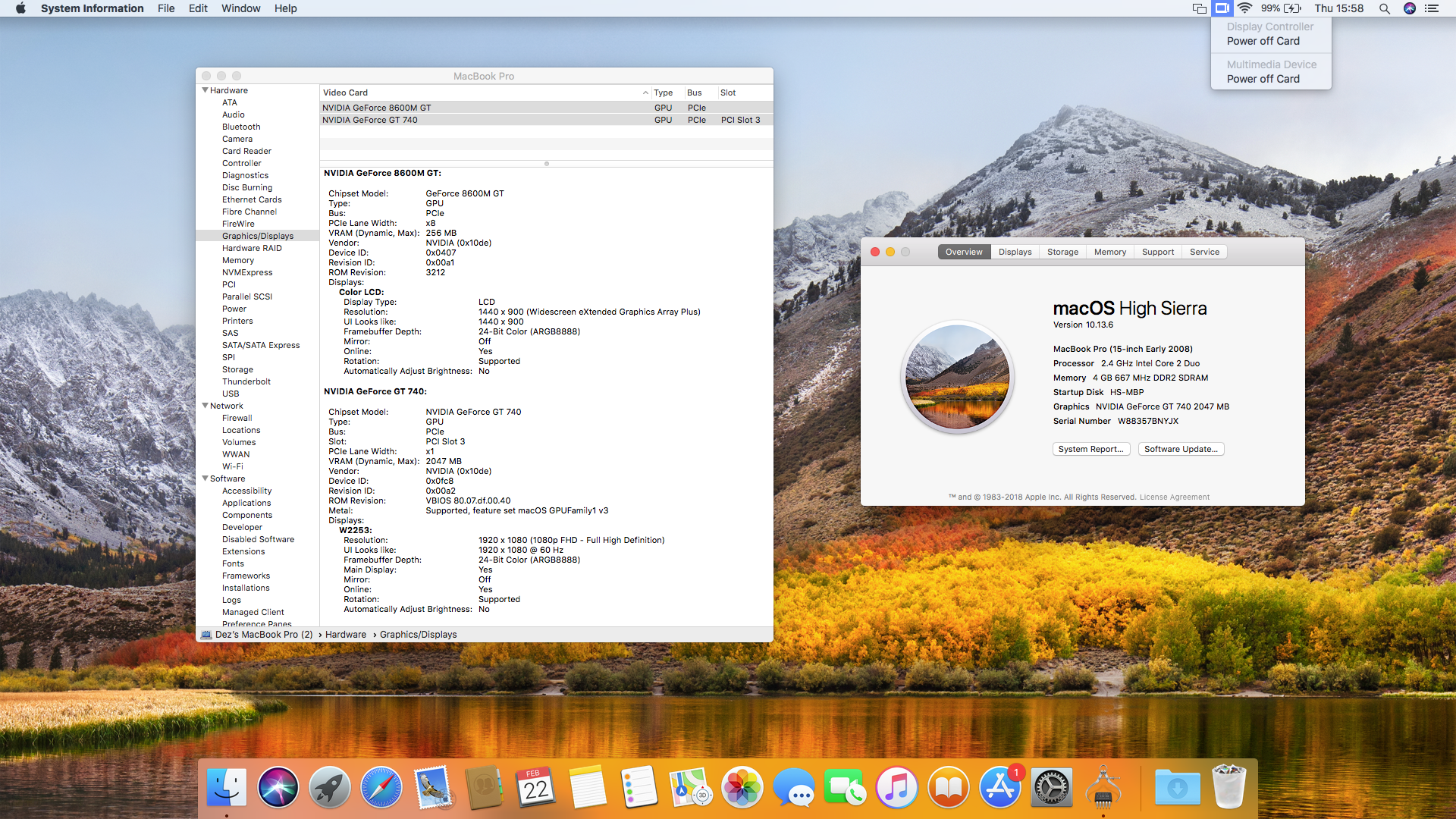

pleased to report the GT 740 does actually work, with my MBP4,1 :), seems for some reason it just wont play ball on the MBP6,1, I can also boot the MBP4,1 with it plugged in from cold which I cant do with the 6,1

pleased to report the GT 740 does actually work, with my MBP4,1 :), seems for some reason it just wont play ball on the MBP6,1, […]

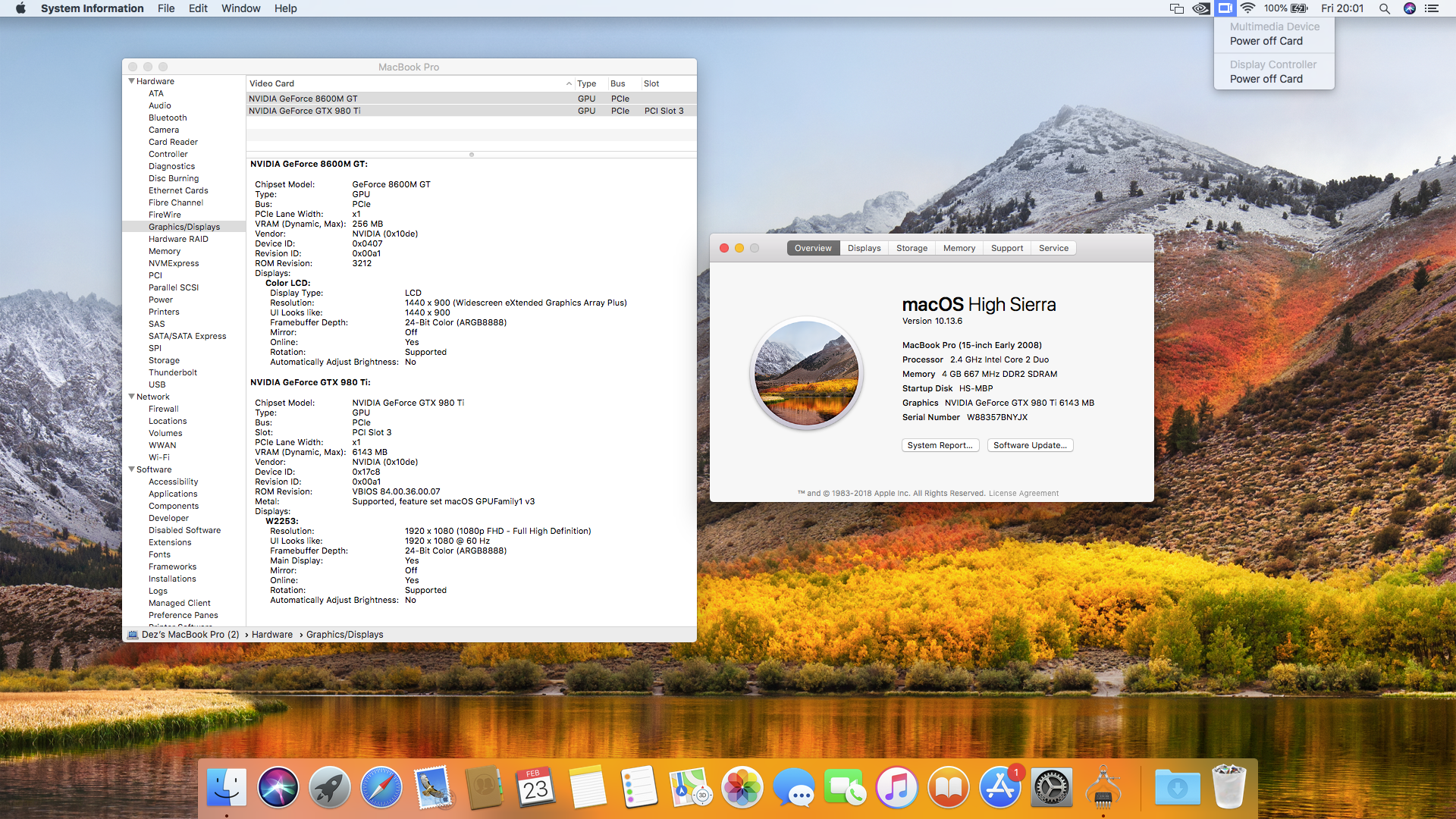

sadly it wont play ball with the MBP6,1, on that system I get the Generic NVIDIA Chip Model 256MB when the drivers cant quite talk/setup the card properly, but as you can see above it does work with the MBP4,1 which is even more overkill :) (the MBP4,1 is happy to boot with it plugged in from cold also)

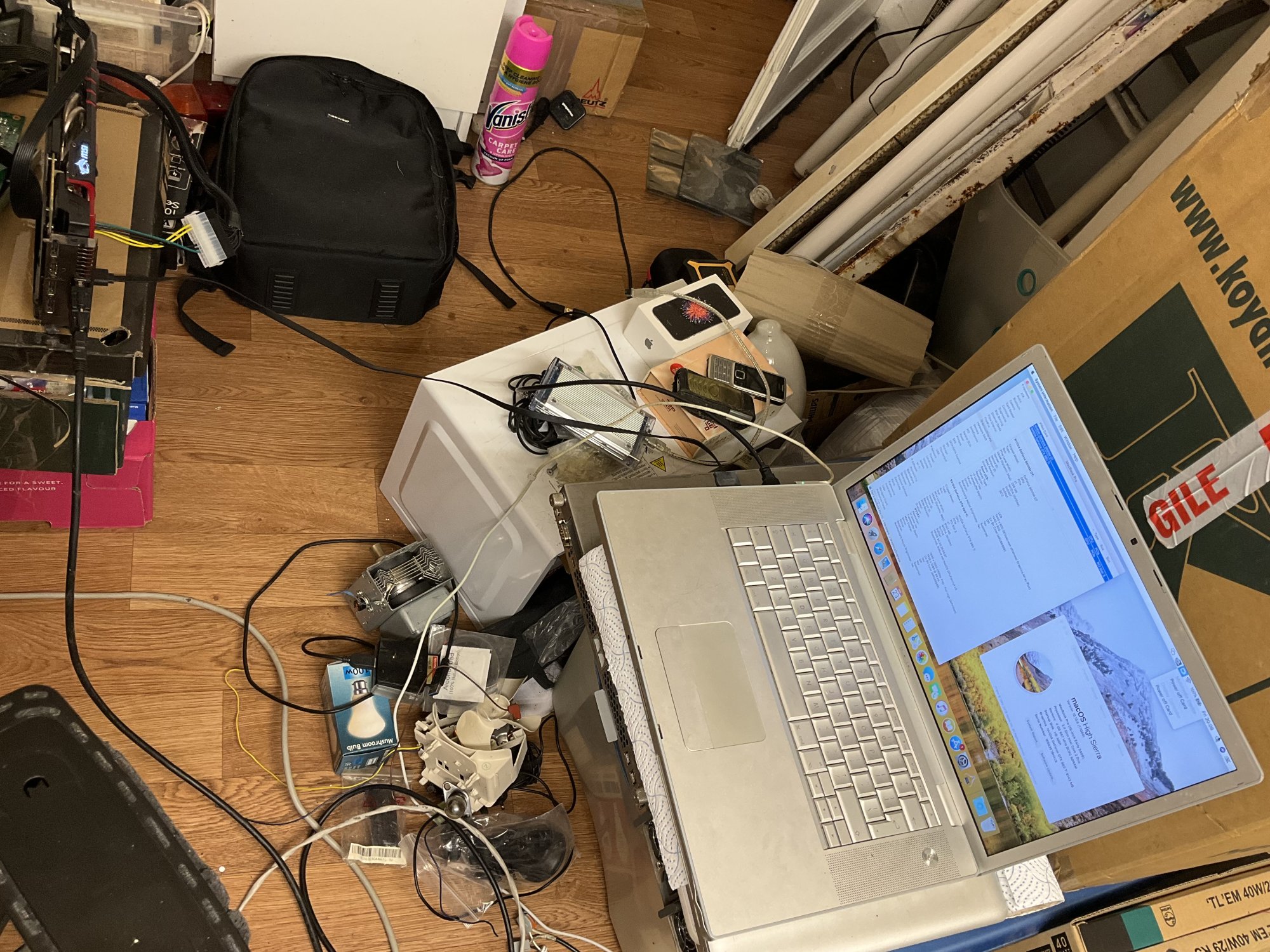

and heres a janky photo showing the physical setup, that yes it really is real! :)

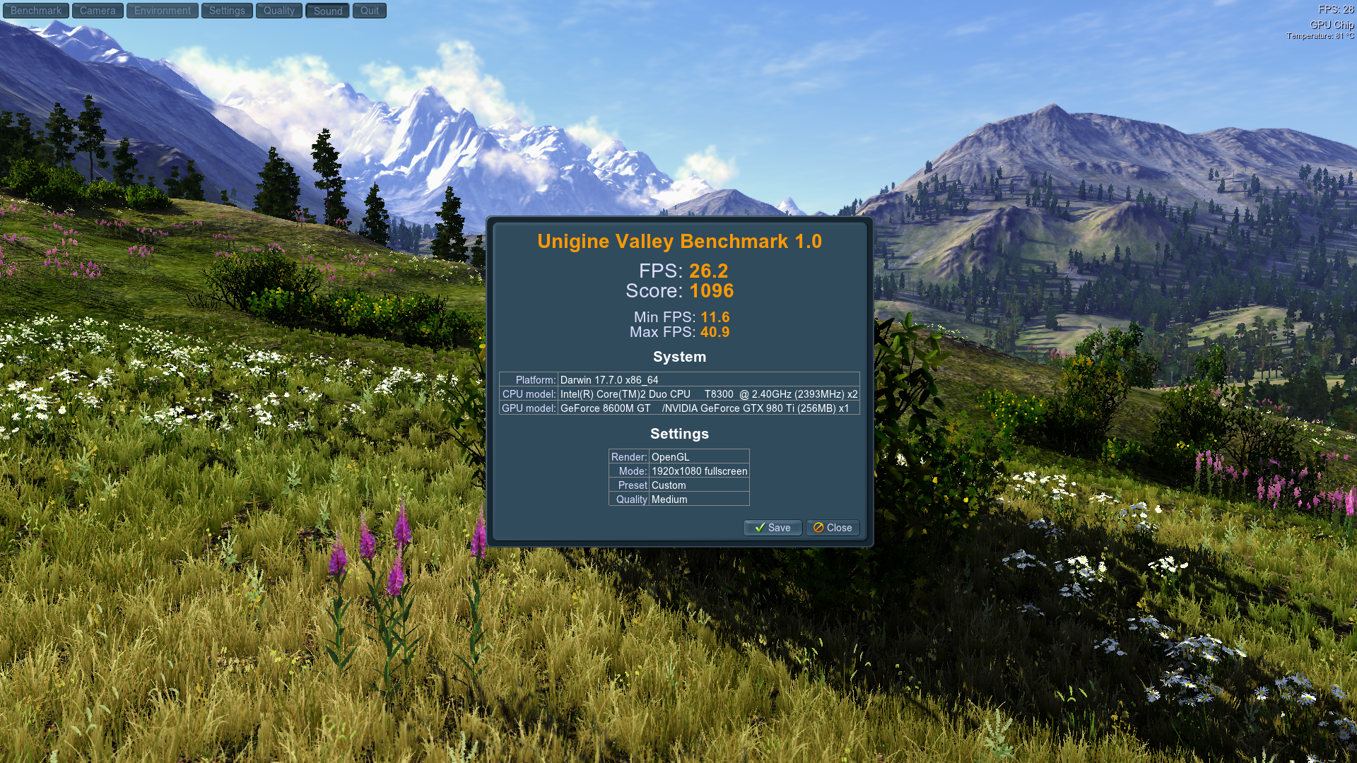

and just for giggles heres a quick Unigine Valley benchmark, its actually a little better then I was expecting, I was expecting it to be totally bottle necked by the PCIe 1x link, but despite that, and despite even the weaker CPU etc of the MBP4,1 the GTX 980 Ti still managed to get a foot up over the 5770 with the MBP6,1

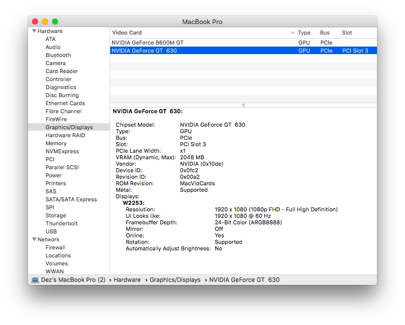

a little while back I fortuitously stumbled across in a CEX one of those the special HP OEM, Dual full size DisplayPort single DVI port NVIDIA GeForce GT 630 cards for which MVC made a ROM for, so I quickly grabbed it, and got that flashed and and I currently have it sitting MP3,1, so ill dig it out and chuck it at the eGPU setup :)
might also finally give me the motivation to get my GT 640 flashed properly (I got it flashed but with an older MVC firmware so some of its display outputs are bit non-functional, but I know I have a later firmware that I have been meaning to try, I got said GT 640 primarily for that Xserve you can see hiding in the setup shot a few posts above :) which it is currently hiding inside of )
both the GT 630 and GT 640 are 2GB VRAM modern resource hungry cards, so should prove a good test for the MBP3,1/4,1 firmware
IE if the MBP3,1/4,1 can handle one of those then i'd feel more confident about it being able to handle a 1.5GB Quadro FX5600
then again im not 100% what the crack is, the 2600 XT is only a 256MB VRAM card but the MBP6,1 rejects it still
as an aside note on the GT 630, when MVC made the ROM for that and set the display name for the card he put NVIDIA GeForce GT 630" note the double space and it bugs the ever loving crap out of me LOL
I really want to fix it and remove that double space but I am not sure how to edit the display name of a Mac NVIDIA card in ROM....
(ok I think the forum is being too smart for its own good and not allowing a double space LOL every time I try and add one between GT and 630 it just reverts back to single space)
well im pleased to report the MBP4,1 can load MVC's GT 630 Mac ROM
and note the double space in the name that bugs the crap out of me so much LOL
weirdly the card wont auto-int at all, in that if I hot plug it, its just not seen at all go figure (as i was trying to show it without the double space, when a card is auto-int'ed the driver sets the name to be displayed rather then the ROM)
but the important thing is it does work cold booted so, hopefully fingers crossed a Quadro FX 5600 would as well once suitably flashed

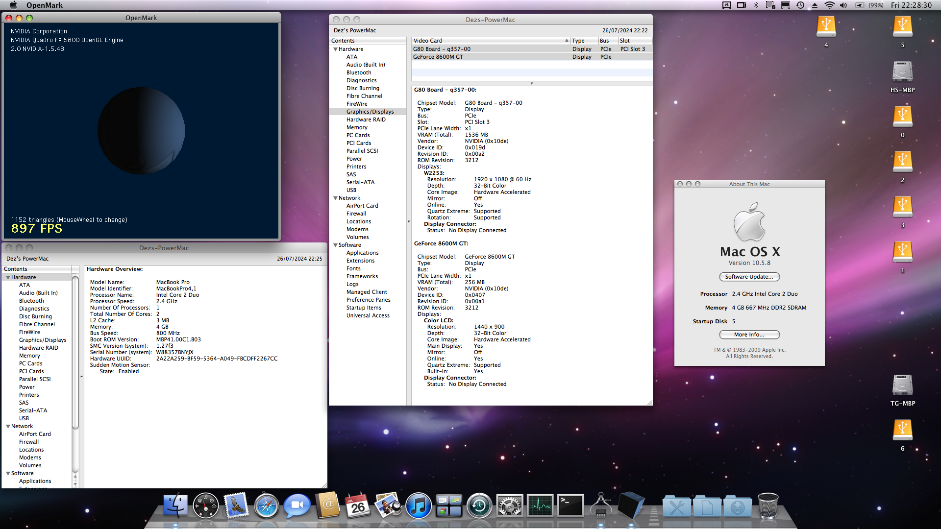

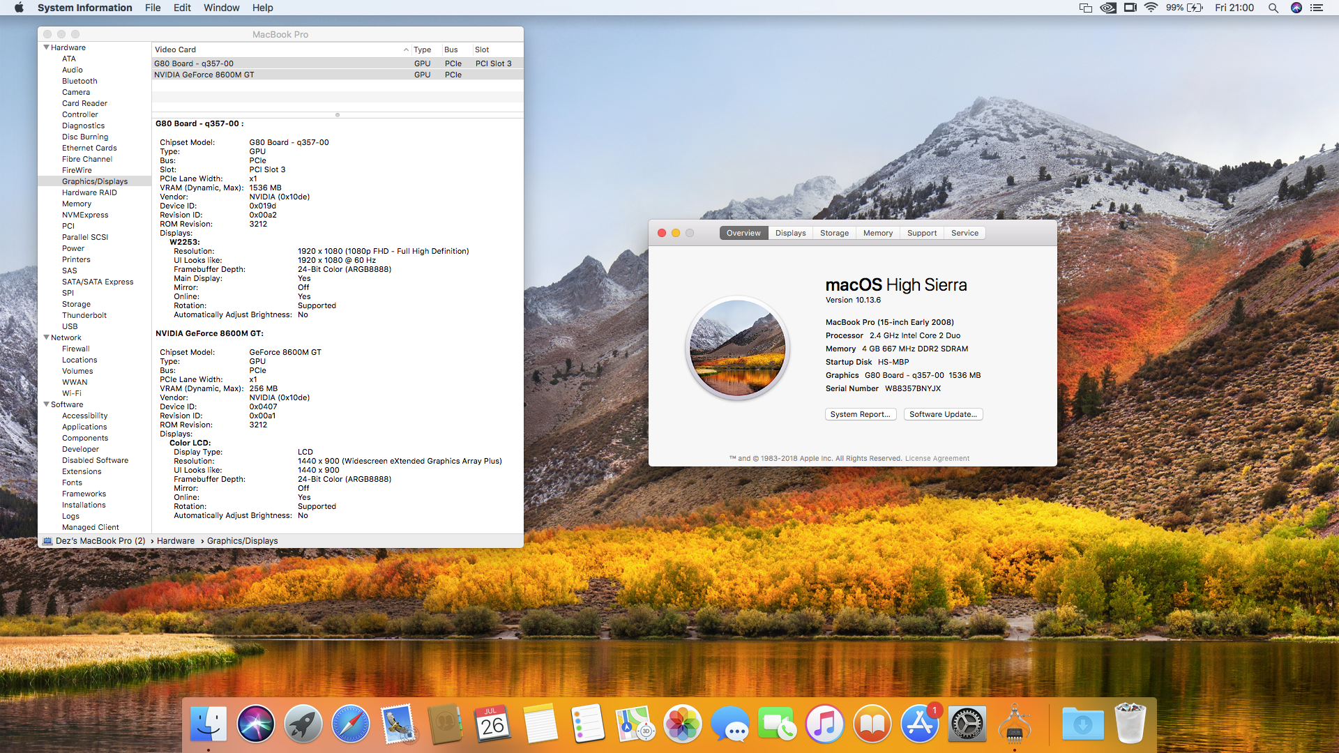

well this is quite interesting not what I expected at all, I just recived today a Quadro FX 5600 I picked up off eBay for reletively cheap, big old beast of a card! and I have just chucked in the MBP4,1 through the express card eGPU setup and booting it up I get this in High Sierra!
it shows up as a G80 Board - q357-00 of all things! and look at the ROM revision its the same as the built in GeForce 8600M GT ROM revision, this to me (and the way GPU fan spins down after the chime) has me thinking very strongly that the card is being initialised by some sort of OptionROM built into the MBP4,1's own BootROM
in the same way you can put a PC unflashed GeForce 2MX or ATI Rage Pro into a Sawtooth or G3 beige respectively and they will work natively because the cards piggyback off the ROM's built into the BootROM
im just really surprised a MBP4,1 of all things has a Quadro FX 5600 compatible OptionROM built into it! and its the first time I have seen such piggy-backing happen on an intel Mac like this I think, sadly as is Tiger kernel panics when booting, ill have to try flash the card with the actual Mac OptionROM and see if the situation changes at all :) (and also try my MBP3,1 see how that acts)

alright I can indeed confirm the Quadro FX 5600 is most certainly being enabled by the MBP4,1 itself, as seen here it works just fine in Leopard (and Snow Leopard) and this is notable because leopard especially requires the card be initialised at a firmware level, IE Leopard cannot self int a PC unfleshed un-initialised card like say High sierra can, so this tells me that indeed the MBP is what is populating all the properties of the Quadro FX 5600, giving it its weird display name etc, I have to wonder what other G80 or G8x Tesla cards this would work with? sadly my only other such card a G86 based 8500 GT up and died a while back
Just tried my MBP3,1 who's GeForce 8600M GT ROM revision is 3175, and very curiously, with the FX 5600 plugged in with the system off and then I push the power button, (ie a cold boot with it already plugged in) chimes but never finishes POST, it obviously is trying to do something with the FX 5600, failing and falling over
plugging it in at the boot picker letting the OS boot up (where I can happily see it in system profiler un-initialised) and doing a warm reboot, still results in the same low level hang as the MBP firmware does then try and initialise the card and fall on its face doing so
it will be interesting once I flash this to the Proper Mac firmware and see how if any behaviours change at all, but before that I want to try it in my MacPro3,1 unlashed just out of sheer curiosity now, and ill be saving the ROM off this card just incase I have ended up with something weird/special
one interesting thing I notice about it when plugged un-initialised it shows up as with the Device ID 0190 which is that of a 8800 GTS/GTX and interesting (im guessing thats softstrap vs hardstrap thing) and it shows up as a 3D controller, which I think is a first, im pretty sure all previous un-flashed cards have just shown up as VGA Controller, but maybe I mistaken there!
