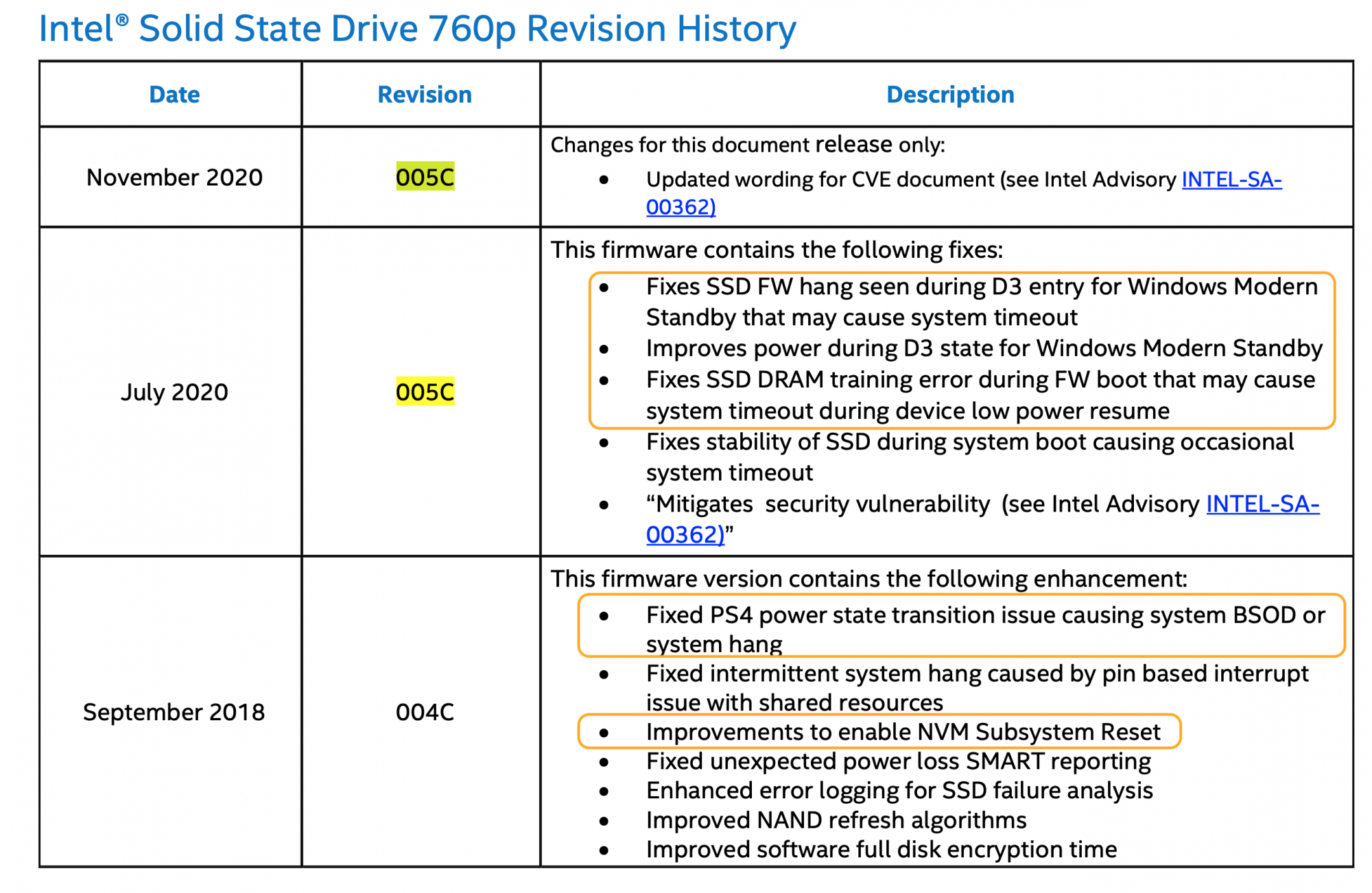

760P latest firmware (660P also) has some very interesting changes. Could this indicate proper compatibility without any terminal commands/disabling suspend to ram?

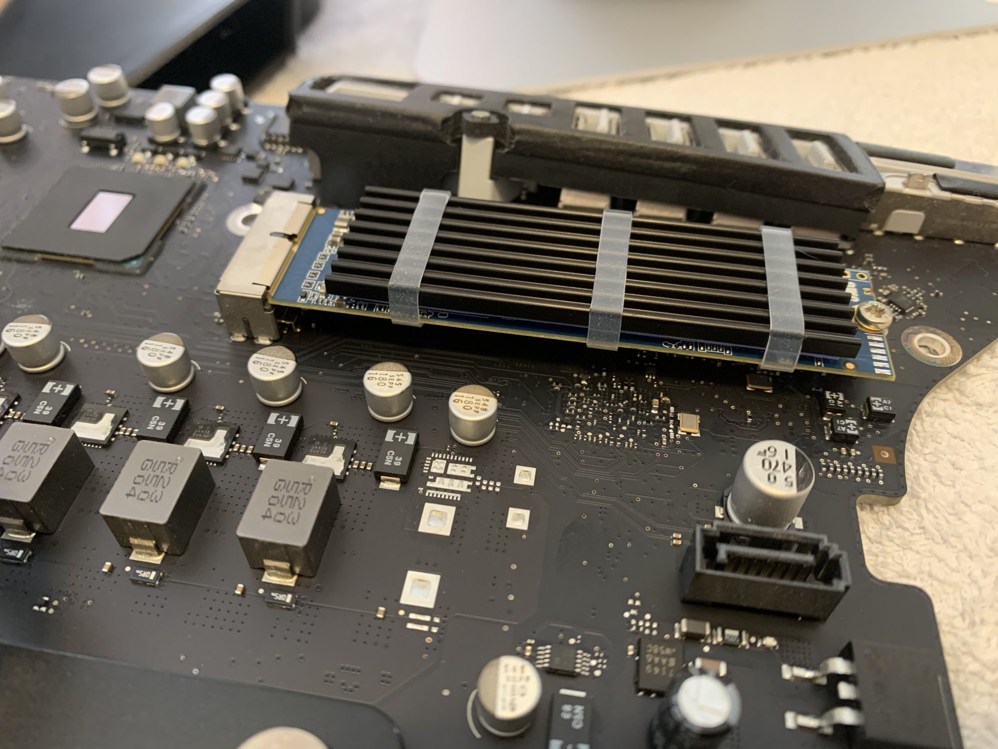

Device: iMac 27” 5K - Late 2015 - 17.1 - (3.2Ghz i5-6500, HDD only)
Location: Sweden, Europe
Blade upgrade: none -> 1TB OWC Aura Pro X2 PCIe NVMe SSD
HDD to SSD upgrade: 1TB original Seagate SATA HDD -> 1TB 2.5” WD Blue SATA SSD
CPU upgrade: no upgrade
Speed test NVMe SSD: ~3000 MB/s read, ~2550 MB/s write
Speed test SATA SSD: ~510 MB/s read, ~400 MB/s write
OS before: Catalina 10.15.7
OS after: Big Sur 11.2.3
Adapter: No adapter needed with the OWC blade
Heatsink for blade: Glotrends NVMe heatsink
Mounting bracket 3.5” to 2.5”: Corsair Dual Solid-State Drive Mounting Bracket
Adhesive strips for the screen: iFixit
Temperature sensor: not required
Boot-ROM before upgrade: 428.x.x.x (never got stuck on 170.x.x.x most likely due to the iMac never being shipped with a blade SSD)
Boot-ROM after upgrade: 429.80.1.0.0
TRIM: Enabled by default for the OWC (didn't expect that..), but not for the SATA SSD (expected)
Issues during install:
1. Since the iMac wasn’t shipped with a blade from factory it had no screw to secure the blade. Naively I thought I would have one in my rather big stash of different bits and bobs - but no sir. Luckily I was able to source one similar locally, after calling around to at least 4 different shops that handle electronics. For anyone wondering, the original Apple Part Number is 923-0336. It’s a M2,5x3,0 (mm) with a big flat head.
2. I'd forgot that I needed a long T10 screwdriver to reach the one screw in the middle of the logic board. Had to go get one from work.
3. The 2.5” SSD had to be mounted in the top slot on the dual bracket due to cable management. Managed to route the SATA cable through the back of the adapter to line everything up.
Issues after installation:
None, sleep and everything works.

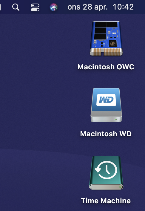

Yes, I kept them separate. There is no reason to combine them as one with Fusion Drive since that is going to give you MUCH slower performance. Fusion Drive is to combine a blade SSD with a mechanical HDD. If you combine a blade SSD with a SATA SSD you're going to get the SATA SSD's speed overall.
If you're installing a blade SSD, and a SATA SSD, that separately has less storage then your old HDD I would do a clean install on the blade and then use Migration Assistant to move the data from your Time Machine backup post install.
Thoughts and questions:
- I had originally planned on installing a 1TB WD Black SN750 with the Sintech ST-NGFF2013C, but I got a really really good deal on an OWC Aura Pro X2 so I changed my mind in the last minute. I’ll use the WD blade in an enclosure with my iPad Pro instead, or throw it in my unRAID server.
- Since the heatsink was bought with intent to use with the adapter (needed to be thin), perhaps it could’ve been larger. But I don’t think it’ll be an issue. Didn’t use the metal springs to attach the heatsink to the blade, only used the silicone bands. Felt like I would risk shorting the blade if I used the metal ones, time will tell if the silicone will hold up.
- The iMac 17.1 isn’t (!) one of the supported Macs for the OWC Aura Pro X2 according to OWC but from what I can understand that’s probably due to an EFI issue with these models. See this thread for more info:
https://forums.macrumors.com/thread...te-2015-efi-firmware-update-failures.2228324/ Since I have no issues with EFI I thought I’d give it a chance. So far no problem and I don’t expect any either. My theory is that OWC and others don’t want to risk problems with 17.1 and therefore skipped support for it. I’ve got the WD blade and the adapter if issues occur.
- I've found different sources saying different things about TRIM being enabled by default for NVMe blades.
Some say it's only automatically enabled for Apples own blades, some say its enabled for all NVMe by default, some say all 3rd party SSDs (NVMe and SATA) never have TRIM enabled by default..
Well, my OWC was enabled. Thats good. The SATA SSD wasn't, as expected, so I guess I still will have to run the trimforce command. Shouldn't affect the blade in any negative way, right?
