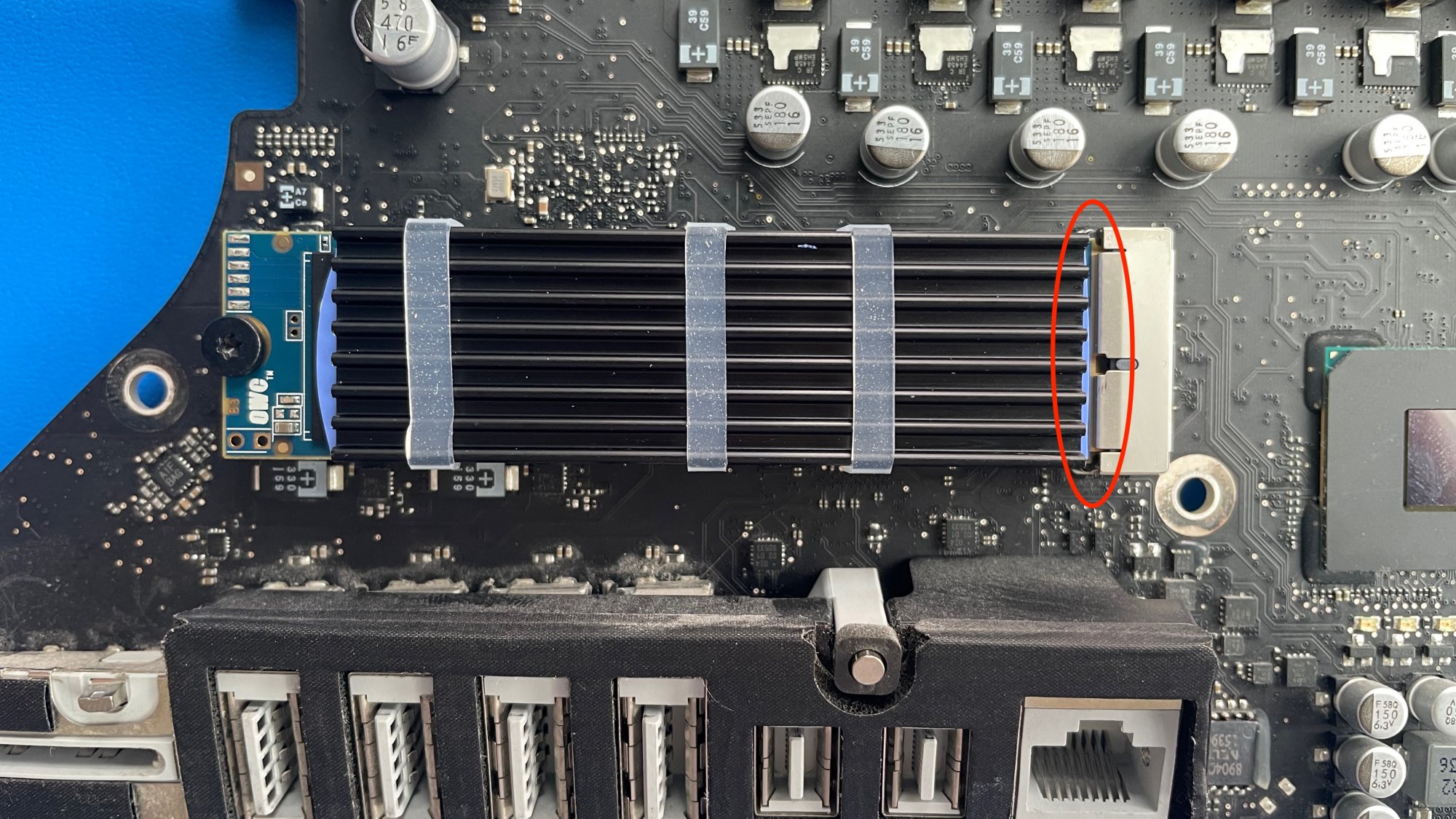

Hi,
New to the forum. Update was successful BUT I am having kernel/sleep issues.
It was second time upgrading by HDD and my first upgrading the NVME.
Device: iMac 27” 5K - Late 2015 - 17.1 - (4.0Ghz i7)
Location: Tokyo, Japan
Blade upgrade: Apple 128 GB SSD -> 1TB Crucial P5 PCIe NVMe SSD
HDD to SSD upgrade: 4TB Seagate SATA HDD -> 1TB 2.5” Crucial MX500
CPU upgrade: no upgrade
Speed test NVMe SSD: ~2900 MB/s read, ~2800 MB/s write
Speed test SATA SSD: ~510 MB/s read, ~400 MB/s write
OS: Big Sur 11.4
Adapter: Sintech (the long one)
Heatsink for blade: Glotrends NVMe heatsink
Temperature sensor: not required
Boot-ROM after upgrade: 429.120.4.0.0
TRIM: Enabled by default for the NVME , but not for the SATA SSD
Details below but first this:
Update: Big Sur 11.4 currently is installing on SSD blade. The problem was an incompatible bootable USB Stick. Stick was doing its work on my old iMac 2011 without issues, but the stick wasn't recognised on Model 2015. Disk Utility from internet recovery didn't see Kingston SSD blade. I made a new bootable usb stick, got the installer and Disk Utility BS sees all drives. I think internet recovery disk utility remains on status "El Capitain"and therefore have problems with modern drives. Thanks for all the advises.
This saved me. I was having the same issue after upgrading so I was freaking out. However, properly doing internet recovery got the NVME to show up and I was successfully installed Big Sur 11.4.
After installation completed (new install with minimal data migration), I left the computer running overnight. In the morning I played with it a bit and there were no issues. However, after walking away from the Mac, I came back to it and the computer failed to wake up from sleep and reboot to a ? folder. This is very weird as I have the new firmware installed.
Any thoughts on how to address this or why this is being caused? For reference, here is the error message I get:
panic(cpu 4 caller 0xffffff8018cce860): nvme: "Fatal error occurred. CSTS=0xffffffff US[1]=0x0 US[0]=0x4 VID=0xffff DID=0xffff
. FW Revision=P4CR324\n"@/System/Volumes/Data/SWE/macOS/BuildRoots/e90674e518/Library/Caches/com.apple.xbs/Sources/IONVMeFamily/IONVMeFamily-557.120.1/Common/IONVMeController.cpp:5499

Hey there, another successful upgrade from Israel:
Blade + CPU upgrade
Device:
Late 2015 - 17.1 - MK462LL/A (3.2Ghz i5-6500, HDD only)
Blade upgrade: none -> 1TB ADATA XPG SX8200 Pro
CPU upgrade: i5-6500 -> i7-6700K
Speed test: 3100 MB/s read, 2300 MB/s write
OS: Big Sur
Location: Israel
Adapter: From Ali Express
Issues with sleep: none
My tip for future upgraders: press firmly on the adapter to insert it into the NVMe slot. I spent several hours trying to figure out why this this isn't working, I even considered upgrading to a regular SSD instead!
The metal prongs of the adapter should fit inside the slot without them showing.
Good luck!
