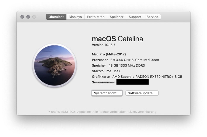

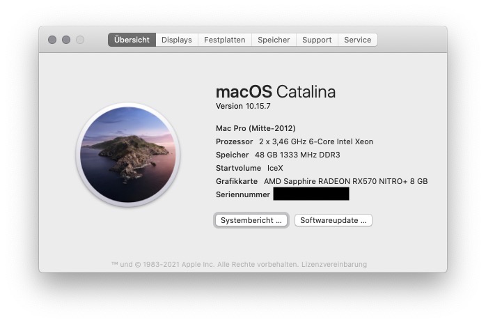

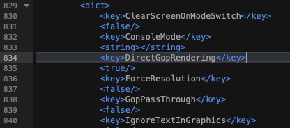

Hi Martin,
thank's again for your work and your package. Wanna let you know something because I am not shure if this feature is only for you (Radeon VII) and should be better set in your package to false:

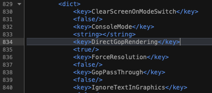

  1. DirectGopRendering
    Type: plist boolean
    Failsafe: false
    Description: Use builtin graphics output protocol renderer for console.
    On certain firmware, such as on the MacPro5,1, this may provide better performance or fix rendering issues. However, this option is not recommended unless there is an obvious benefit as it may result in issues such as slower scrolling.
If I let this feature unmodified (default true in your package) than the console output is really slow. I set this feature to false and the output is much faster.

@h9826790
Hi Martin,
    Type: plist boolean
    Failsafe: false
As you have an RX570 set it to false. Here is a section from page 1 of the OpenCore on the Mac Pro forum by @cdf
"Disable the special GOP renderer if not needed
For maximum compatibility, the sample configuration enables a special GOP renderer to display the boot picker. This option, which is needed for the Radeon VII and some versions of the 5700 XT but not for the RX 580, can cause undesirable effects (such as slow scrolling) and therefore should be disabled if not needed.
  • Find DirectGopRendering and change true to false"
Reactions: h9826790

Hi. Can anyone explain to me what "DirectGopRendering" in the config means? I don't really understand the "GOP" jargon and cannot find any explanation in the manual that makes sense to me. I read somewhere here that for RX580 this should be off (false) but Martin's config has it as true (and he seems to err on the safe side generally).
Check this post: #2,503

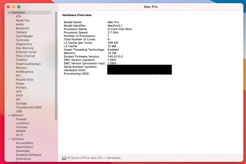

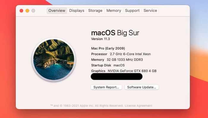

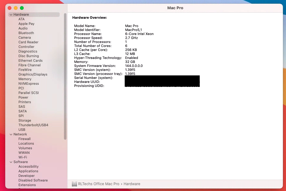

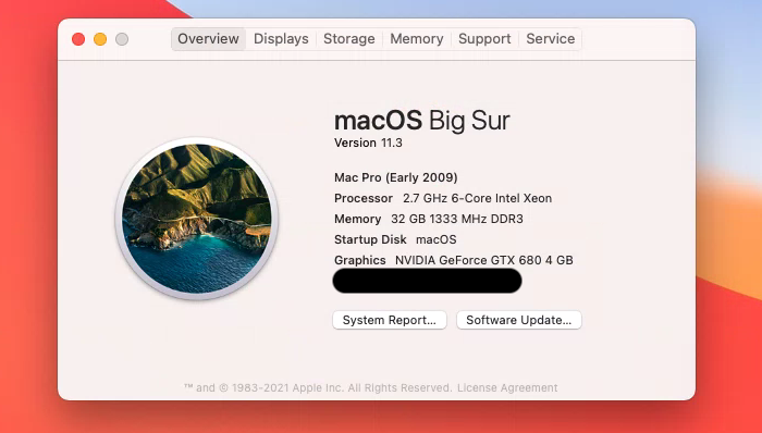

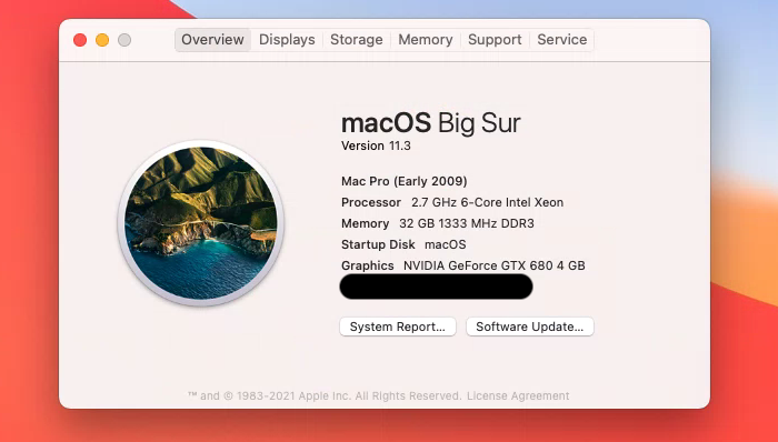

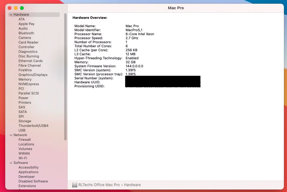

Ok so here I am to throw a wrench into the issues with Big Sur 11.3...
I finally had a lax day at work and got to sit in the air conditioning at the office and figured I'd get some paperwork done. So I went to log into my cMP in my office and first thing I noticed is it was not at the normal Lock Screen, it was at the login screen. Soo I logged in and it wanted to verify my iCloud, first sign of updating. So I hit up one of my employees who said ya while I was out on client sites, all the Mac popped up the update thing so she updated them all. DOH!!! For most machines in the office it is no big deal, however for my cMP and 2010 MacBook Pro no one is supposed to touch them. So I was expecting a terrible day from that point on and was preparing my mind to roll back to 11.2.3 from my time machine.
To my surprise the machine works almost flawlessly. I can reboot without getting the shutdown error at login. It reboots just as fast as before, it is a little bit slower on the shutting down before a reboot, but everything that was working , still is. Including my USB Card in Slot #4.
There are some hardware differences between my home and office cMP. The one at my office is a 2009 cMP with 1 6 core processor. It is flashed to the 5,1 firmware. The other thing is that although I have tons of USB peripherals they are different than at home. They are mostly printers, scanners, and drive docks. I have 3 monitors all 1080P on a GTX 680 4GB which I have never bothered to set up for DRM cause well, it's my office computer -lol.
I am trying to explore this more as I have no clue what the differences are other than the machine year, the vid card and the less RAM in my office machine. Now that being said I have not updated my OC in forever since it is my office machine and has been very stable. I have attached a zip with my EFI files in case someone wants of has the time to explore this.
For my 5,1 at home I had to restore back down to 11.2 because it was too unstable/. However I did create a partition on another drive which I will be installing 11.3 on to start doing some testing with.
Try rebooting at least 30x in a row. Simply click "Restart" from the login screen. If you can get past 30 reboots without issues, your machine might prove useful at some point for testing. My personal record is 22x successful reboots before getting a fail on the 23rd attempt, and I've performed hundreds of reboots on every version of 11.3 from beta 3 through 11.4 beta 3. Conversely, I've had a dozen fails in a row as well. It's that random. Also the place it hangs each time is random - on the same system.

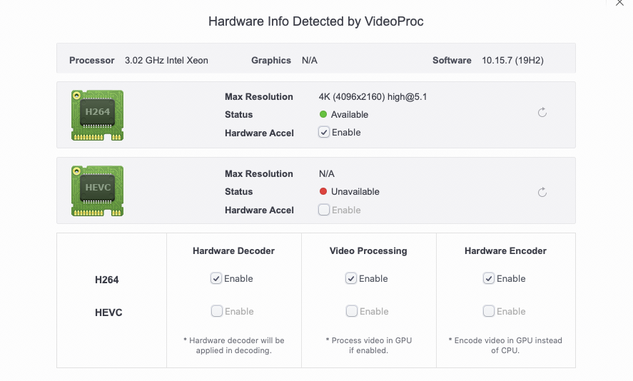

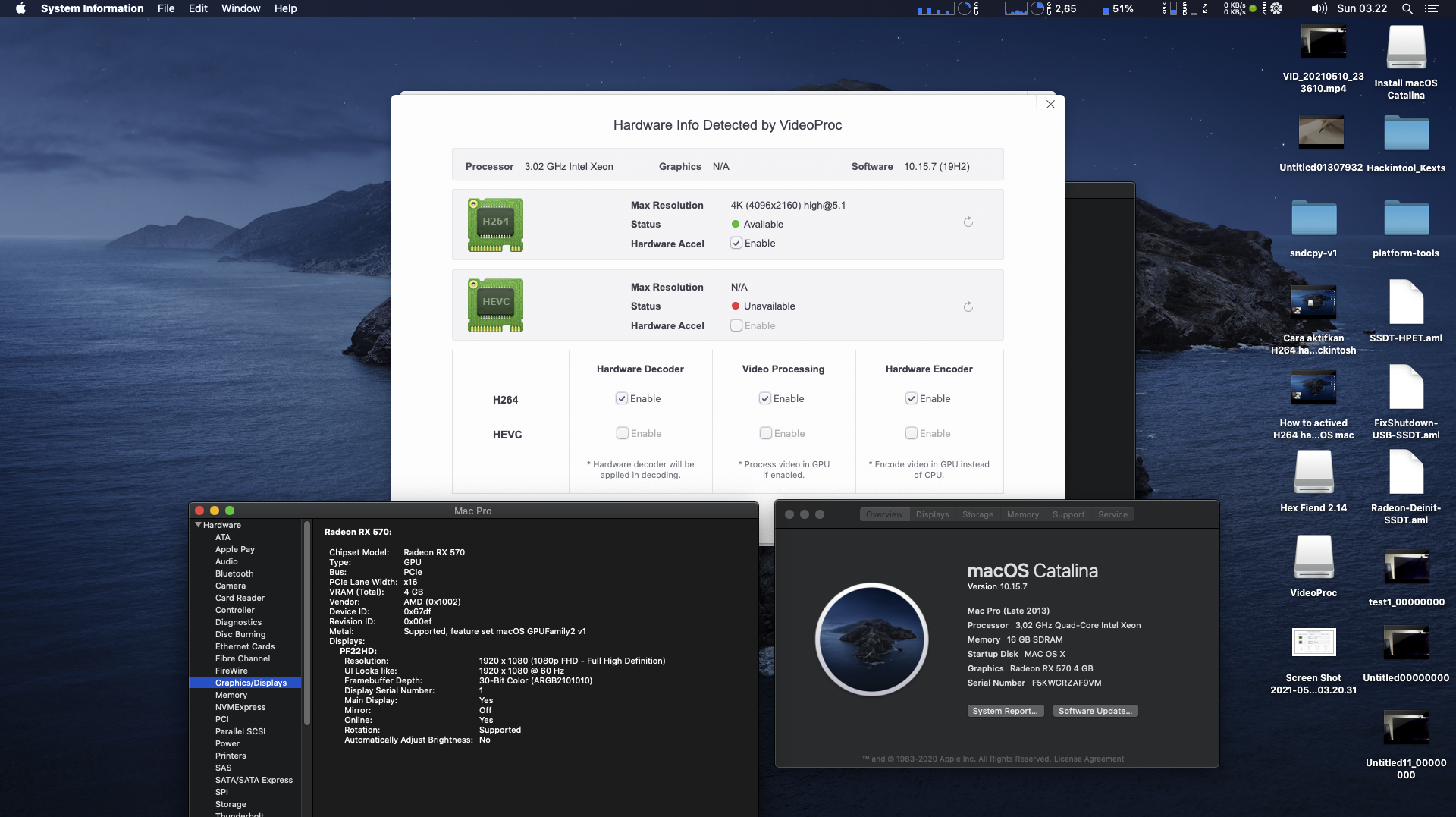

work H264 to catalina 10.15.7 but i haven't a HEVC(h265),
I used the first method, but I have to change the MLB to 7BA5B2D9E42DDD94,
My PC is a legacy PC using Xeon without internal graphics, I am using an eGPU rx570, do I need to use the second method to activate HEVC (H265)

I upgraded my (flashed) 5,1 from Mojave the other day & Big Sur feels sluggish AF. 0.6.9 Clover... I turned SIP off and didn't change, or do anything in the configurator.
Decent 12-core 3.46 machine with 96GB RAM, Radeon 580RX, Evo 860 SSD on PCI card, wired mouse & keyboard. Three monitors – 4K LG & two Dell HDMI. Ran fine on Mojave... I also created another SSD with Catalina. same sluggishness – UI and mouse feel wonky, typing in some apps feels delayed, Chrome feels laggy. Adobe Illustrator is unpleasant to use & Photoshop UI flickers at times. No changes if I use the 4K monitor only.
I have another machine 32GB 6-core SSD 540RX & the computer UI feels much snappier overall. One 27" Cinema Display only.
Ideas or tips anyone?
What do you mean by "Clover" - did you create your own config? Try h9826790's 0.6.9 config: https://forums.macrumors.com/thread...n.2180095/page-53?post=28255048#post-28255048
If still sluggish, try changing DirectGopRendering to false and see if it improves.
