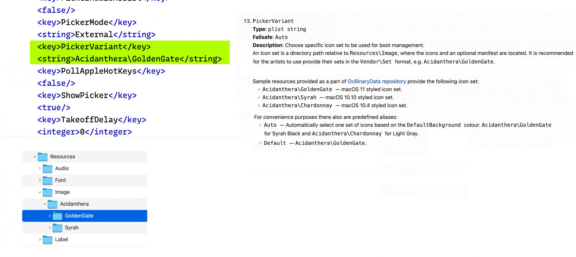

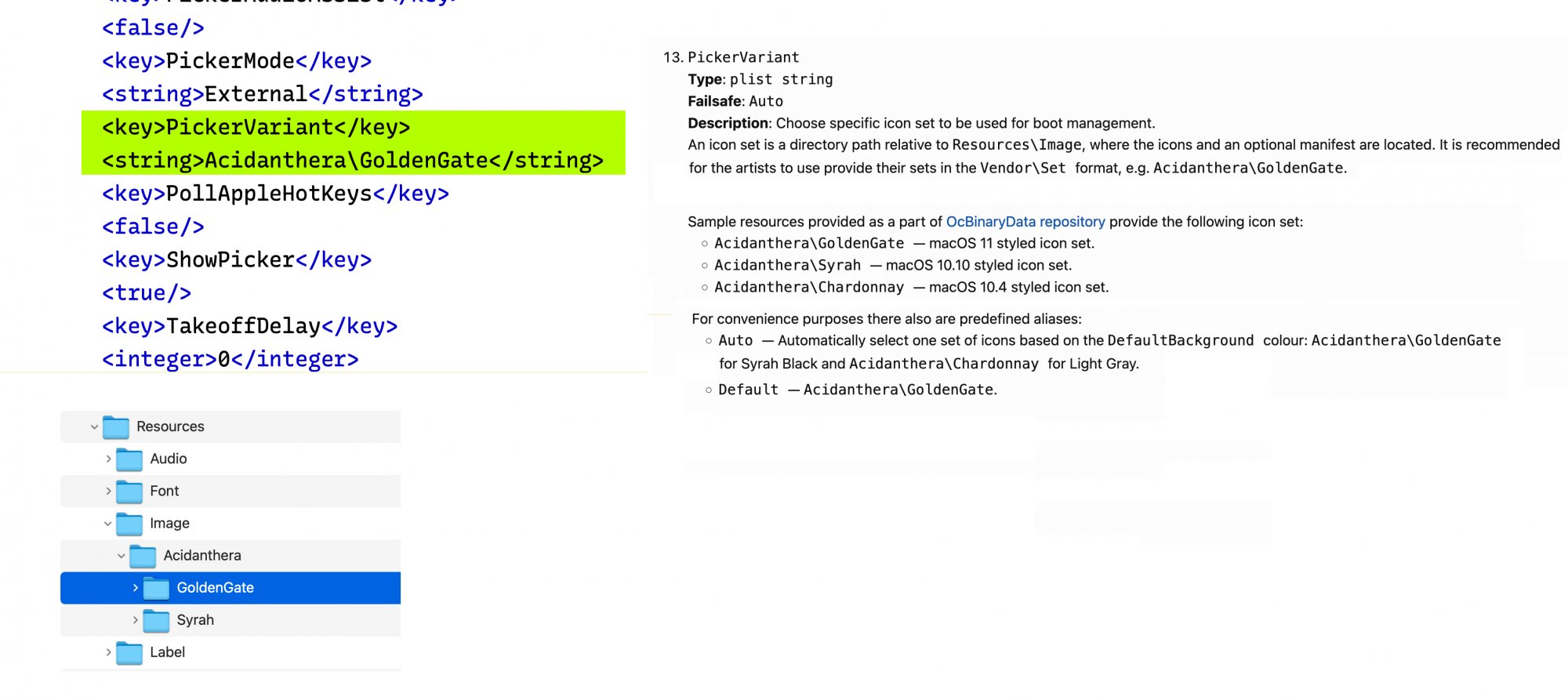

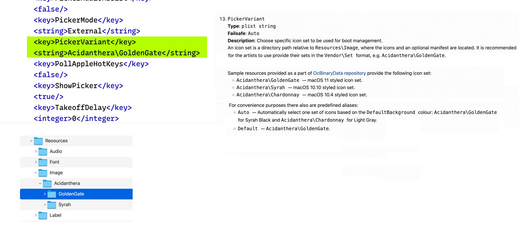

Hello Martin,
thanks a lot for your new Opencore 0.7.0 package. I tried it immediately and everything works as it should - except the BootPicker.
I tried to find out what the problem is but got no result: Only the text BootPicker appears and no graphical one. I am at a loss. I have not yet performed a 3x PRAM reset.
I am grateful for any tip.
P.S.: I check all relevant entrys:
PickerMode - PickerVariant - and if the drivers there and have the correct names.
<string>OpenRuntime.efi</string>
<string>OpenCanopy.efi</string>
<string>CrScreenshotDxe.efi</string>
Reactions: h9826790 and pbsxr
You need to download the new OpenCanopy resources and set the new icon set name in the Info.plist.
As usual, check the dortania post-install guide.
Thank you very much for that hint.
I checked the part of "PickerVariant" at the new Config Documentation and got the new icon resources copy it to the target, delete the old icons and fix the entry of the "PickerVariant" value. Reboot and hold the escape key (my prefered config) and works like a charme.
Reactions: h9826790
Hello Martin,
Thanks for the report and providing the solution.
This is the problem when I have no Mac to test but have to work in blind 😅
I uploaded that 0.7.0 package, but which is for some specific users to test (this is why the post itself still saying 0.6.9 etc).
I will look into it and fix it accordingly. Once again, thanks for helping me to create a better (and functional) package. Cheers!
Reactions: JedNZ

I tried to follow this - installed icon folders in /Image/ and changed the config "PickerVariant" as per screensnap but still get only a text version of the bootpicker. If I set "PickerVariant" to "Default" or "Auto"- same result, also if I changed backslash to regular slash in the pathname.. Can anyone please let me know what I am missing here? Thanks
Try PickerAttributes = 17
Code:
            <key>PickerAttributes</key>
            <integer>17</integer>
            <key>PickerAudioAssist</key>
            <false/>
            <key>PickerMode</key>
            <string>External</string>
            <key>PickerVariant</key>
            <string>Acidanthera\GoldenGate</string>
That's all I have done.
My 0.7.0 package is now avail here
The GUI boot picker should be fixed. You may simply download this latest version and install / update it as per the video guide in post #1314.
Reactions: kkinto

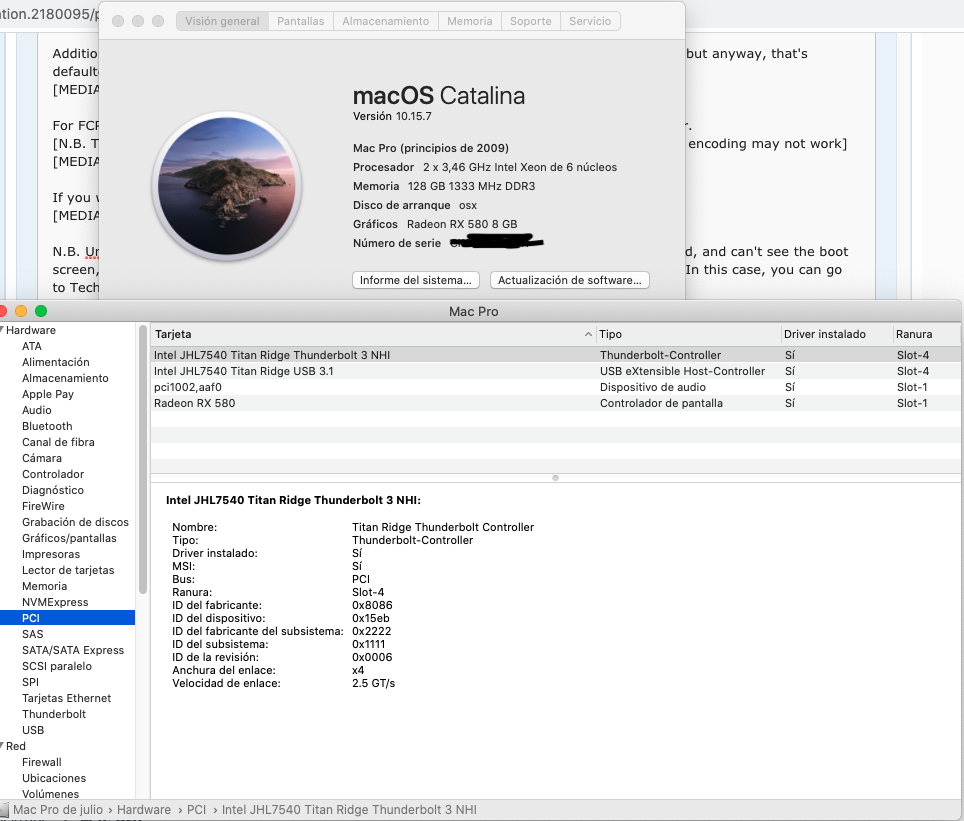

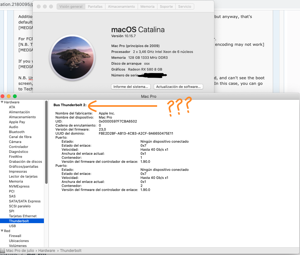

Hello, just one question. First, on this page you talk how configure titan ridge. So my first question is:
¿this is for titan ridge 2.0?
other point, i found this link also: LINK on the part of "Install Files" the config.plist is really different from the link that you upload on forums.macrumors.com, there is a lot of differences.
So i follow this page, and put my card on the 4 slot but my mac pro 5.1 early 2009 with opencore 0.7.0 and Catalina OS, and it doesn't recognize the card (you can see upload image)
I'm using the 0.7.0.zip file and works well up to i put the titan ridge 2 card.
And just to clarify, the titan ridge card is enabled.
Please can you help me? regards
All is here
Follow the instructions
There's a thread on MacRumors too here exclusively for Thunderbolt Cards.
The thread here is only about HW acceleration with an OpenCore mod from Martin.
BTW, I have a Titan Ridge rev2, I flashed it myself, I follow the instructions from the link I gave you but I used an other FW because i need it to make a soundcard to work (Apollo Twin MKII TB). Then I enabled TB in config.plist
