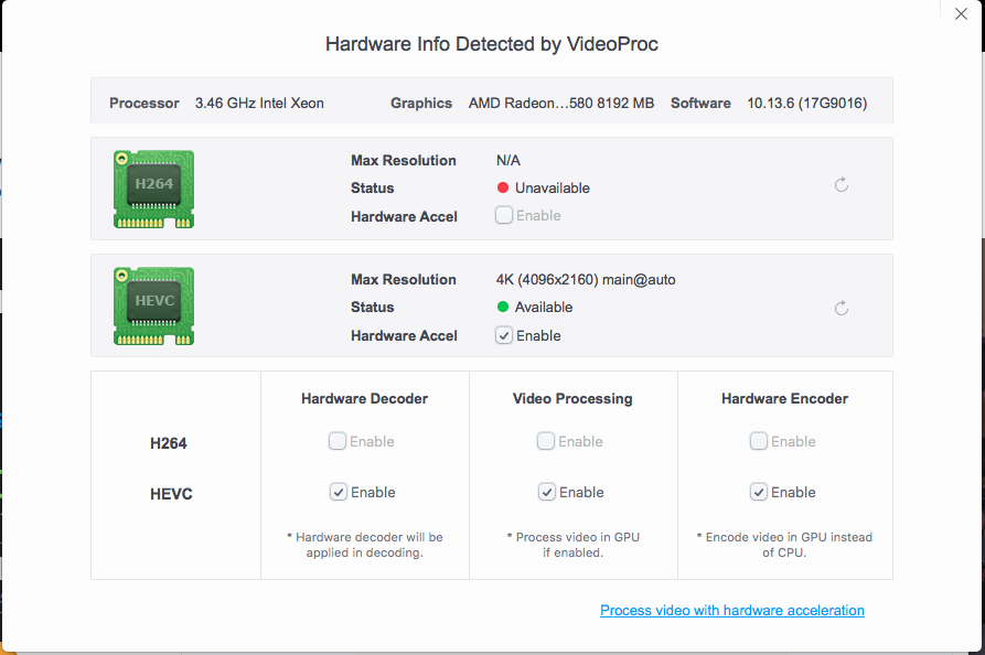

This is funny. Just tested videoproc in HS:

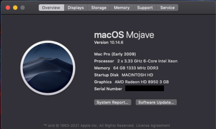

Hello, firstly, thank you all for the amazing work on this project, it was made so simple to install and yields great results! Secondly I am very new to this.
I do have a couple of questions regarding my install instance;
I have a cMP 4,1 -> 5,1 with a SATA SSD (Main OS drive), AMD HD 7950, 64gb RAM and 2 x 3.33ghz (X5680) Xeon's running Mojave. Before the opencore install, I upgraded the firmware to show 5,1 and the firmware is 144.0.0.0.
The HD 7950 is stock firmware I believe (I need to validate this)
At the moment I would like to stay on Mojave, until I am ready to jump to Catalina (in a month or so).
I recently installed OpenCore 0.7.0 from post #1,314 with relative ease with only a handful of inconsistencies.
1) The HD 7950 shows up as a HD 8950 (is this due to the SMBIOS being spoofed to Mac Pro 7.1?)
2) VideoProc shows that hwaccel is not enabled, but my Plex server is definitely using the 7950 for transcoding
3) I do not get the boot screen at all. (I did disable boot picker as I only use MacOS via config `ShowPicker`).
4) I have 4 x 8TB HDD's installed, when performing a warm reboot they don't seem to register in the OS, I have to shut down the Mac and cold start it. (this was an issue prior to OpenCore, I was hoping OC would have resolved this?)
Is there any way I could fix the above inconsistencies?

First AMD GPU that have compression/decompression/conversion hardware acceleration with a Mac Pro is RX460/580, your GPU don't have the ASICs required.
