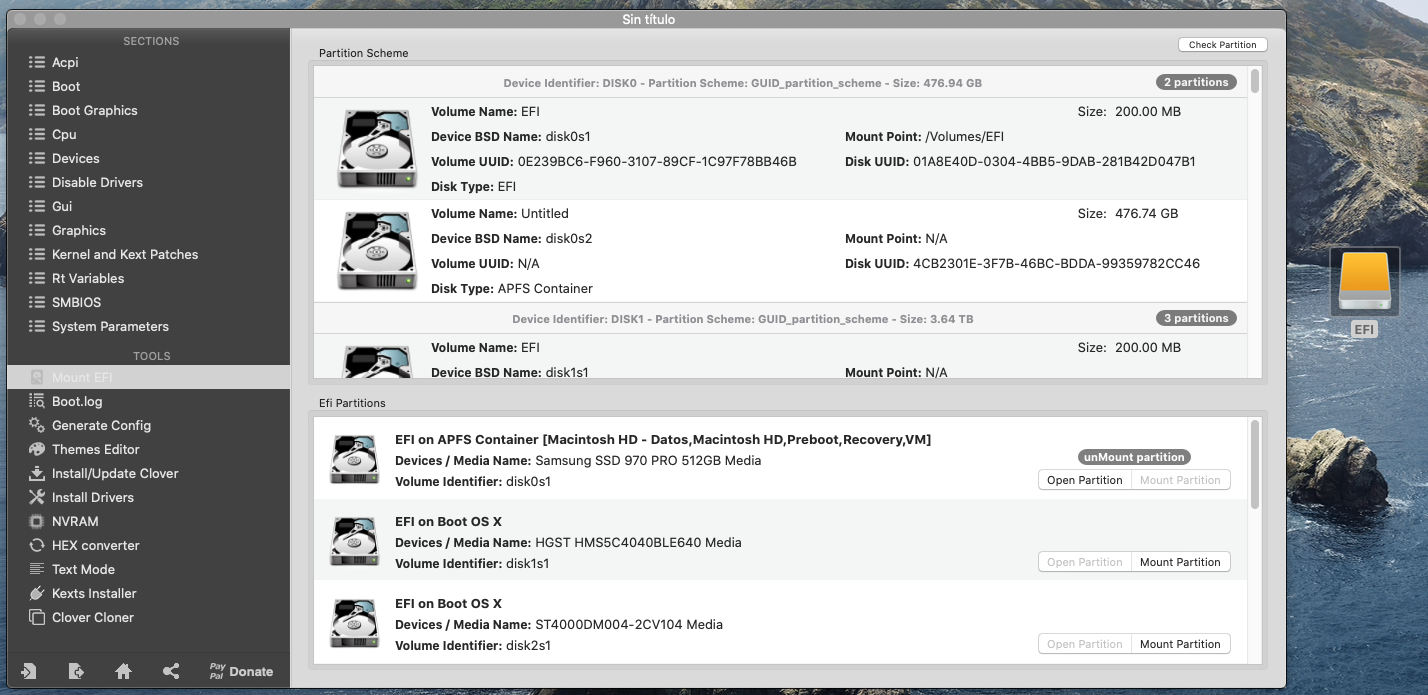

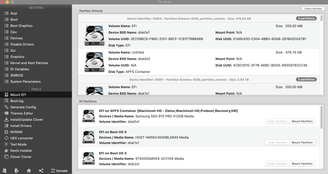

How do you mount the EFI volume on the NVME? When I try to mount it using Clover, nothing happens. I have no issues mounting the EFI on any of the 4 SATA hard drives. So I installed OpenCore 0.7 on one of them and blessed it. I boot from the NVME and it all works.
Using Clover. Odd. Never had a problem mounting it in my NVMe.
That’s what I’m using but when I select the EFI on the NVME and hit mount, nothing mounts. I have regular SATA drives and well and those WILL mount the EFI Just not the one on the NVME.

Weird. At first I was completely stumped since I incorrectly thought that oc had to be on the boot drive and I could not get the EFI on that NVME to mount with Clover. As soon as I tried the other SATA drives, it worked on all three of those.
