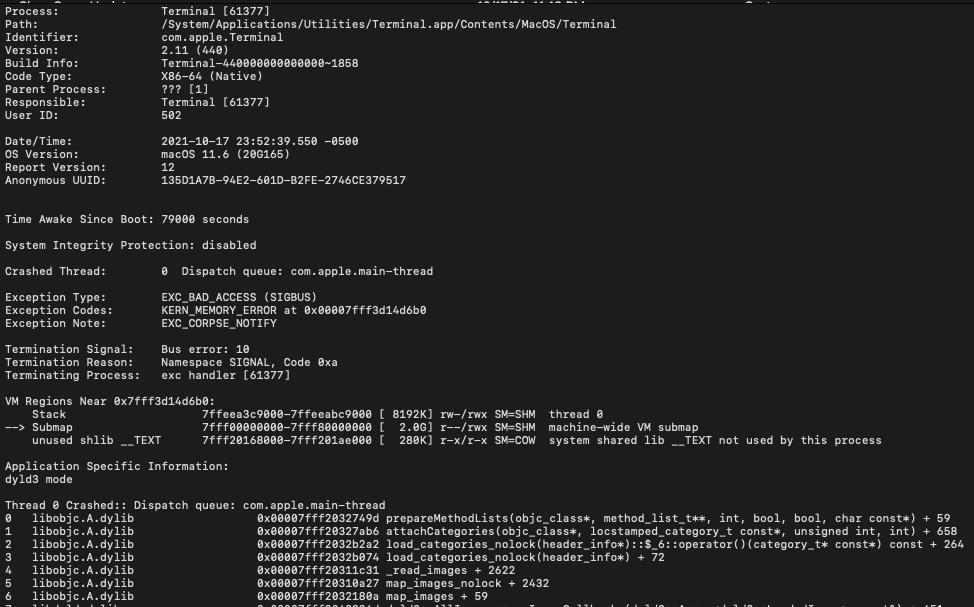

I was running Opencore 7.2 from Martin on Big Sur 11.6 on MacPro5,1 spoofed as a MacPro7,1, and it was working pretty well; however, it was a bit sluggish until Jessie's Flying on YouTube discovered spoofing cuts your speed in half. I've upgraded to Martin's Opencore 7.4 with the Slur Plus path, copying over required attributes and the memory mappings to the new config.plist, no longer spoofing, and everything is snappy again.
However, the system isn't stable where once a day, all running apps crash and cannot be re-launched. A complete system reboot is required. Attached is a log of one of many crashed apps with the same error.
I'm guessing this is related to the floating-point memory issue with 11.6, but I thought that is what the Slur Plus patch addressed.
Anyone else experiencing this or have any suggestions for remediating this?

Could you elaborate on this? Because a minimum of spoofing is a requirement for hardware acceleration on the MacPro5,1...
The system is set to identify as its native self as a MacPro5,1 before I had it set to MacPro7,1. I just had the crash happen again just now. Something is going on with memory management. I'm going to remove the defined DIMMS and use auto mode.
