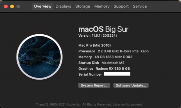

@abaxworld - thanks. but above my paygrade - work pending, editing in FCP so for now I have stable HardwareAcc in FCP 10.5.4 with 5,1 Catalina 10.15.7 (Catalina-patcher used to install to the NVMe from a Mojave boot) ; OC 0.6.8 ; EFI blessed. All good.

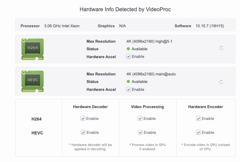

Public Service Announcement:
GiveAwayOfTheDay has VideoProc 4.4 for Mac and Windows free today (Tuesday, 26oct21). Click that link, give an email address, they'll email you a download link. The downloaded file contains both the Windows installer and the Mac DMG. Once you install it, visit this link and click "Get License Code" to download the license keys. Enter the appropriate key the first time you run the software.
Notes:
  • I have no affiliation with GiveAwayOfTheDay, Digiarty, or any related entities. I receive no benefit from anyone downloading or using this. This is strictly a PSA, since VideoProc seems to be popular around here (and I personally like it).
  • The GAOTD license does not expire; however, it does not include any updates, so be careful to never update the software or your license will revert to the "trial version". (This happened to me more than once. 😡)
  • If you're running multiple versions of MacOS on your system, you'll want to do separate installs on each MacOS version, since the license seems to be bound to where it's installed. The same license key will work for multiple installations (I verified this just now on my systems).
  • They seem to have renamed the product "VideoProc Converter" and introduced some companion products; at first glance, it appears that VideoProc Converter is more or less just an update of the old VideoProc product. I know nothing about the newer products.
  • What you're reading in this message is what I know. If you need help downloading, installing, registering, etc., you'll need to ask on the GiveAwayOfTheDay site or at VideoProc.com - I can't really help you with that.
  • GiveAwayOfTheDay offers like this one are only good for 24 hours. If I've done the math correctly, this offer is good until 08:00 GMT tomorrow (that's 03:00 EDT, midnight PDT).
Enjoy!

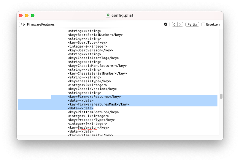

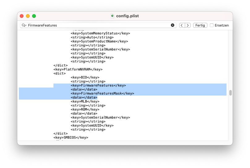

There are a few users asked about how to stop Big Sur update to go beyond 11.2.3. For those who are using my OpenCore package (0.6.6 or older), and already running 11.2.3, here is the method.
Once you update the system to 11.2.3.
1) Mount the EFI partition
2) Open config.plist with a text editor
3) Search
Code:
<key>FirmwareFeatures</key>
<data>A1QM4A==</data>
<key>FirmwareFeaturesMask</key>
<data>P/8f/w==</data>
4) Remove them, save changes, and reboot.
N.B. This is not just to stop Big Sur update to go beyond 11.2.3. But completely disable the ability to install / update ANY versions of Big Sur. e.g. You can't even re-install 11.2.3 until you add these code back in. Therefore, please only do this if you know what you are doing. If you screw up your OS, and want to make a clean Big Sur installation. You will need to add these code back in by using another OS / boot drive / computer / etc.

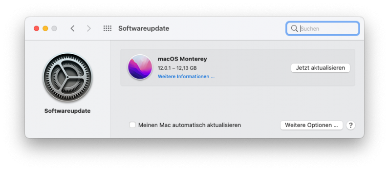

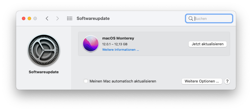

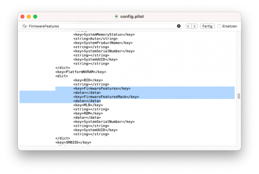

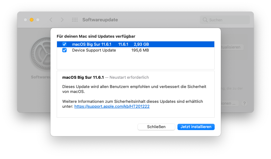

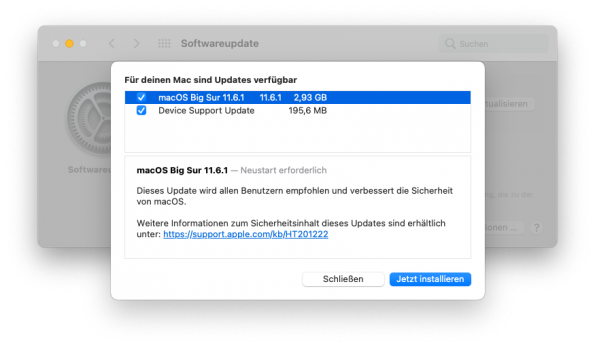

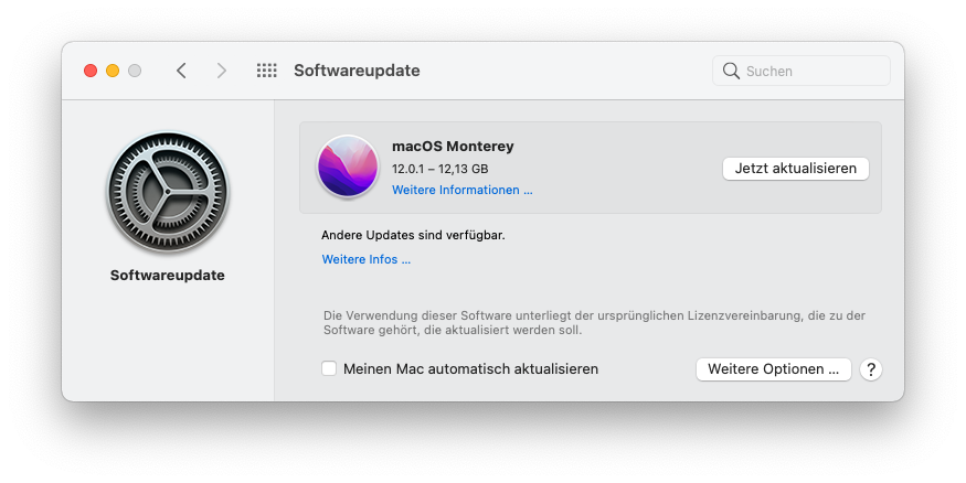

I'm still on the hunt for the reason, why my system says 11.2.3 is the last version and there are no updates available. If I boot from my Mojave-install in the OC boot-picker, software update shows 11.6, if I boot from my BigSur 11.2.3 install software update shows Monterey. So the reason isn't OC or my cMP5.1, I think it must have to do with stopping the BigSur system-updates following 11.2.3. But I can't remember if how or I did it. Found the post above and noticed that these two entries "A1QM4A==" and "P/8f/w==" are missing in the 0.7.4 sample config file, that contains 2 entries for"FirmwareFeatures". Is this ok? But I think my problem is related to something else that prevents BigSur updates
Since Monterey was released on yesterday. The official update from Software Update pulls only Monterey. You have to download Big Surf 11.6 directly from Opencore thread. They have an utility allowing you to choose which build to download selectively which is awesome. It works for me. Run the following in your terminal. That's all.

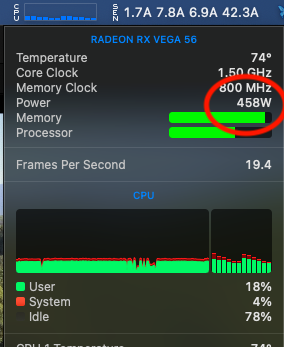

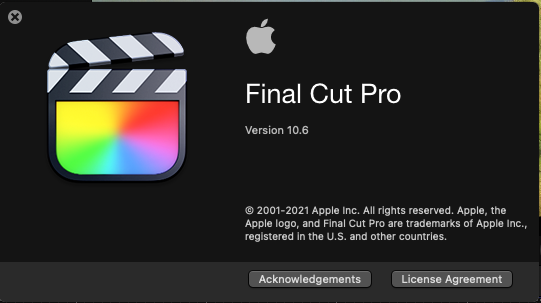

Since I've upgraded to Big Surf 11.6.1 today. A big jump from Catalina 10.15.7 overnight. Then I installed the latest FCPX 10.6. The performance is suuuuuper fast!!! During the encoding phase to an output movie. The Mac now can make use 100% (465W) of GPU power (Vega 56) no matter the output format either a h264 or h265 (HEVC) mov file.
See the cap. It is amazing. In the previous build of FCPX. It could only make used of about 50% of GPU power. This new FCPX is totally rewritten and when it works on Big Surf. It works total differently. I've been waiting for this version of FCPX for years and finally it has come! Now, encoding a project movie which has 10 mins long is only a task of several minutes job!!! Cheers!!!

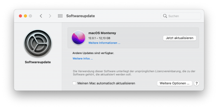

Yeah, that did the trick. Downloaded the appropriate OS installer, worked without problems. Additionally to the updated system, softwareupdate list now all the remaining installs for BigSur. I think it has really been some kind of update-blocker I have applied to prevent automatic update as long as it has been advised not to go further than 11.2.3. Stupid me, I can't remember the way I did it. But problem solved, thanks for your help

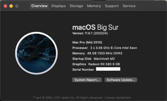

Hey guys, I successfully installed Big Sur using Martin Los 0.7.4 on my Mac Pro 5,1. System drive is a NVME on PCI and running an XFX RX580.
The issue I'm facing is that after an hour or so Finder crashes. I try to relaunch it and it won't load. If I try to load any other app they won't load. Only solution is a restart. What should I do?
Hey guys, so with some digging and a few coffee cups with some friends over on discord, some friends believe that the problem's with Feature Unlock. So I loaded up the config.plist and did a search and found that by default its active (for NightShift). Deactivated it (changed YES > NO). Let's see if things will work better

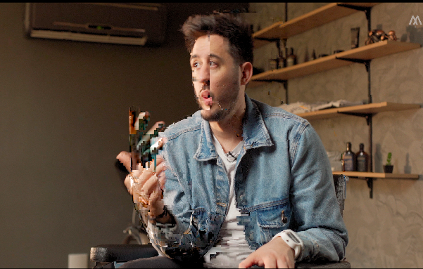

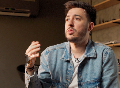

I'm getting some strange artifacts when editing 4k in Final Cut Pro X 10.6. Does this have to do with the Patcher?
