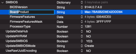

Hey guys, so my artifacting with HWACCEL is pretty bad. Can't get any work done. So I've spent most of the day goin through the forum. I can't figure out what in the config.plist on EFI I have to deactivate to turn off HWACCEL. Can anyone point this out?
Thanks!
Remove the board ID spoofng
Reactions: Danielgbr
Ok so in the config.plist I'm supposed to remove SMBIOS? Searched this forum and I couldn't figure this out...
Attached is what I see in SMBIOS:

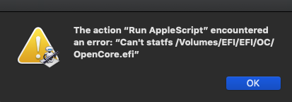

So I copied the APPLE folder from the original Mojave EFI (The one I made this clone from) then did the OC install as per Martins instructions but I get this message when I try and Bless OC.

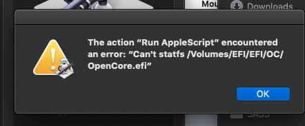

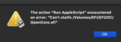

Process:
This disk is a Mojave CCC > Followed #1314
  1. [Optional] 3x NVRAM reset to avoid some unknown issues.
  2. Disable SIP (must do, especially if you performed step 1)
  3. Download the attachment in this post (Some users reported 0.6.1 package has compatibility issue. You may download the 0.5.9 package if you prefer that, same installation procedures.)
  4. Follow the steps in this video (please turn on and read the subtitle)
BUT I get the above error message.....

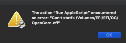

Nope. Still get the same error message.
Martin can you help? @h9826790
Process:
99% because you haven't copy the files into the correct location.
e.g. the correct location is the EFI folder inside the EFI partition, but not at the root folder of the EFI partition.
Ahhh ok. Well I'll need to create an EFI folder then...?

Yeah I just created an EFI folder. And OC Installed ok.
In case you missed this part: You should be using clover Config to mount the EFI partition on your desired OC drive and then copying Matin's package into that, per his video instructions. You shouldn't need to create an EFI folder.
Read all my posts above dude..
