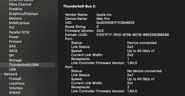

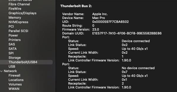

any idea why my flashed titanridge just wont work for thunderbolt?
it works fine as a usb3 card. usb sticks pluged into the card will show up as USB3 on my MacPro but no thunderbolt device will be regognized...
it has never worked. i keep updating to newer OC releases but it doesn't seem to get fixed.
I flashed it using the tutorials over at the testing TB3 thread and i set the bootflag in the cofig.plist to true but yeah no success.
systeminformation shows this under the thunderbolt tab:
Any tips from the TB3 users here?
thanks in advance...

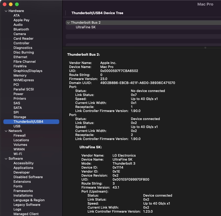

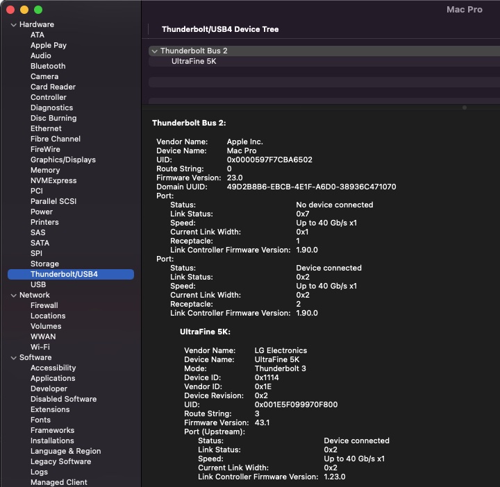

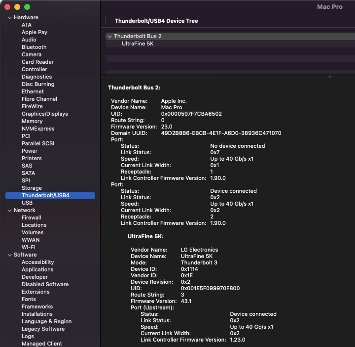

All I needed to do with mine was enable it in the config.plist (change false to true). On my two 2010 Mac Pros they each have a flashed Titan Ridge 2 and they definitely work:
I have the LG Ultrafine 5K display connected via the Thunderbolt port. I use the display port to displayport-in cable that came with the Titanridge package to pass the video through. The screen runs at 5K no problem at all. On both machines the Titan Ridge card is in PCI-E slot 4 as instructed.
Hm. I dont have a Thunderbolt Display to test this but it sure doesn’t recognize my Thunderbolt Harddrive.
I also enabled it in the config.plist i also have it in slot 4 and i also flashed mine following the steps mentioned here on the forum including putting this connector cable between two of the pins on the back of the card.
I don’t know why its not working…

Do you see it in the System profiler? Also have you tried another drive? I have one old Thunderbolt 1 drive that does not mount with the Titan Ridge card. All newer ones have no issue.
One thing I didn't mention was that the 5K display won't wake up if the machine goes to sleep, you have to unplug it and plug it in to the thunderbolt port. It's recognised when you start the machine and the Opencore bootscreen even shows on it, but when macOS starts (Monterey 12.1b2 for me) then the screen is asleep and you need to unplug and plug in the cable again to the thunderbolt port (Titan Ridge 2).
It's a minor inconvenience - probably not related to what you are experiencing.

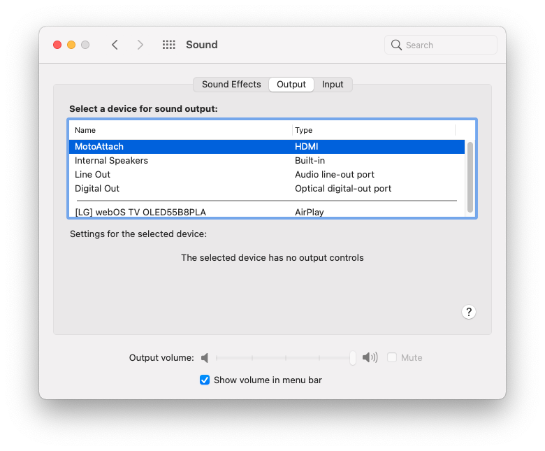

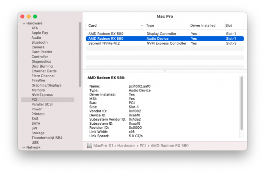

What you're describing is what I thought I had after installing Martins 0.7.5 package. After double checking, I can confirm that WhateverGreen.kext is enabled (as by default in Martins 0.7.5 package) and boot-args include -wegtree (as by default in Martins 0.7.5 package). I have now re-disable the AppleALC.kext, rebooted and again, no HDMI audio output available in system preferences or system profiler. Do you have the option to select HDMI audio from your sound preferences? Will it make a difference if I upgrade to Big Sur 11.6.1? My RX580 is an MSI model. Could it be that they don't have HDMI audio on certain models? If the gpu was faulty, what would be the best way to find out? Thanks a lot for your time btw :c)
Yes I do:

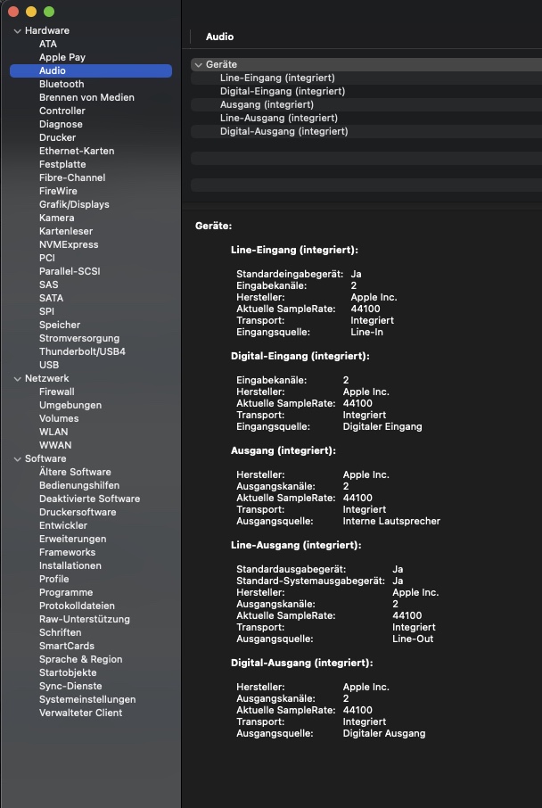

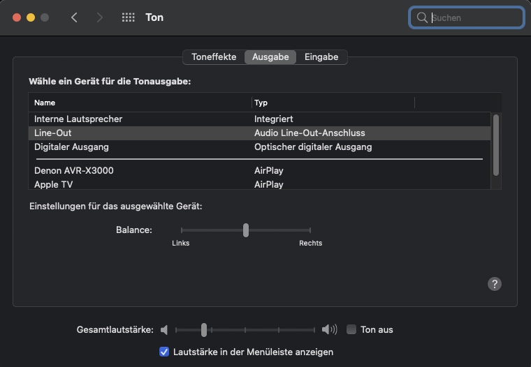

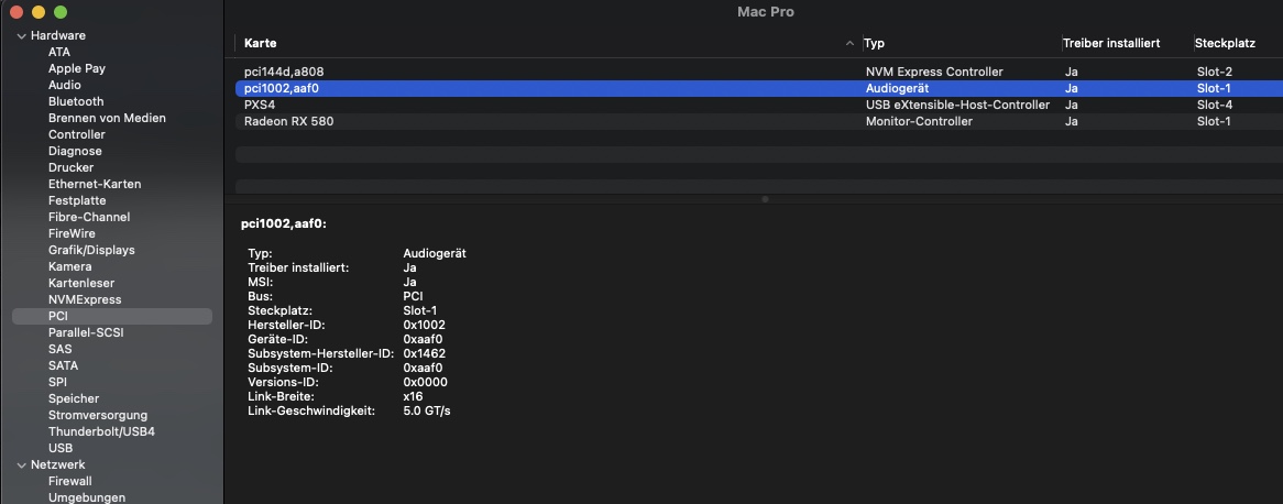

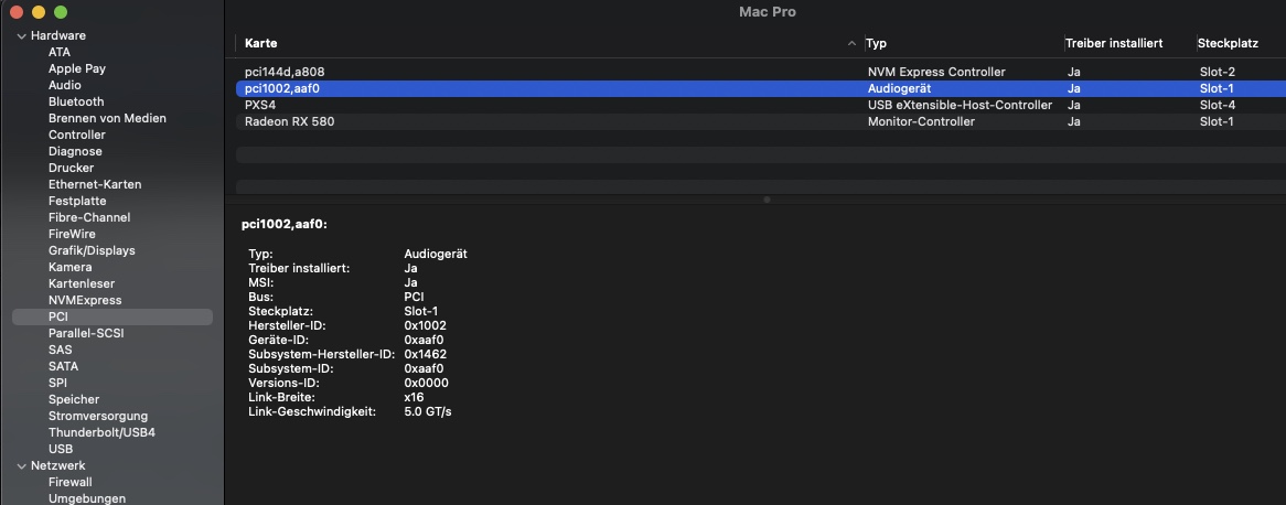

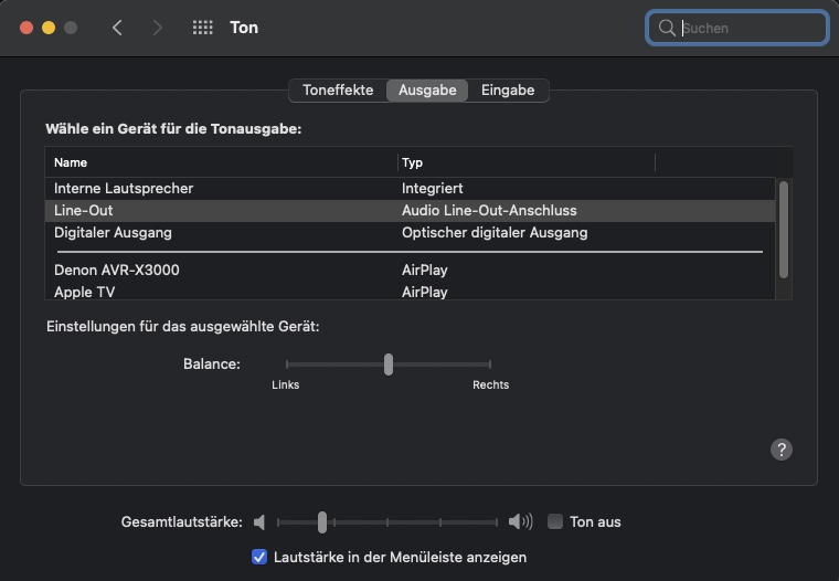

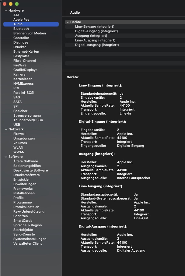

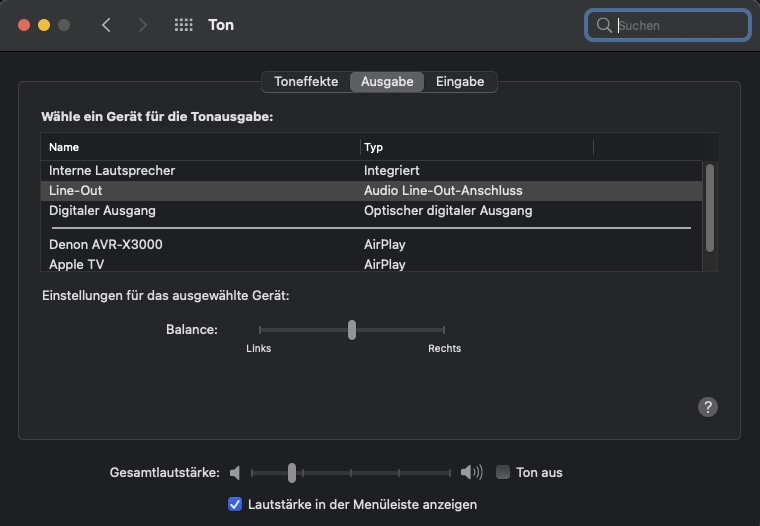

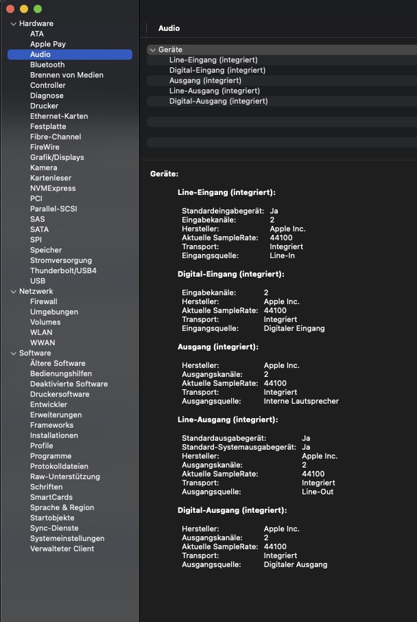

Ok so I think thanks to you we're zooming in on the problem...
I've never seen a sound / audio option HDMI in my last system (High Sierra with a GTX980). I've now upgraded to Big Sur with OC and an RX580 but have also never seen an HDMI audio option anywhere. BUT I've just checked the system profile and look what I found:

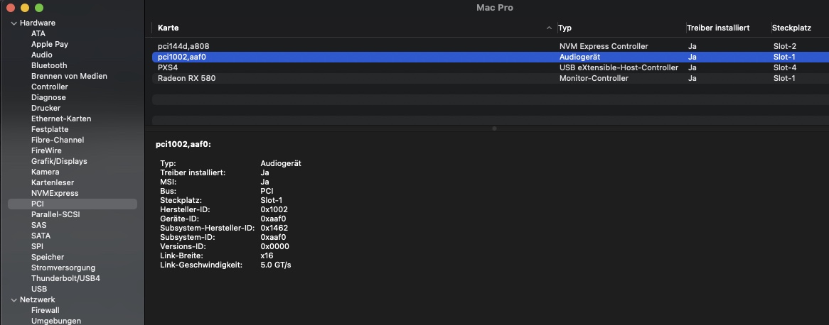

So there's definitely some audio functionality connected to the gpu in slot 1 (like on your screenshot) but it doesn't show up anywhere else. Drivers are installed. But note the funky name as compared to your profile. Yet the same funky device name pci1002,aaf0 shows up further down in your pci device descriptions. Then in the audio section, there are only the usual suspects:
And in system preferences, no HDMI either...
I don't have a drive with Mojave but with High Sierra. Do you think I can check within High Sierra without OC aswell in order to see whether HDMI shows up there (instead of Mojave)? I don't have any Linux or Windows readily available...
I'm not using any adapters. The HDMI cable I'm using is quite old and very long. But I'm just sending a Full HD signal so I didn't think that could be an issue. Does there need to be a successful "path" for the audio signal to travel through for the HDMI option to show up in the system? Meaning: will the option only show up if there is an actual compatible cable connected to the HDMI output of the gpu or if that cable can somehow make a handshake of sorts with the other device connected? Or should the option be available no matter what or whether anything is connected to the gpu?
I'm not trying to connect the HDMI to my monitor but to a Denon AV receiver in another room and there are speakers connected to the receiver which work when sending the audio through the digital optical output of the cMP in High Sierra (this digital optical output seems to also have been broken in Big Sur, at least for me)

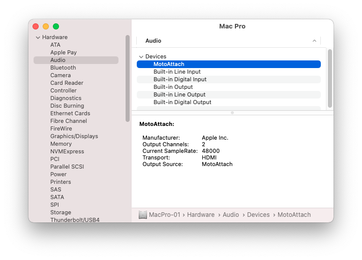

So it doesn't seem to be recognizing the audio on your RX580. Try setting the name in deviceproperties in your config.plist. See this post - https://forums.macrumors.com/threads/opencore-on-the-mac-pro.2207814/post-30593056. Maybe that will work for you.
That "funky device" name is normal. It shows that the macOS device driver for HDMI audio is enabled. Mine looks different because I manually change the name by injecting a DeviceProperties as described here. It is not necessary to change the name...it's just cosmetic.
Yes High Sierra will work too. Just remove the Big Sur drive and any drive where OC is installed. But I suspect it too will not work. See other comments below.
No the length is not the issue. The "path" needs to be two-way. See "handshake" below.
"handshake" is important. The device at the "other" end of the HDMI cable "talks" to the GPU to exchange info about its capabilities. If that device does not respond then there will be no HDMI audio option in Sound Preferences. E.g. my screenshot shows the name of my monitor "MotoAttach". That name was sent by the monitor to the HDMI audio driver.
OK, now it is making sense.
First, to check that your HDMI cable is actually working, you need to directly connect it to an HDMI input of a TV or monitor with speakers.
It looks like your Denon amp is not talking with your cMP. The amp must present itself as an HDMI device to the GPU. You need to check your amp and consult its manual regarding HDMI switching and what needs to be selected on the INPUT selector of the amp.
I have not tested my digital optical output but cannot see a reason why it would not work. Again, check your amp.

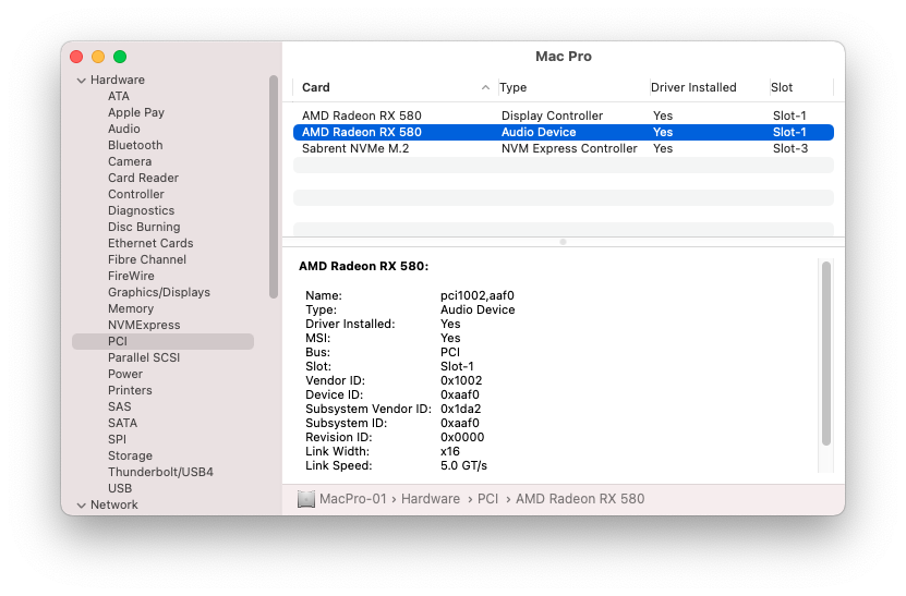

Actually, the GPU's audio device is recognised as shown by his System Profiler screenshot. What is not recognised is what is attached to the GPU.
Setting the DeviceProperties will not solve the problem as all that does is change the name displayed in System Profiler. Good link though 😉
OMG you DID IT! The handshake was missing! I hadn't disconnected the digital optical cable and apparently hadn't unplugged and replugged the HDMI cable WITHOUT the digital optical cable connected and after doing both things and changing the audio input to standard (=HDMI instead of digital optical), the receiver finally connected to the Mac Pro, the HDMI option shows up in system preferences and the sound is being transmitted! YEEEHAW! Huge thanks to you MacNB2!
Reactions: 0134168
You're welcome.
