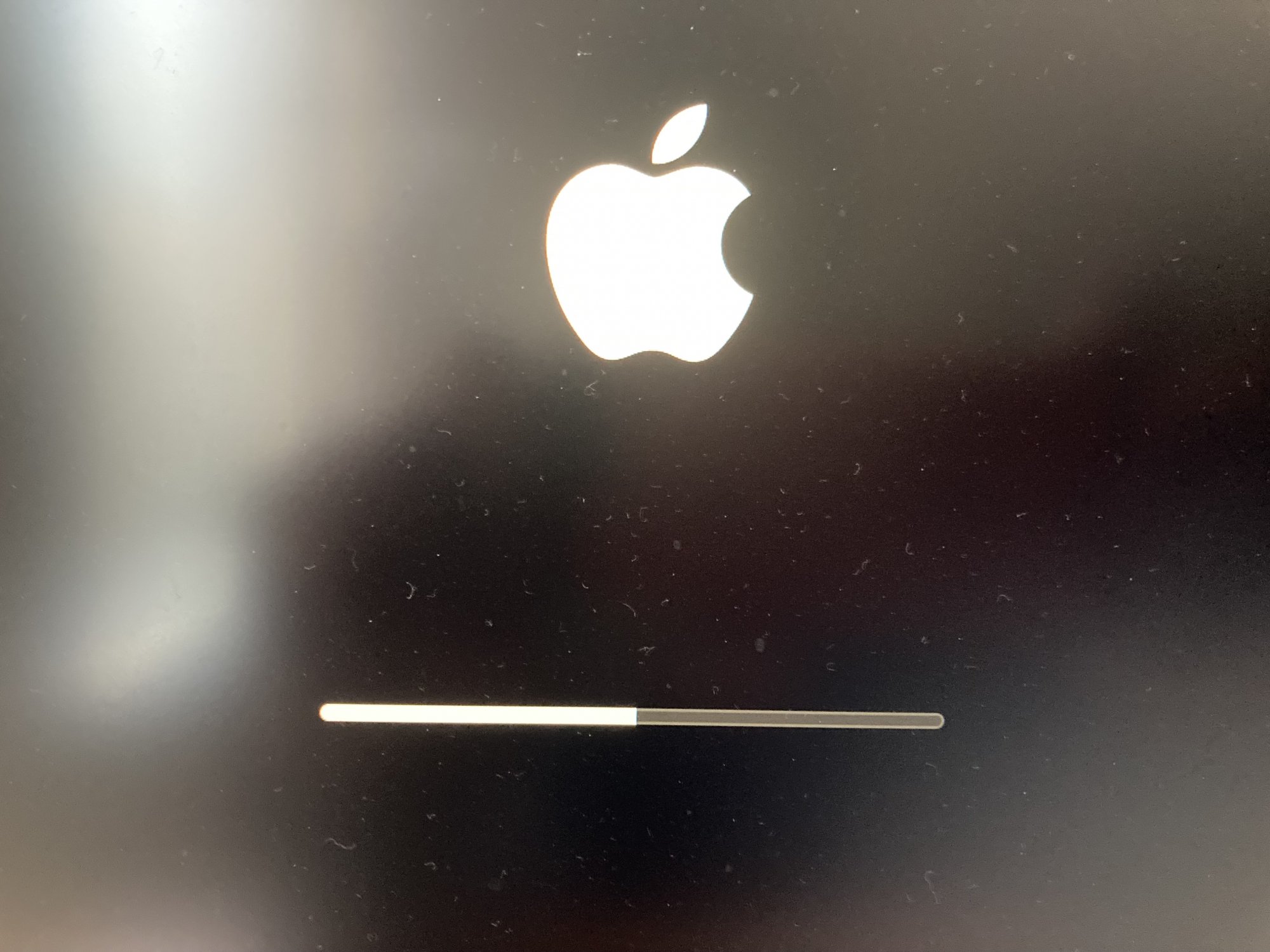

Well @h9826790 I had to enable VMM flag to get the installation going and now I am stuck here on this screen
Any thought on what I could do?
update : I have also tried doing a fresh install but still no luck, I am stuck on the same place
