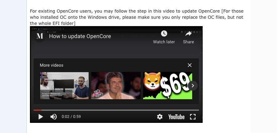

For existing OpenCore users, you may follow the step in this video to update OpenCore [For those who installed OC onto the Windows drive, please make sure you only replace the OC files, but not the whole EFI folder]

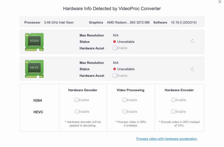

When using Safari, I will get GPU Reset / VTDecoderXPCServ and WindowServer Kernel Panics or whenever I need to use a VTDecoderXPCServ process (which is rare).
In Chrome and Firefox, I have hardware acceleration turned off. As a result, I can stream video all day long and use EyeTV. However, once I start to use Safari or another process using VTDecoderXPCServ, I will receive the error.
Is it possible to turn off the hardware acceleration in the config file or modify something else?

You can turn off SMBIOS spoofing. This should also turn off HWAccel.
If still crash, you may need to remove all HWAccel related boot agrument in the config plist as well.

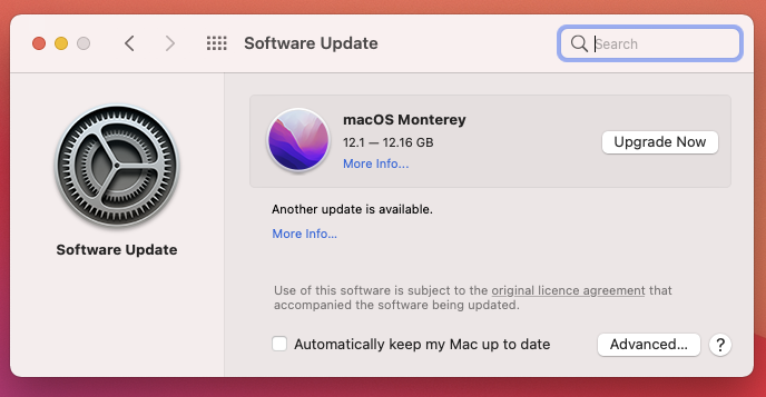

Guys I used the instructions below to update the EFI to 7.6 and all went well.
As soon as I rebooted I was asked to update to Montgomery..............Is it safe to do so?
Thanks in advance guys
Neil

My 5.1 cMP now thinks its a iMac Pro after updating the EMI from 6.1 to 7,6. I really want to update to Montgomery now but I'm scared to do it after reading a warning somewhere saying "DO NOT UPDATE TO MONTGOMERY USING THE OS POP UP BUT DO IT BY DOING XYZ".....but for the love of me I cant find what the XYZ is. Can someone please help me?
Thanks
Thanks

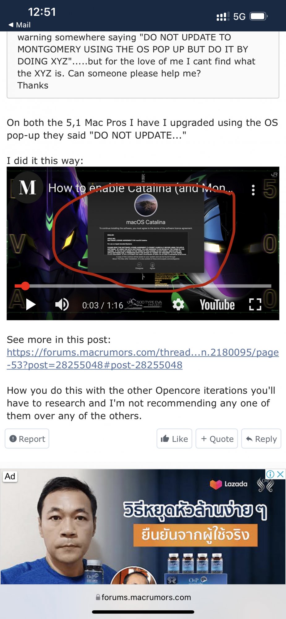

On both the 5,1 Mac Pros I have I upgraded using the OS pop-up they said "DO NOT UPDATE..."
I did it this way:
See more in this post: https://forums.macrumors.com/thread...n.2180095/page-53?post=28255048#post-28255048
How you do this with the other Opencore iterations you'll have to research and I'm not recommending any one of them over any of the others.
I did it this way:
Sorry I don’t want to sound thick. But I saw that video already but don’t understand how to initially get the Mac OS installer. In the video it shows Catalina and I’m guessing Montgomery is the same. But how do I get the OS Montgomery download to start the process?
Thanks
Thanks

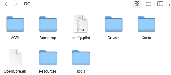

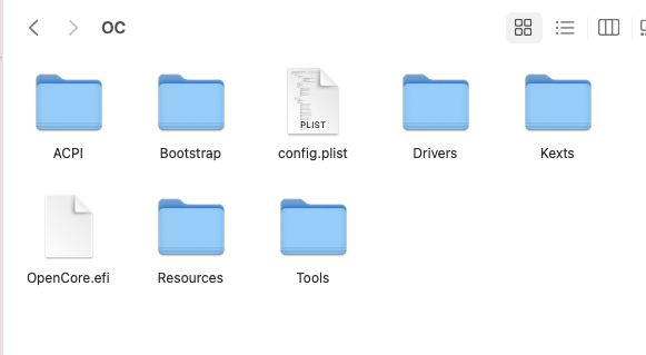

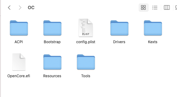

I tried following this but after I mount the EFI and open the OC folder the Config folder on my computer says config.plist not config
And if I double click on that something else opens up not the same as in the video...........What am I doing wrong?
I haven't looked at the video so I have no idea what you're expecting but I'll make some guesses.
You have "Show all filename extensions" enabled in Finder preferences which is good.
When you double click something it opens the default app which might be different than the app that someone else uses.
A plist will appear differently in a text editor than it does in a plist editor.

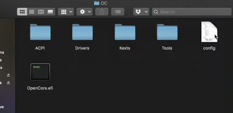

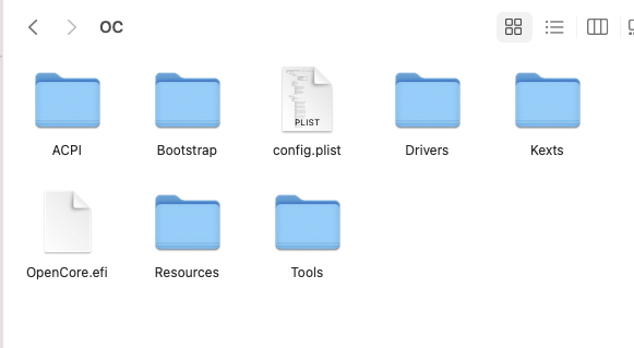

Thanks for your reply. The actual contents of my EFI/OC folder is different
My OC folder
Contents in the video EFI/OC folder is
I opened the config.plist file in text editor and I found the lines where you have to make the changes..........I did that and "bobs your uncle" Montgomery opened up.......thanks for all the help
