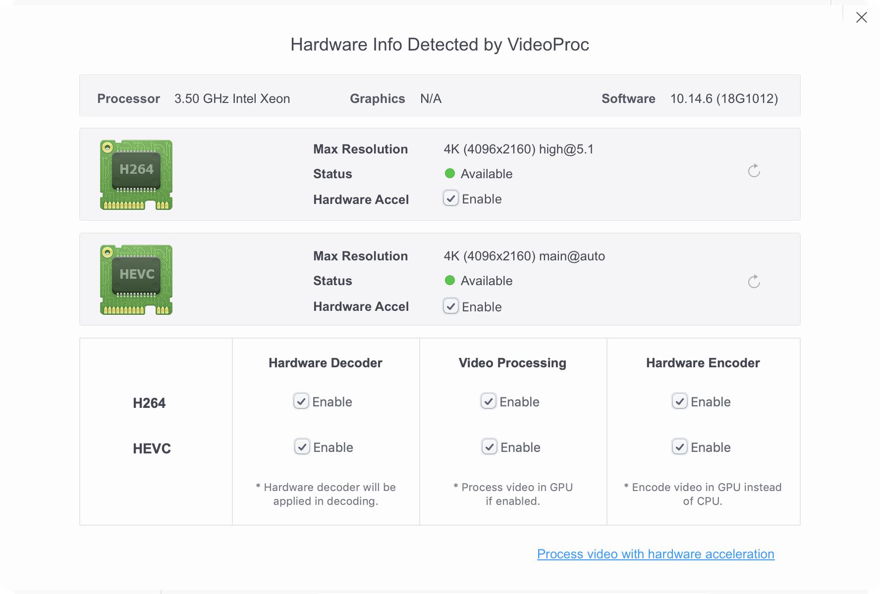

Finally, FULL HWaccel achieved (including HEVC hardware encode)
The exact condition still unknown due to few variables exist.
My understanding so far. The requirements are
1) OpenCore
2) Inject iMac Pro SMBIOS (via OpenCore)
3) Rename the graphic card APCI name to GFX0 (via OpenCore)
Since we ident the cMP as iMac Pro 1,1 now. There is no need to patch the AppleGVA framework anymore.
However, I am not 100% sure if WhateverGreen still require (boot argument is 100% not required anymore, but the existence of WhateverGteen may be crucial)

I look forward to one of your awesome detailed guides on the full process (when you are finished testing, and have the time of course)...
