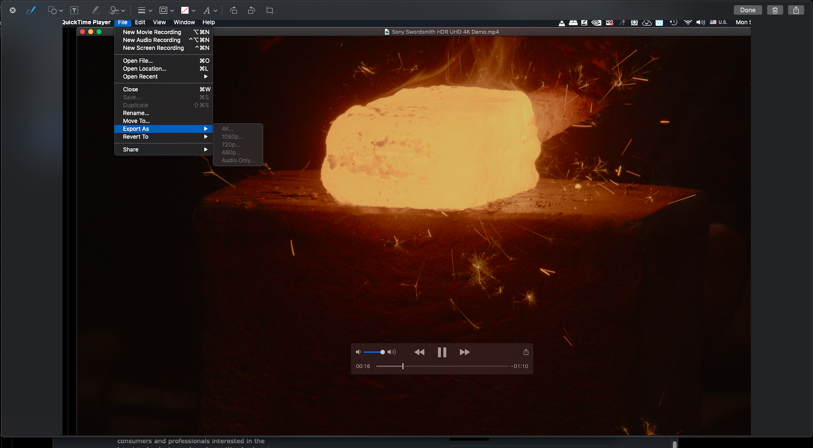

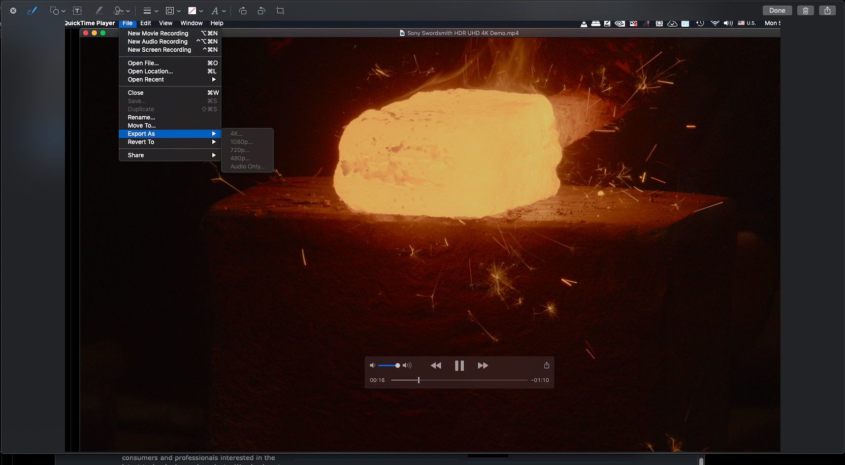

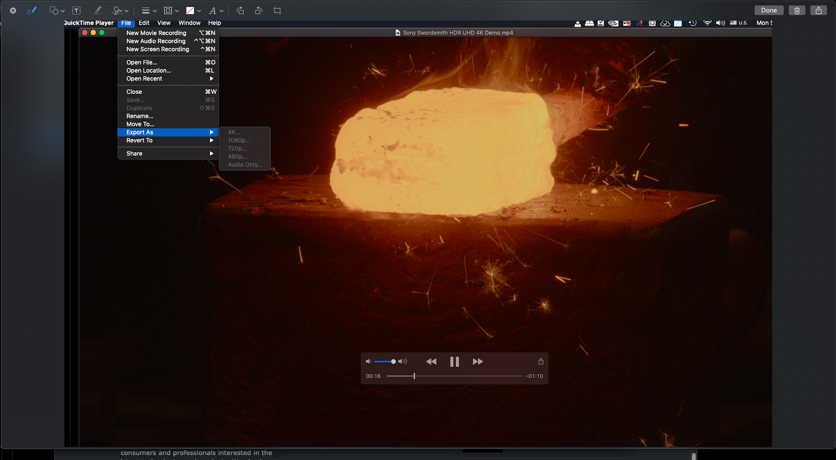

May I know what's wrong in your screen capture?
If you want to show QuickTime cannot export 4K, then most likely because your source video isn't 4K, and QuickTime won't give you the option to upscale the video.
Anyway, if the discussion is purely about HWAccel, but not "if OpenCore can make HWAccel work", then we better go back to the HWAccel thread to discuss.
With 4K video it is even worst.
QuickTime Player cannot export this sample video. This is normal, but not because HWAccel is not working. Some video / audio codec cannot be export in QuickTime. No idea why, but it's been like that for many years already.
QuickTime Player is not a good video converter anyway. It has this kind of function, but very limited.
HWAccel also has its own limitation, e.g. some encoding parameters cannot be changed.
I already showed you this particular video and be fully hardware decode and hardware encode in VideoProc. The screen recording also show you the parameters used. You may try the same thing, and see if get the same result.

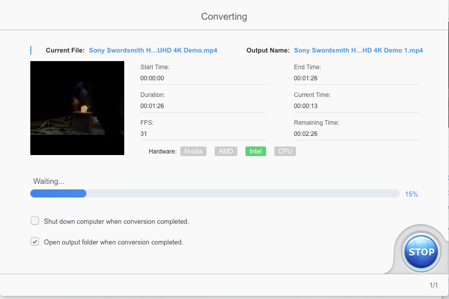

This is how VideoProc treats hardware acceleration:
Intel really?
In fact, your screen capture in this post suggest that everything is working as expected. That “Intel” is just cosmetic, doesn’t really matter, it’s about how fast you can decode / encode now.
31 FPS is what your GPU can do. Did you monitor the CPU usage? That should be nearly idle. Which is a clear sign that HWAccel was working. Otherwise, which piece of hardware was doing the conversion?
You may also try the same hardware setup, but boot Without HWAccel, and do the same conversion again (of course, no HWAccel indication will be available in the settings page), and see how many FPS you can get for the same video conversion, and what’s the CPU loading. At least, VideoProc should show “CPU”, but not “Intel” anymore.
