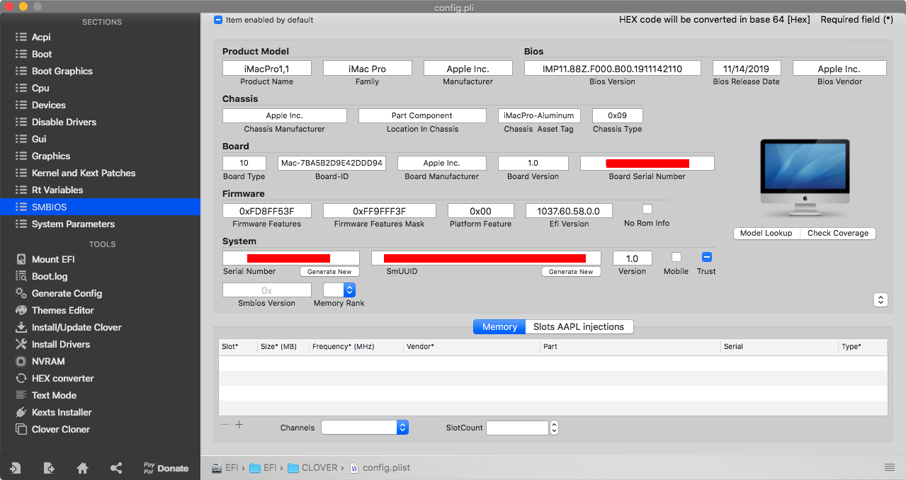

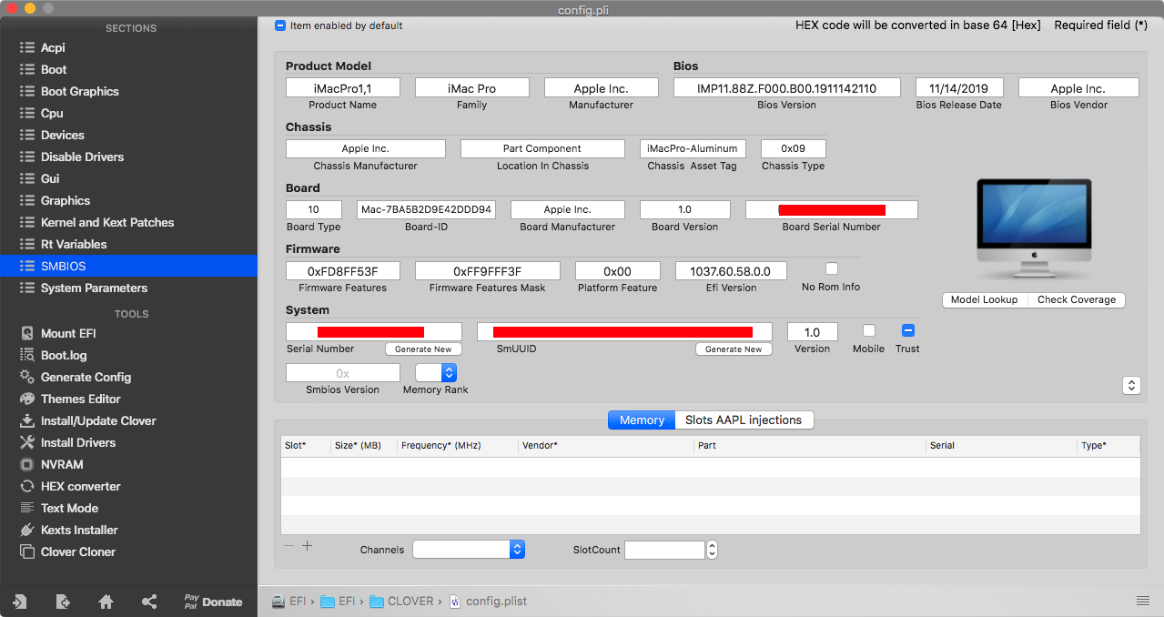

I only added:
Code:
<key>SystemProductName</key>
            <string>iMacPro1,1</string>
Different than cMP5,1. But looking at the Hackintool The iMac Pro board ID is automatically applied.
I only added:
Code:
Oh, I forgot to mention that I am using manual mode. Which can keep SystemProductName as MacPro5,1, but only inject the board-id Mac-7BA5B2D9E42DDD94

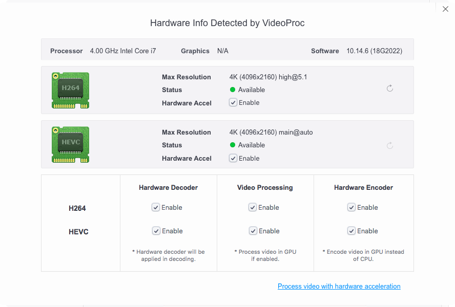

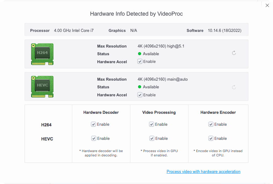

Confirmed full HWAcell.
This is on Asus Gryphon Z97 (Haswell HD4600 Intel Graphics ) Hackintosh with MSI Armor Radeon RX580.
Maybe useful to someone in the future.
I didn't bother on my MacPro 5,1. Not much point using it, no boot screen, no AirDrop, generally just way way too slow.

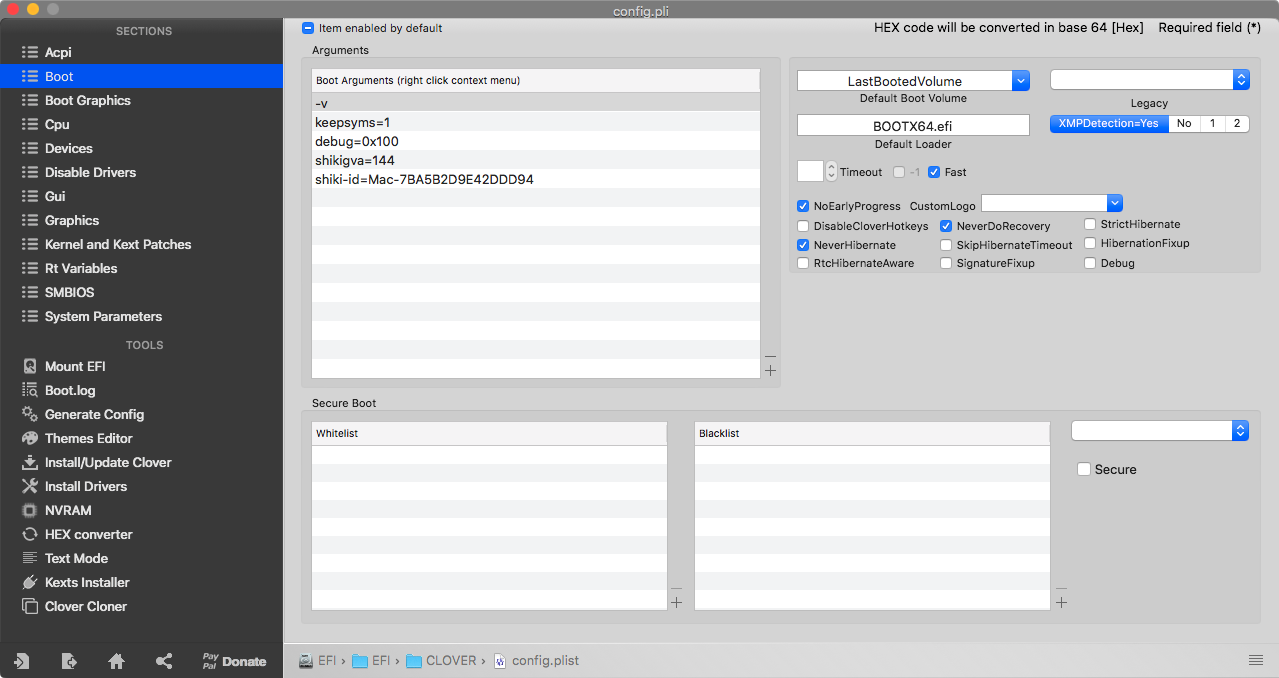

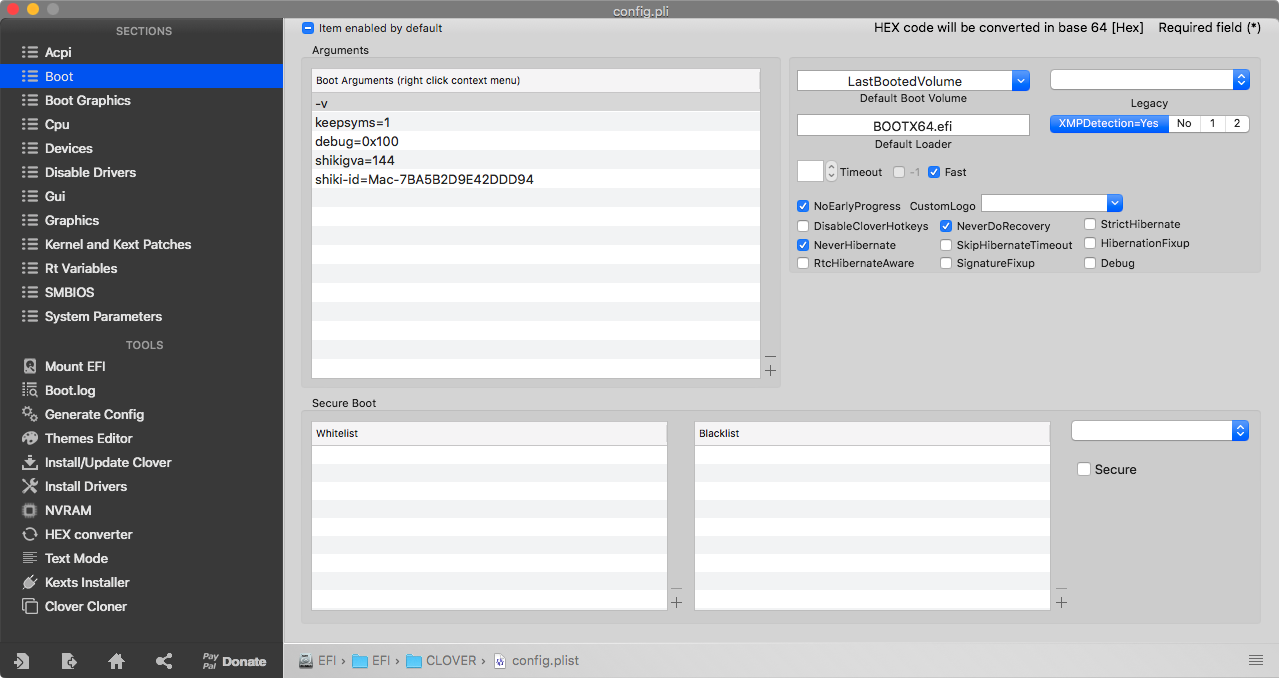

Changed Product Model to: iMacPro1,1
Boot args:
shikigva=144
shiki-id=Mac-7BA5B2D9E42DDD94
keepsyms=1
In VideoPro, the reload icon MUST be clicked, simply opening does not do any checking.
Reactions: Warriors Photo

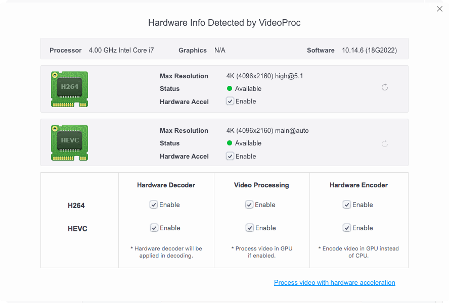

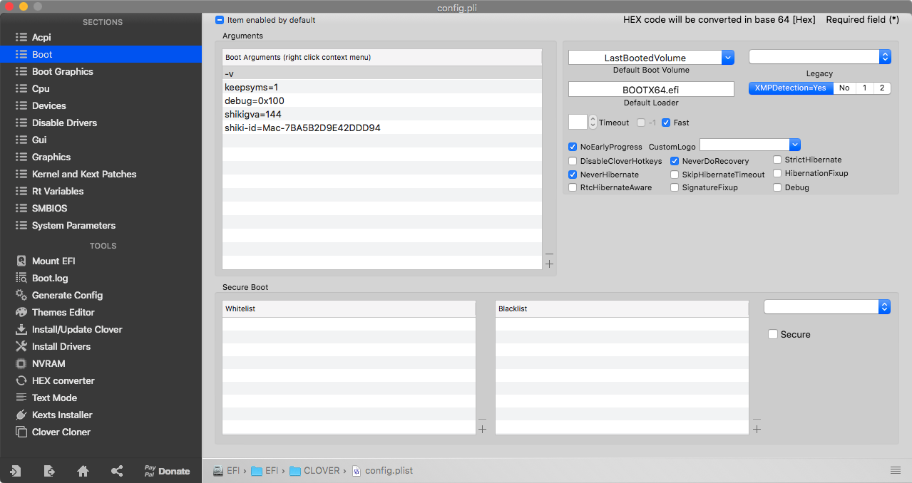

Boot args:
shikigva=144
keepsyms=1

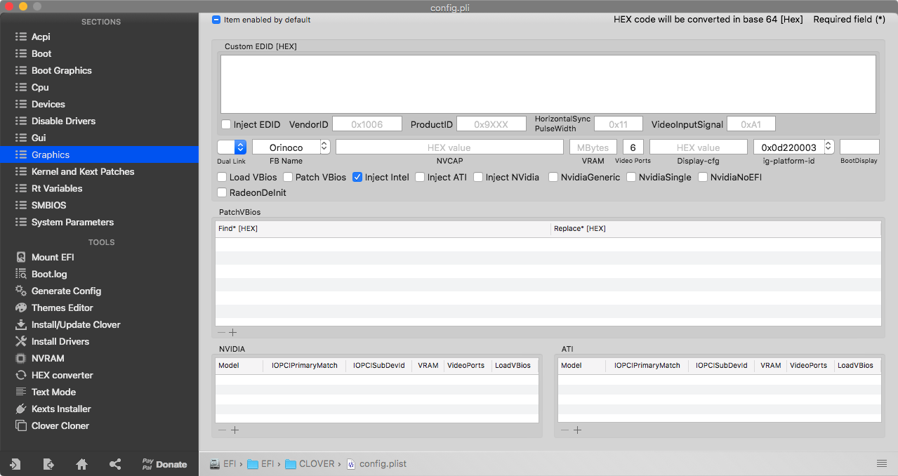

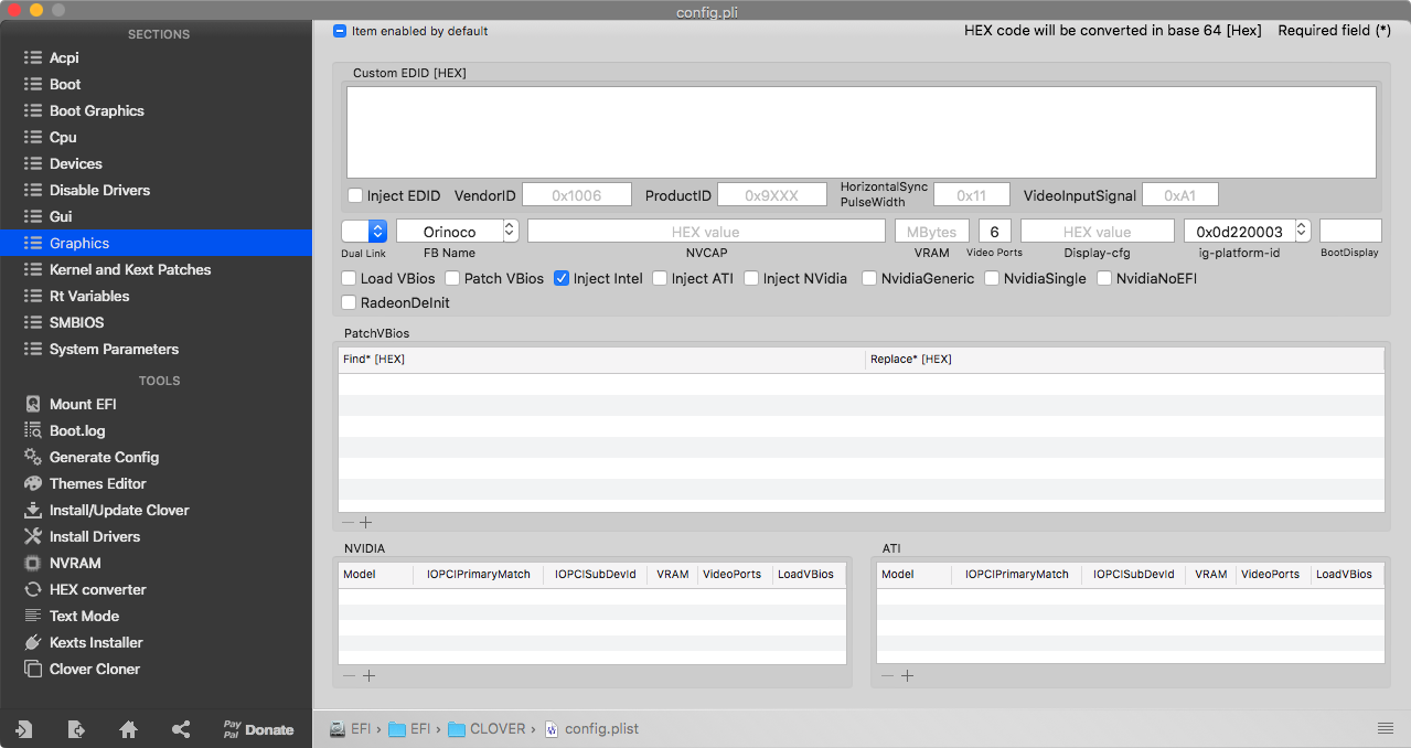

Hello there. I have a Z77 Hackintosh that I would like to start using over my Mac Pro. Are you using the HD4600 for QuickSync or the GPU? Thank you in advanced for this input. :)
[automerge]1576612238[/automerge]
All 6,1 native GPU won’t work. Need at least Polaris to provide HWAccel.
However, 6,1 + eGPU may work. Still waiting for someone to confirm it.
I like and don't like the sound of this. I was hoping to move on to the newer generation of Mac Pro. At least I can look at the bright side. The 5,1 Mac Pro, is still a very powerful PC. :)
Hey mate,
Okay, there's some peculiarities or myths surrounding HWAcel.
I had the iGPU disabled, and Handbrake using VideoToolBox H265 encoder.
First run I noticed 60%+ CPU core utilisation, Radeon GPU usage was noticicible but I don't have any numbers because the GPU history meter in Activity Monitor doesn't have any reference measurements. I don't know if the meters being half the window vertical can be assumed to be 50% use or more or less.
Then I realised the Handbrake profile had Video Filters enabled, it is known the filters, decomb, de interlace etc are not processed on the GPU, these are purely CPU bound, so I had to do another run, disable the filters to get amore accurate understanding of resource usage, sure enough CPU use dropped to about 20% use, that is explained because Audio encoders only use the CPU, rest of resource use was on the Radeon.
Then I enabled the IGPU in the UEFI firmware (BIOS) and expected Handbrake to default to using Intel Iris iGPU but it didn't.
Ran same tests in that ugly VideoProc app, H265 encoding in this app showed the Intel doing the encoding not the Radeon. Then I read VideoProc knowledge base that Radeon RX580 does not accelerate H265, only h264.
This was rather pointless because h264 on the GPU is no faster than on the CPU. The big gains, according to Handbrake tech info is that h265 on GPU is where the big advantage is seen over CPU encoding.
When I ran H264 on VideoProc it only used the CPU, but I went so fast I was unable to make an assessment because it is trial version and the second encode probably encoded only the first minute of the video source, and I wouldn't pay for that junk windows ported software anyway. Probably there are other apps that people regularly use that would be more suited to testing to get useful metrics.
As far as other source material and apps are used, such as Quicktime playing movies etc I didn't have the iGPU enable to observe Intel Quicksync because at that stage I was primarily interested in if the Radeon was doing the processing.
In my observations when the iGP was enabled it appeared to be ignored in favour of the Radeon, but I can't rule out the possibility that my Clover configuration is having an effect and preventing the iGPU from functioning.
Hey mate,
