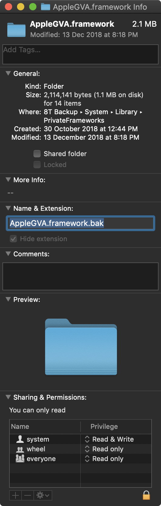

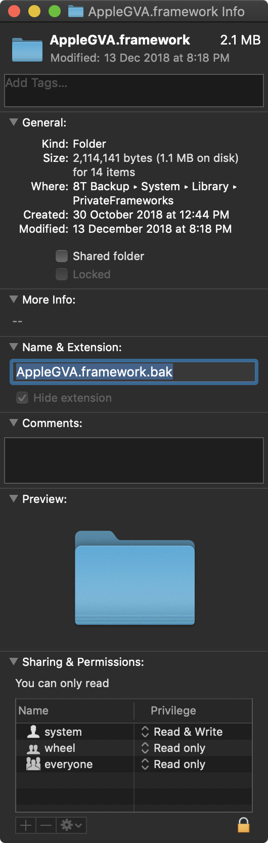

5) single click the ORIGINAL AppleGVA.framework
6) Press “Command + i”
7) in the pop up window, rename “AppleGVA.framework” to “AppleGVA.framework.bak” (the file icon should now change to normal folder icon)
8) Rename the duplicated “AppleGVA copy.framework” to “AppleGVA.framework”. (This file’s permission should be wrong at this moment, but tests shows no adverse effect. In fact, make it easier for us to mod. For beta testing, I intentionally keep this “wrong” file permission)

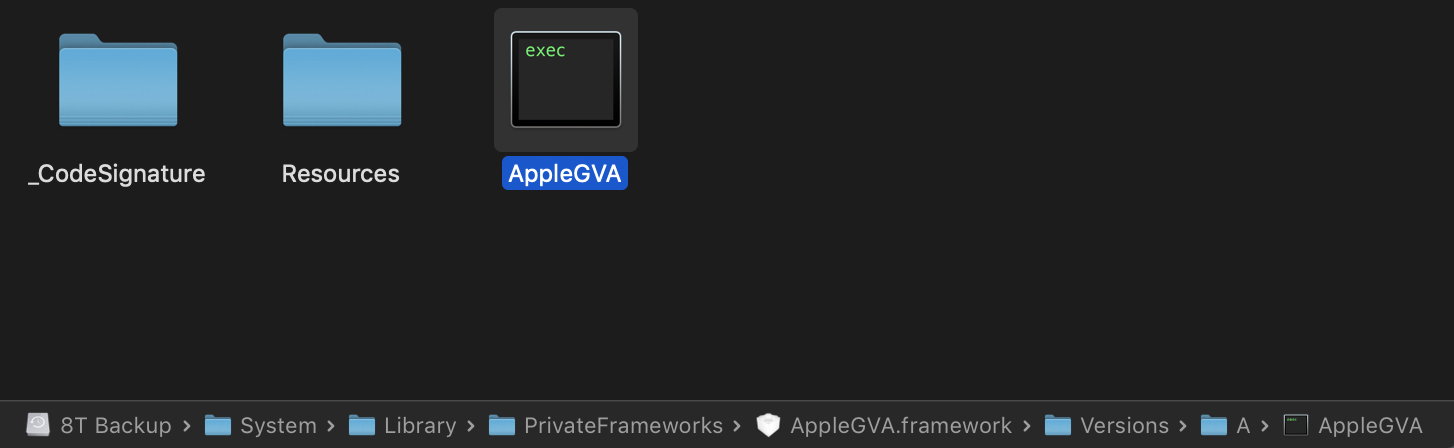

9) double click the current AppleGVA.framework, you should able to open it.

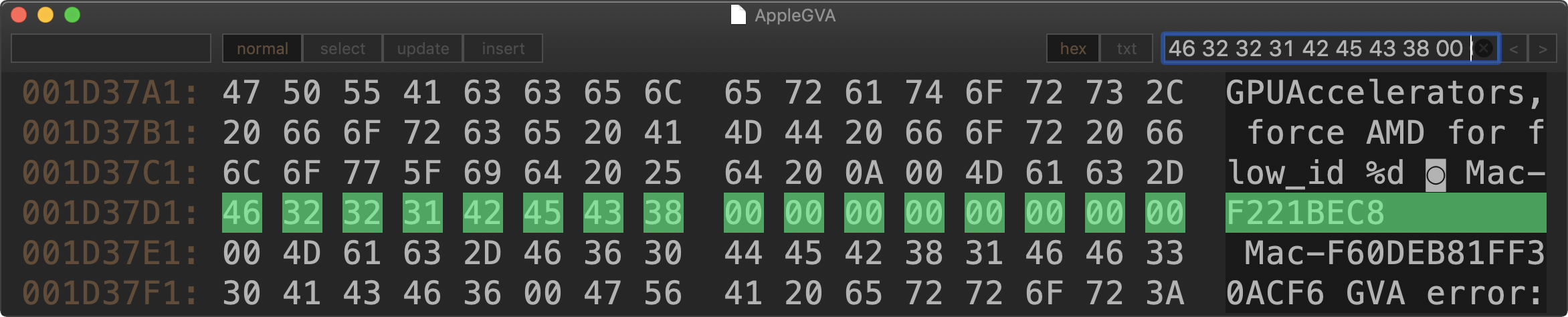

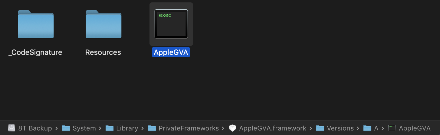

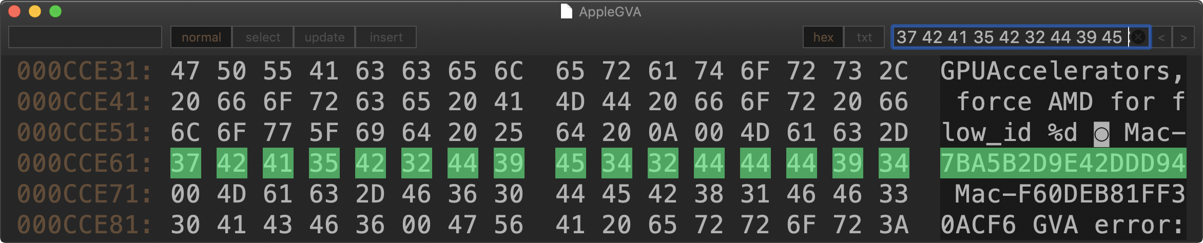

10) continue to Version -> A, and locate “AppleGVA” (this file has no extension)

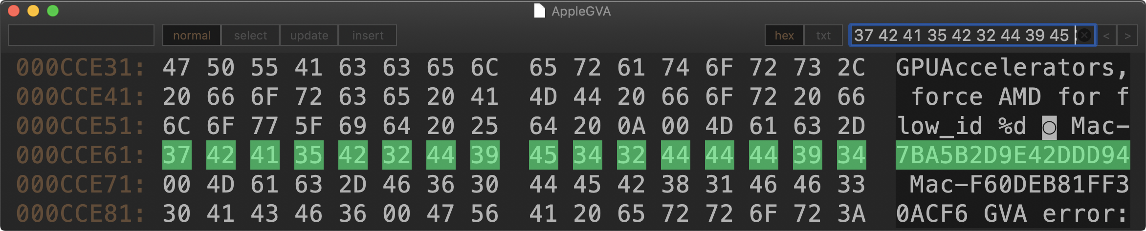

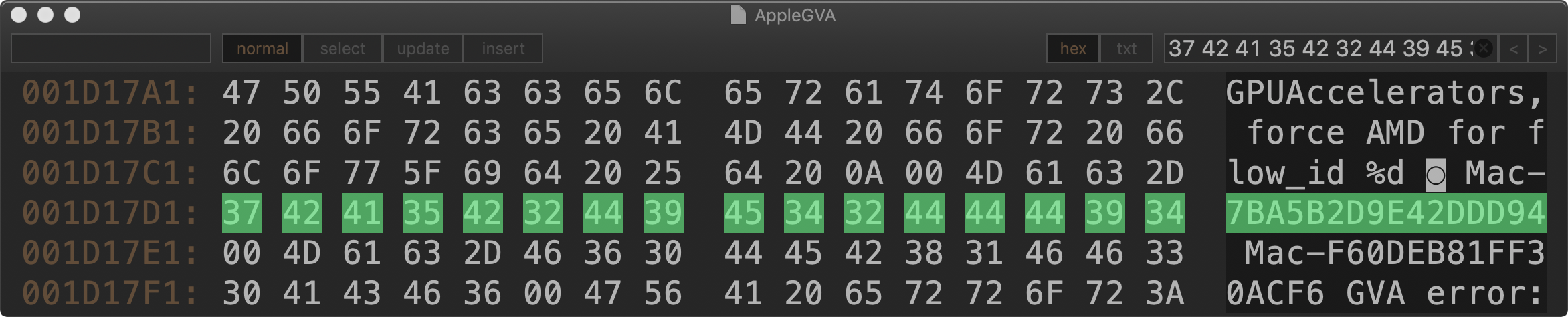

11) open this AppleGVA file with a Hex editor.
12) find 37 42 41 35 42 32 44 39 45 34 32 44 44 44 39 34 (should have TWO match result in Mojave. If you want to try this in 10.15, you may find only one result)
View attachment 841940 View attachment 841939

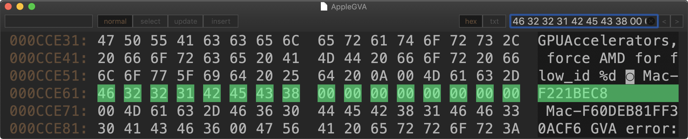

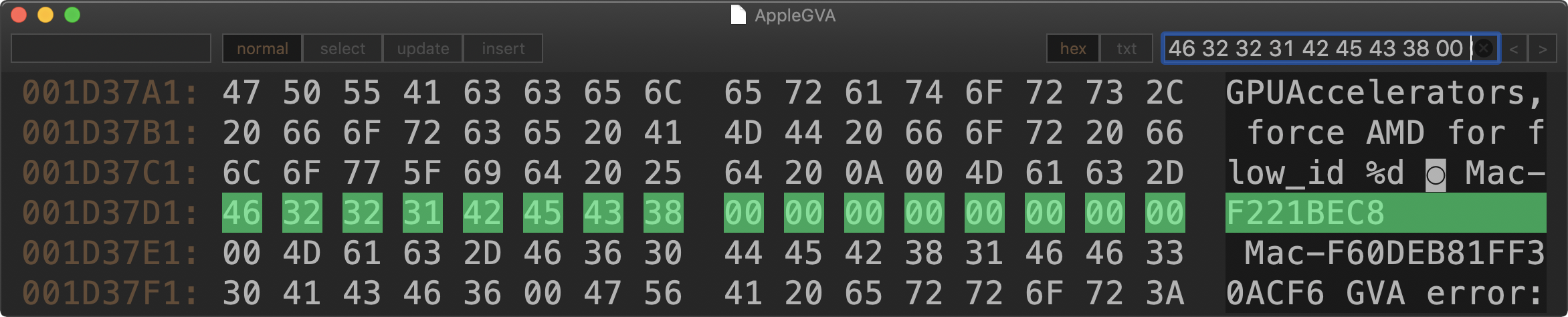

13) replace BOTH by 46 32 32 31 42 45 43 38 00 00 00 00 00 00 00 00 (make sure you replace the original byte, NOT insert).
View attachment 841942 View attachment 841941
14) save the file

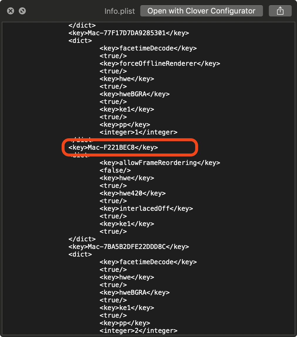

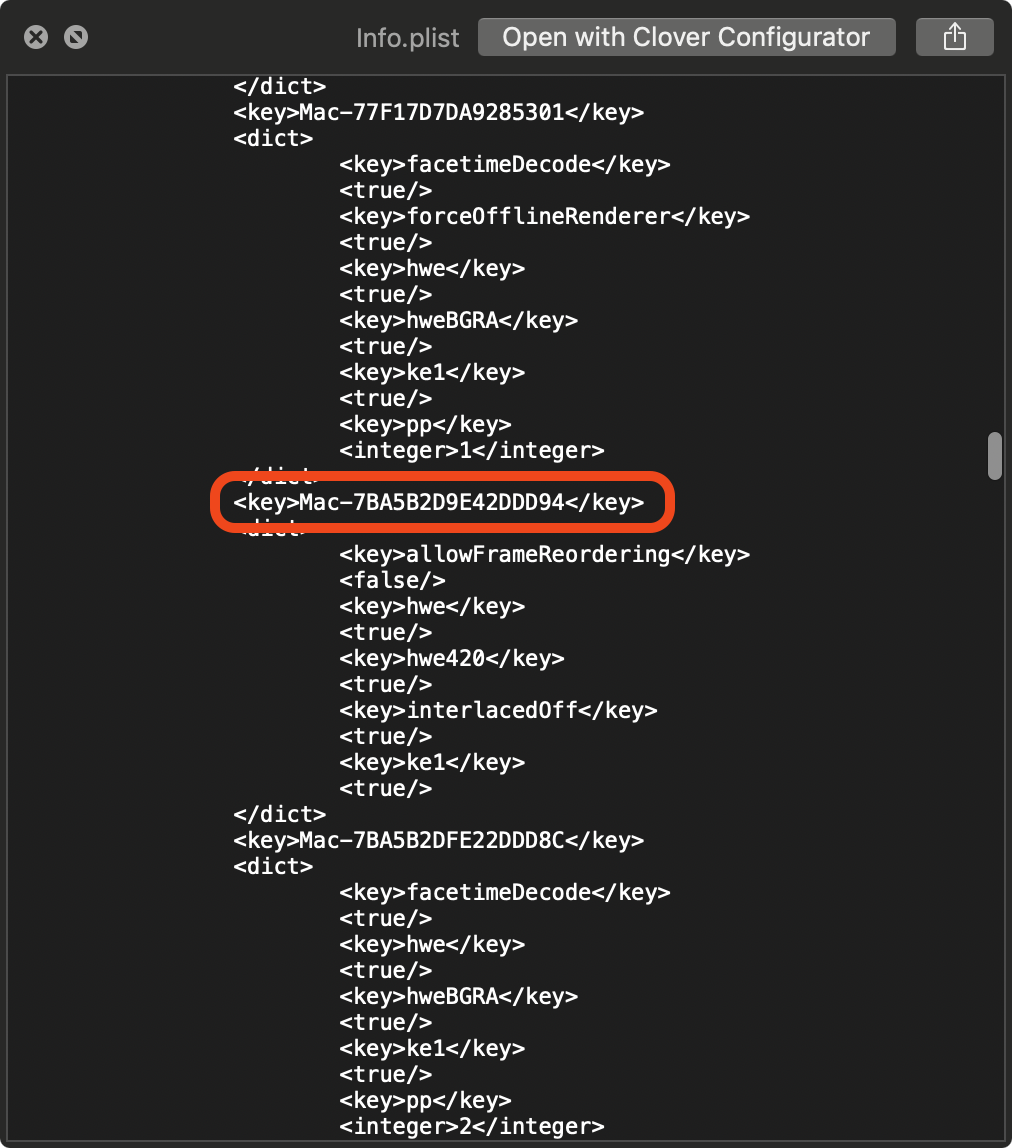

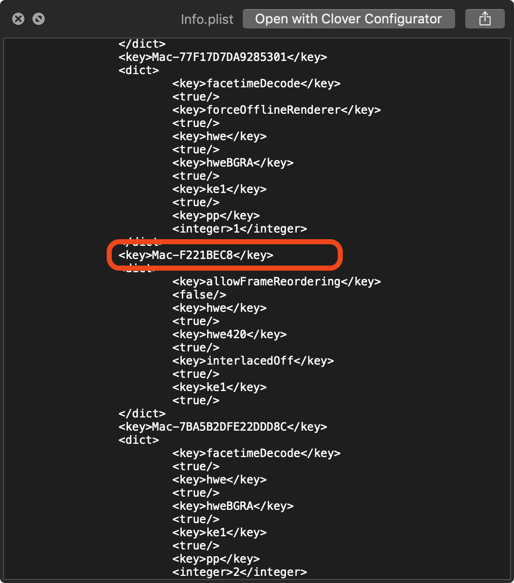

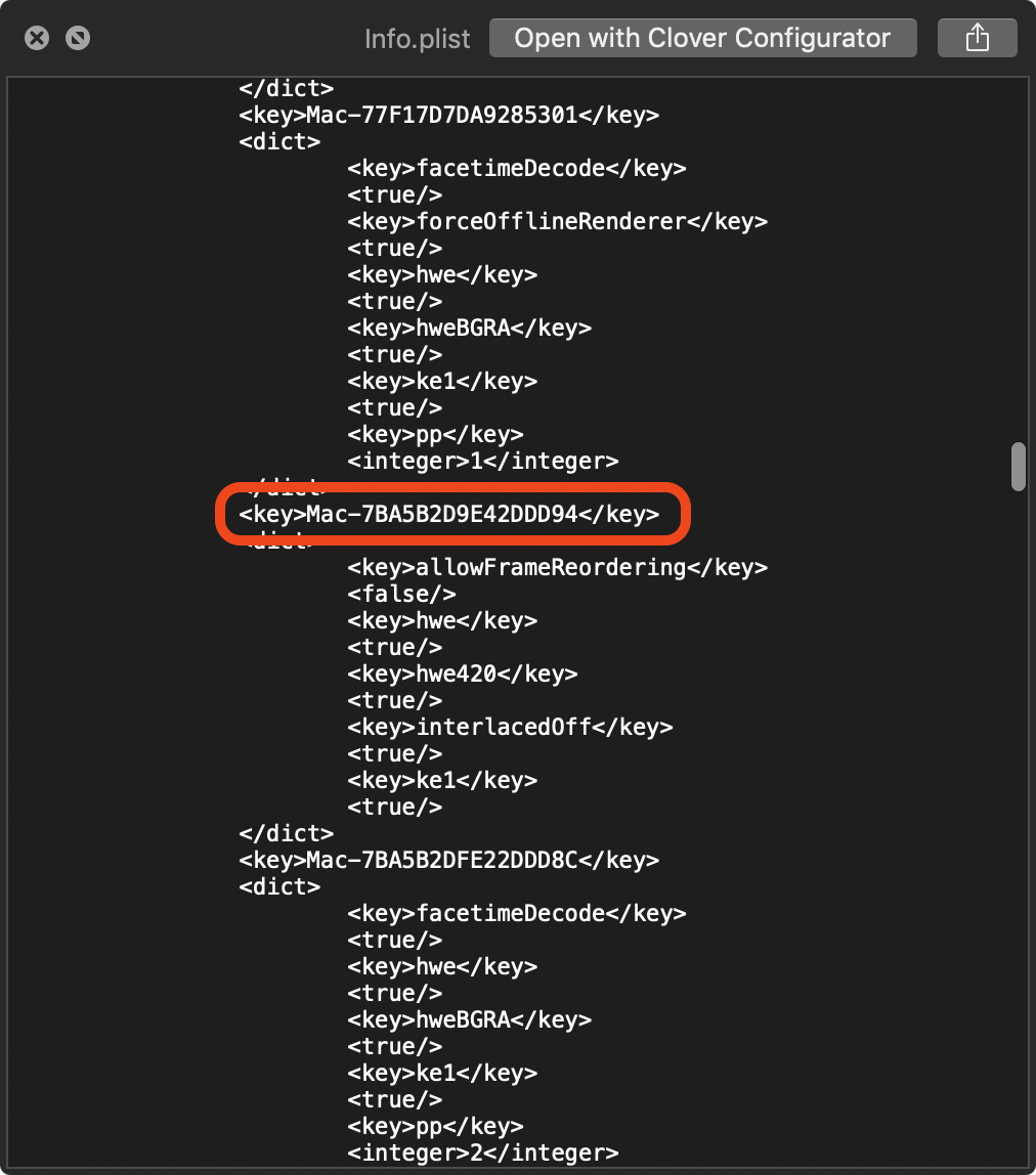

17) in Finder, in that folder “A”, continue go into folder “Resources”
18) open the info.plist with text editor
19) search 7BA5B2D9E42DDD94
20) replace that by F221BEC8
21) Reboot.

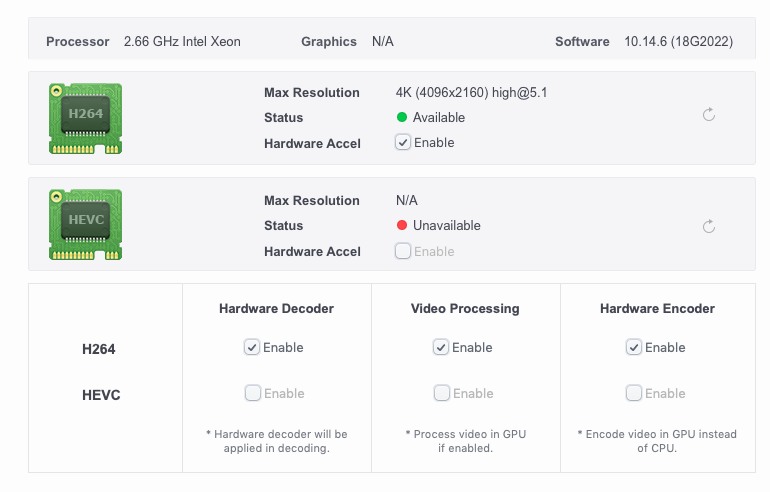

Hi and thanks for the mod! I followed it and now I get this:
Is it normal for the the HEVC acceleration to be disabled?
Once again, thanks a lot!

Just tested, no problem for both H264 and HEVC conversion in Handbrake with VideoToolBox in Catalina
Could it be your Vega card vs my Polaris (rx 580 pulse)?
I am not sure, but H264 HWAccel should be OK, Apple only removed the HEVC HWAccel for Polaris in 10.15.2
If you use Hex edit method, please restore the edited files, and try latest Lilu and WEG.
