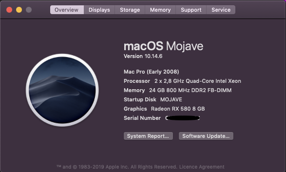

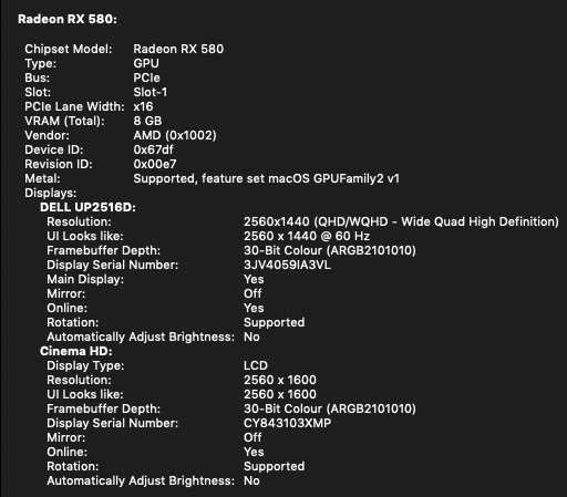

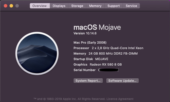

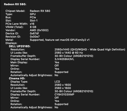

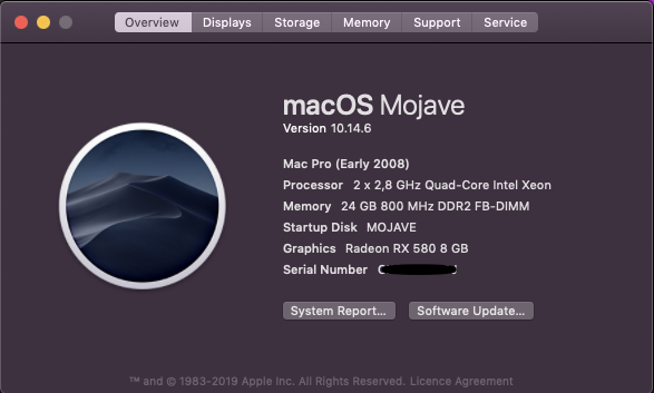

Hi all, found some promising info here and very detailed descriptions. thanks! I've tried the latest opencore package on my cmp 3,1 from 2008. It has the Radeon RX 580 pulse /8gb edition. I used and USB stick with an EFI Partition to be on the safe side, instead of my boot drive. up until now, no bootscreen or orinoco frame buffer. (confirmed via Hackintool) Is there anyone with a 3,1 that has managed to get this working via opencore 0.5.8/9 package? Or for that matter with the same non flashed card via another way? I'd like to have the acceleration. I can confirm though that 10.14.6 is way better for fcpx 10.4.7 than Catalina 10.15.4. GPU support seems to be broken or an there is some incompatability (like apple removed support...) in that case.
/edit. @h9826790 , do you have any thoughts on my situation?

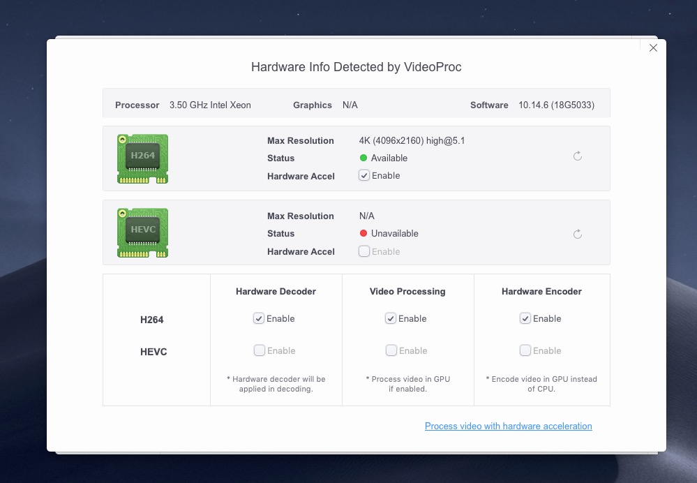

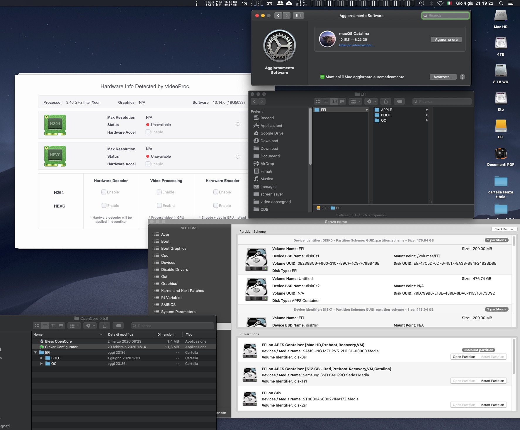

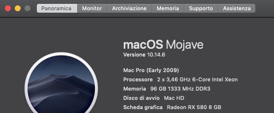

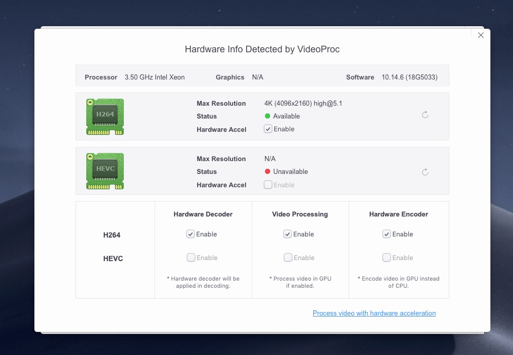

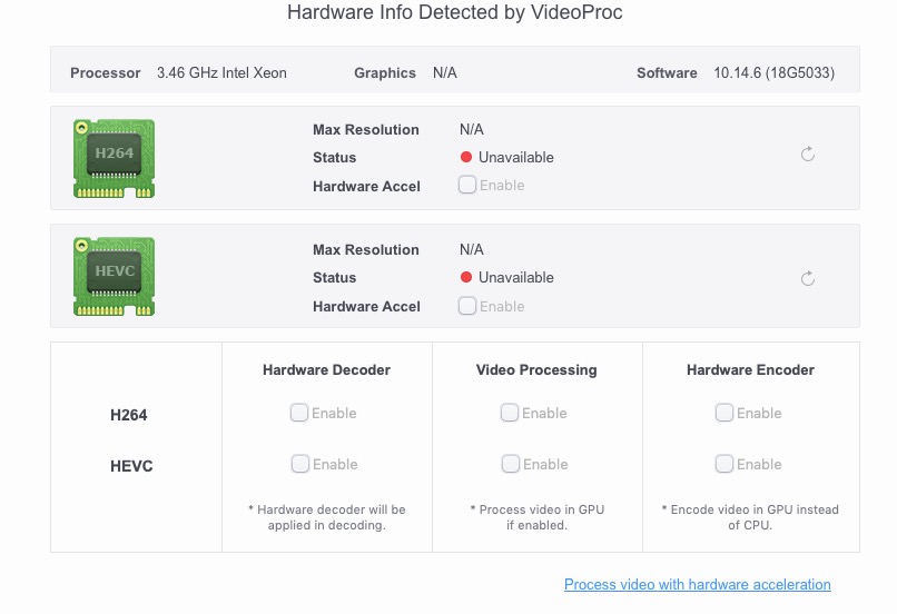

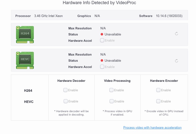

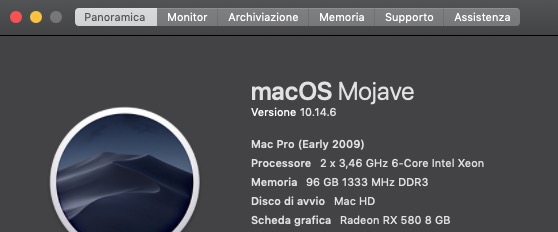

Hi everyone I installed open core 0.5.9 on mac pro 5.1, with mojave 10.14.6, I installed catalina on another disk .... but on mojave hardware acceleration (h264 and hevc) is not activated what to do to activate ? thanks
You haven’t boot via my OC package yet, please remove the installed files, and try the whole procedure again (please make sure you follow the exact procedure, e.g. install OC at EFI folder, but not EFI partition root directory)

yes I downloaded that
and followed the video to install ...
and I replaced the config file that I found here: file config
I have a white initial screen with apple and disk selection ... didn't I have to replace the config file?
Thanks
Thanks
NO, my procedures never ask you to replace the config.plist.
You are lucky, because both cdf and me keep our shared files up to date. And the config base on the same OpenCore version.
NEVER do this again, config files not necessary work with others package. You should either follow exact cdf's procedures, or exact my procedures.
thanks..

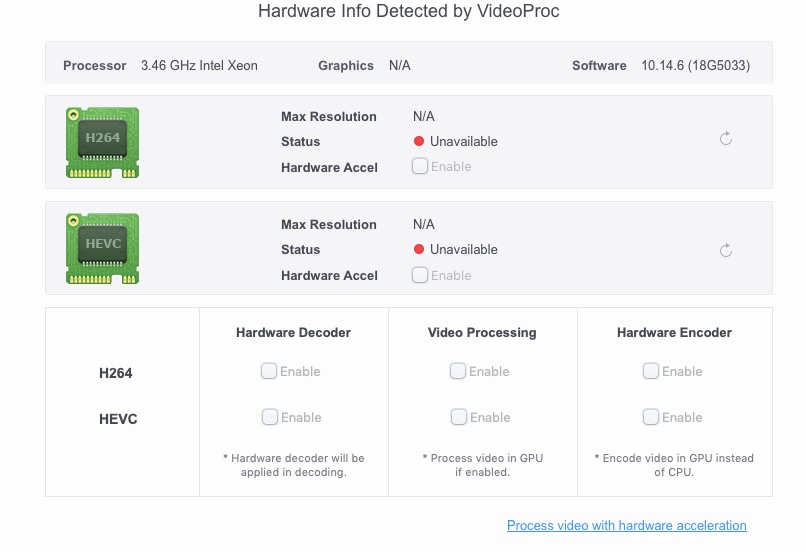

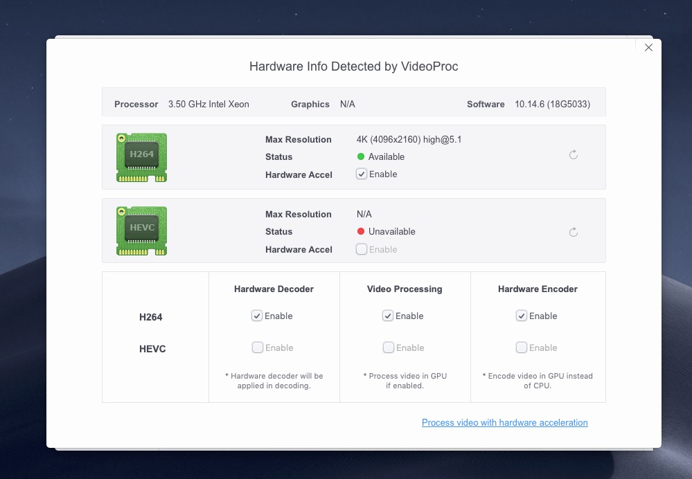

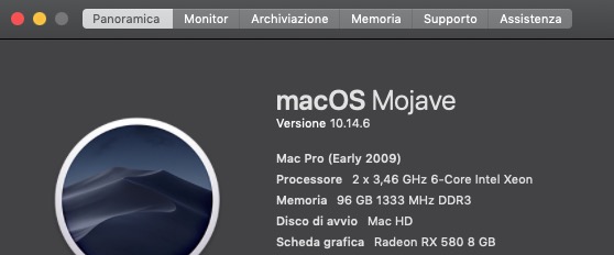

I re-downloaded your package,I deleted the one installed before and followed the video procedure but the hardware acceleration is not activated ...
I have the initial white screen with the apple .. also gives me update to catalina available

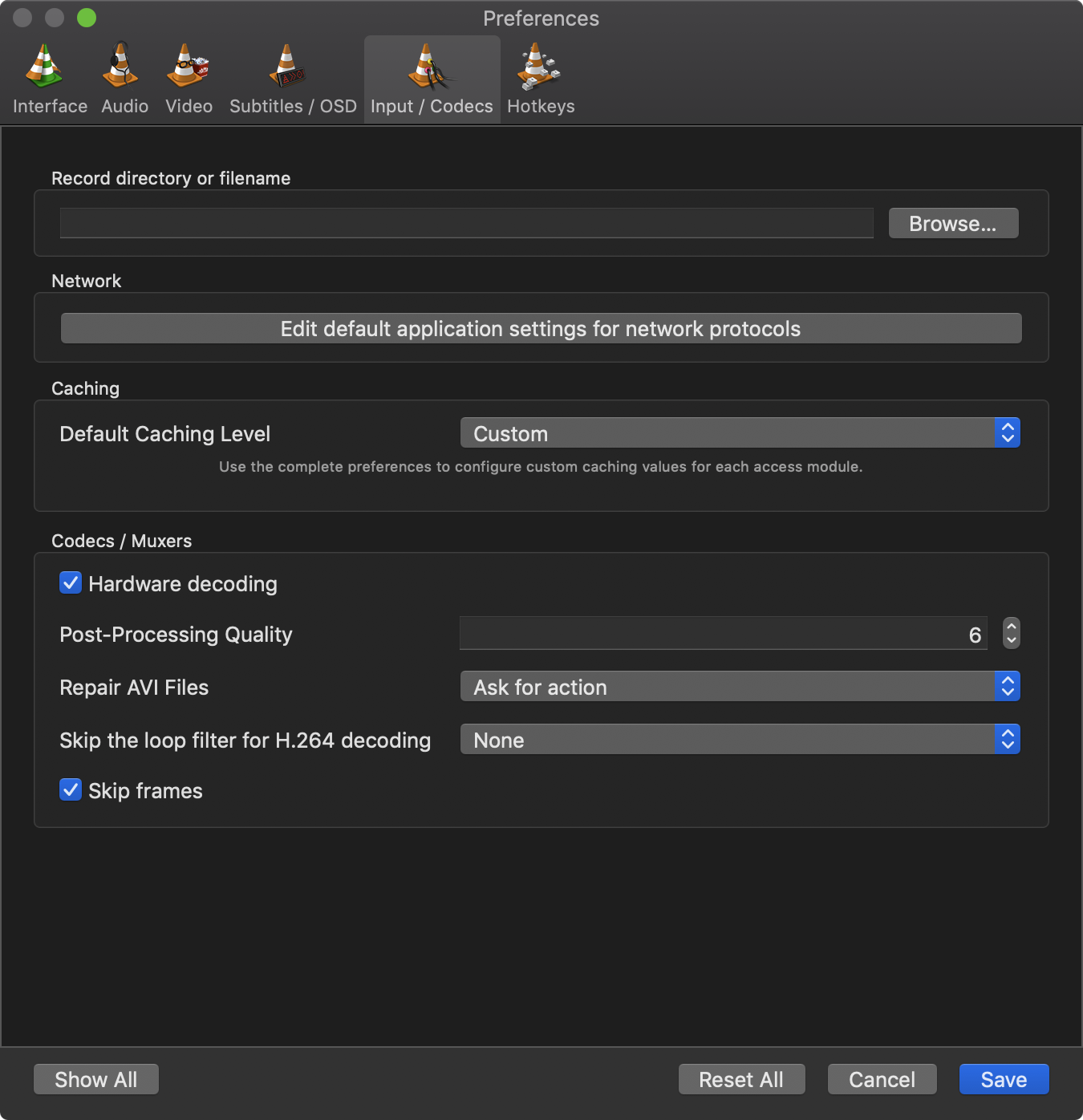

Did you enable hardware decoding in VLC?
Reactions: pierrox
D'Oh! I was using an old version of VLC. I updated, and now even the 400 Mbps 10-bit HEVC video plays smooth as silk. Moreover, both the CPU and the GPU appear to be nearly at idle - the machine isn't even breaking a sweat.
