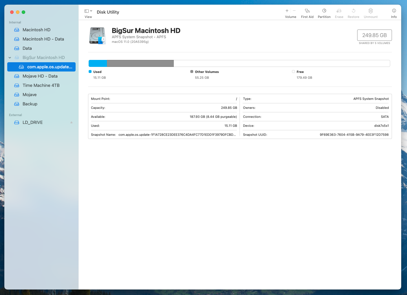

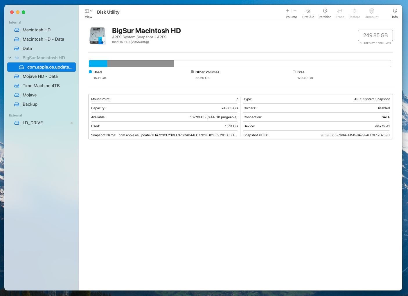

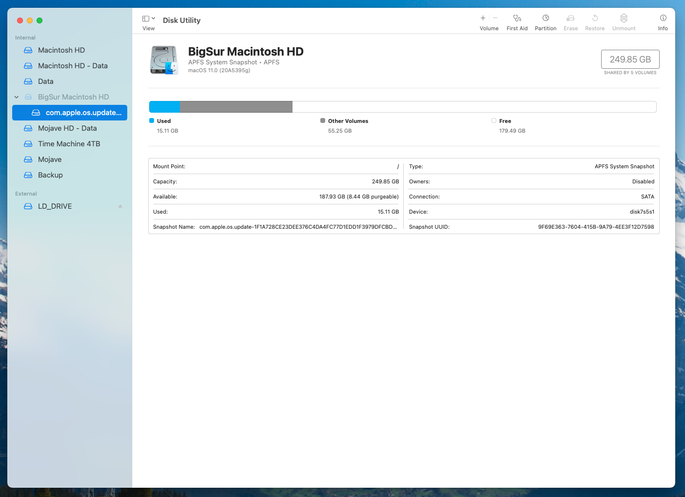

But I have problem that update said I need the full installer to update and there is snapshot mount to my system and the disk show unmount...
System is successful to beta 10 and work normally but only this happen...
Attached is what I see in disk utility. I am use imac pro simulation to update
Yes! when updated to beta 10, hardware encoding resume to normal.
Attached is what I see in disk utility. I am use imac pro simulation to updateView attachment 967845
I am a bit confused. So, you successfully install beta 10, but just need to use the full installer. Is that correct?

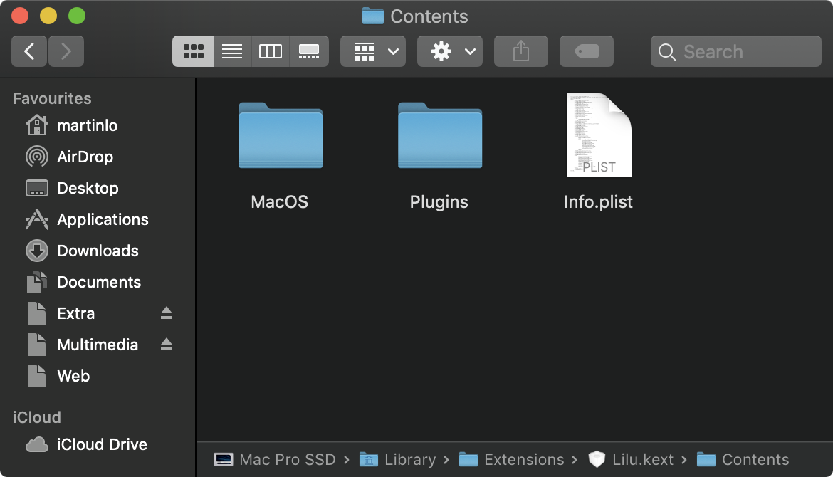

4) open Lilu.kext (right click -> show package contents)
5) enter Contents
6) create folder "Plugins" (N.B. This folder is INSIDE Contents, please do NOT miss step 5)
7) Copy the WhateverGreen.kext into Plugins
8) Copy the whole modded Lilu kext to /Library⁩/Extensions/

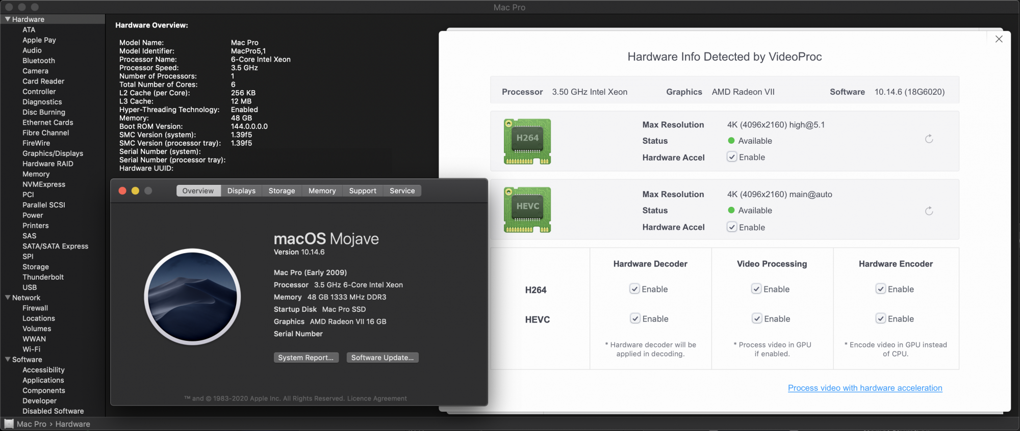

A: Able to play some very demanding HEVC video (e.g. this one)
https://4kmedia.org/sony-swordsmith-hdr-uhd-4k-demo/
This is how my cMP can play this video now. Smooth playback with very low CPU usage (please use a browser that support VP9 to watch all the following Youtube videos in 4k, otherwise, you may not able to read the details)

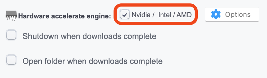

Q29: Why VideoProc shows nothing activated but everything seems working as expected?
A: As long as you can see this tick, which mean HWAccel is activated. From my observation, this tick always change automatically.
For the Hardware Info Detected page, please click the little reload icon in order to let VideoProc to show you the latest status.

Hi I did the method to the letter but only manage to get H264 acceleration and not HEVC. I’m using Mac Pro 5,1 (flashed from 4,1) two 3.46 xeons 96gb ram, boot drive nvme on Mojave and Radeon VII. Any suggestions on how to get HEVC to work?
many thanks
many thanks

Only thing is, VideoProc displays the hardware as being 4K enabled, and HVEC enabled, so all looks great there. But, exporting in FCP still seems to be really slow in exporting 4K videos. I'm running FCP 10.4.1
Thanks again though!! Seems I was scared for no reason.
