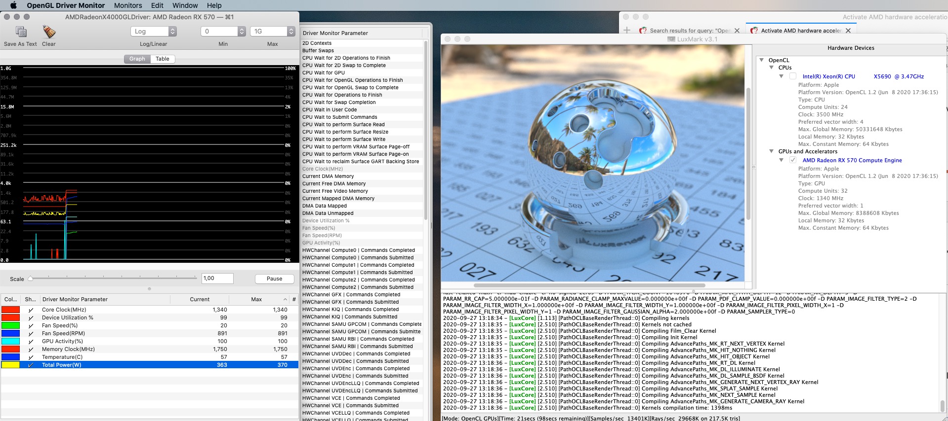

Just found that we can actually monitor the AMD GPU HWAccel activities by using OpenGL Driver Monitor.

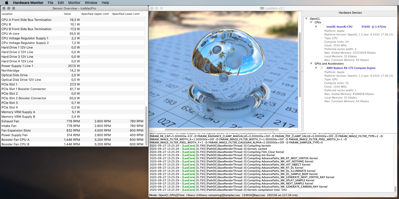

Does anyone has any idea why and how my RX570 Nitro+ can grab 370W? Btw. it's the same value the iStat Monitor shows in CPU -> GPU -> Power and it's totally different what Bresinks Hardwaremonitor shows up.
I am totally confused... :oops:
That's erroneous. You can safely ignore that.

With iStat, you should check the Boost A + B + slot current draw, then x12V to calculate the card's power draw.
e.g. Booster A - 5.5A, Booster B - 5.0A, slot - 5.3A
then the power draw should be around (5.5+5+5.3)x12 ~190W

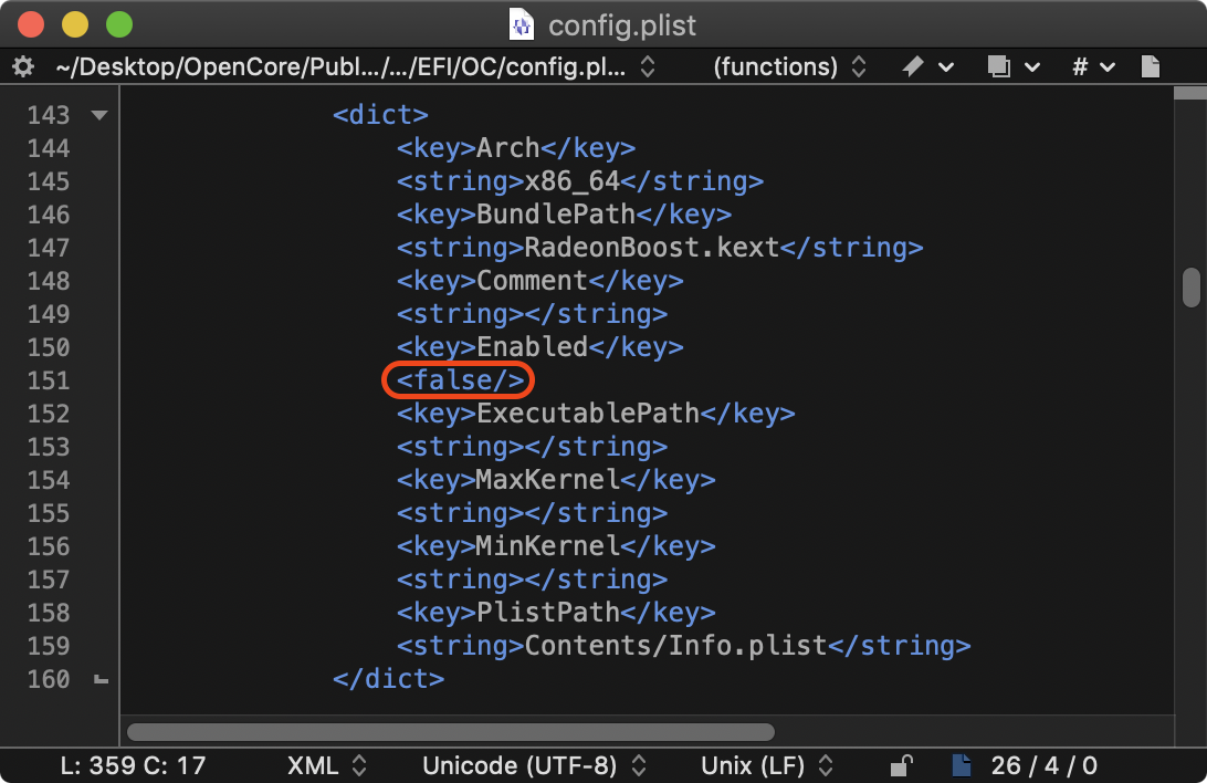

I noticed that you added RadeonBoost.kext in your latest package. Which version? What's the idea?
edit: typo in the kext name
Just because lots of people want that, therefore, I added that (V1.6) into the package, however, disabled.
Same as Thunderbolt support, the package just "ready" for it, but default to leave it off.

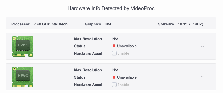

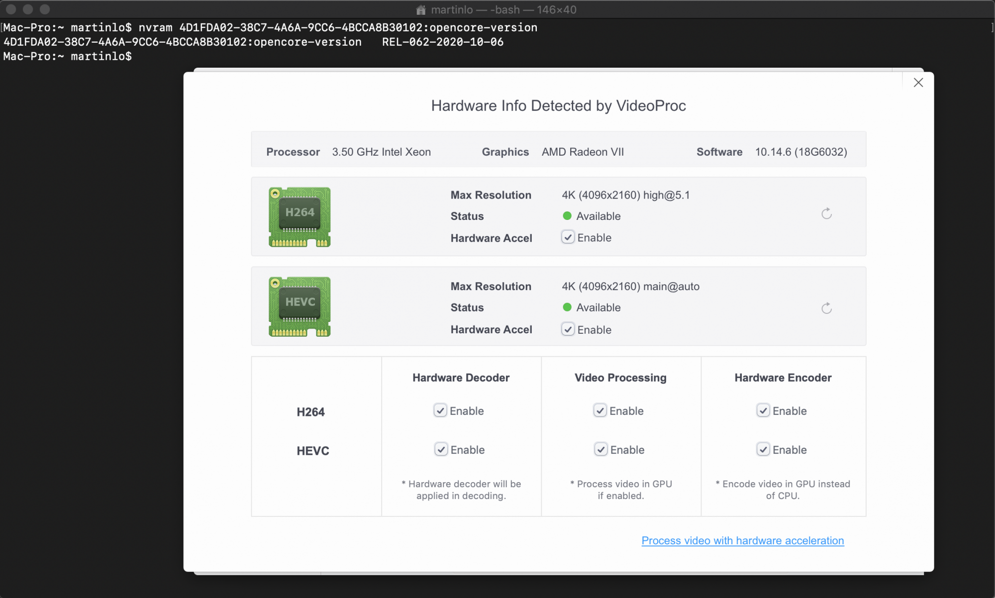

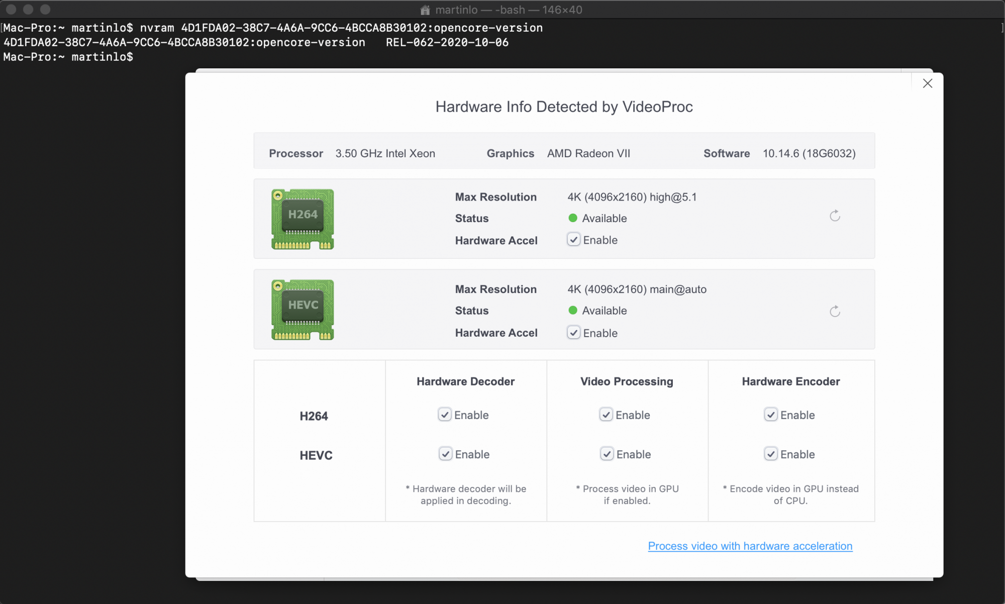

Hey Guys, did the hex method was able to get H264 up and running verified in videoproc however HEVC isn't enabled still, is this method solely for h264 or did I muck something up?

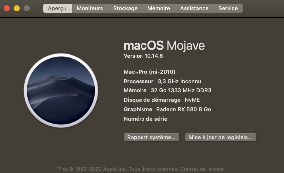

Hi everybody,
Thank you for all this shared work ...
I have the exact same problem as RottenCotton :https://forums.macrumors.com/threads/opencore-on-the-mac-pro.2207814/post-29006014
boot_3-jpg.964771
cMP 5.1, 3.33 Gh, XFX 580.
I get the same screen with weird colors. I tried several solutions: the small switch on the card in the 2 positions does not change anything. I tested “DirectGopRendering = false”, it doesn't change anything.
Please does anyone have an idea?
Everything else works without problems, hardware acceleration etc ...
Thank you !

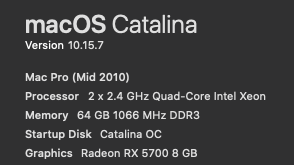

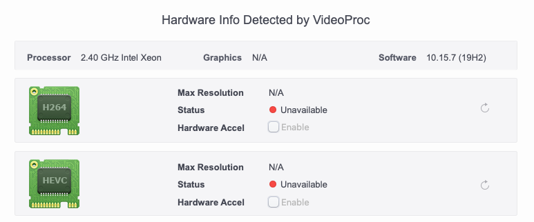

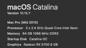

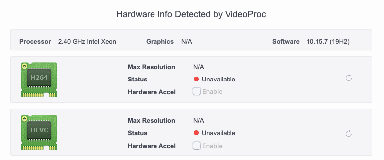

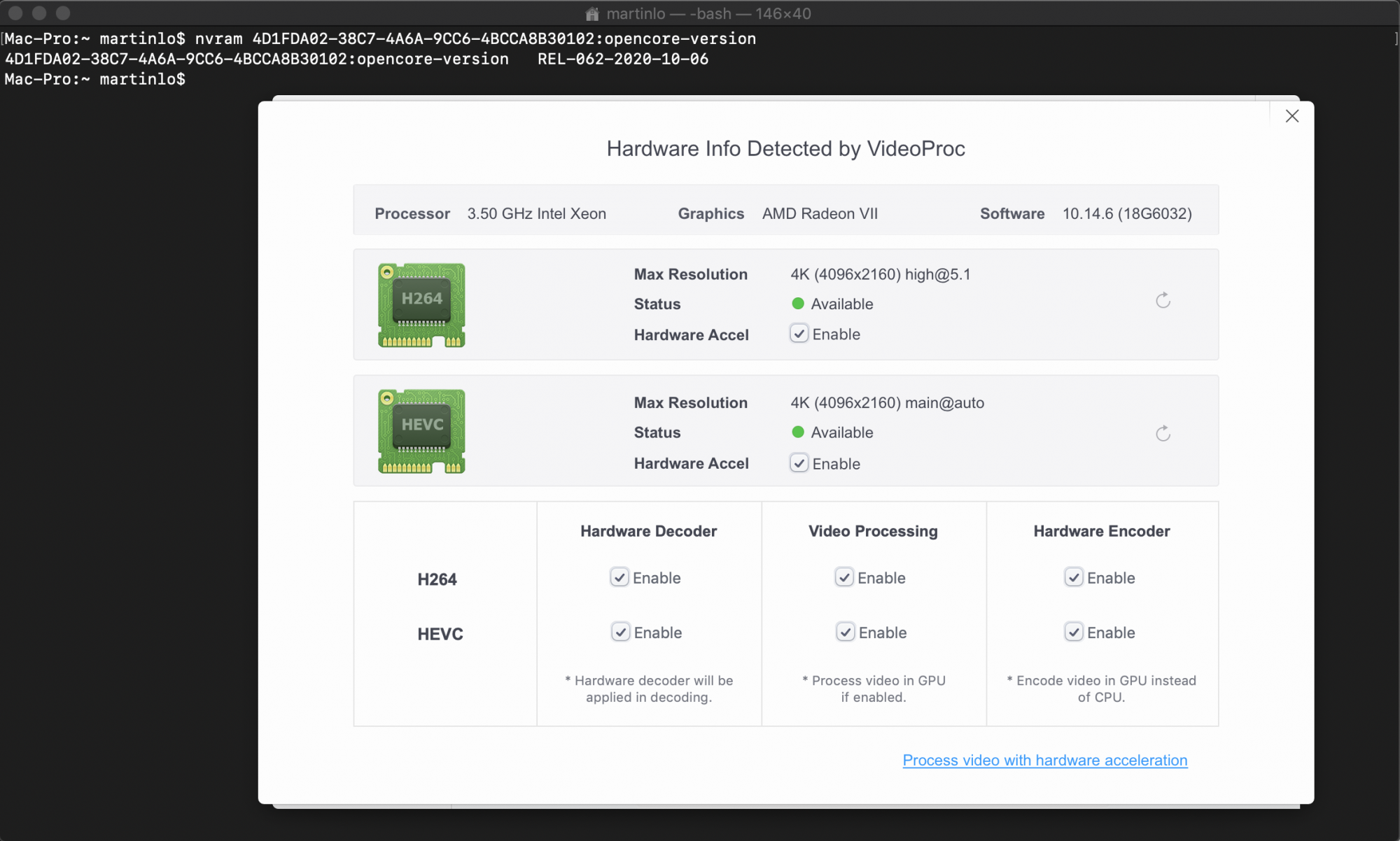

Hi,
thank you for all your great efforts.
I used OpenCore 0.6.2 package from post #1314 and followed all the instructions:
The systems boots fine with OC 0.6.2 but I don't get the AMD hardware acceleration:
As far as I understood the latest package version from post #1314 should provide the acceleration with the given settings. Or am I wrong? Are additional steps needed on my side?
Thank you.

Post #1 Q29
Thank you for the quick answer. I saw Q29 but I don’t understand it. I have the check mark ticked and I also clicked on the refresh icons many times but still it shows unavailable...? If I can’t trust this VideoProc app how can I verify it then? Thank you.
Try GVAdebugChecker
  • GVADebugChecker.zip
Thank you Pascal. Great Tool!

Sorry I am confused about disabling the SIP. The main post OpenCore on the Mac Pro doesn't mention anything about disabling SIP. The hardware acceleration seems to be slightly different from what is provided in post #1314.
I understood that one of the main benefits of Opencore is the security feature, so that you don't have to disable the SIP.
Anyway post #1314 speaks about disabling the SIP. Is it really necessary? Are there different variants to make it work? I though disabling SIP is only needed for the depreciated procedure mentioned here.
In my case it doesn't work with or without SIP disabled:
Code:
Filtering the log data using "composedMessage CONTAINS "GVA""
Timestamp               Ty Process[PID:TID]
2020-10-14 15:08:26.928 Df VTDecoderXPCService[1321:497b] (AppleGVA) GVA error: AVDLoadAllAccelerators machine not supported
2020-10-14 15:08:26.942 Df VTDecoderXPCService[1321:497b] (AppleGVA) GVA info: AVDLoadAllAccelerators metalId: 0, metalIdIsValid: 0, needToLoad: 1, gRefCount: 0
2020-10-14 15:08:26.942 Df VTDecoderXPCService[1321:497b] (AppleGVA) GVA error: AVDCreateGPUAccelerators: Error loading GPU renderer
2020-10-14 15:08:26.945 Df VTDecoderXPCService[1321:497b] (AppleGVA) [HEVC] GVA ERROR: Error creating the virtual accelerator
2020-10-14 15:08:26.945 Df VTDecoderXPCService[1321:497b] (AppleGVA) [HEVC] GVA info: Successfully disposed the main virtual accelerator
2020-10-14 15:08:26.945 Df VTDecoderXPCService[1321:497b] (AppleGVA) [HEVC] GVA info: Successfully destroyed the API interface
The above is with SIP disabled the first one was with SIP enabled.
Do I have to add following?
Code:
<key>Add</key>
<dict>
<key>PciRoot(0x0)/Pci(0x0,0x0)/Pci(0x0,0x0)</key>
<dict>
<key>shikigva</key>
<data>UA==</data>
<key>agdpmod</key>
<data>cGlrZXJhAA==</data>
<key>rebuild-device-tree</key>
<data>AA==</data>
</dict>
</dict>
Sorry for my ignorance. Everything is completely new for me and many things I am not able to understand yet.
Thank you so much.
Oh I am so sorry. I discovered the cause of the problem now. After the installation and update of Catalina I switched the VMM flag off and the SMBIOS spoofing on as recommended. But I made a little typo in the SMBIOS spoofing setting. So the spoofing was still off. After I discovered and fixed this everything was fine. Acceleration works nicely. :) Thank you so much. Great work!
Still wondering if the SIP still has to be disabled?
