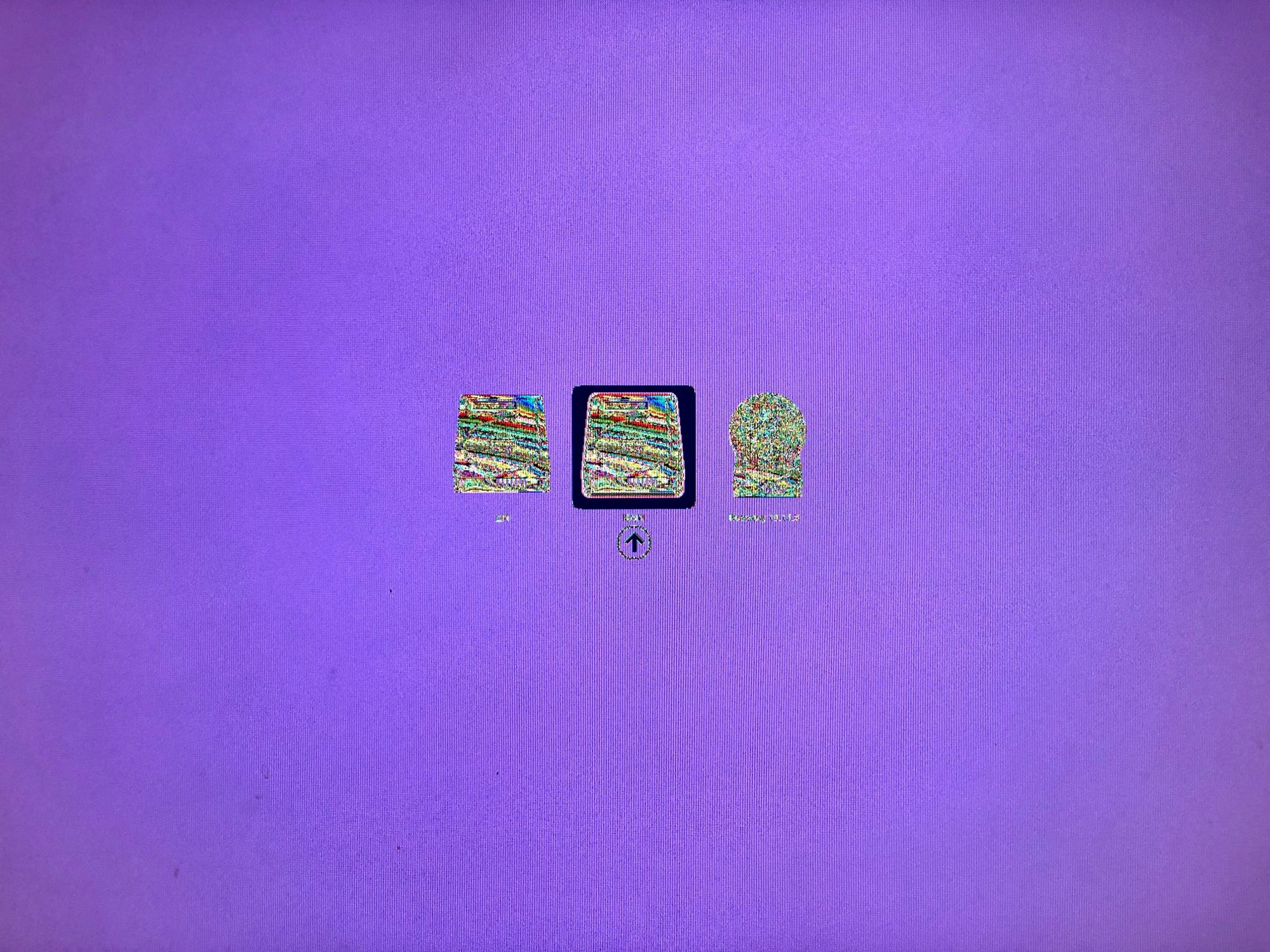

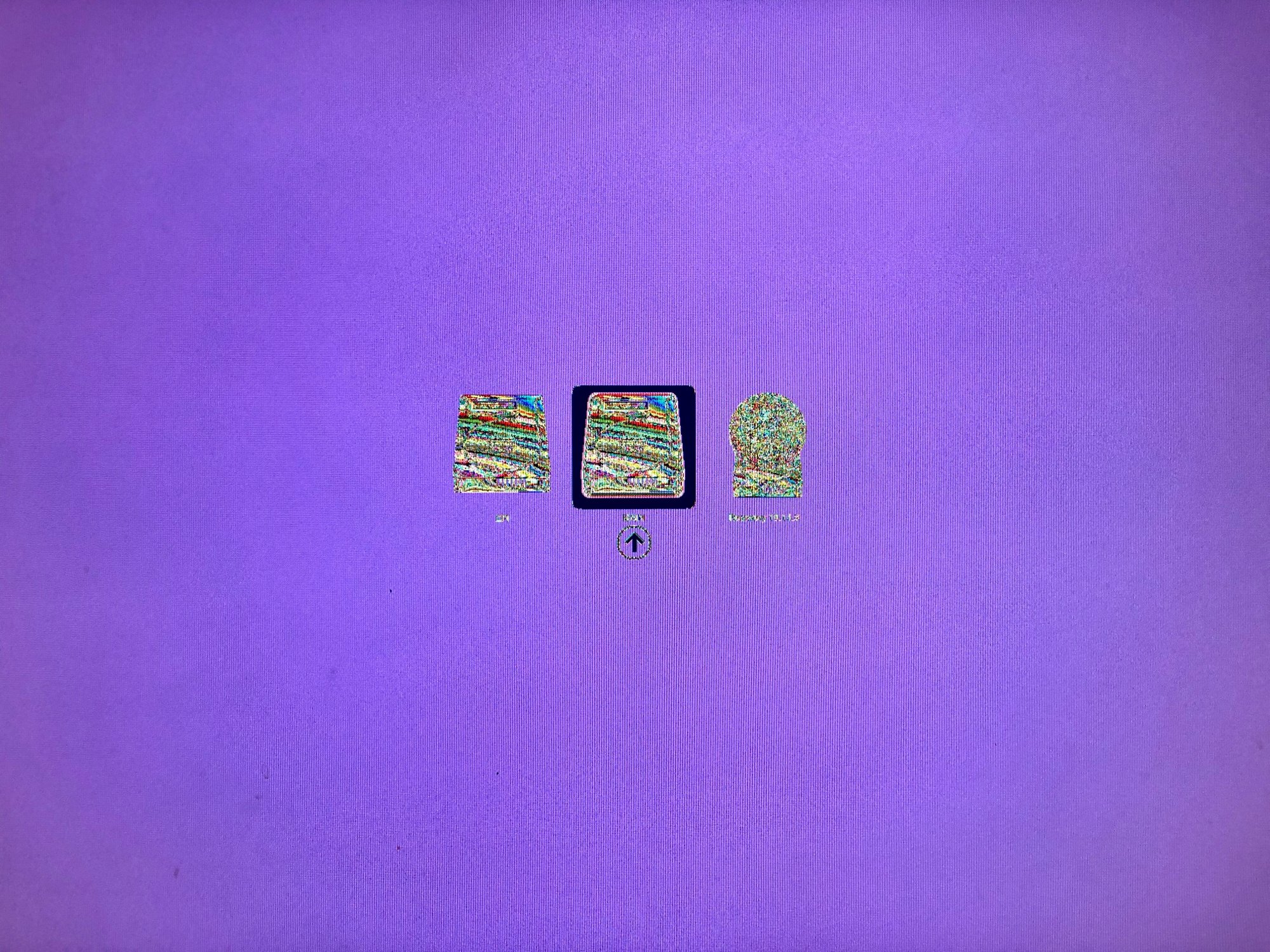

Everything's working great for me, with the exception of dirty graphics within the boot loader. Over the last 5 weeks, I've had clean images only once, and I don't know how to replicate it because it was completely random. Any help with this would be mucho appreciated :apple:

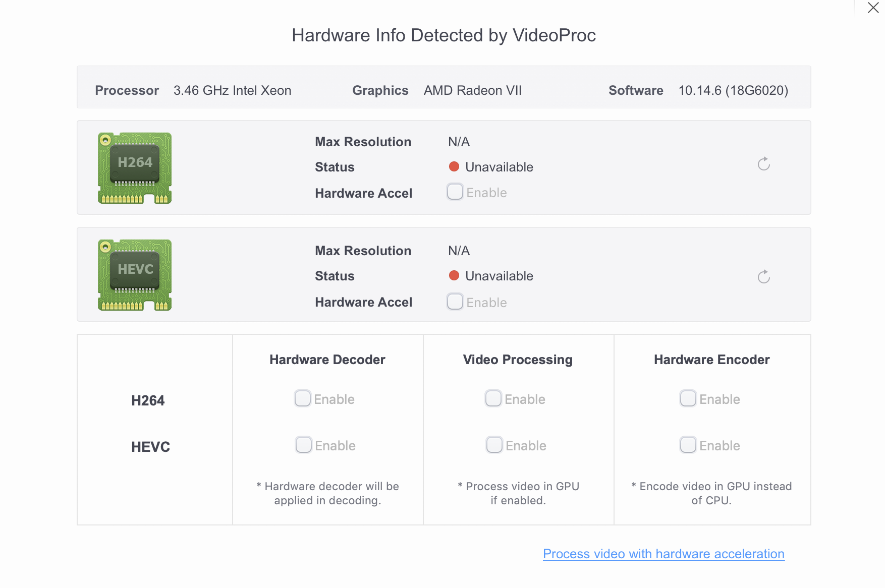

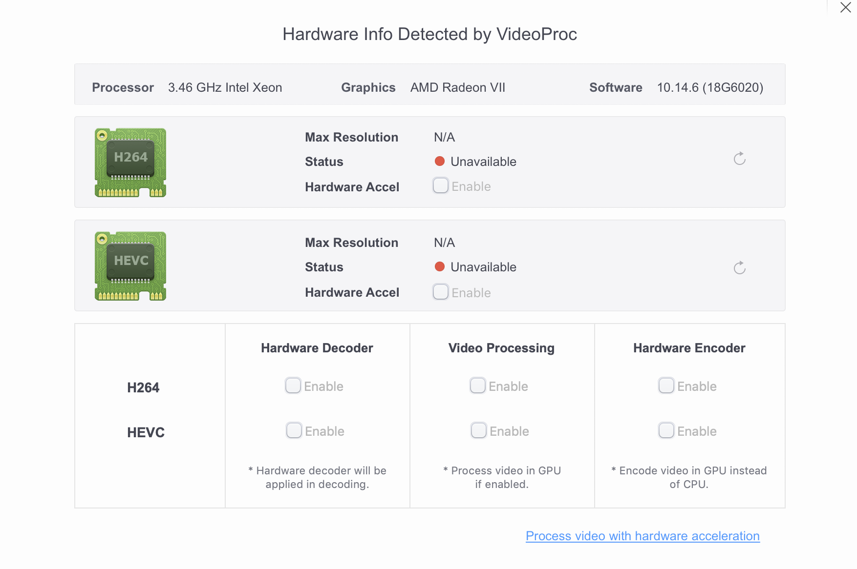

why i try this metode but stuck on logo apple no pogressbar, please help...
im using Radeon VII

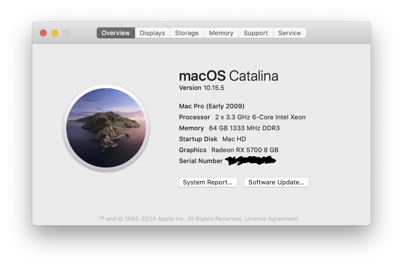

However, these two Mac have T2, it may be the reason why they can do it but we can’t (even we can also use AMD HEVC hardware encoding).
TBH, I believe there is a way to make it work, but I haven’t really look into this area yet.

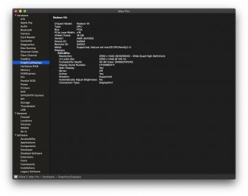

I've seen on the Hackintosh forums that they were able to run sidecar the exact same way is intended to run on compatible macs, so I am starting to doubt the T2 chip is a requirement

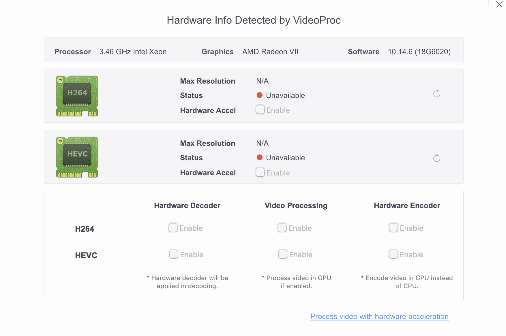

since i try Activate AMD hardware acceleration, previous normal no problem my mouse & keyboard
my mouse and keyboard I see on bootpicker not working, but I try to move and push return working, but on bootpicker cursor not seen move and mouse not show.
I try to reinstall open core and bless opencore and I try restart working fine, but next restart back to ubnormal
how to fix it?

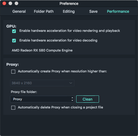

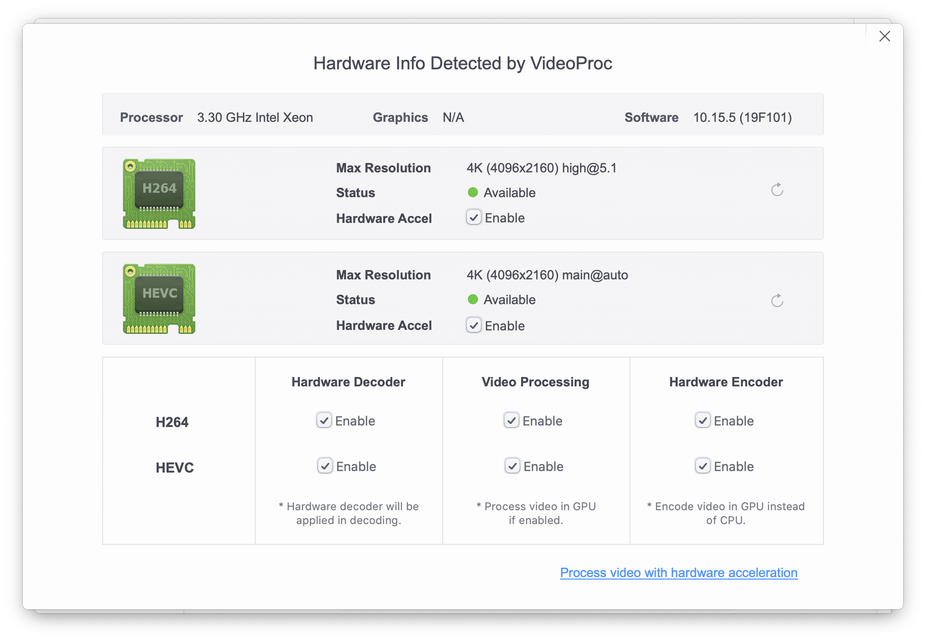

Anyone using Filmora 9?
It seems to crash whenever I try to export with HWAccel. Works when this is not selected.
I can play the jellyfish video and have this from VideoProc
Filmora Prefs:

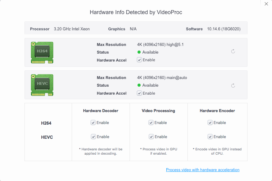

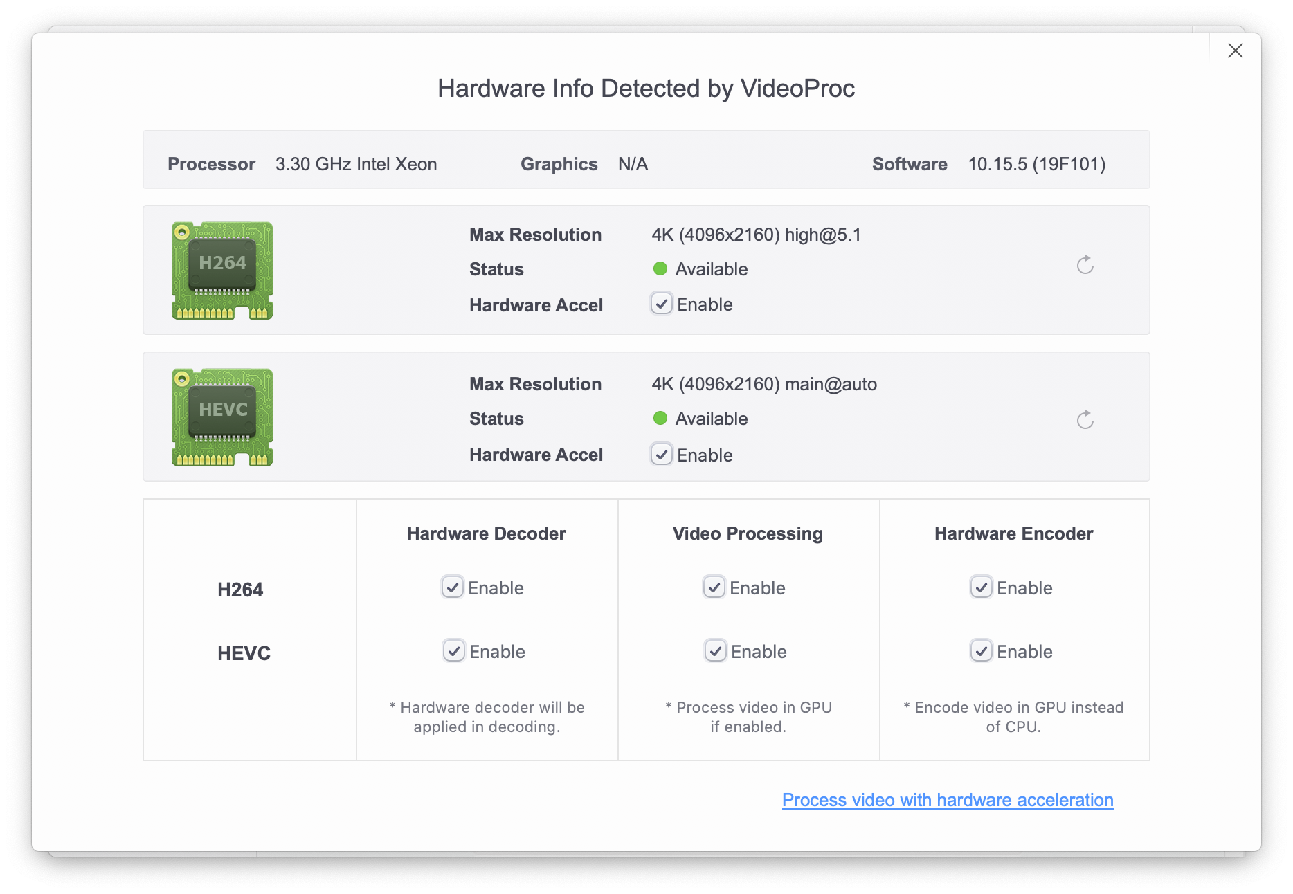

[For existing users, you can download the latest OpenCore 0.6.0 package at post #1314 for update]

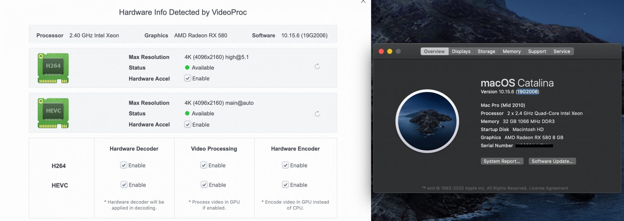

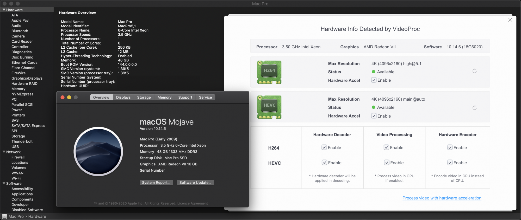

Full HWAccel achieved now!
Everything are covered in the OpenCore threads. The step by step tutorial is at here, but I strongly recommend you go through the whole thread before you do anything.
The same method works in both Mojave and Catalina. HOWEVER, for dual processor cMP user, please stick with Mojave at this moment. (Update: please stick to Mojave for ALL who want HWAccel. CMMChris advised Apple removed HEVC HWAccel for all Polaris GPU in the latest Catalina beta. Which means you may not upgrade the OS to get any security fix, unless this is an error in beta. Stay with Mojave, get HWAccel, and keep your OS up to date seems will be a better choice at this moment)
Sidecar (and AirPlay Display) should also work, but I have no iPad to test it yet. The latest config.plist in post #594 and #1314 will now keep the cMP ident as 5,1. Therefore, will NOT activate Sidecar by default now.

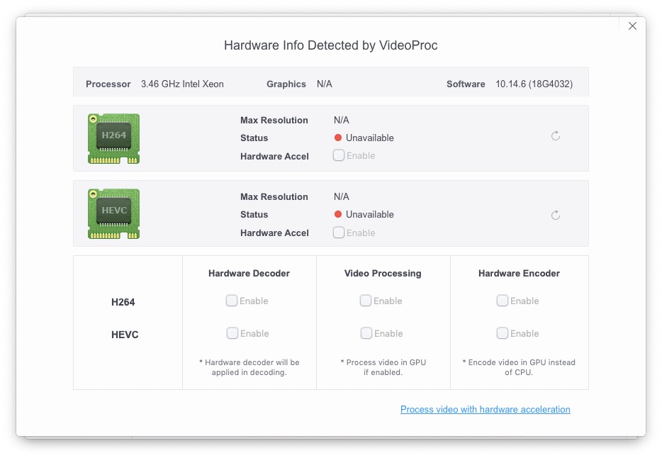

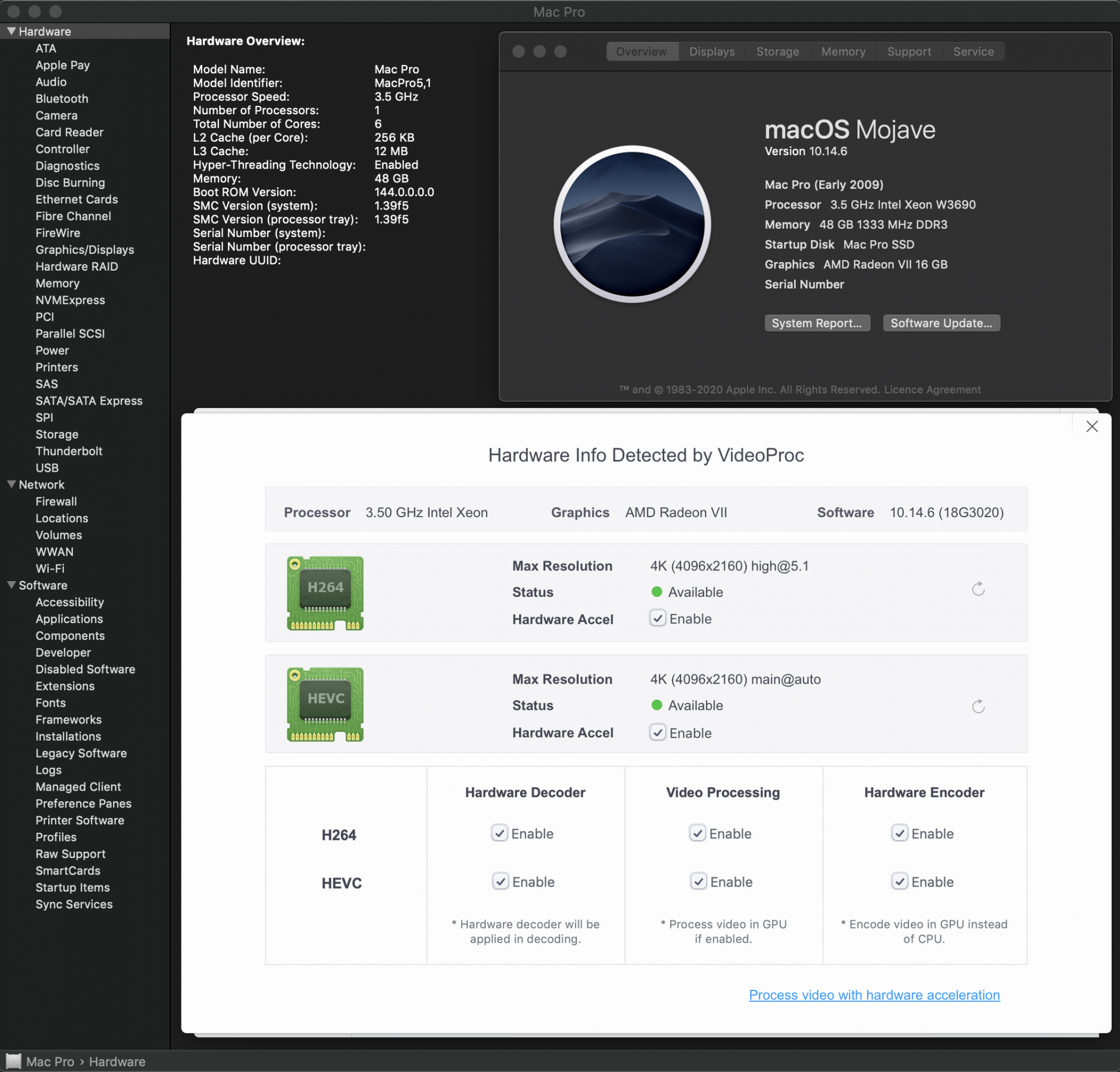

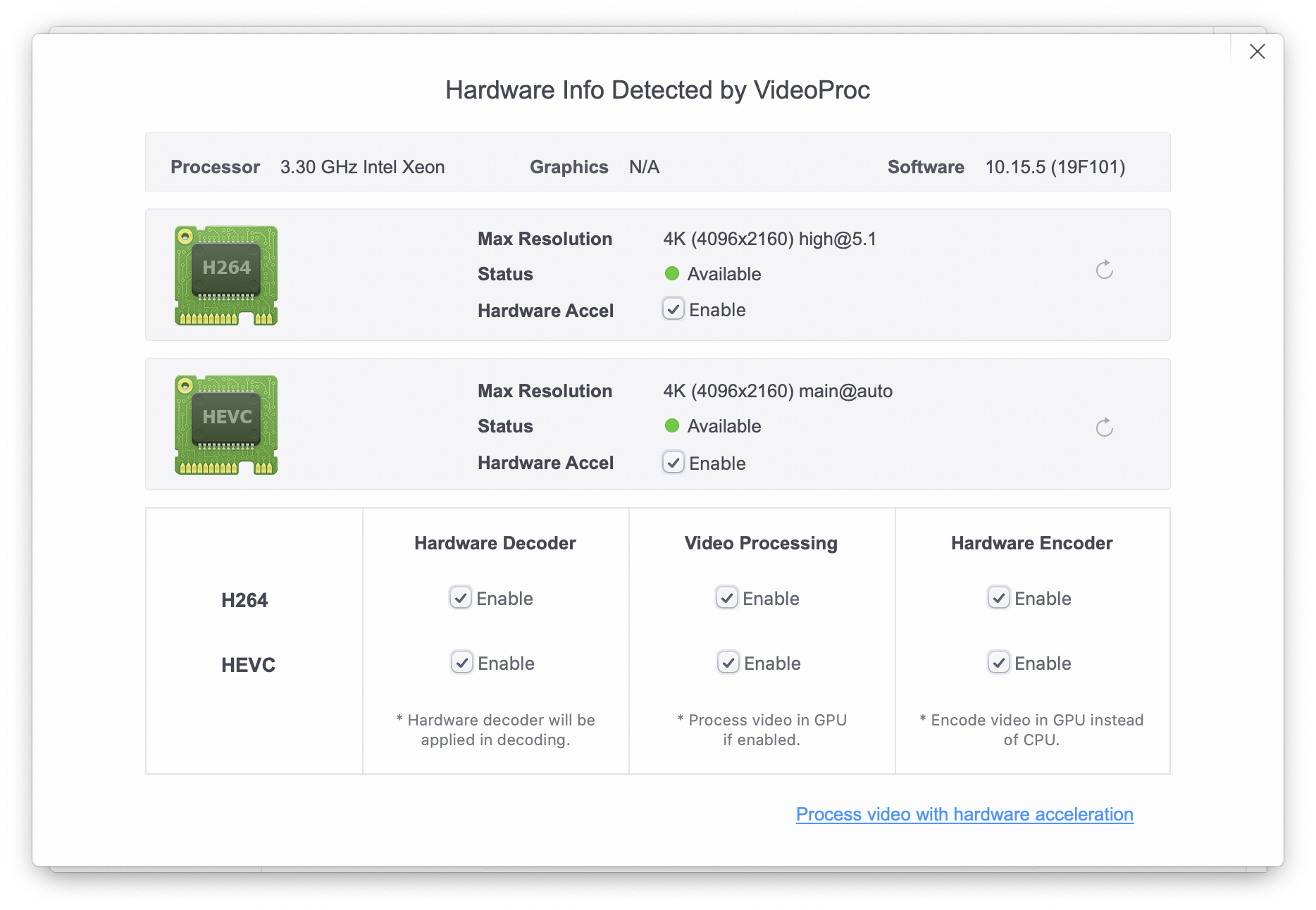

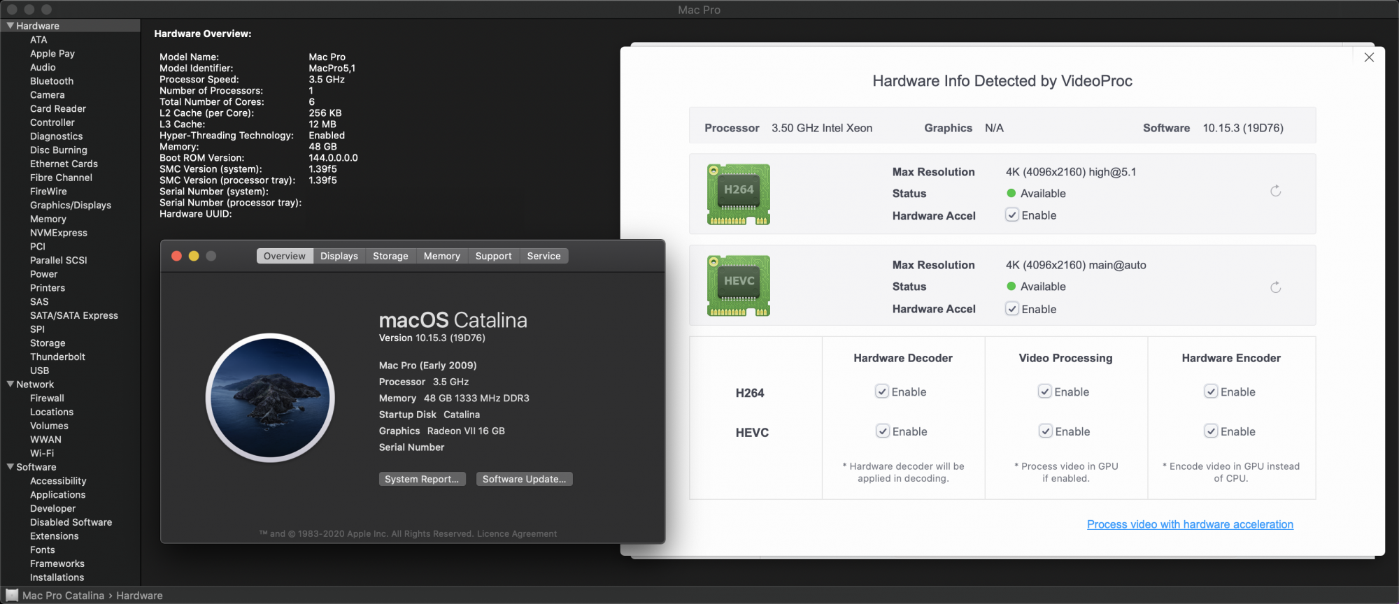

Q19: Why VideoProc shows no HEVC decode after the mod?
A: I don't know why, but this is normal in this case. My recommendation is to download demo HEVC video from the above link, and play it via QuickTime (or simply via Finder preview). As long as the CPU usage only stay around 20% (but not 800%), that means HEVC decoding is working properly.
For those who use OpenCore method, you should able to see HEVC HWAccel avail. If not there, please click the little reload icon.

Q27: Why the "Graphics" in VideoProc HWAccel page shows N/A?
A: No idea, but it's just a cosmetic error in this case. (Update: It seems VideoProc looking for the key word "AMD". e.g. If the card ident as AMD Radeon VII, VideoProc can show it properly. But if the card ident as Radeon VII, then VideoProc can't show its name)
Q28: Why VideoProc shows that I am use "Intel "HWAccel when converting videos?
A: Also no idea, but again, it's just a cosmetic error in this case.
Q29: Why VideoProc shows nothing activated but everything seems working as expected?
A: As long as you can see this tick, which mean HWAccel is activated. From my observation, this tick always change automatically.
For the Hardware Info Detected page, please click the little reload icon in order to let VideoProc to show you the latest status.

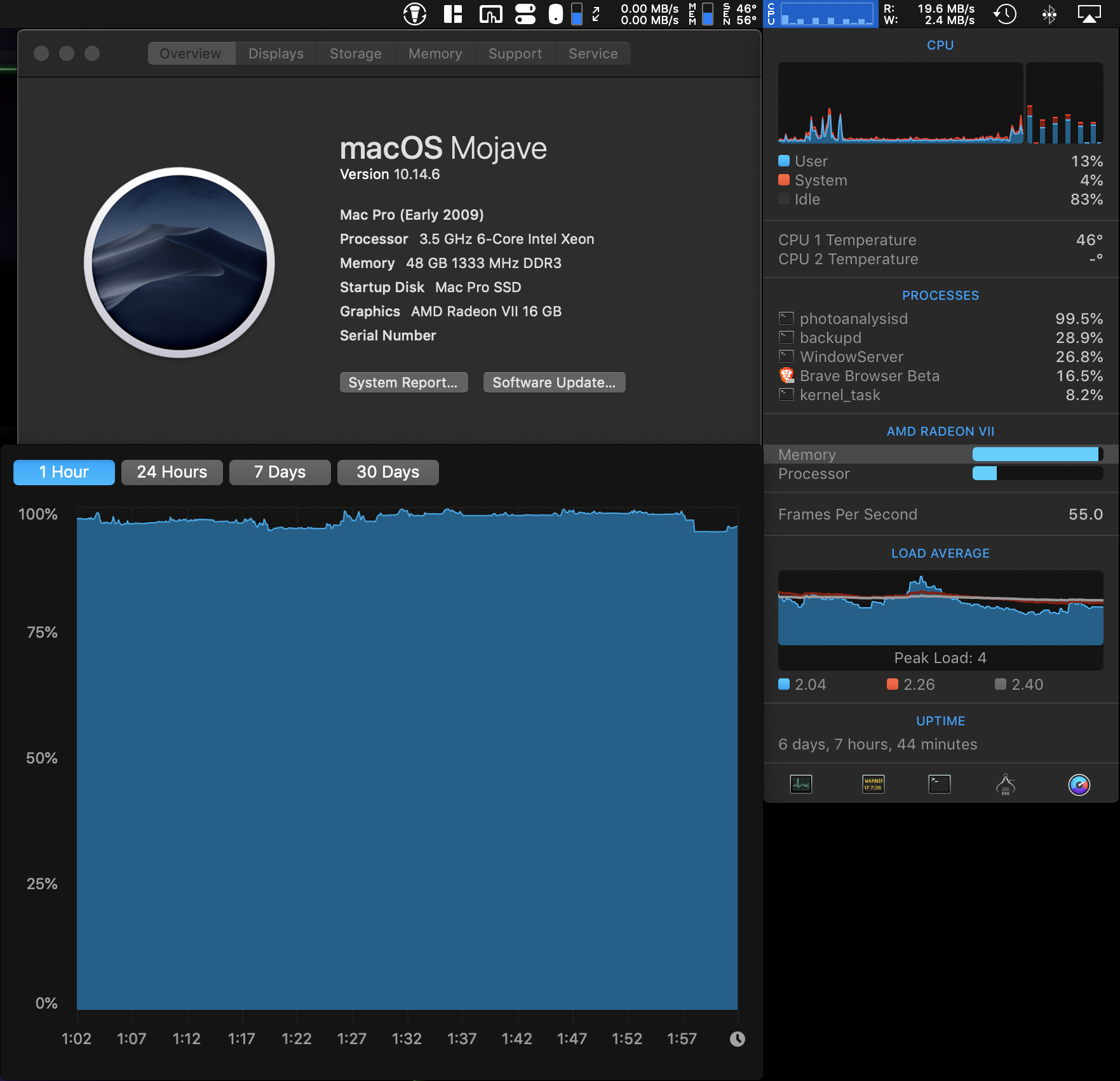

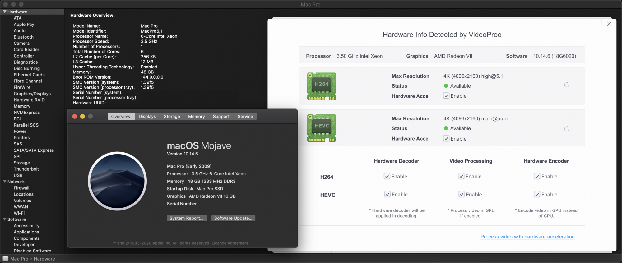

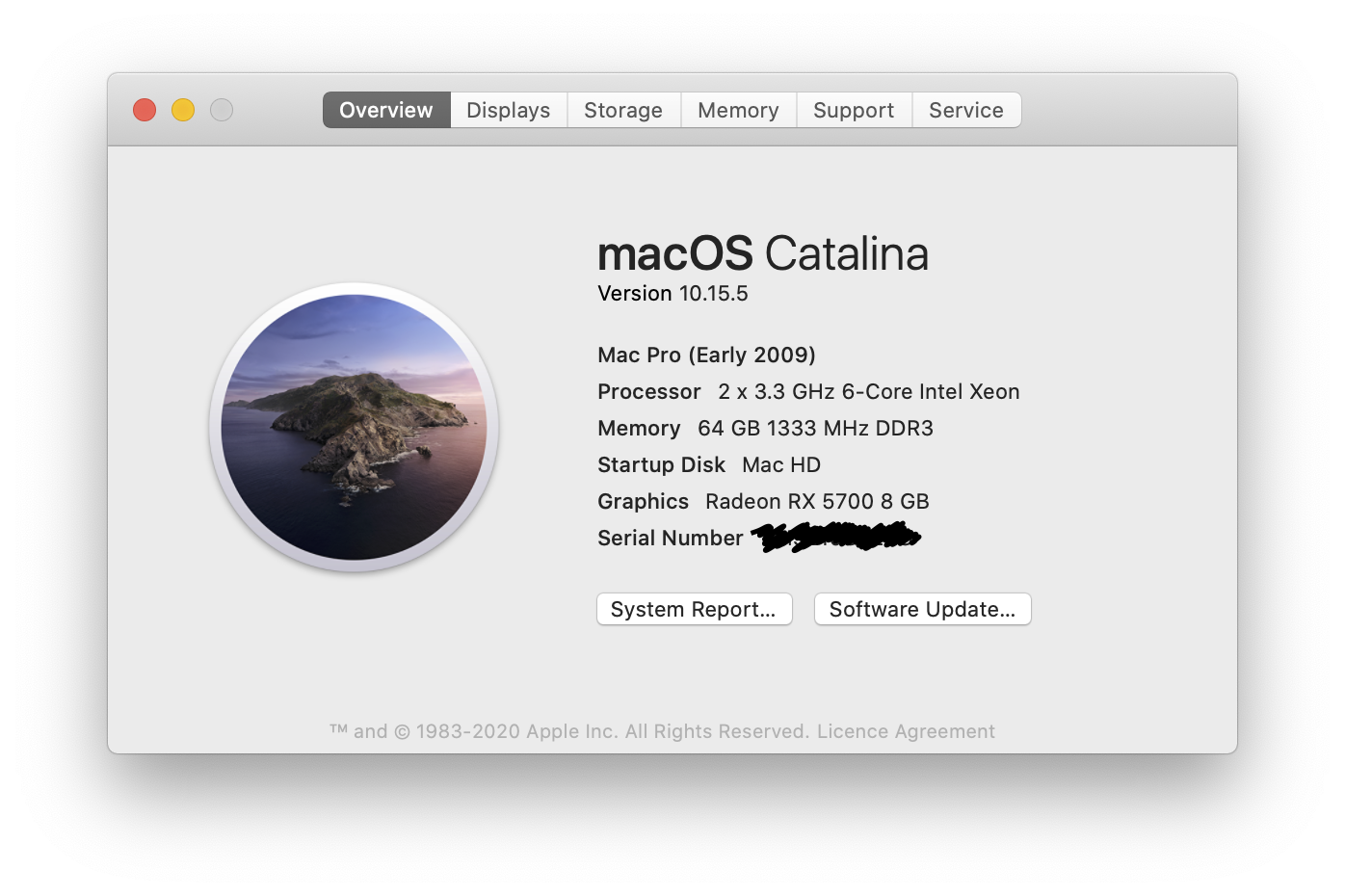

Hello,
I followed the guide in post #1314, AMAZING. looks like I have bought another year or two for my old amp 4,1 flashed to 5,1.
So a massive thanks to all the super smart people that made this happen.

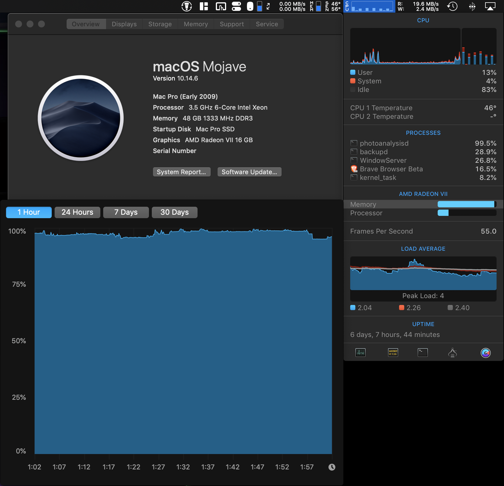

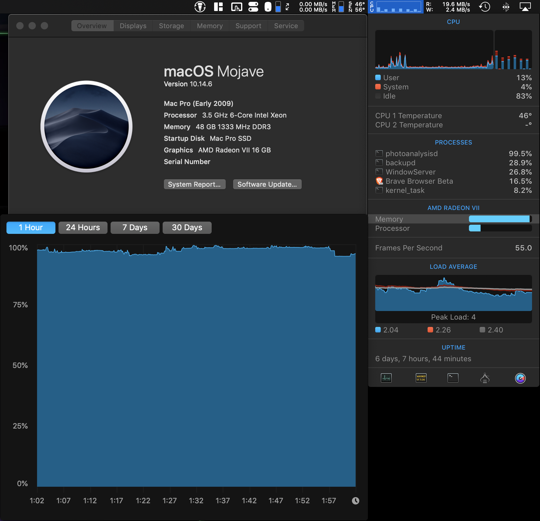

I have an issue where my GPU memory maxes out and will not dump what ever is in there. Is this a known issue or am I missing a step?
I'm running open core 5.9 with the config from post #1314
Got that sweet hardware acceleration though.
Modern OS / softwares are designed to fully utilise all VRAM whenever possible. (e.g. Browser can use lots of VRAM to accelerate).
Even my Radeon VII has 16GB VRAM, the utilisation rate can still be quite high in normal daily use.
Thanks for the reply and all your work on this h9826790
It just seemed odd that even with everything quit the gpu memory never drops back down in iStat menus.
Thanks again.
AFAIK, actively free up the memory has no benefit in general.
That's why modern OS allow the data simply stay there (until something else need to use those VRAM).
Makes sense I suppose, don't do anything until you have to. The only real reason I suppose is to know if you are in fact running under stress or you have some gremlin that's hogging assets.
Thanks again.

Successful update to Catalina. Thanks your guide
