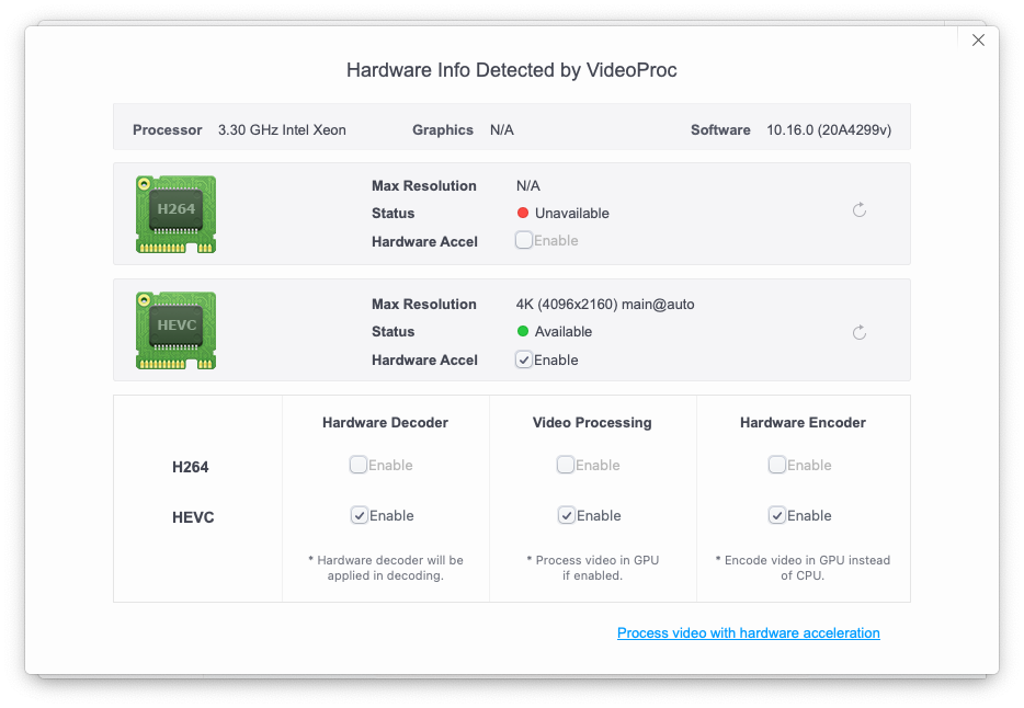

My suspicion was correct that I had Update Smbios set to false. I have acceleration now without WEG / LILU but with rebuild-device-tree and PXS1 to GFX0. I will now try to run it with the GPU as PXS1.
[automerge]1593292351[/automerge]
I was able to remove the GPU as PXS1 patch and rebuild-device-tree but still have HEVC & H264 hardware accelerated encoding and decoding.

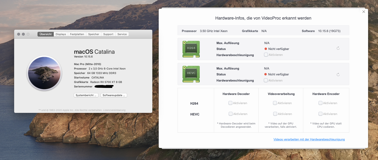

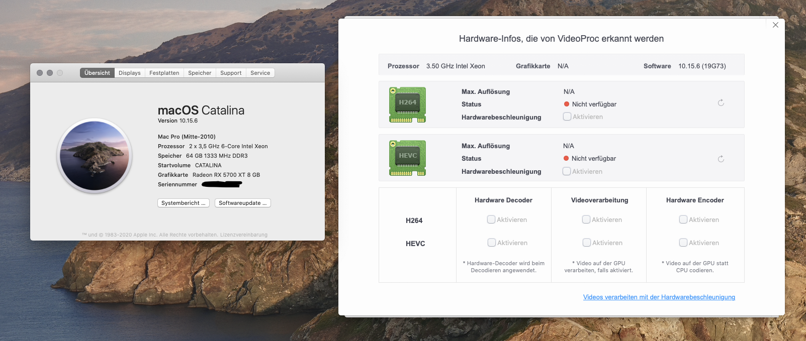

sorry, if I may ask a already answered question. if yes pleas give me a hint, where I can find the answer... I dit the OpenCore 0.5.9 installer. everyting works besides HW-acceleration (my main reason to switch for NVIDIA to AMD).
Post #1, Q29 can solve it?
Thanks you, I tried that already. But came to an idea.
Fyi, I accidentally installed over my used Highsierra instead of a plain fresh Mojave, I made. There were some weird things with the EFI-partition, which was called differently in clover than in Terminal. Anyway, now I copied and blessed your OpenCore again at it works now also in other applications. (insta360pro-stitcher-app in my case) Which it has not before.

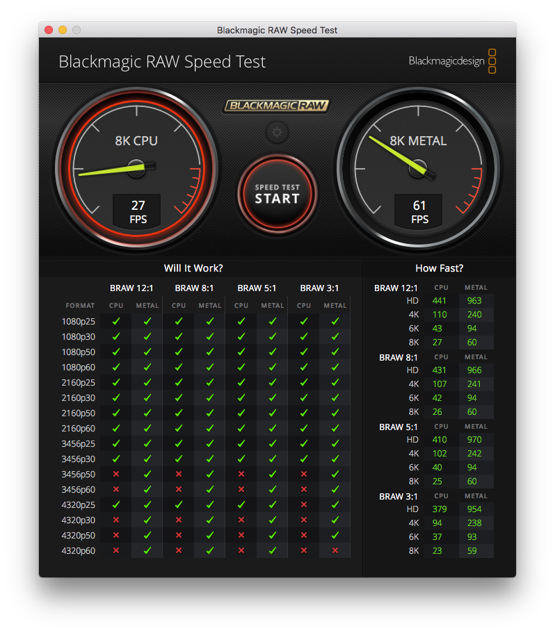

This is my system report in high sierra with Xeon x5690 and RX580
If this capability is locked why this test shows support up to 8K 61FPS in Metal?
