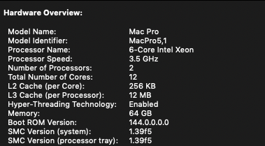

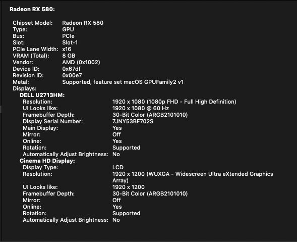

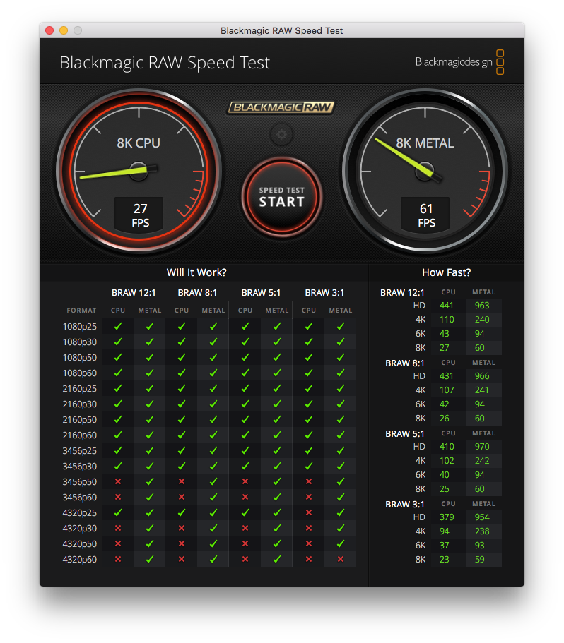

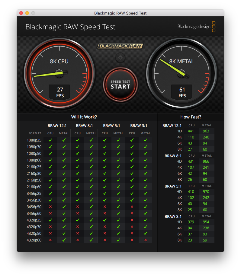

This is my system report in high sierra with Xeon x5690 and RX580

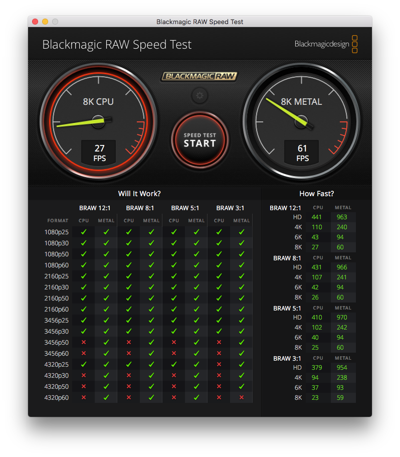

If this capability is locked why this test shows support up to 8K 61FPS in Metal?
AFAIK, only decoding acceleration can be enabled with 10.13.6 and RX 580, see the first post FAQ, not encoding.
BTW, you are failing to understand how the VideoToolbox API acceleration works, AMD hardware acceleration is just a way to say video compression/decompression using VideoToolbox API running on AMD UVD/VCE/UVC ASICs. AMD UVD/VCE hardware acceleration is not METAL at all, it's a pair of dedicated ASICs (UVD/VCE), or just one unified ASIC (UVC) depending on the generation, in the GPU and these ASICs don't support METAL.
An app that uses METAL for video acceleration, like FCPX, bypass the VideoToolbox API and uses the GPU compute units directly. Some apps use both METAL and VideoToolbox, for different things.

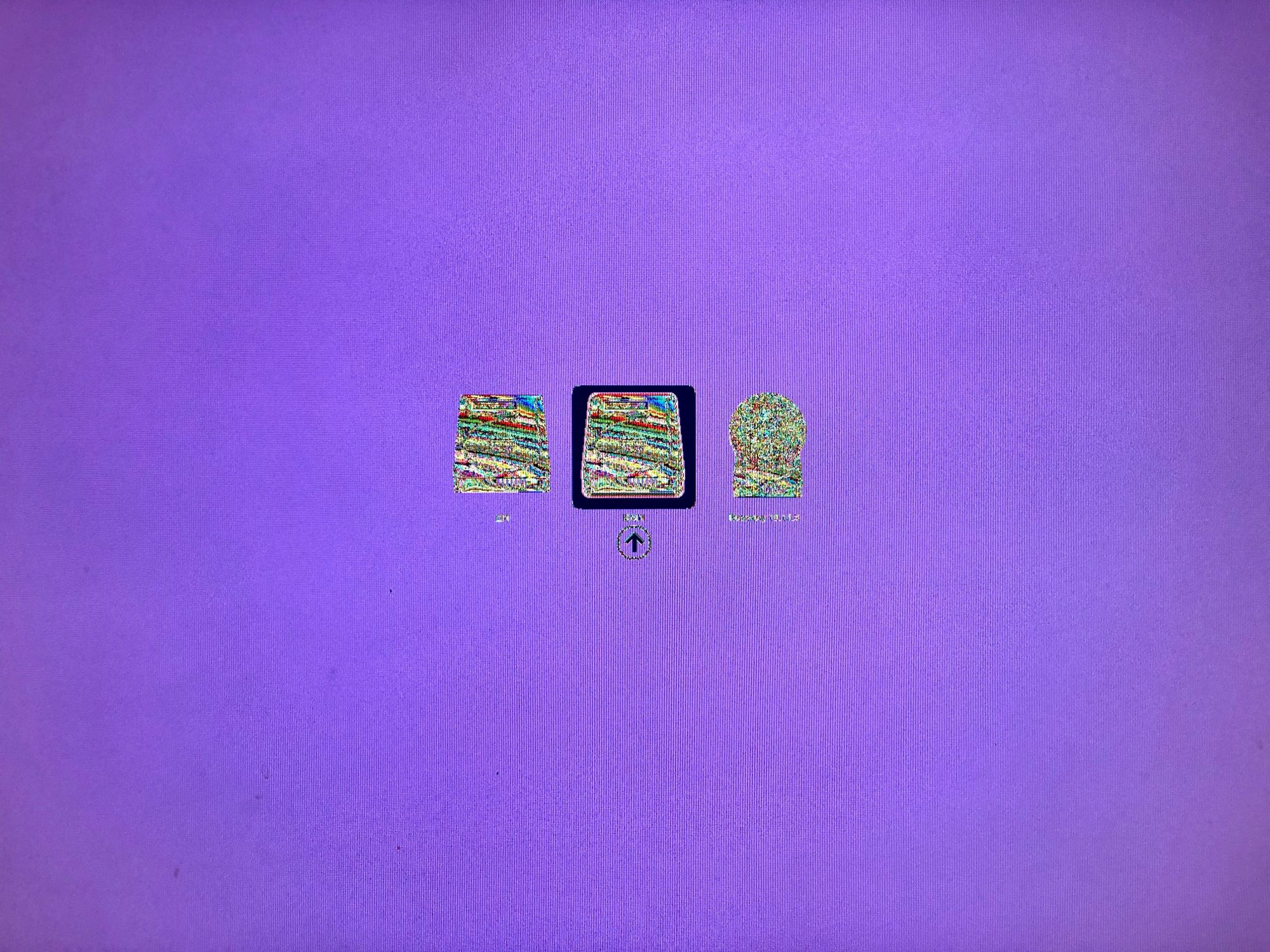

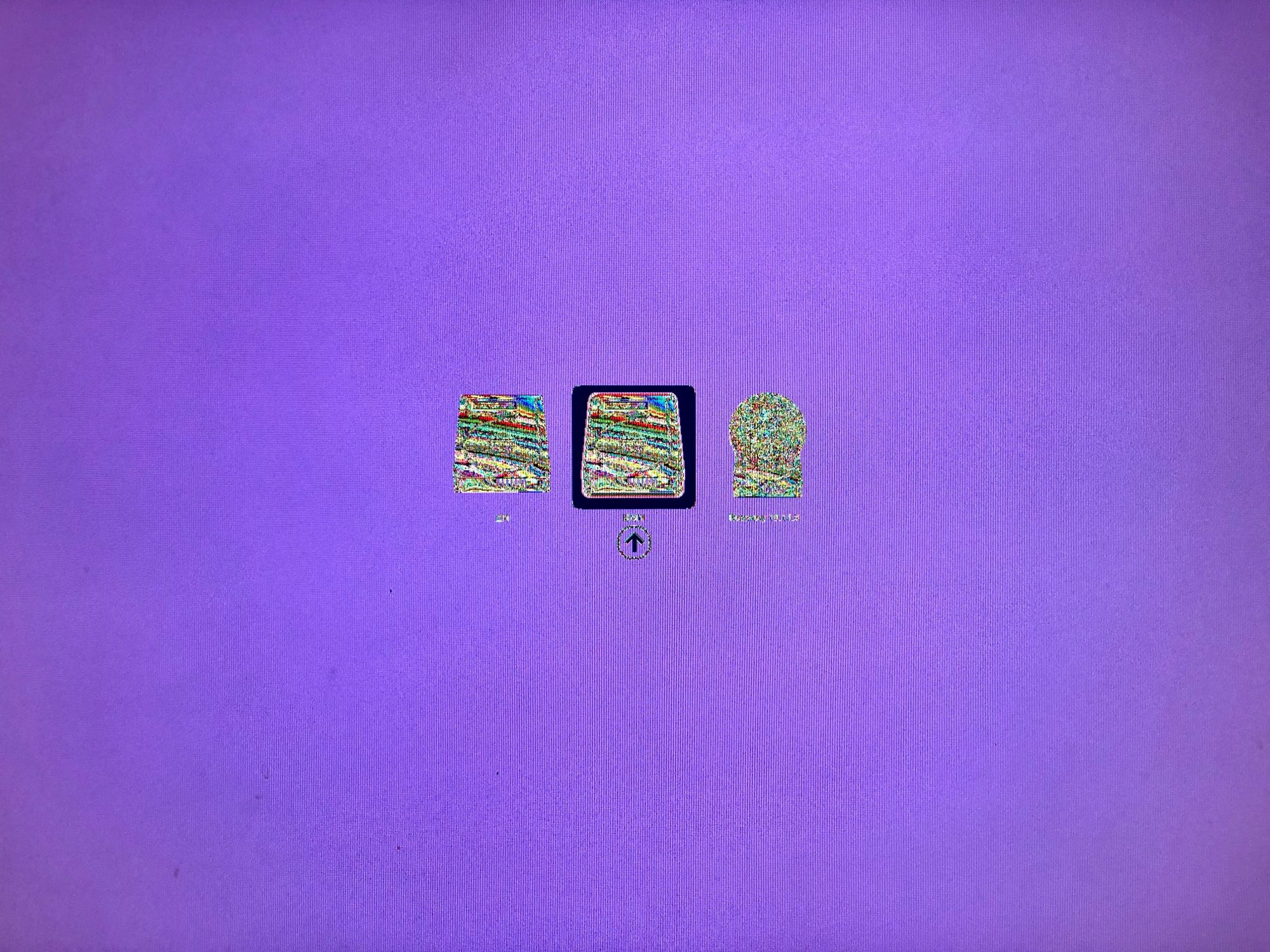

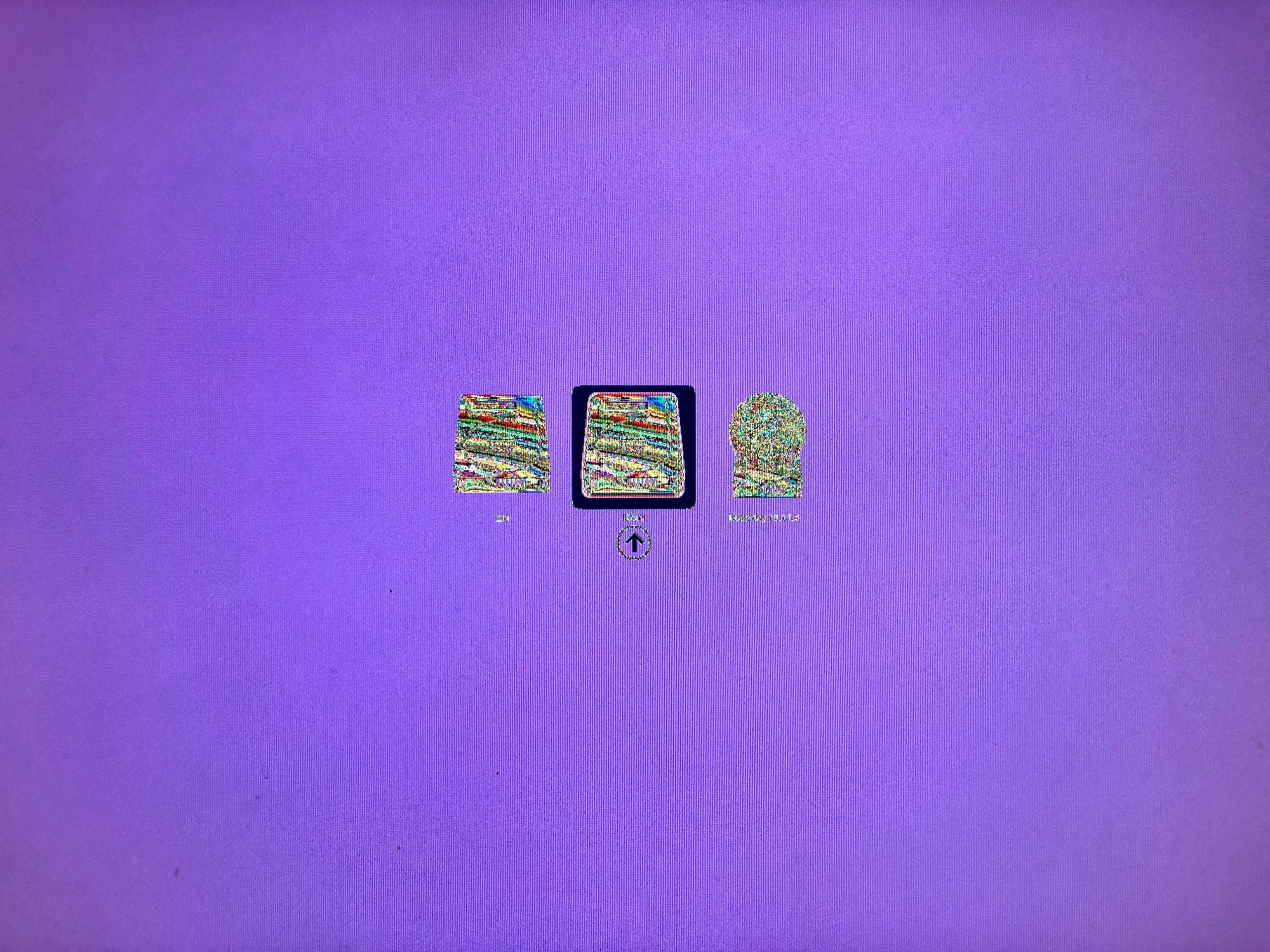

I upgraded from OC 0.5.9 to OC 0.6.0 using the .zip file from @h9826790 at post 1314 (thanks again!):
Now I also see the (an?) EFI partition among the volumes available to boot from at the Open Core boot screen. It wasn't like this before. Is there away to hide that partition from view? Just a minor thing, but…
Sounds like you have an extra instance of OpenCore.
I'm also wondering if ther'es a way to change the boot disk from within MacOS, i.e. so one doesn't have to sit and wait for the boot picker to come up and possibly missing it because of the timeout?
With RequestBootVarRouting enabled, OC will respect the selection in System Preferences > Startup Disk. You can also hide the picker by setting ShowPicker to false.

Few users reported that after to 0.6, OC boot picker shows the EFI option (it's the OpenCore itself). In general, the hideself function should be on by default. For unknown reason, the EFI options still shows up. Select the default boot drive in System Preferences -> startup disk will set the default boot drive in Boot Picker, but not bypass it. This action seems can also effectively enable that hideself again.

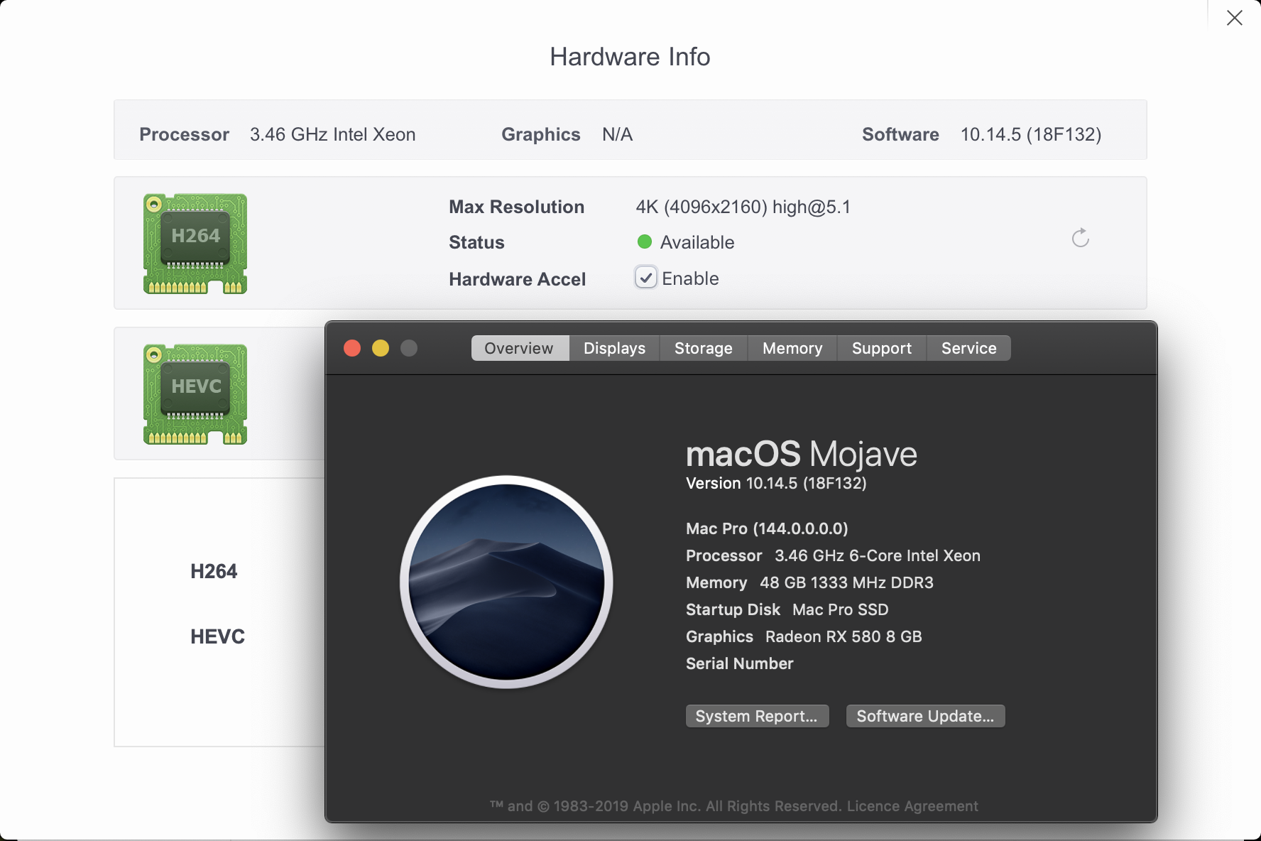

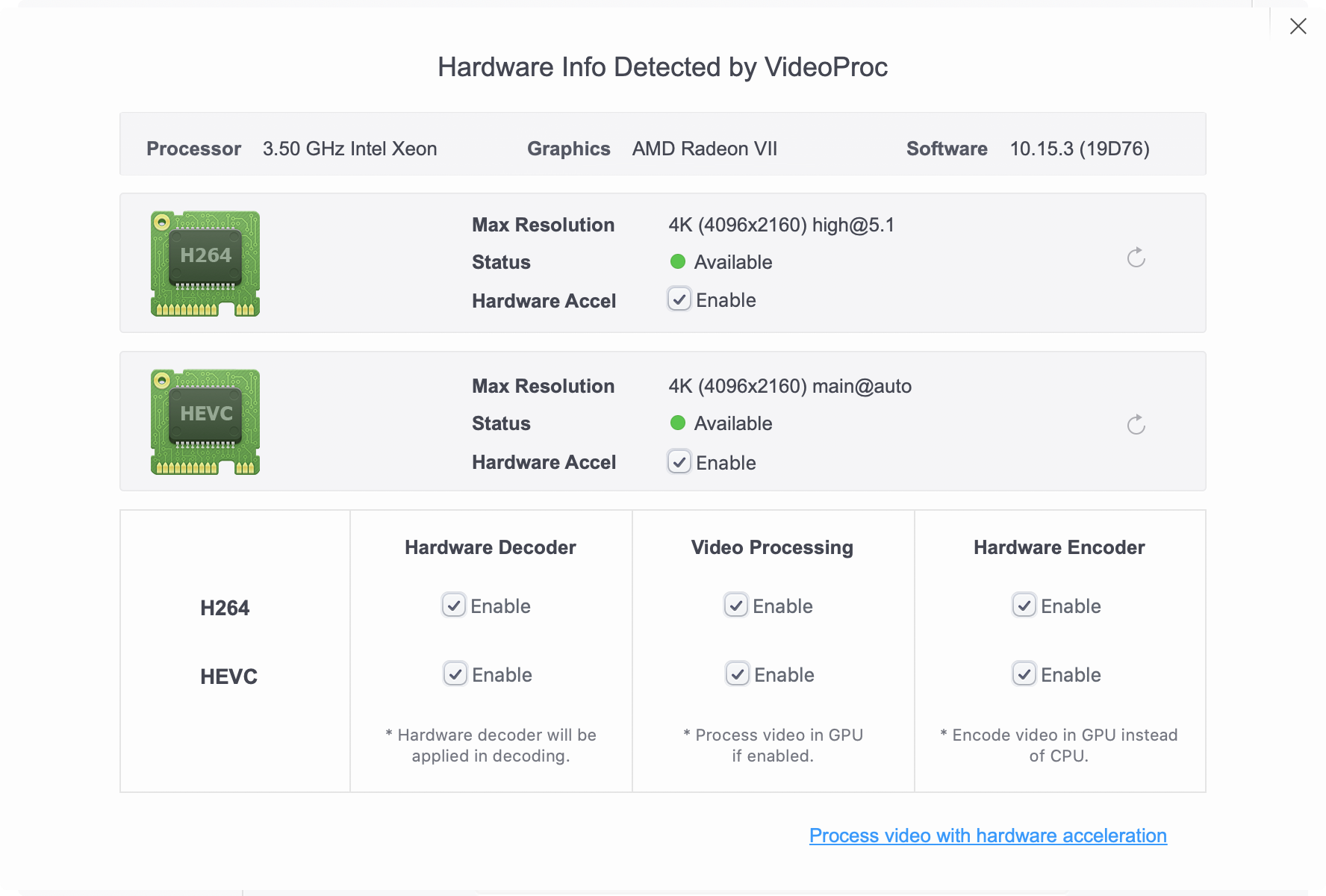

Full HWAccel achieved now!
Everything are covered in the OpenCore threads. The step by step tutorial is at here, but I strongly recommend you go through the whole thread before you do anything.
The same method works in both Mojave and Catalina. HOWEVER, for dual processor cMP user, please stick with Mojave at this moment. (Update: please stick to Mojave for ALL who want HWAccel. CMMChris advised Apple removed HEVC HWAccel for all Polaris GPU in the latest Catalina beta. Which means you may not upgrade the OS to get any security fix, unless this is an error in beta. Stay with Mojave, get HWAccel, and keep your OS up to date seems will be a better choice at this moment)
Sidecar (and AirPlay Display) should also work, but I have no iPad to test it yet. The latest config.plist in post #594 and #1314 will now keep the cMP ident as 5,1. Therefore, will NOT activate Sidecar by default now.

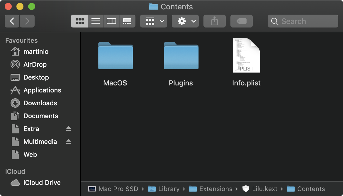

4) open Lilu.kext (right click -> show package contents)
5) enter Contents
6) create folder "Plugins" (N.B. This folder is INSIDE Contents, please do NOT miss step 5)
7) Copy the WhateverGreen.kext into Plugins
8) Copy the whole modded Lilu kext to /Library⁩/Extensions/

A: Able to play some very demanding HEVC video (e.g. this one)
https://4kmedia.org/sony-swordsmith-hdr-uhd-4k-demo/
This is how my cMP can play this video now. Smooth playback with very low CPU usage (please use a browser that support VP9 to watch all the following Youtube videos in 4k, otherwise, you may not able to read the details)
Able to edit H264 directly smoothly, no need to transcode to ProRes anymore, greatly reduce the storage speed and capacity requirement. Most likely can improve productivity as well
Able to edit HEVC directly smoothly, no need to transcode to ProRes anymore, greatly reduce the storage speed and capacity requirement. Most likely can improve productivity as well
Can greatly improve H264 export speed with low CPU usage (depends on your CPU / GPU spec)
Able to record the screen at 4k smoothly. As you can see from the above link. My cMP now can do those stuff and still record the screen smoothly at the same time.
Able to play VP9 video smoothly. My cMP now can play this 8K 24FPS youtube video with zero frame drop. (VP9 hardware decode is NOT supported at all in macOS)

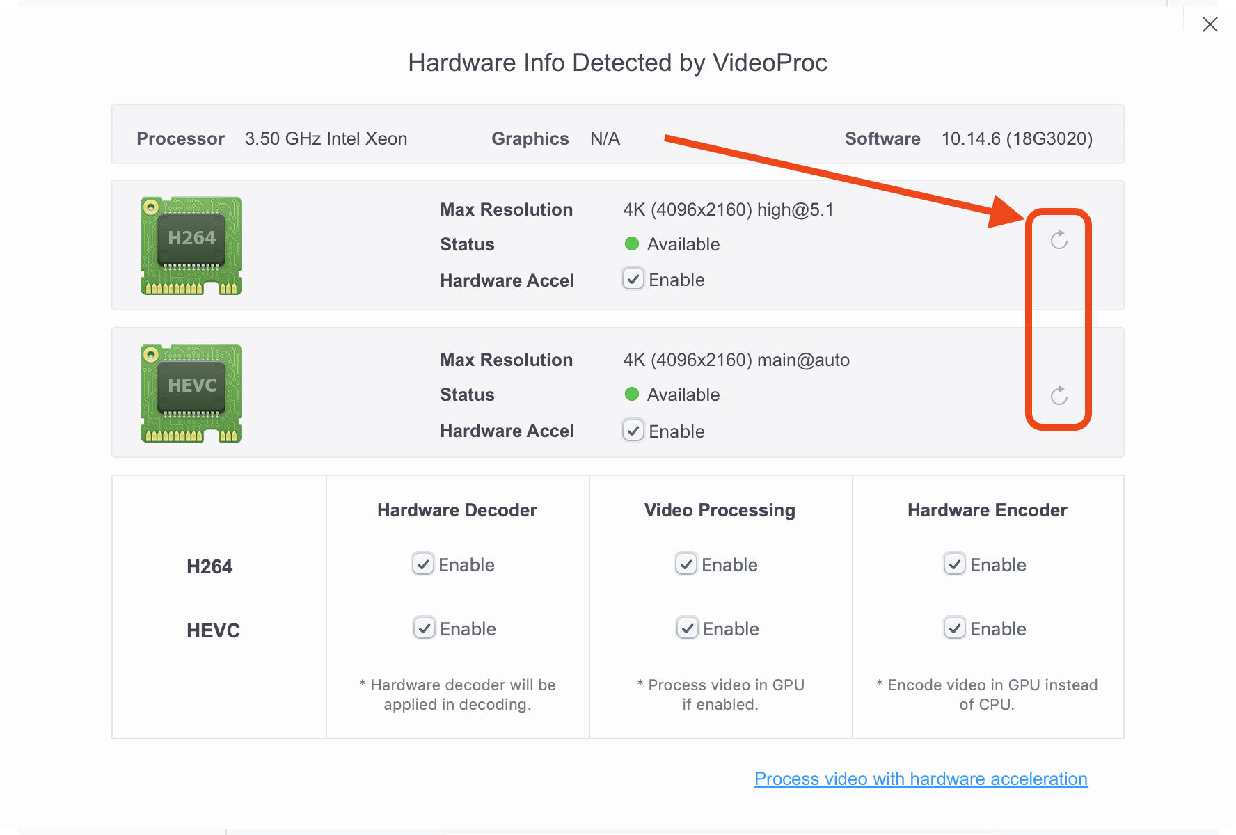

Q19: Why VideoProc shows no HEVC decode after the mod?
A: I don't know why, but this is normal in this case. My recommendation is to download demo HEVC video from the above link, and play it via QuickTime (or simply via Finder preview). As long as the CPU usage only stay around 20% (but not 800%), that means HEVC decoding is working properly.
For those who use OpenCore method, you should able to see HEVC HWAccel avail. If not there, please click the little reload icon.

Q27: Why the "Graphics" in VideoProc HWAccel page shows N/A?
A: No idea, but it's just a cosmetic error in this case. (Update: It seems VideoProc looking for the key word "AMD". e.g. If the card ident as AMD Radeon VII, VideoProc can show it properly. But if the card ident as Radeon VII, then VideoProc can't show its name)
Q28: Why VideoProc shows that I am use "Intel "HWAccel when converting videos?
A: Also no idea, but again, it's just a cosmetic error in this case.
Q29: Why VideoProc shows nothing activated but everything seems working as expected?
A: As long as you can see this tick, which mean HWAccel is activated. From my observation, this tick always change automatically.
For the Hardware Info Detected page, please click the little reload icon in order to let VideoProc to show you the latest status.

Everything's working great for me, with the exception of dirty graphics within the boot loader. Over the last 5 weeks, I've had clean images only once, and I don't know how to replicate it because it was completely random. Any help with this would be mucho appreciated :apple:
MacPro 4,1 --> 5,1 @ Dual 3.5 GHz 6-Core Intel Xeon | Sapphire RX580 | OS X Mojave |
