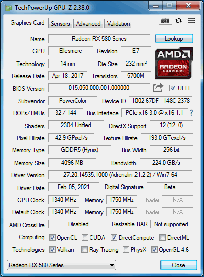

Going to sound dumb but does HWA in OC affect Windows 10 at all? Having instability with Windows (during gaming) and I'm trying to track down what it is, but I don't think so myself....
Should not.
Instability in Windows gaming usually GPU cooling related (if not because the driver itself is buggy).
In macOS, the graphic card use the voltage, clock, fan curve that defined in the VBIOS.
In Windows, the AMD software override all those value, and use a different set of parameters to run the card. E.g. the fan curve can be less aggressive.
Also, in MacOS, the GPU rarely can run as hard as in Windows gaming.
Therefore, the GPU may end up run at higher temperature in Windows gaming, which can cause stability issue.
I don’t know what problem you are actually having. But you may spin up the PCIe fan more (via MacsFanControl), and make the graphic card’s fan run at higher speed (in the AMD software) to keep the GPU run at lower temperature. And see if it helps.

Thanks for the insight.
I thought that would be the case here and didn't think it would have been HWA causing my issues.
I've been monitoring it and had already set a fan curve for the GPU within adrenalin, also linked PCIE fan to PCIE ambient within Mac's Fan Control but it'll either crash due to the driver (BSOD with thread stuck), freeze (probably driver issue again) or black screen and the GPU fan will go full tilt (assuming this is a heat related issue). Temps for the CPU, NB, RAM are fine, even the GPU reports maximum of 65C with my settings.
Might be the card itself (SOL with GPU pricing now lol) will probably take it apart for a repaste and go from there.

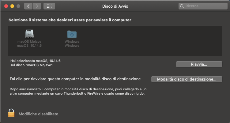

Just performed an upgrade on my cMP 5,1 from Mojave --> Bigsur.
Currently am successful on my test SSD (cloned from NVMe card). So far multiple monitors works great, hardware acceleration is good.
Am unable to boot into my bootcamp Windows 10 install (loaded on m.2 Sata drive - non UEFI), so will see if I can reinstall this in a different method so the bootpicker will see it???
If anyone has been able to dual boot macOS and Win10 (each on its own NVMe), please let me know.

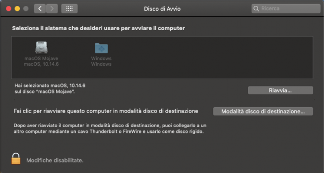

chiming in...
THanks!
This may help
thank you very much for this! Will be trying this soon (waiting for a new drive so I can clone my existing windows install)... Have been trying to use the windows install method noted here https://forums.macrumors.com/threads/opencore-on-the-mac-pro.2207814/ ....But can't seem to get my USB drive to show up in the picker.
Will let ya know how this works out
For new Windows installation, follow this link, post #1, Appendix
yep... this is what I followed, I was having trouble with making my USB stick, finally have it online and built.
Of course this was all using Sata SSD's. Will have to see if my NVMe sticks will work with this setup (as that do in mojave). I'm liking the ease of use with OpenCore a lot more!
Appreciate the help/links provided!

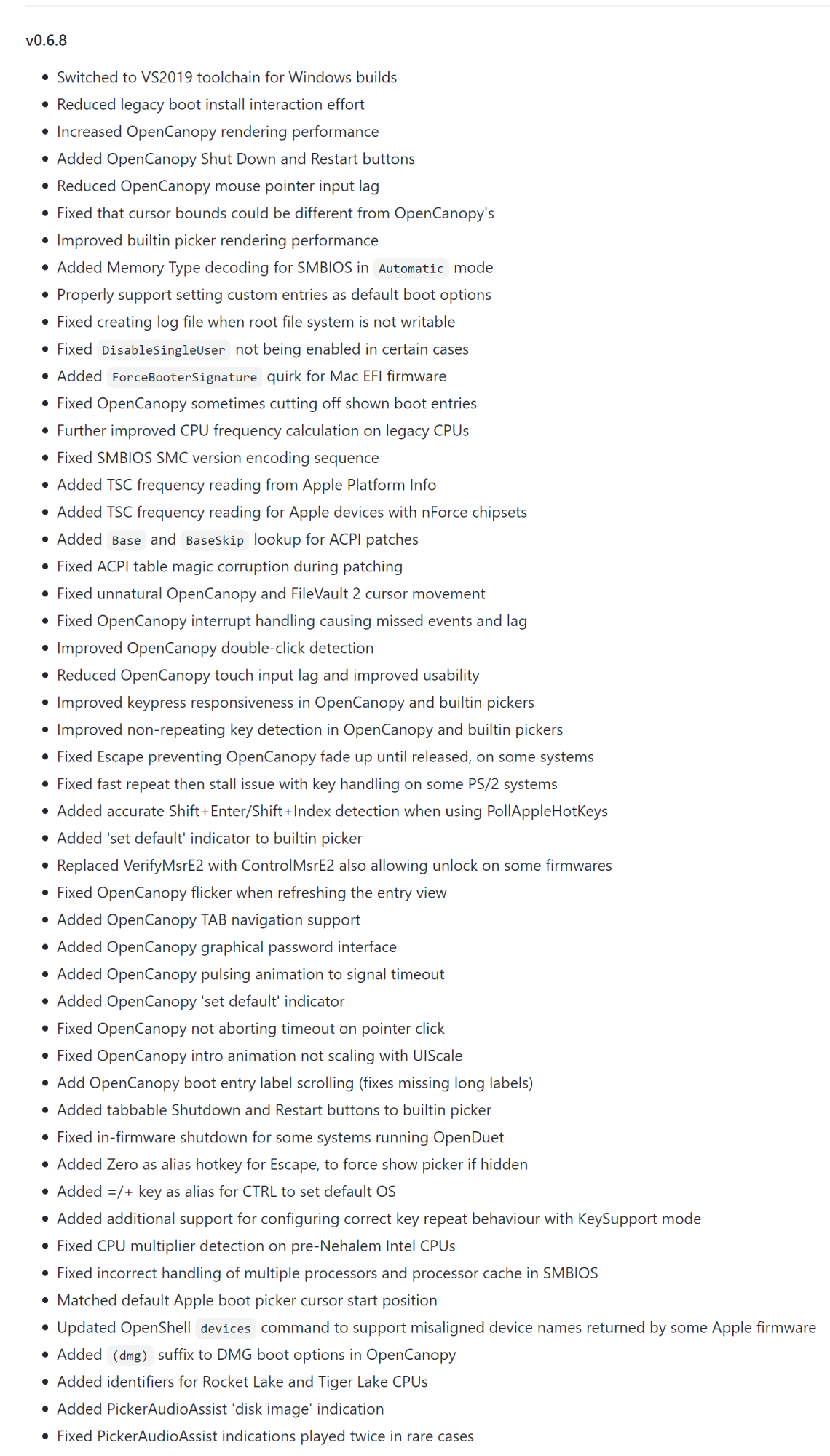

Yeah, the upcoming 0.6.8 should improve OpenCanopy quite a bit, including improve the mouse pointer smoothness.

With your OC 0.6.8 package, after choosing to boot with Mojave or Windows, in the next start, the Mac's boot sound (boing) is heard normally, but after booting the Mac from the Big Sur volume, and rebooting, the boot sound (boing) is no longer heard (muted)! Why?
Also, why can't I see the Big Sur disk from the Mojave Startup Disk?
Thanks!
Thanks!
Mojave can't understand the Big Sur APFS system, this is normal.
If you want dual boot, you have to choose Big Sur in the boot picker.
For boot sound, please check your Big Sur internal speaker volume setting.
