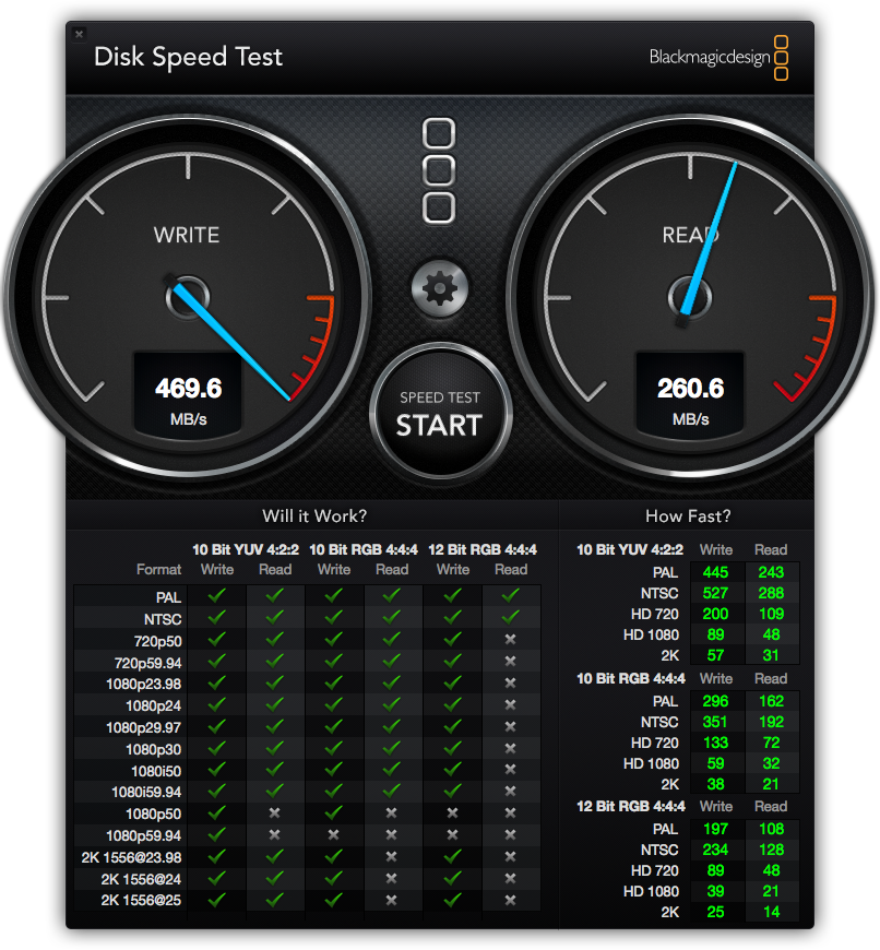

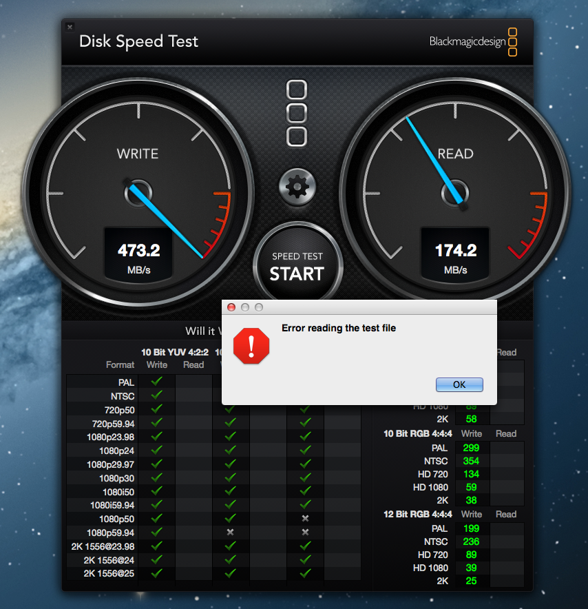

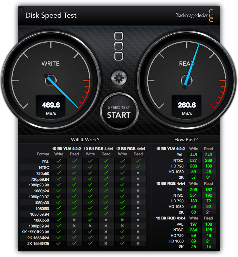

Blackmagic Disk Speed Test comes out with VERY poor read speeds for the Samsung 840 Pro. Sometimes it will fail.
Not having good luck on this upgrade :/ It was running fine before I opened it, really bummed out right now. Wish I had another working Mac Mini to test the SSD.
