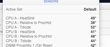

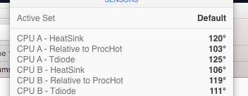

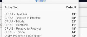

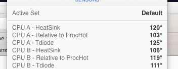

...Anything I should worry about with these temps? They look fine to me but just to make sure (both in F and C ust because ;))
...Again this is with the original CPUs, but I just don't want to take any risk after swapping them several times...
