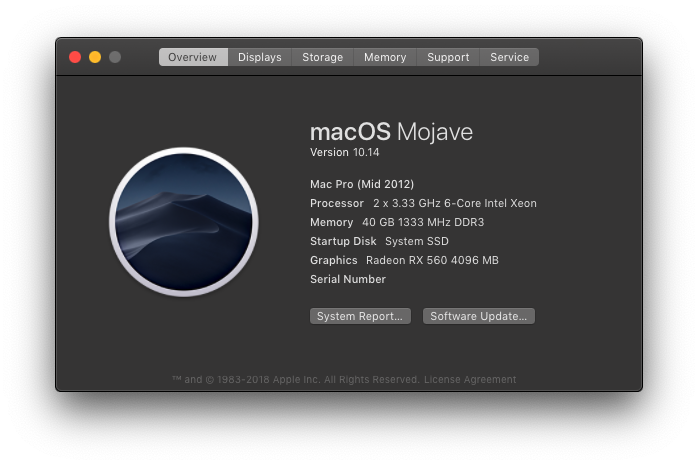

So all that trouble was the de-lidded Xeons?
No they were not de-lidded. This is a new pair. Took me 20 mn to install them. No problem so far!! Now I'm going to get completely paranoid with my temps, as I did when I upgraded my first Mac Pro (1,1 -> 2,1) :D
[doublepost=1538169431][/doublepost]GB 4 score with the stock CPUs (2.4): 2050 single, 18055 multi
GB 4 score with the 5680s: 2693 single, 24679 multi
:cool:

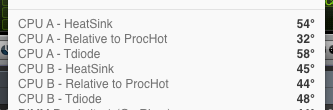

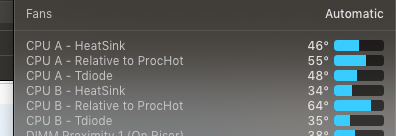

Now...
With the E5645s:
And with the 5680s:
Everything look normal here? Just to make sure!... Computer is almost idle right now.

With the E5645s:
And with the 5680s:
So from your original post on a non working CPU, you have a new pair of CPU's that are working and only taken 20 mins to install? might have been better to update the original first post to now working so that others with issues can see your original issues and how getting a new pair of CPU's you were able to get working Mac Pro.
Just goes to show that all the testing in the world isn't going to make a duff CPU work.
Temps all look ok, what is the ambient system temp?

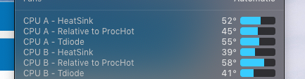

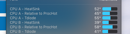

After 24 hours it almost seems like the 5680s are actually running cooler than the 5645s when idle, although it can be hard tell and I'm not going to look at the temps 24/7 anyway:
I have 2 more questions:
1 - Yesterday while I was doing some test with handbrake, I noticed the ProcHot A was going below 10º (it went to 6 iirc), then when the fans kicked in, it went back to 13-15ºC. I'm not sure I like it when it gets so close to the threshold...should I be concerned?
2 - Also, yesterday there was roughly a 15º difference between proc A and pro B now it's more like 10º. Could this be attributed to the thermal paste settling in?
1 - Yesterday while I was doing some test with handbrake, I noticed the ProcHot A was going below 0º (it went to 6 iirc), then when the fans kicked in, it went back to 13-15ºC. I'm not sure I like it when it gets so close to the threashold...should I be concerned?
CPU A always runs a little bit warmer than CPU B from my experience, and yes sometimes thermal paste can take anything upto 48hrs to settle at a stable temp. depends what paste you used. With PC overclocking we used to flatten the ICH the metal cover over the CPU as sometimes they could be concave or have a high corner.
48c you have CPU A and 35c CPU B so a 13c delta between both CPU's. I would say let it settle in a few days and if you feel you would like to see a better delta, you can always remove CPU A heatsink and re seat it to see if delta improves.
Ambiant temp is fine, and CPU B only 7c higher than ambient, so looks good.
