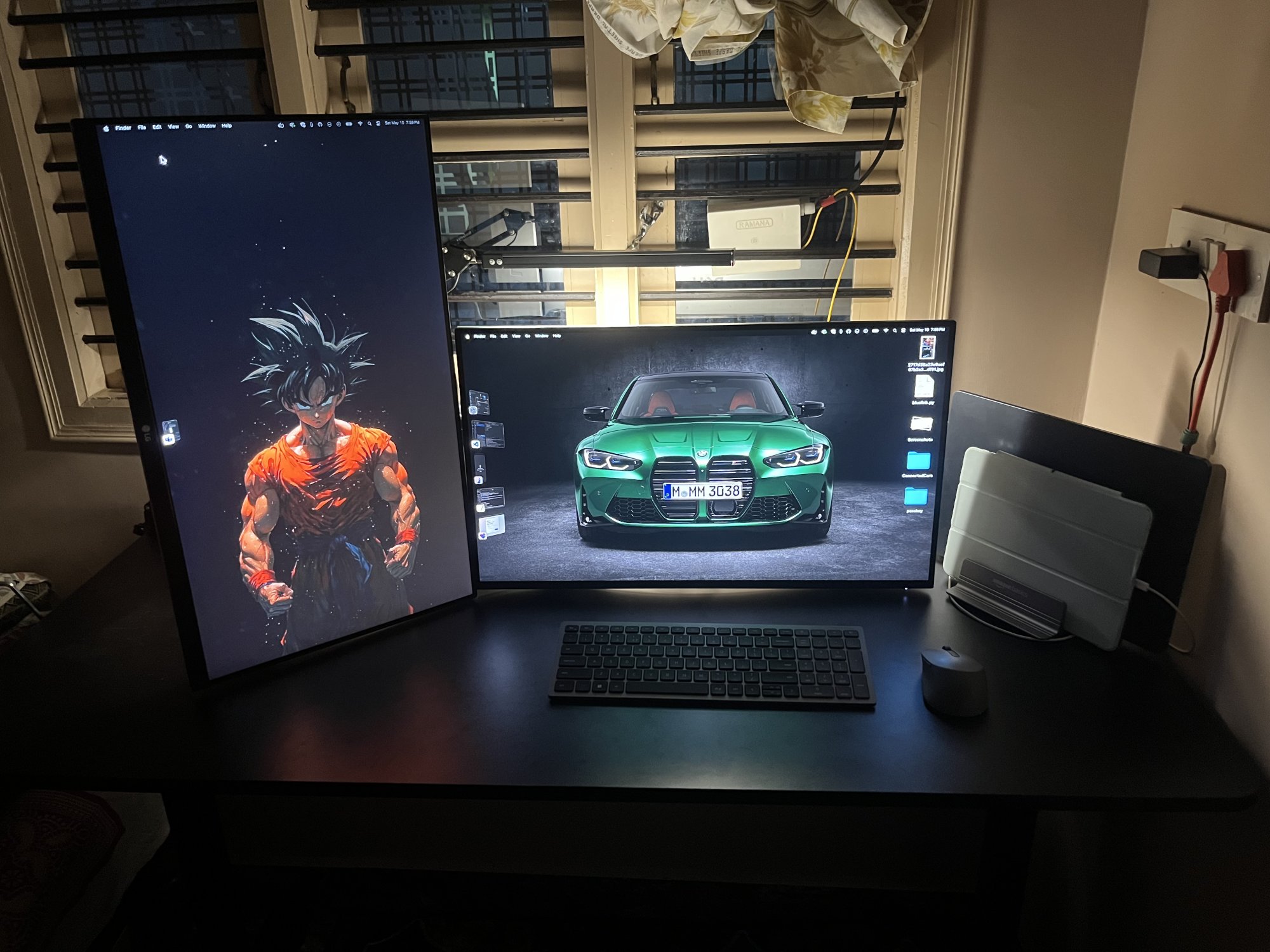

Finally, I got mine on exact date promised. And writing this first impression review on it.
So first of all im not an expert to judge the color accuracy and all but this is what i felt and might help u.

5. Color - Again im not an expert. So when i first connected to my laptop i felt shocked and tooooo much disappointed bcz of default color it had which is warm just like a night shift on mac. To fix i tried different profile, did calibration (using mac utility) but didnt satisfied my mind bcz i can really see a big difference in the sharpness like a crisp tone in MAC vs on monitor which is warmer side. But sRGB 1EC61... profile make me feel a bit better.
6. Issues - So apart from cable, color issue. I felt a jerk 1 or 2 time when i suddenly switch full screen windows(apps)
- And just now while write this post, i initially connected both the monitor cables to mac and turned on system and now when i was checking color profile i noticed the dell display was showing max 60HZ i was worried and removed 2nd display still didnt refreshed so i removed both, connected main one (dell) first then it showed 120HZ later connected LG 75Hz one and the main switched to 60Hz but this time i could see 120Hz option. But i need to try few more time by turning power down to monitors and retry.
So yeah this are my initial impression on this. But i really dont like worm tone bcz while coding it feels different i mean not sure bcz of sudden switch but yeah felt sad in first see.
IMP: And one more thing, i know u might feel -ve in this post on color but when i connected my 2nd monitor LG FHD 75Hz one i saw the difference in clarity. And i agree the Dell is not color accurate bcz my eye adjusted to apple products like iphone, mac, ipad but its just has sRGB 100% not like LG equivalent 125% so yeah i need to give time.
I found the reason for MAC's weird behaviour of 60Hz thingy. So the mac official doc says
1. connect the first display which has higher refresh rate supporting till 4k@144Hz, then
2. Connect second display which has lower refresh rate compared to main which is till 4k@100Hz
Now the problem is i connected the low hz monitor first (without power delivery in clam shell) so mac considered this as main display and fixed bandwidth of 120 (but it can use only 75hz), later i plugged in the Dell monitor 120hz but second display can only work till 100Hz and as per monitor configuration and data read from it by mac. the mac cant find 100Hz option as supported refresh rate by monitor (only possible rates are 24,25, 30, 60, 120). So this makes mac to use the next option other which is <=100Hz is 60Hz
And this is tested by connecting Dell as main(primary) first then my LG (75hz) and it works. Also even when i turn off power and boot monitors again (not laptop) it works.
So no worries, it a mac's shittt and my less understanding on it. But got to learn something in detail for sure :)

Glad to report, my monitor seems to work just fine as of now. Connected to my M1 MBA via the USB-C Cable that came with it, everything is smooth. No flicker, no retention (so far), no weird issues. None.
It is working fine with 120Hz non-HDR 1440(hidpi) resolution. That is 4k but UI is scaled. No font issues, no jagged edges, nothing that I feared. I can comfortably work on it the whole day and then some. Although I have to admit, MBA's built in screen is just stunning to look at.
Colors are nice, stand is nice and there are couple of caveats. For example there is no 3.5mm jack on the monitor, to be fair they never claimed there would be. Their DDP software works fine my latest macOS, I am able to control brightness, volume through the keyboard.
I was very excited about this purchase but all the frustration around shipping and delays reduced me to looking at it as just another tool purchase. My desire to write an in-depth review just vanished away. And I think it is good at what it claimed to be. I am happy with the product itself. No issues so far, would report here if found any.
