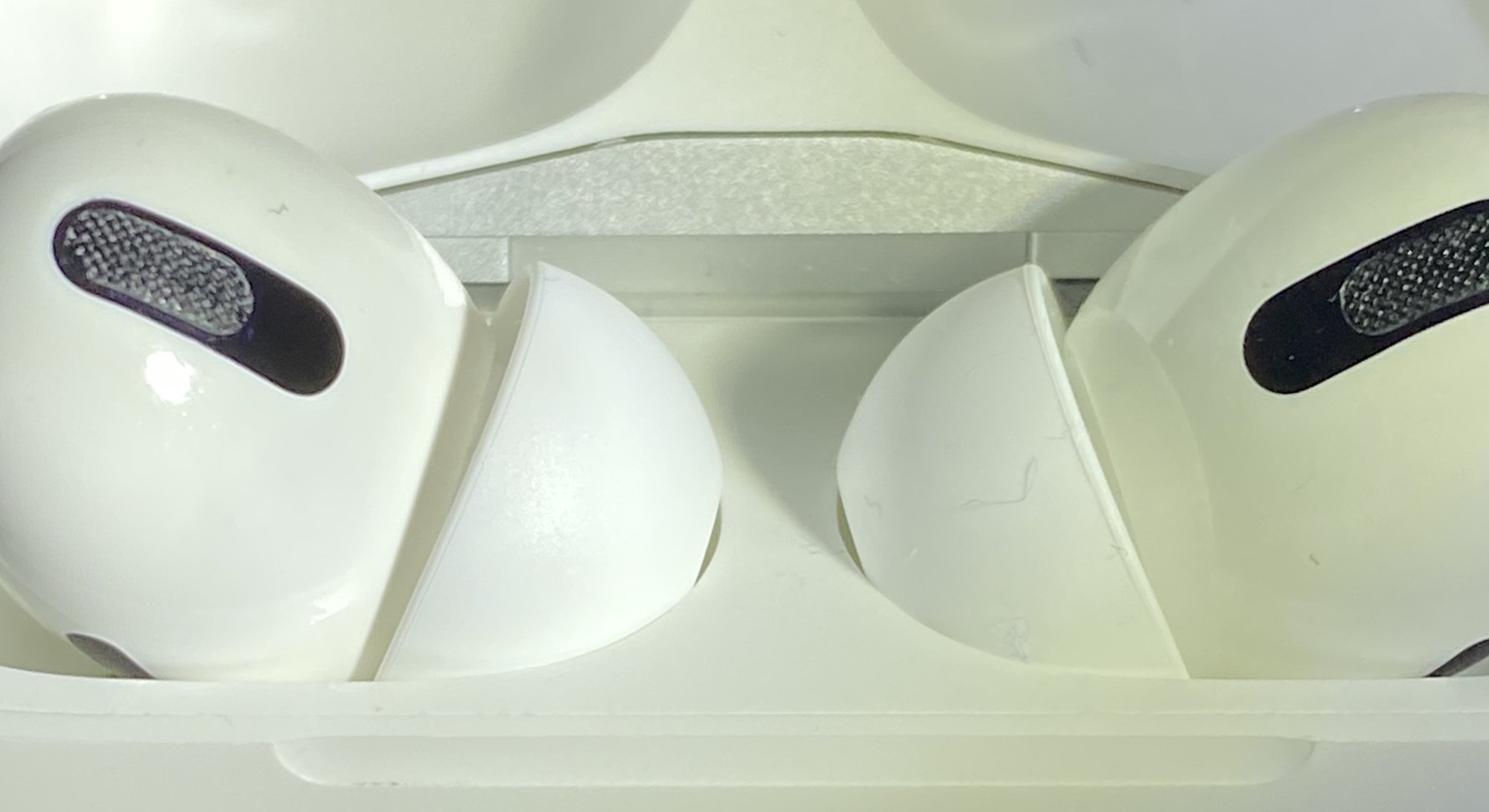

This vents gets dirty. Images after "sucking".
Whoa! I’ve had my APP’s since launch and the vents are pristine. Do you workout ? I wonder if the people having issues workout which leads to salt and oils clogging the vents.
A toothbrush with a tiny bit of isoproyl will make quick work of that. Apparently people genetically either have "wet" or "dry" earwax, ear-related stuff gets gunked up faster for 50% of the population

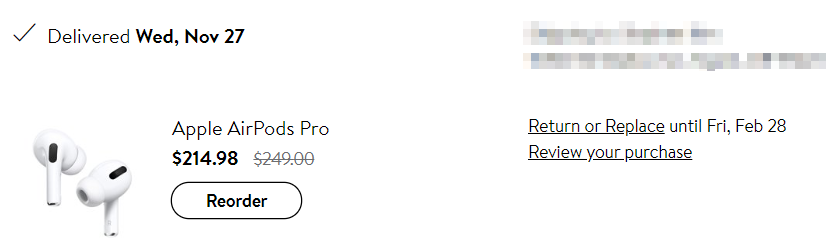

My 1 month old APP had left side fail fit test and had just the left side replaced at Apple store on 12/26. My right side is now failing fit test, with the sucking method "fixing" it. If it fails again, I'll be calling Apple to request replacement.
I have until end of Feb to return so we'll see how many more issues I have by then.
BTW, for those stating there is no difference in sound when fit test fails, I very much notice a difference in bass response when they pass/fail. I don't notice a difference in ANC, though.
how did you obtain nearly 3 months of return period? 😳
