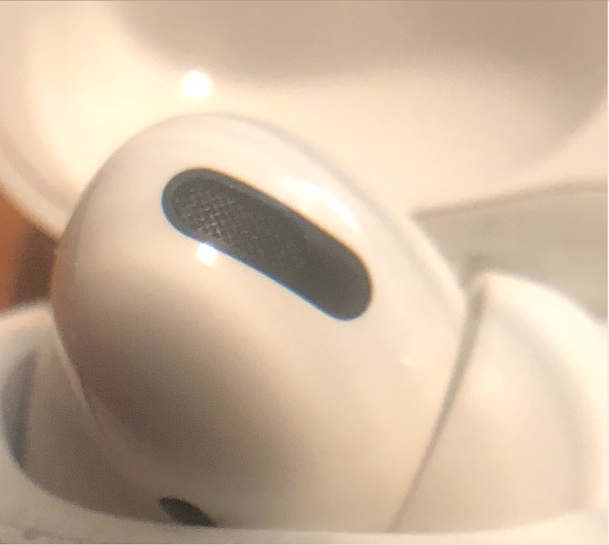

Can you post a picture of your AirPods? I down know, the pictures I’ve seen the difference is big enough to make me believe it’s a design change, the grille is way deeper compared to the original design.
Here's an attempt through a loupe I had sitting around. Pretty hard to get the lighting/focus so I was only able to get the left AirPod, and that actually is the one that is ok with no problems. Though the right one looks the same to me.
I have a cheap iPhone macro lens on the way in a couple days (I was reminded a macro lens could be fun to have), I might try again. Just a regular shot with my iPhone X I couldn't get the grilles to be visible enough, even with cropping it all the way.
In this shot, yeah, it does look like a design change.

That looks like it, so it doesn’t really avoid the problem. Well, I’ll stick with multi tack + sucking to keep mine clean until close to a year then I’ll replace them to get new batteries
