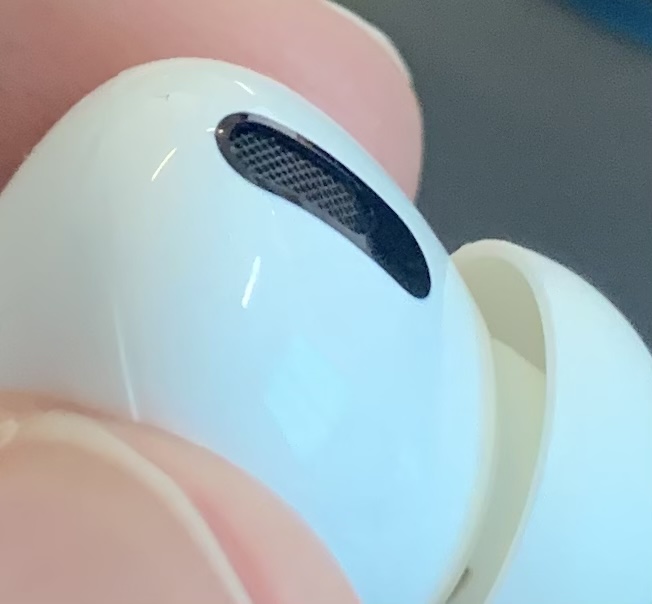

I’ve always used blue tack as best practice for the cleaning of my APP but after 6 months a bud starts rattling, out of the blue.
I asked for a replacement of both buds and now they sound great (the mic sucks as ).
I checked the image on apple website and in the very first one the mesh is not even.
It is very even on this picture, it’s just the lightning. My first model was exactly like this
Now look at this (my replacement)

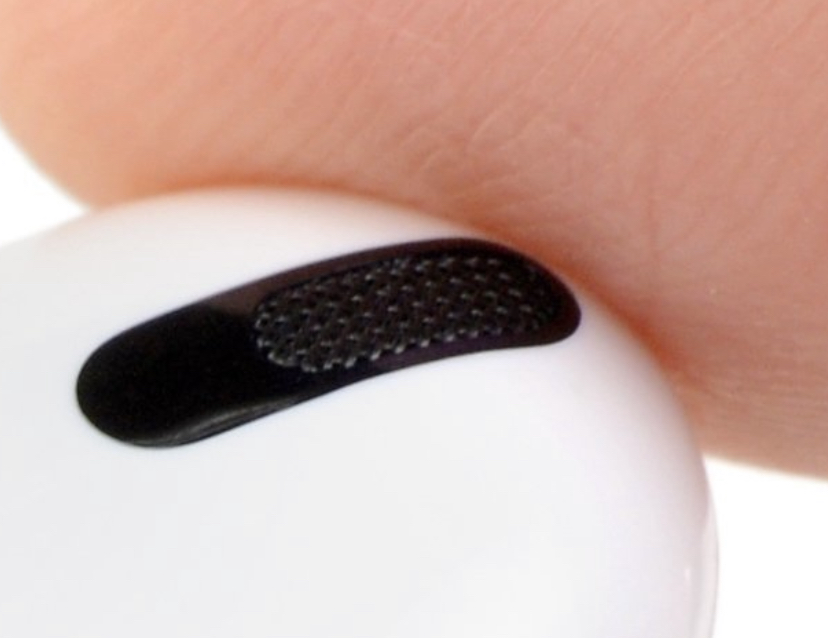

edit: a picture from the iFixIt it tear down made October 2019
