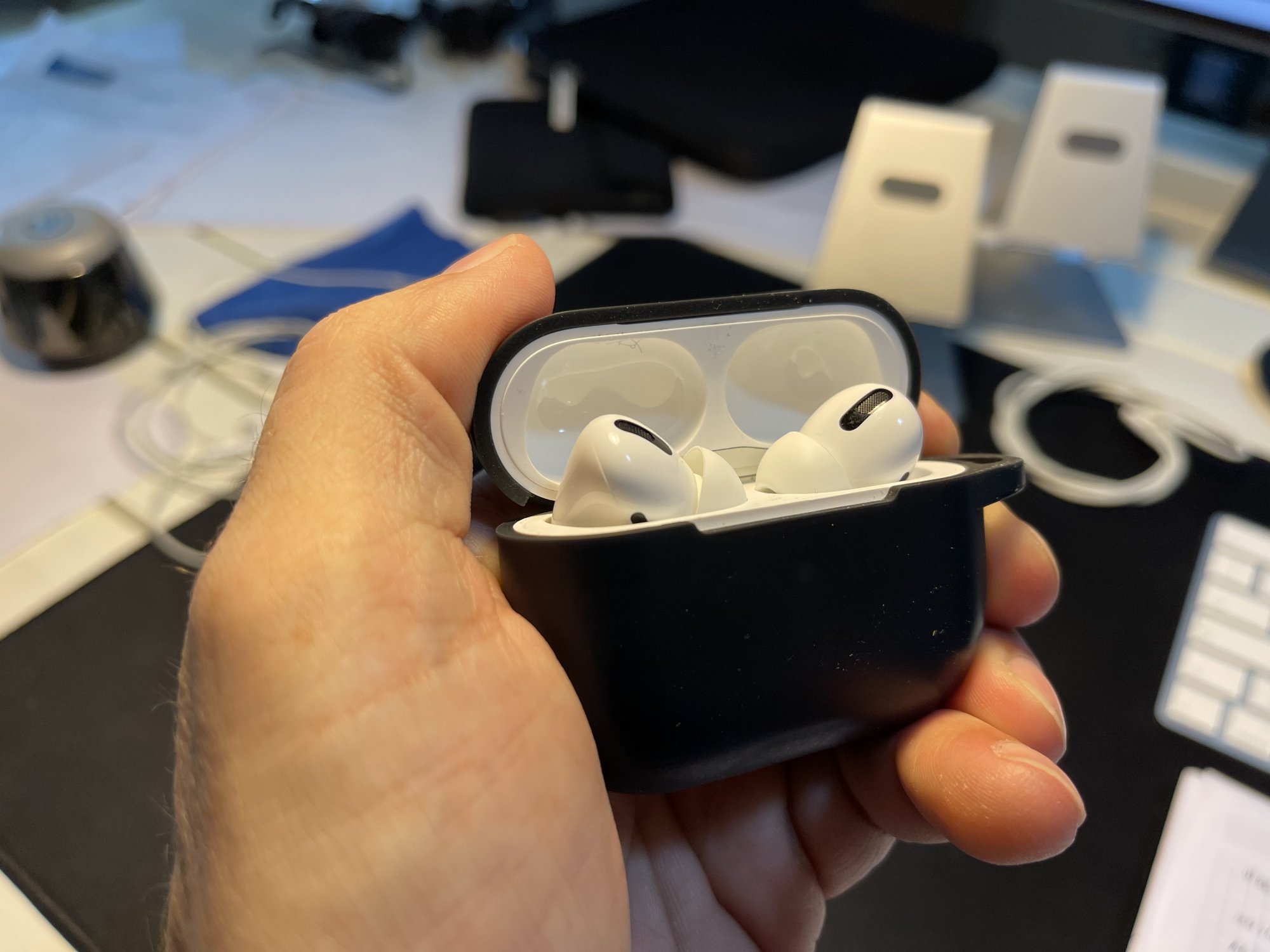

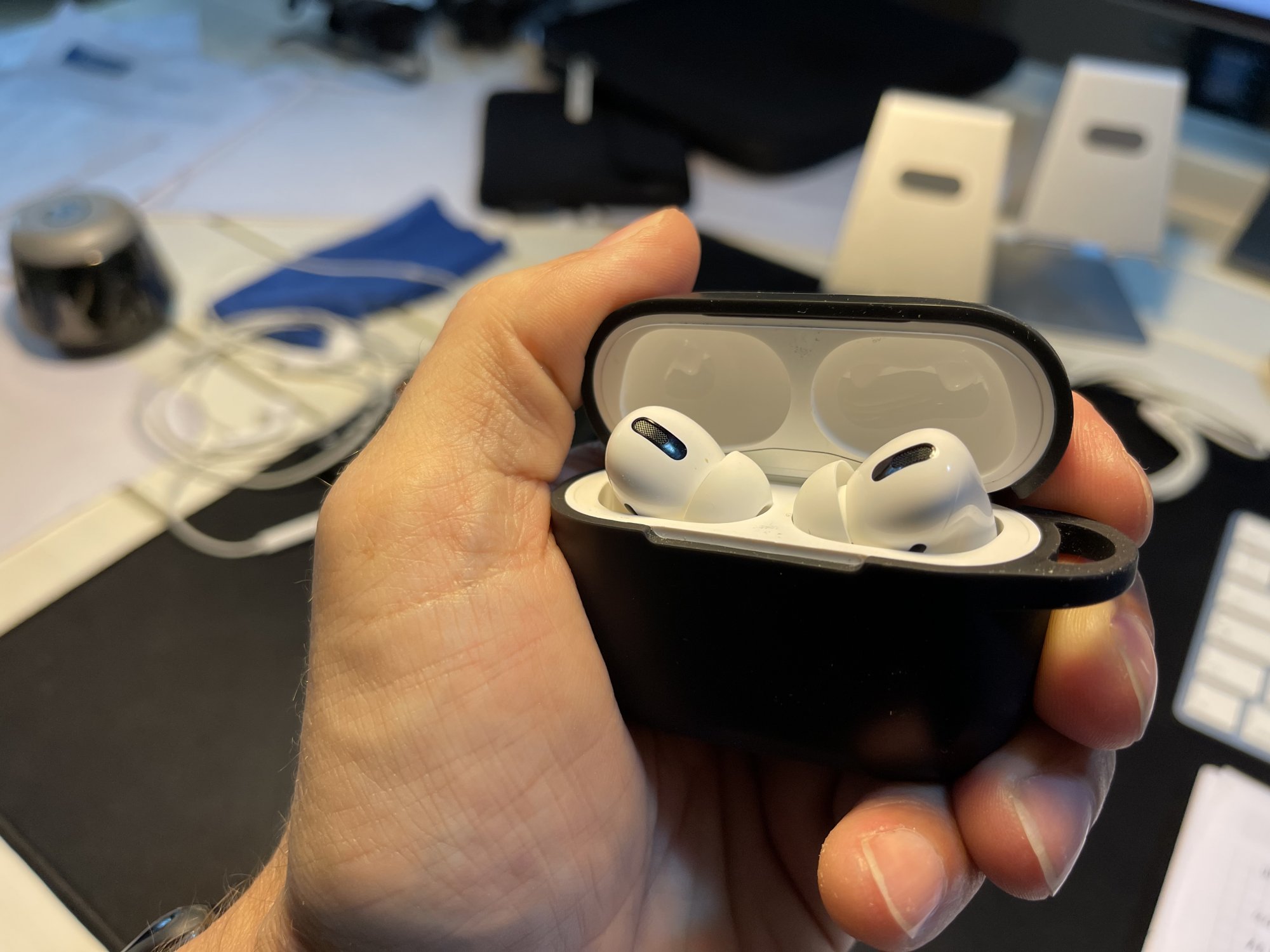

thank you. I read it carefully. It's not clear if the recessed mesh is a redesign or something else.
My new buds seems to be both recessed. Unfortunately i send back the old one, so i can't compare the different units.
Here a couple of pics.
the point is: how to keep the mesh really clean? My previous bud shows the rattle gate after one year. Luckily I have 2 years Apple warranty. To it was not related to the earwax: I clean them twice a month with blue tack.
I think that the best way to clean the inner mesh is:
1) qtip with alcohol (to make the wax softer)
2) brush (the break the wax)
3) blue tack if (to grab the wax)
hat do you think?

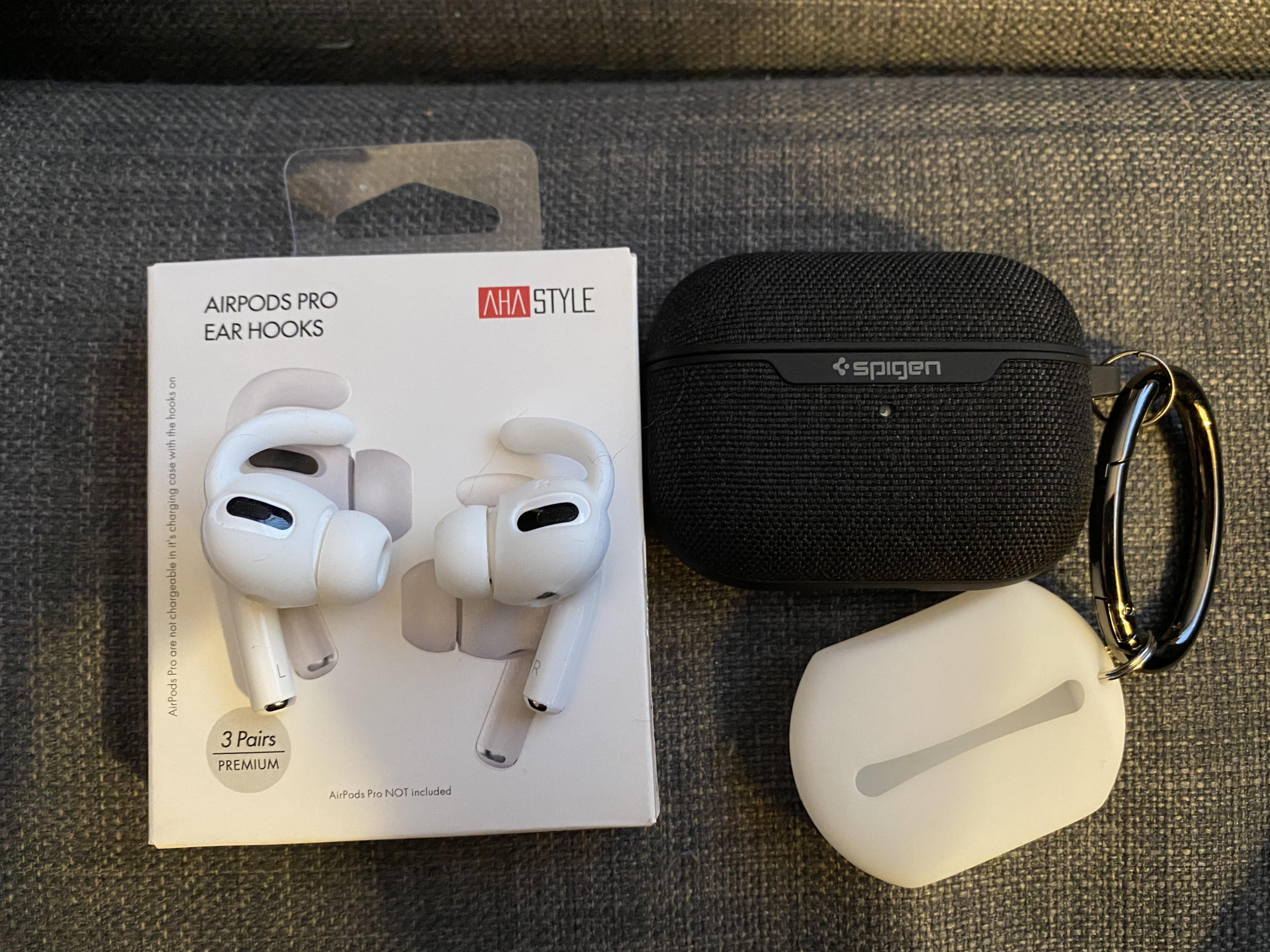

Not exactly a 'solution' per se, but I have wingtips such as these that you can slip on and off and, not only are they very comfortable and provide the perfect fit so that I never, and I mean never have to worry about the APPs falling out (it is so relaxing to not worry about what I'm doing when having my airpods in), they also provide clearance so that your ears surface never touches the vents, hence the vents never get dirty/blocked.
In my experience I've now had the same pair of APPs for almost a year, after having to replace them quite frequently before I got wingtips such as these due to the same issues everyone is describing here. My current pair works perfectly in every sense, slipping these wingtips on and off is a matter of seconds each time, and I'm the happiest I've ever been with the airpod pros. I think this is the way they should've came originally.

the grills on the inside of my airpod pros are, and have always been, perfectly clean because of the wingtips. so yes i’m sure they are perfectly clean because of them.
would this specific pair of airpods work just as well have I not been using the wing tips? i have no idea, maybe yes maybe no. but the grills would not be this clean, that is certain.
and when my old airpod pros would start having the fit test issues, it would always be due to blocked grills.

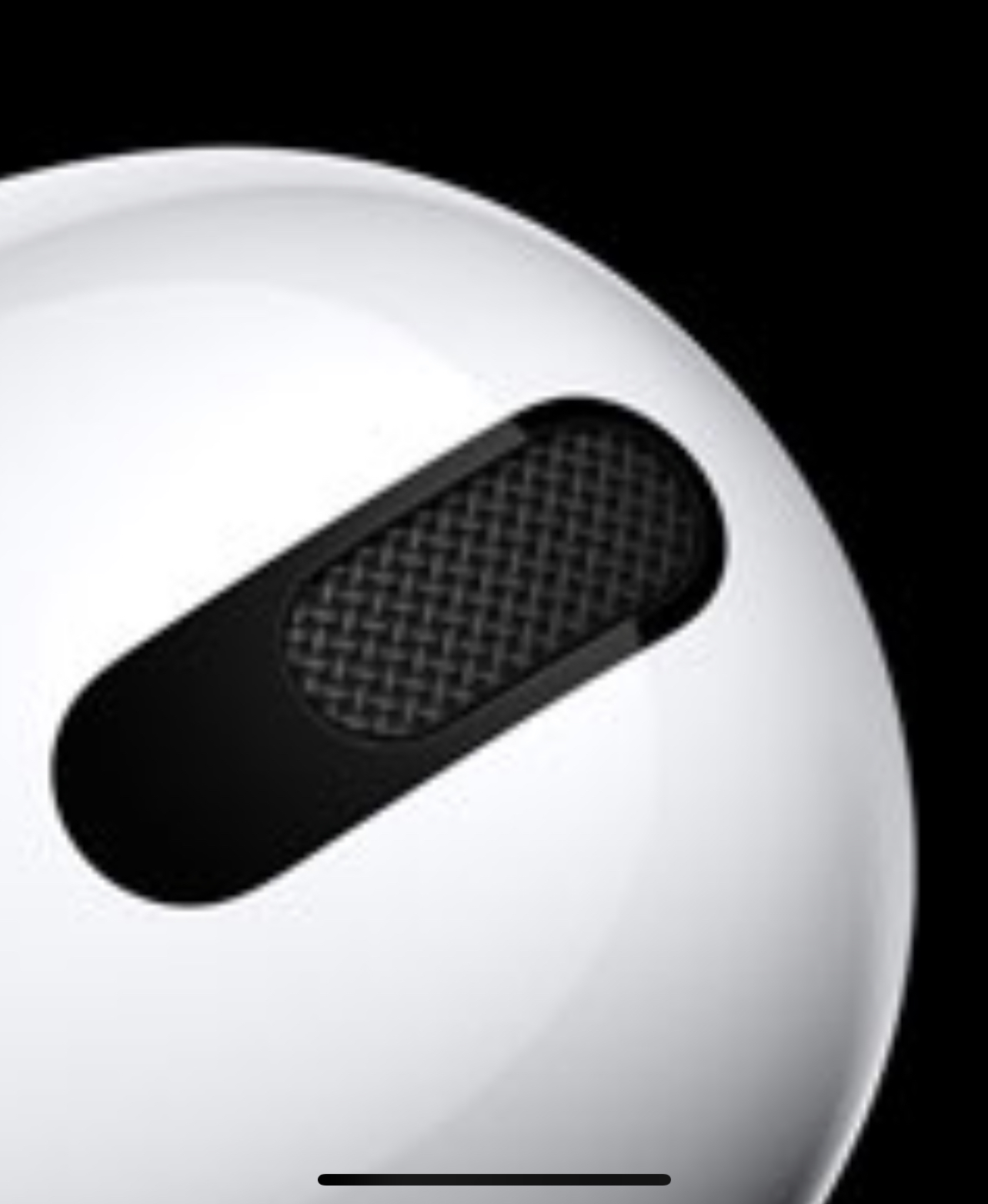

It’s obviously a redesign, the first model the mesh was very even with the frame, just like the renders on the apple website. The new models the mesh is clearly recessed. Apple isn’t known for allowing manufacturing differentiation, quite the opposite.
Anyway, I think you should first try the way Apple recommends, using a dry cotton swab to clean the mesh, especially if you see something stuck or it’s clearly shining from oil.
Try the fit test, if it passes then move on.
If doesn’t, try blu tack and it will probably do the trick.

I checked the image on apple website and in the very first one the mesh is not even.
