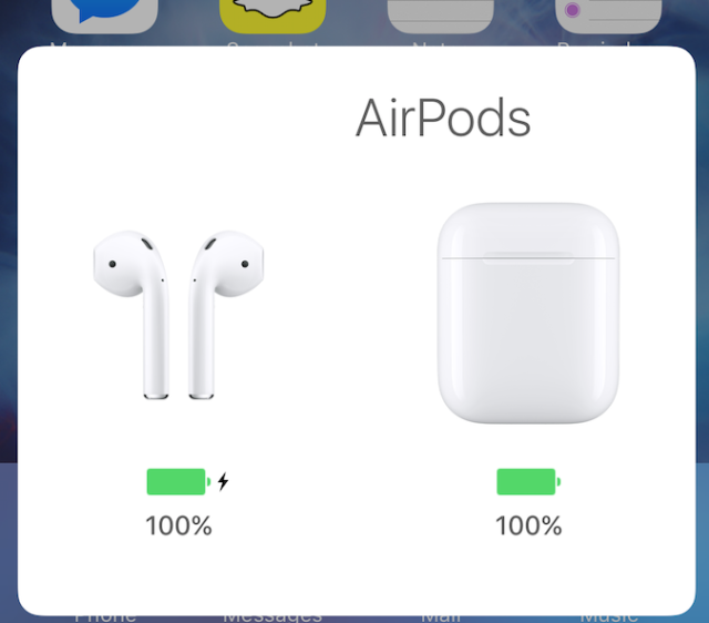

For the first time I saw that the case did not show the lightning symbol that indicates charging. It seems that the case is constantly charging the AirPods, so they are probably always in use somehow, which makes no sense at all.
I bet that people without this issue won't see that symbol all the time next to the AirPods when looking at the status.

Same thing here -- three hours ago my AirPods and case were both at 100%. The case has remained closed since and I haven't used the Airpods at all. The case is now down to 90%.
The charging icon is on next to the AirPods. Stop charging them -- they're already at 100%!
